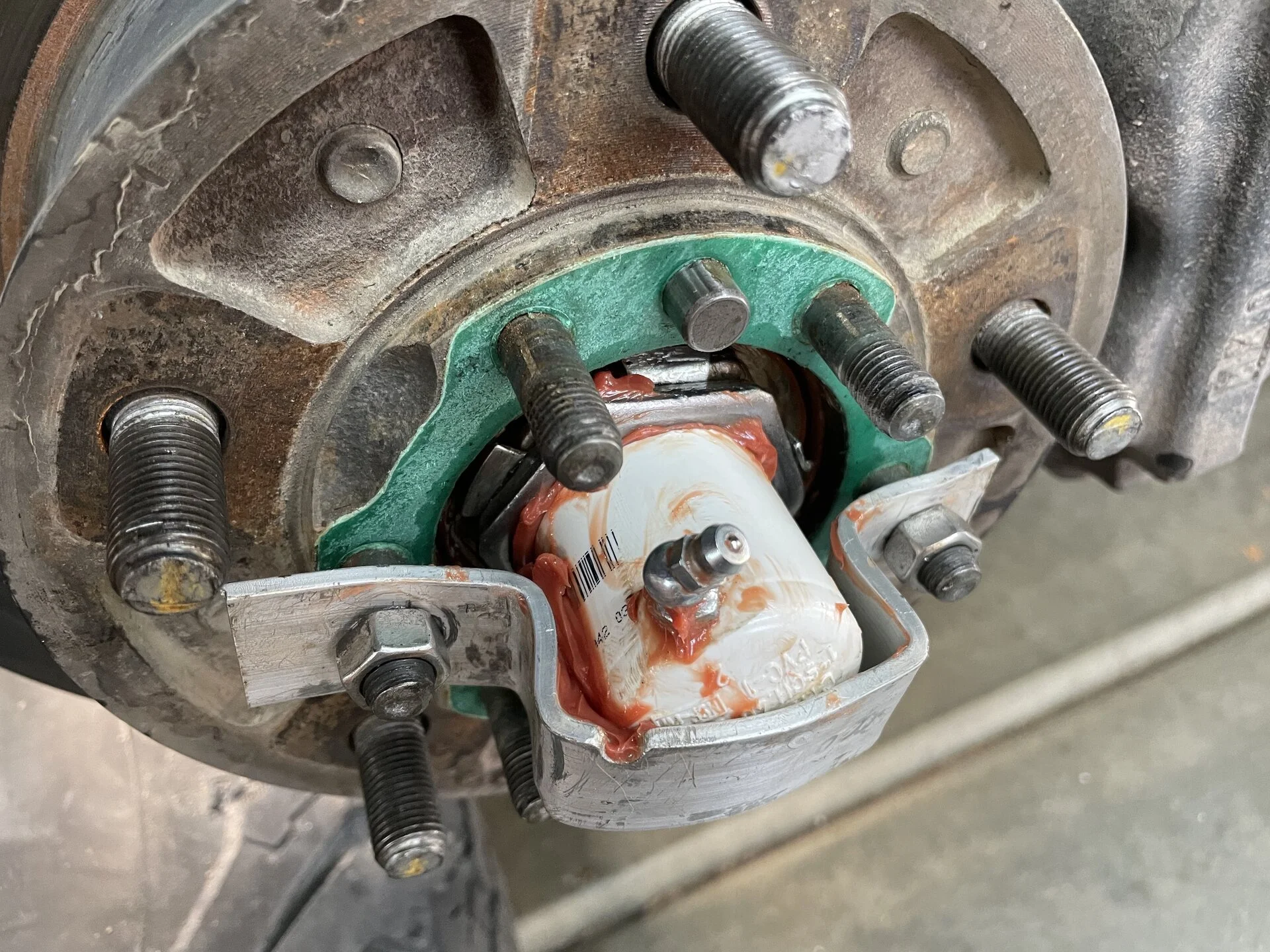

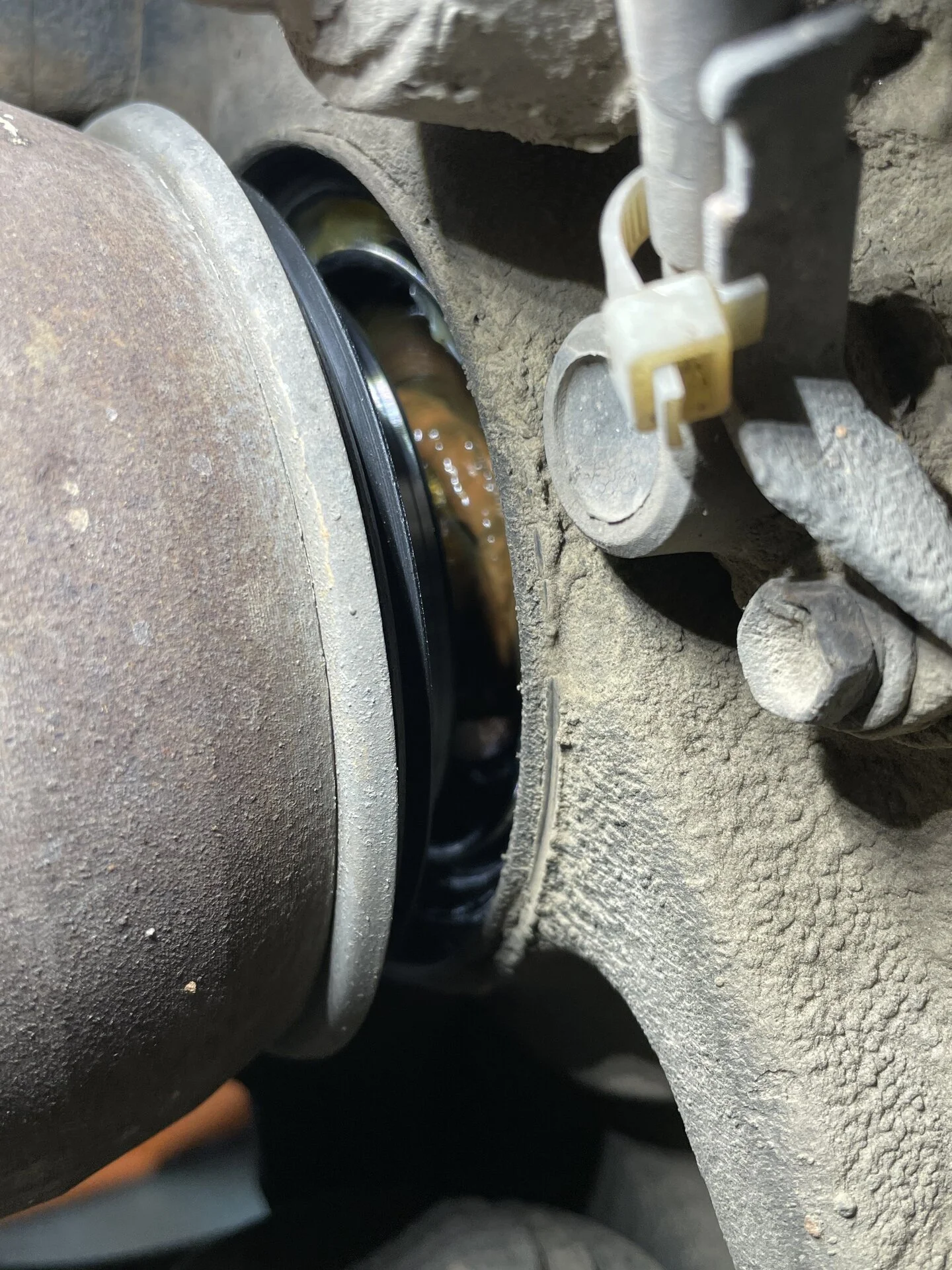

Lubed the spindle bearings using the PVC cap method. Hope this addresses the bird chirping sound coming from the front at slow speeds.
Did this work? Cause mines chirping as well after installing all new wheel bearings. The noise goes away when I apply the brakes and will come back randomly after letting off. I can't figure out what it is but was assuming it had something to do with my brakes, which I just replaced with new OEM rotors and pads.
Did this work? Cause mines chirping as well after installing all new wheel bearings. The noise goes away when I apply the brakes and will come back randomly after letting off. I can't figure out what it is but was assuming it had something to do with my brakes, which I just replaced with new OEM rotors and pads.'
May want to check for play in the bearings. I had a similar chirping issue that would go away when applying brakes. I found my driver side bearing to be quite loose. The PO had done a bearing job and failed to install the lock washer correctly allowing the nut to back off the spindle.
I followed the FSM to a T minus the fish scale method to set the preload. The lock washers are also new with all the tabs either bent forward/backwards over the adjusting nuts. Should I remove the drivers side assembly and re-torque everything?

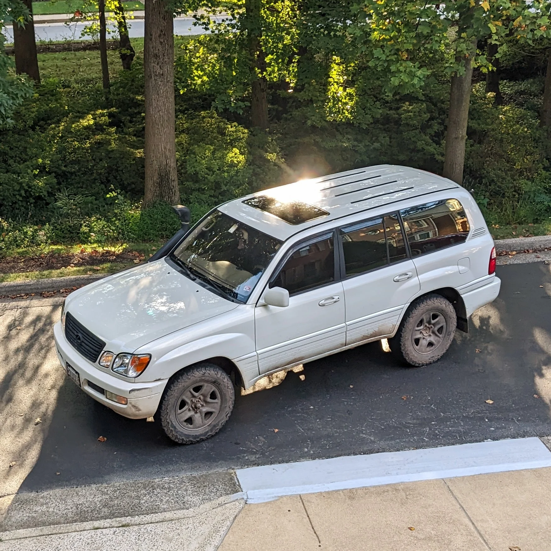

Thought I'd share a project I recently finished on my 2000 LX. Installed a second battery fed by a 200 watt roof mounted solar panel through a MPPT charge controller that also charges through the alternator and trickle charges the starter battery when needed. It powers a 2000 watt inverter that's big enough to run my corded power tools. I removed the factory sub so that the battery can sit back into that space. Everything is mounted on a custom panel that I made. All of the mods are completely reversible.
Thought I'd share a project I recently finished on my 2000 LX. Installed a second battery fed by a 200 watt roof mounted solar panel through a MPPT charge controller that also charges through the alternator and trickle charges the starter battery when needed. It powers a 2000 watt inverter that's big enough to run my corded power tools. I removed the factory sub so that the battery can sit back into that space. Everything is mounted on a custom panel that I made. All of the mods are completely reversible. View attachment 3413587
Really like this setup.
I installed a Renogy 2000w inverter to power a microwave oven in my truck but it is draining out my lead acid battery.
Is your alternator able to charge the LiFePo battery? How long does you 100Ah battery last when drawing full 2000w ?
Yes, because of the the MPPT charge controller, the alternator can charge the LiFePo battery. You just tell the charge controller what kind of battery you're charging and it adjusts accordingly. I haven't tested a continuous 2000w draw because it's just not the use case I was designing for. My goal was to be able to run short bursts of high draw from my power saws and other similar tools, which it handles fine. From what I understand, any single battery will struggle with the draw of a microwave. However, a LiFePo can handle it better because it allows for greater depth of discharge.

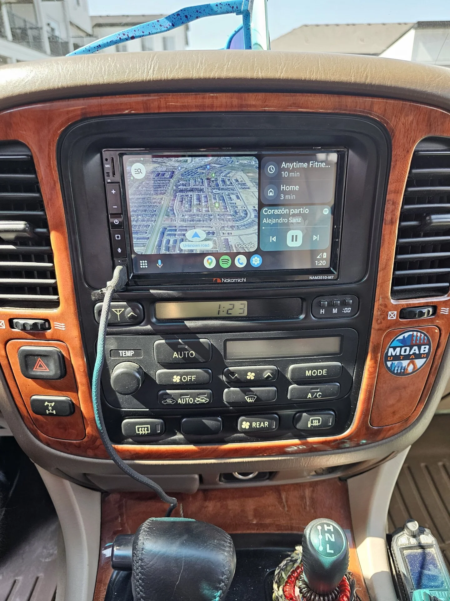

Replaced an old Pioneer Bluetooth unit with a Nakamichi with Android auto/carplay.
Nice to be able to use Gaia on the screen
