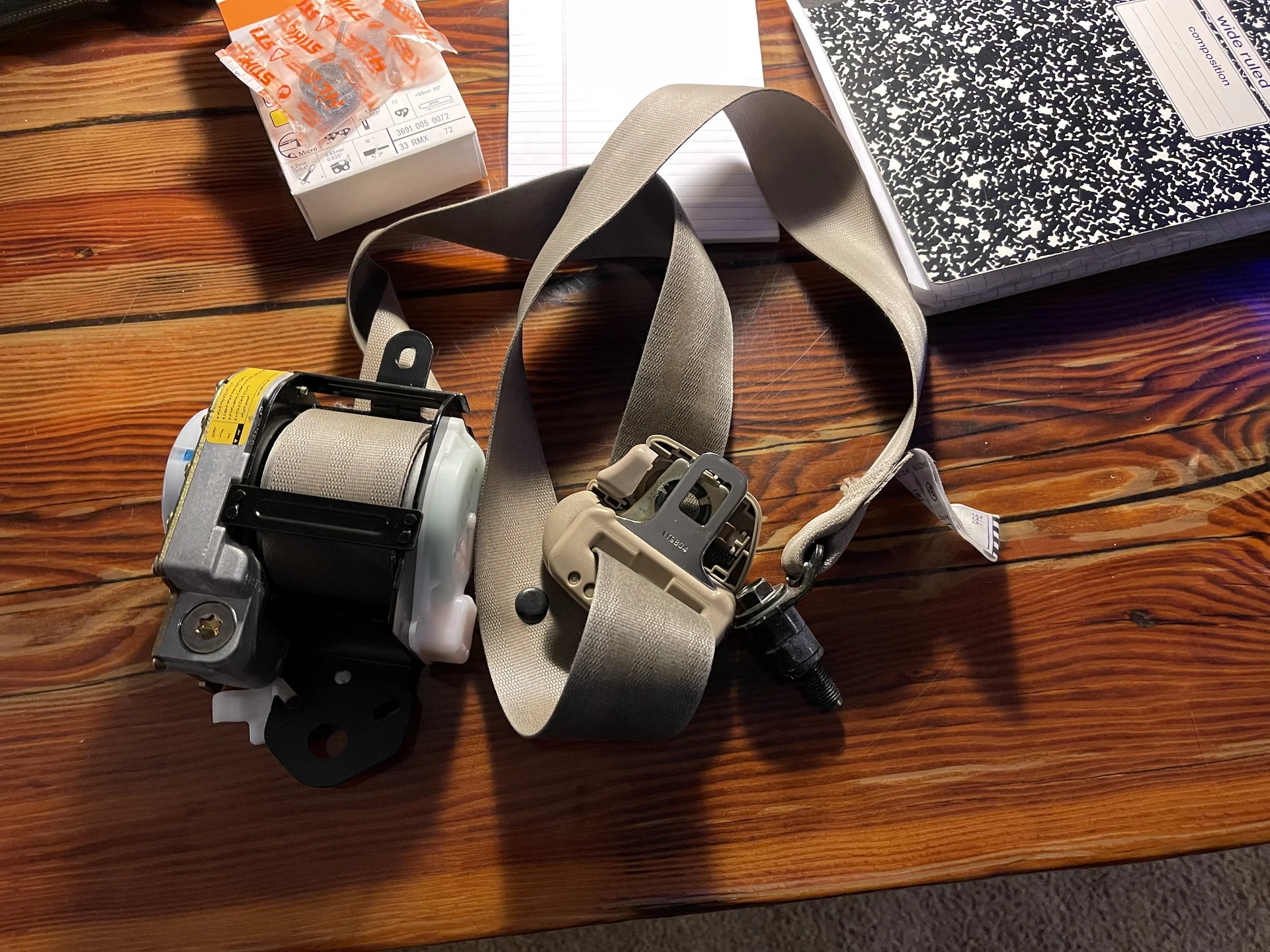

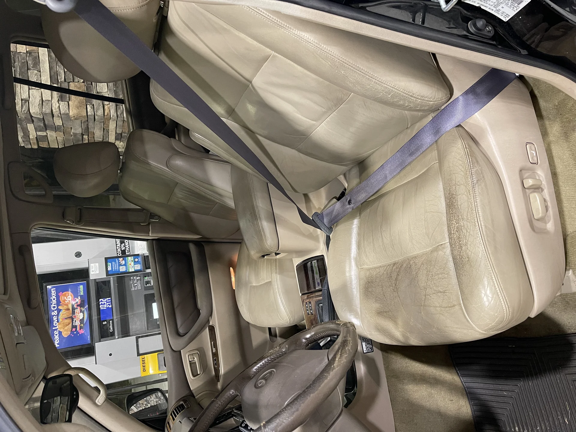

SO, I ordered a new driver's front seatbelt from toyotapartsdeal.com although I think the name of the website should be toyotapartsdetail.com because if you don't pay attention to the DETAILS, your gonna mess up like I did. I thought I ordered an Ivory colored belt like the one I've attached in the pic, but turns out in the item description there is a note that says "replaced by" and then a different part number, which is the part number for a Bluish Gray seatbelt. Oh, and how I was just tickled that they won't let me return it either, due to it being a seatbelt with hazardous material and a charge in it and what not. The only thing Blue in my whole truck is me, feeling Blue about not being able to return my Blue seatbelt.
On a brighter note. I'm happy having a superb functioning seatbelt once again, and the blinking Red man with the beachball on his lap has finally gone away. I knew by instinct it was the driver's seatbelt that needed replacing. Since I bought the truck, I've not had anyone else ride, so none of the other belts in the truck were touched. The Red man was not an issue when I purchased the truck. Also, the retractability of the belt was pretty much gone. I was happy to replace that belt just to remedy that alone.
Now here I ask you. What do you think of the Blue, would it make you crazy, or you gonna live with it if it was your truck? Also, anyone know how much to refurbish my old Ivory one? I mean total refurbishment, so it's like new again almost.

If costs aren’t too high, replace the other side with blue as well and people will think it’s some special model like Porsche does for an extra $35k

I'd run it but if you choose to refurbish your old one, I might be interested in buying this one from you!
oh it was high. won't be doing that. I will say though, I should try to own a Porsche some day.

The driver’s seatbelt in my 2002 LX was slow to retract and the belt had stiff spots… I think that sweat, liquids and dirt over the years had hardened within the seatbelt material.
I pulled the belt out as far as it would go and clamped it to prevent it from retracting…
I used a 5 gallon bucket with hot water and laundry soap to soak the seatbelt for 5 minutes… then scrubbed it with a dish brush in the soapy water.
Toweled it off… then a bucket of warm clean water to rinse out the soapiness… 2 courses of clean rinse. Toweled it dry.
The seatbelt is like new clean… no stiff spots… very soft and supple.
And it now retracts without hesitation.
Might work for yours as well.
I pitched the old LC seatbelt. 100 for refurb and shipping vs replace for 250.
Refurb does not include belt cleaning. My new belt is an awesome experience. Sorry had a video had to remove it.
