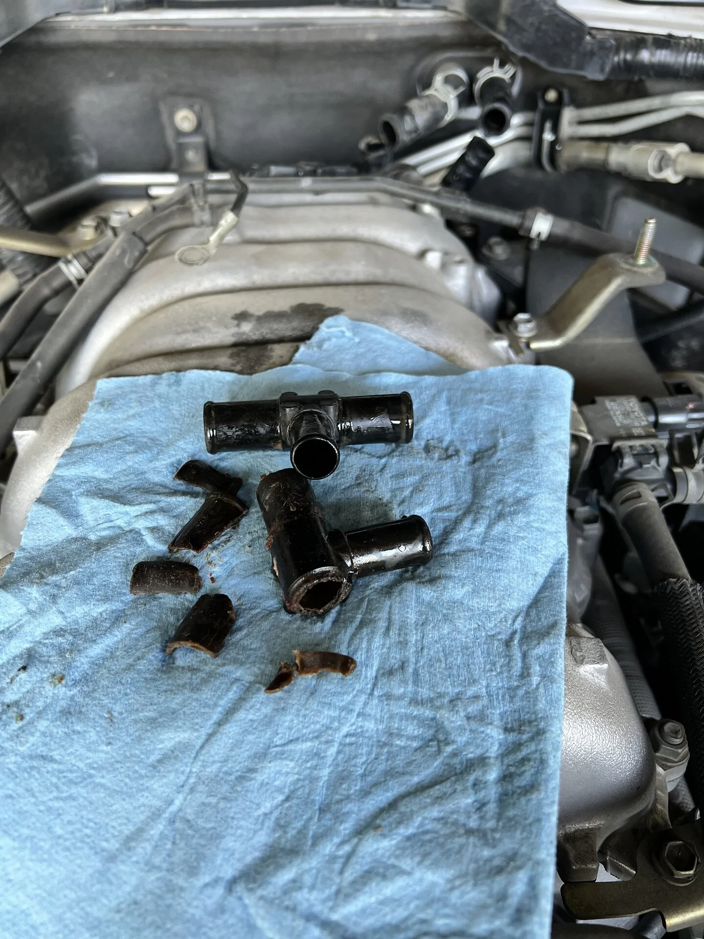

Followed up with these Tees, saw some weeping earlier this week, didn’t think much of it. Glad I decided to get to them sooner rather than later. Part number is there if anyone need a quick reference. I think the next go around, I might try brass, or some type of thin walled galvanized fittings.
