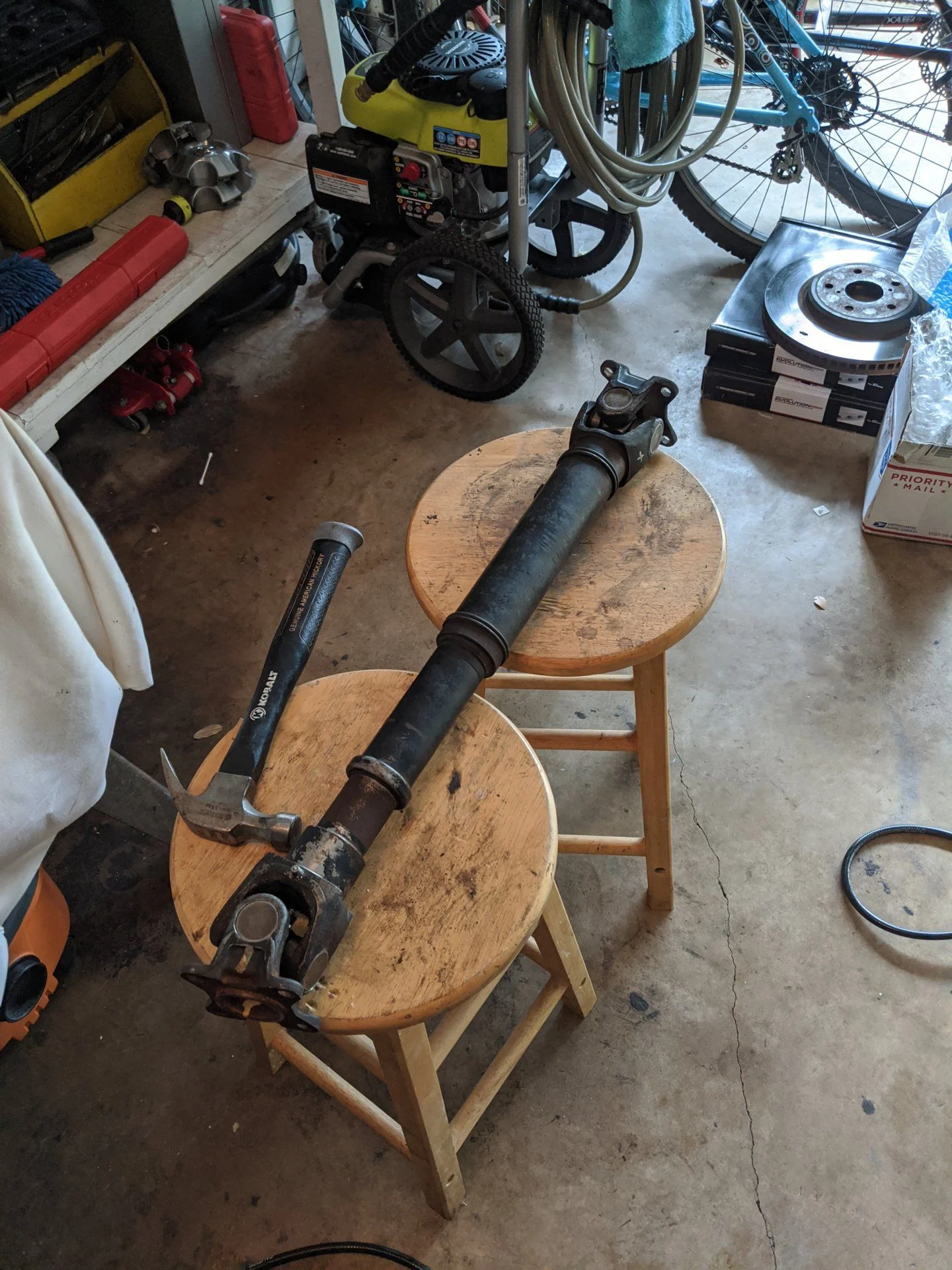

Installed two new drive shafts. Hopefully all the bad vibes will go away! The Cruiser looked odd amongst all the bagged show cars and drift cars!

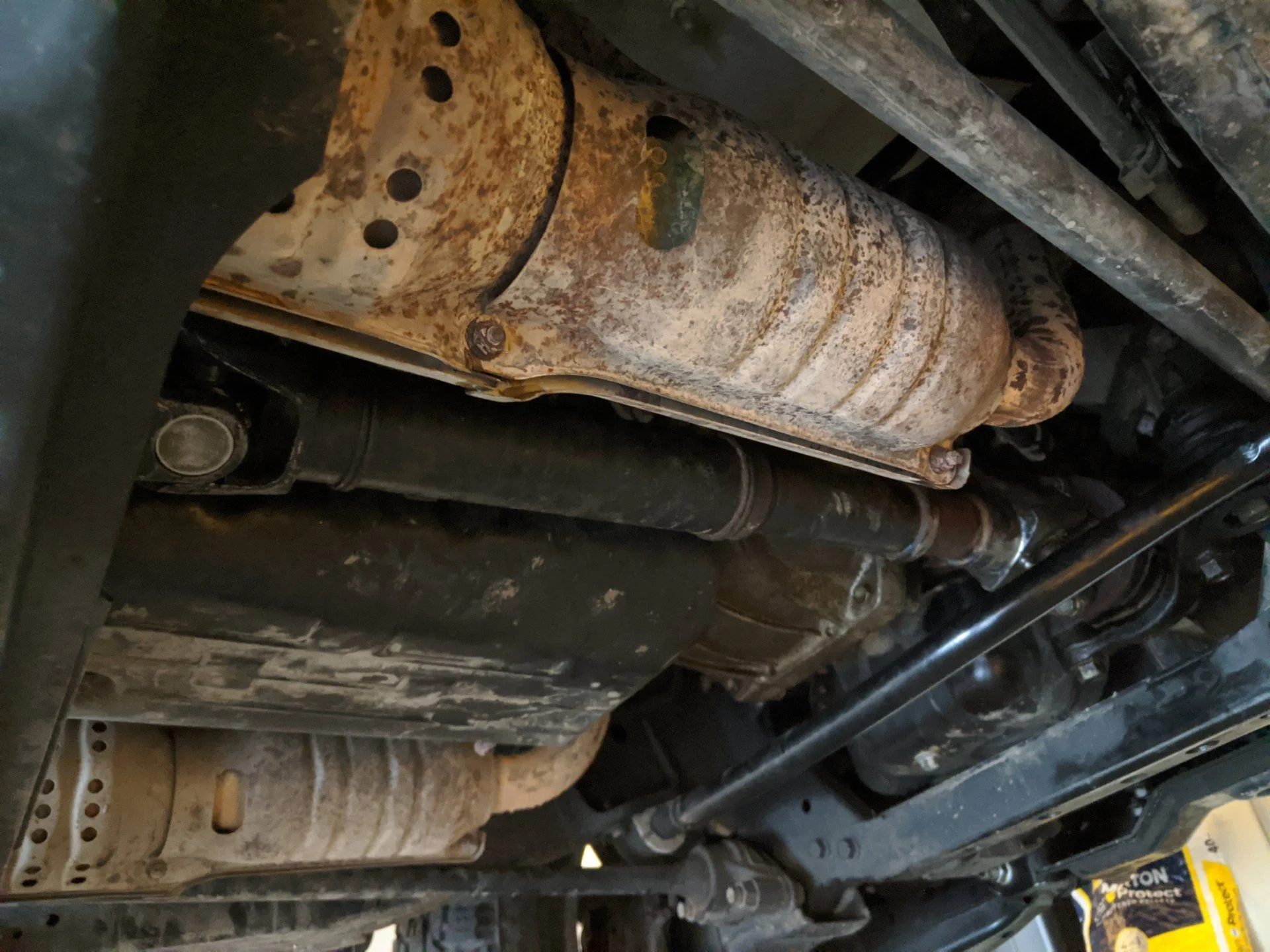

Finally back to AWD. Deleted the front driveshaft/locked center diff while u-joints shipped. 2WD wasn't bad, actually really smooth. Got rid of the vibration I'd get at 70+ and the hum/vibration I'd get when coasting at 30+. Pinion seal stopped dripping too, which is nice.

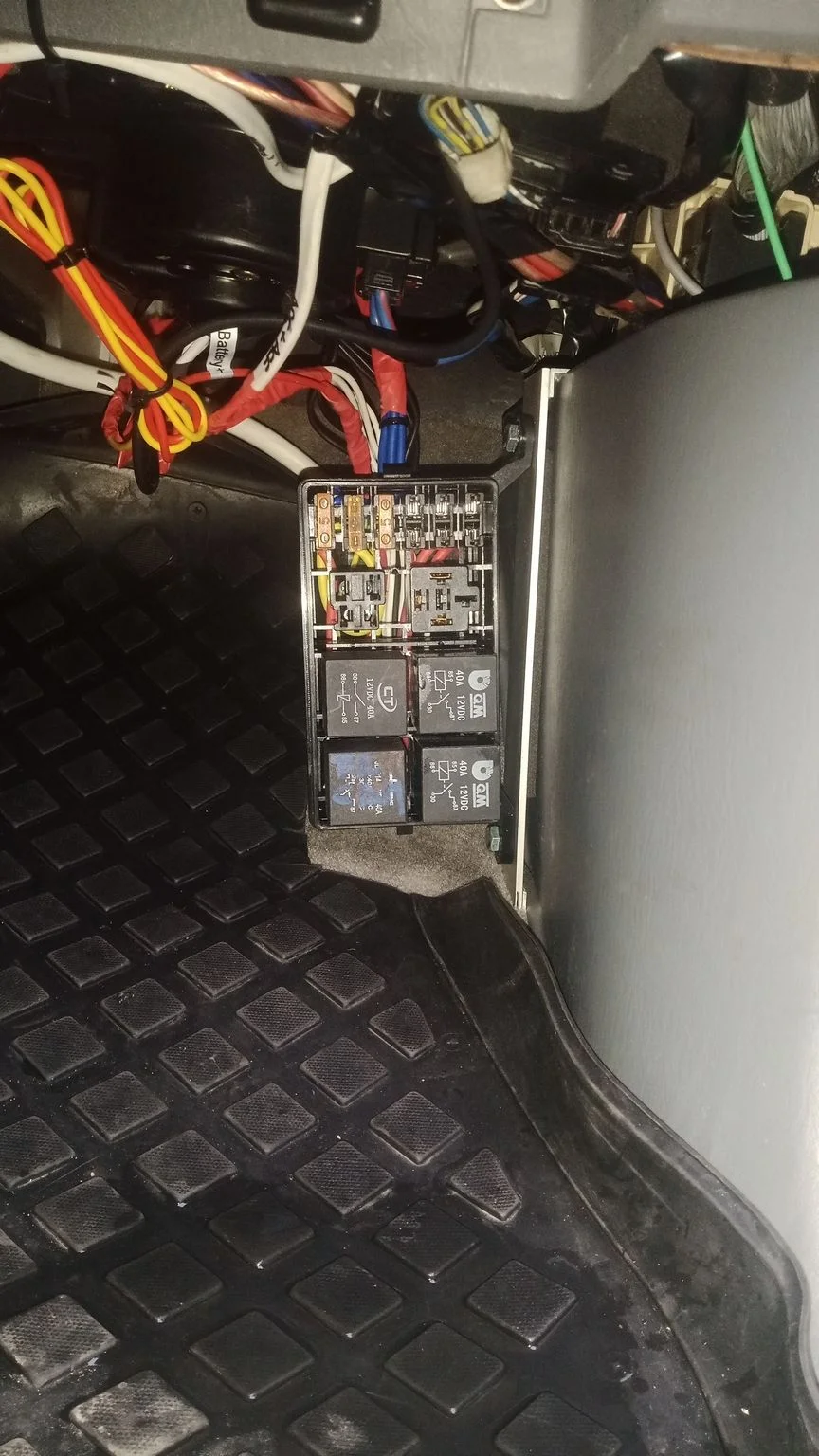

Today installed in cabin additional power supply from the aux battery.
I'm gonna install different gadgets/mods and needed a separate circuit with relays and fuses to support devices. On board front & rear cameras, EGT/Boost/AFR/Temp/Voltage probes and gauges/different CB and VHF/UHF rig a.s.o.
Came down from the aux batt with a 5x1.25mm isolated cable along the right side, went through the firewall OEM gromet, passed next to ECU and down on the passenger side. Bit excessive as I won't draw that much amps but better be safe. Each cable goes to separate relays.
I don't like drilling/chopping/destroying OEM parts so I built an aluminum bracket to stay on the ridges of the plastic cable/plugs cover. On it I mounted the relays/fuses box with two 6mm screws and done all the connections. Diodes were used for the relays control coils. One live continuous + batt line was passed through a fuse to supply the camera's parking mode power needs. That goes through camera's own batt monitoring/protection module (set it up at 12.2 V to avoid depletion of aux batt).
Pulled a + from the lighter's pole and so the box/relays will be powered when the key is on ACC. Relays are using just few hundred of mA's, so no worries there.

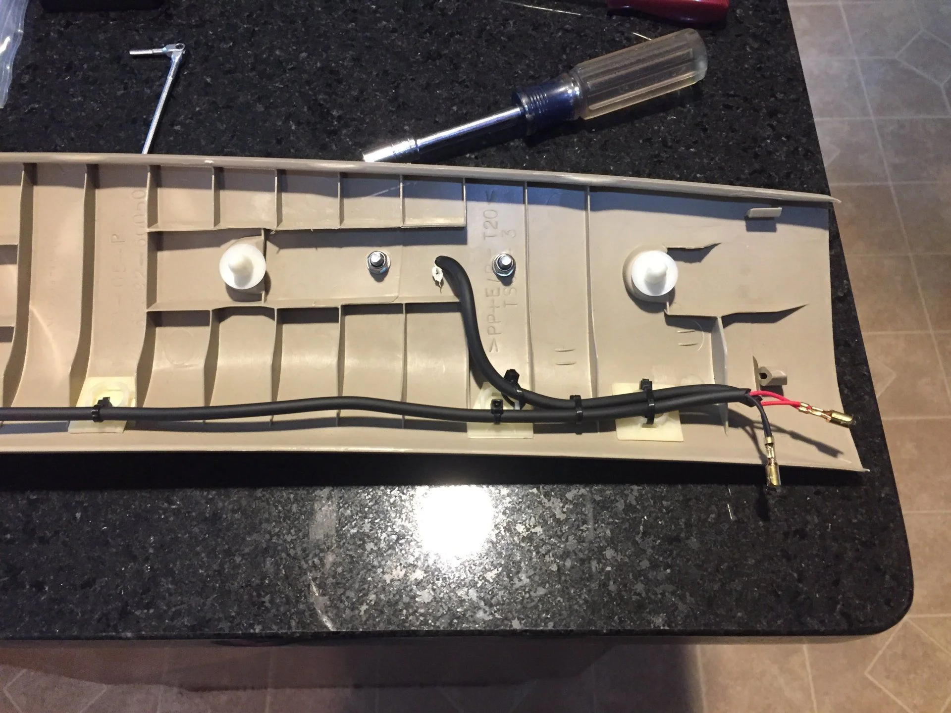

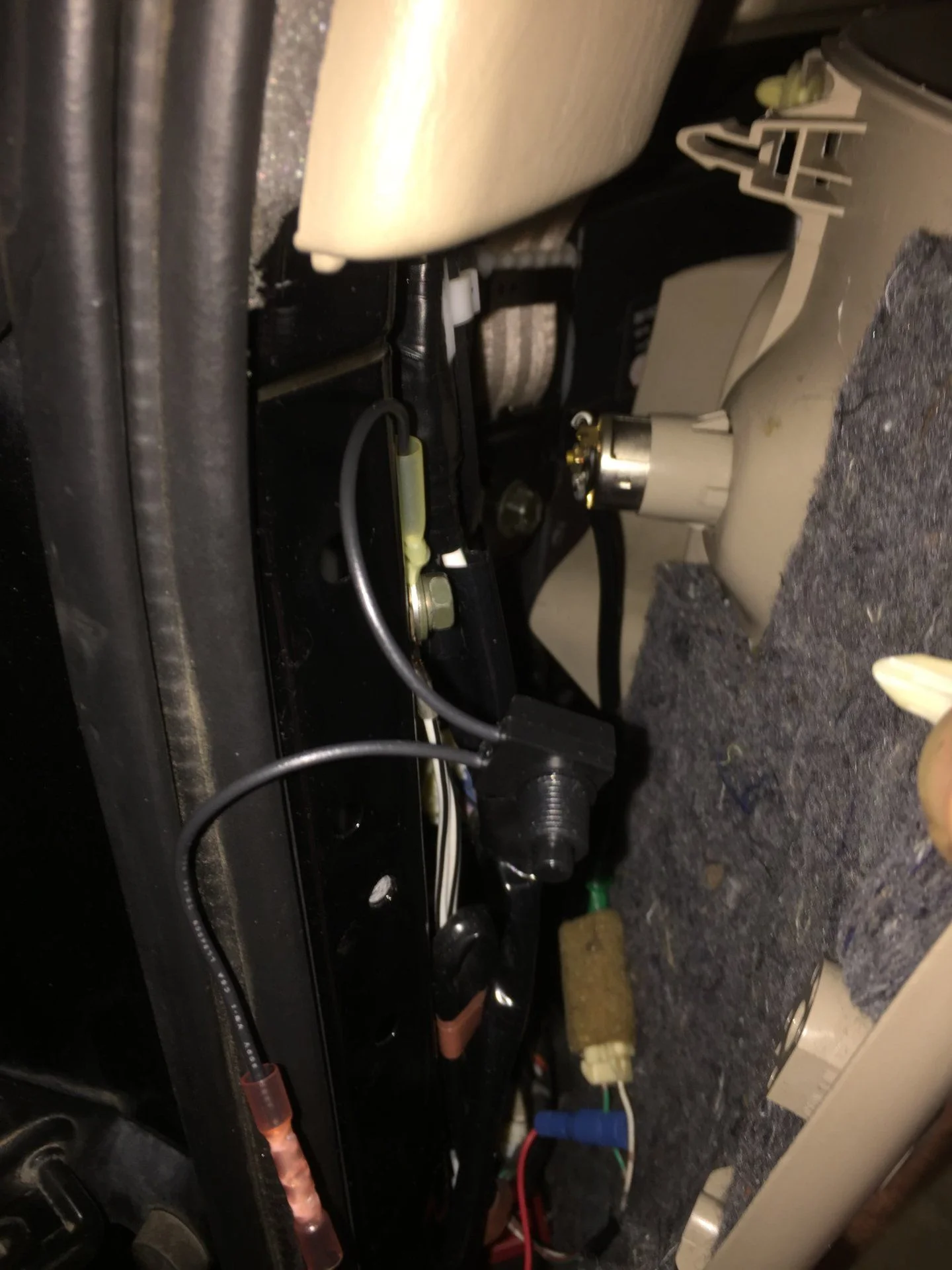

Installed some rear hatch interior LED's. When camping and working food prep or digging inside drawers out of the back end of the truck at night, the rear cargo light wasn't getting it done. I chose the install spot for two reasons- ease of installation and best light spread/usable light into the cabin and over the tailgate. I initially wanted to put them farther out in the upper hatch like overhead lights but that required a lot more work to ensure no potential for leaks and running the wiring through the rubber boot in the upper hatch.

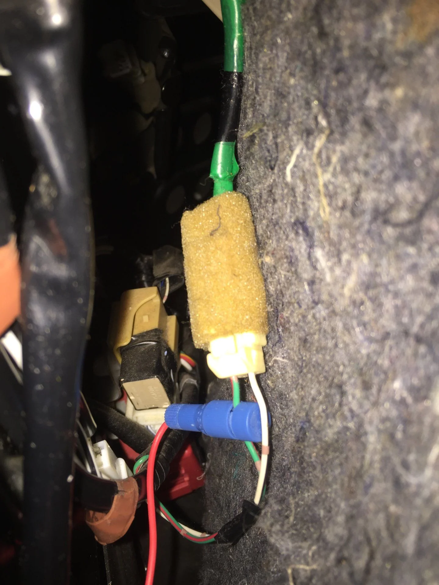

I found some small low profile LED pods that are IP68/69K rated. 9w/.75 amp(3 x 3w led's about 500lumens) 2.9" x 1.6 x .6" come with a rubber mounting base and stainless hardware. I pulled the trim off the interior upper hatch and found a suitable location to mount the lights.
Ran the insulated wire together to one end and then tied together and linked it to one switched power wire tapped off of the ACC outlet in the DS rear cargo area. I used quick disconnect terminals incase it needs to come off for some reason. There's a nice ground location just above the outlet to tie the switch into. The switch is a simple moisture resistant rubber capped push button switch.

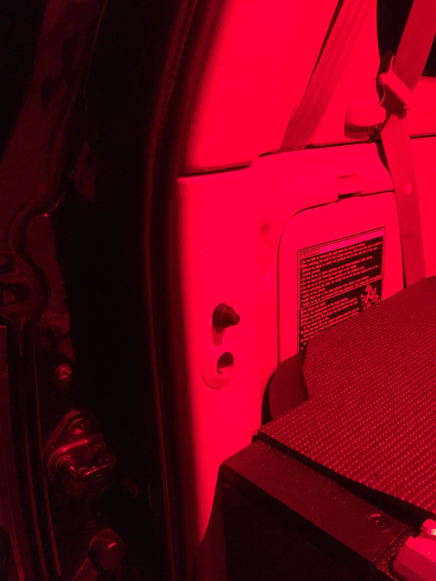

I chose RED led's since I read somewhere that bugs can't see red light and won't be attracted (to the light anyway). Light output is better than I expected. It does however remind me of the Hunt for Red October inside a submarine. Red has less useable light, but its brighter than the picture shows.
One more of the switch location:

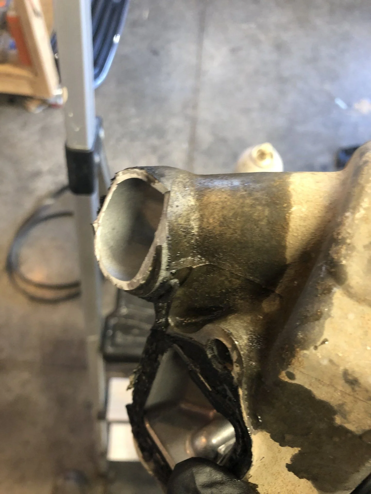

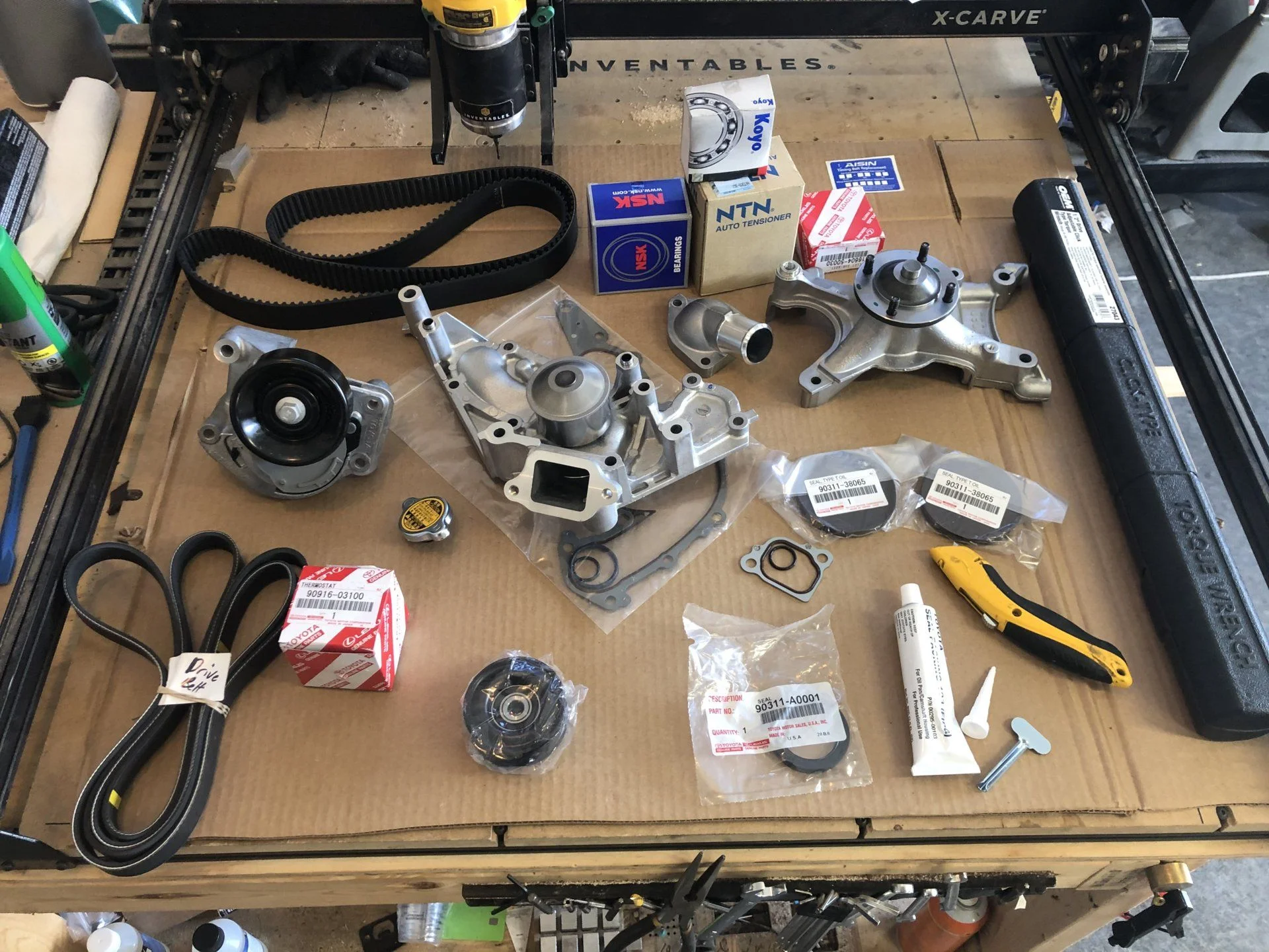

Completed some of the last things on my need-to-do list, unfortunately with some of the issues probably wiped out the budget for the wants/dreams list. Car runs pretty good but the timing job date was a mystery, called the dealerships where it was serviced and could find record with the last 160K miles. I've been hearing some bearings in pulleys on cold starts, turned out to be tensioner bearing and fan bracket. Radiator has been leaking for seventh month from a pin hole in the top left and then the fan was spraying it all over the engine bay made a huge mess. Fan shroud only had the top half and was held on by zip ties. Before:
Ended up replacing cam seals, crank seals, water pump, timing belt, timing tensioners and pulleys, putting in the missing dust cover, new thermostat water inlet (because I broke the old one), thermostat, thermostat outlet, fan bracket, tensioner, idler pulley, radiator, hoses, fan shroud, and radiator cap. Reconditioning all the cover and hardware too.
used my CNC table as a staging area for parts, and the wife was out of town so cleaned all the parts on the kitchen counters:
Started Saturday and greatly underestimated how long it would take. I would doing a lot of cleaning of the plastic and the nuts/bolts but there also several very stuck pieces. Including this:
and it left a little piece in there, in was cemented in there pretty good with some of that seal packing gasket. This obliterated all hope of finishing on time since nobody had the part and it wouldn't come in till Wednesday. Ending up having to borrow someones car for Sunday and Monday and then renting a car Tuesday through Thursday. So between renting a car, buy a new inlet/housing, then ended up getting these tools for $80 on amazon (only one that shipped next day), did take away from some of the thriftyness of this job:
I wish Autozone or somebody would have a good tool like this to rent but alas. Didnt have anything to make a good homemade one but these made it so easy to get exact torque specs and get the timing right. The new thermostathousing/Water inlet has a new design actually, kinda nicer to work with. @2001LC sent me some of that expensive Toyota coolant gasket seal which was nice. Tons left if anyone wants it.
Timing Belt/Water Pump combined with the radiator job took all together probably 12-14 hours over a couple days. I'm slow, was watching the OTRAM videos, rechecking against the FSM, and cleaning but honestly I was decently organized and dont know how I could have done it much faster. Draining the coolant from radiator and engine is slow and time consuming. So I know personally I would say dont plan to finish this in one day. Buttoned it all up and did 2 fill, rinse, and drains with distilled water, and then filled with Zerex, sounds good, looks good, and so far no leaks.
