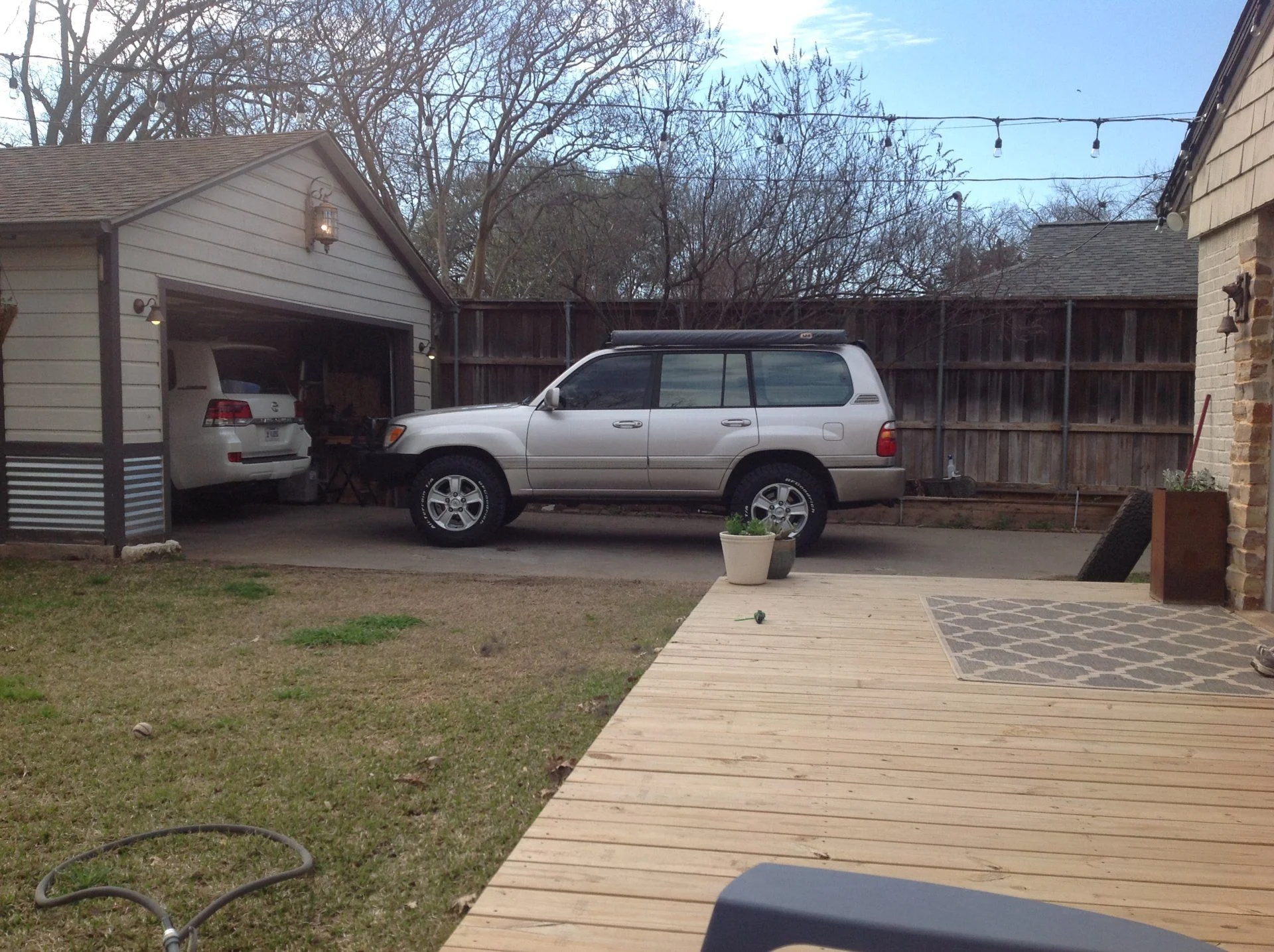

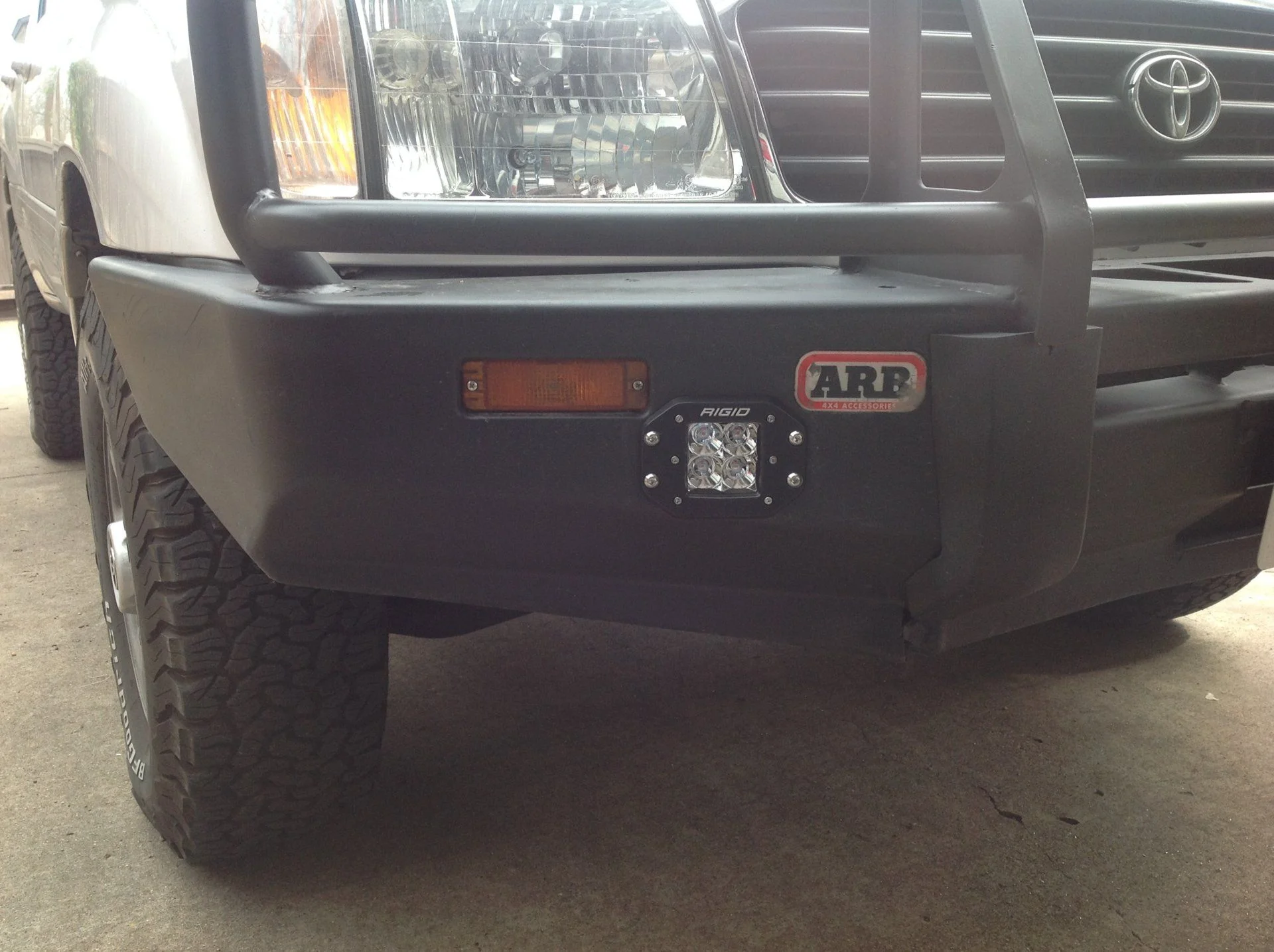

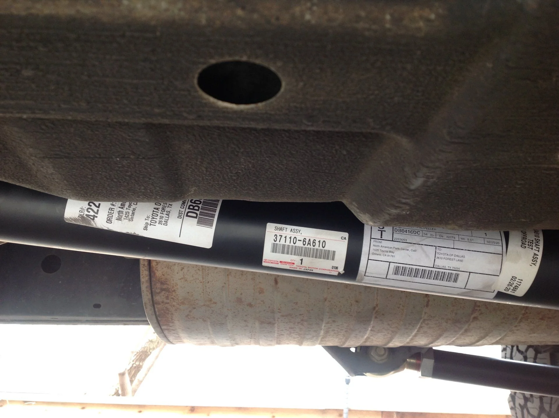

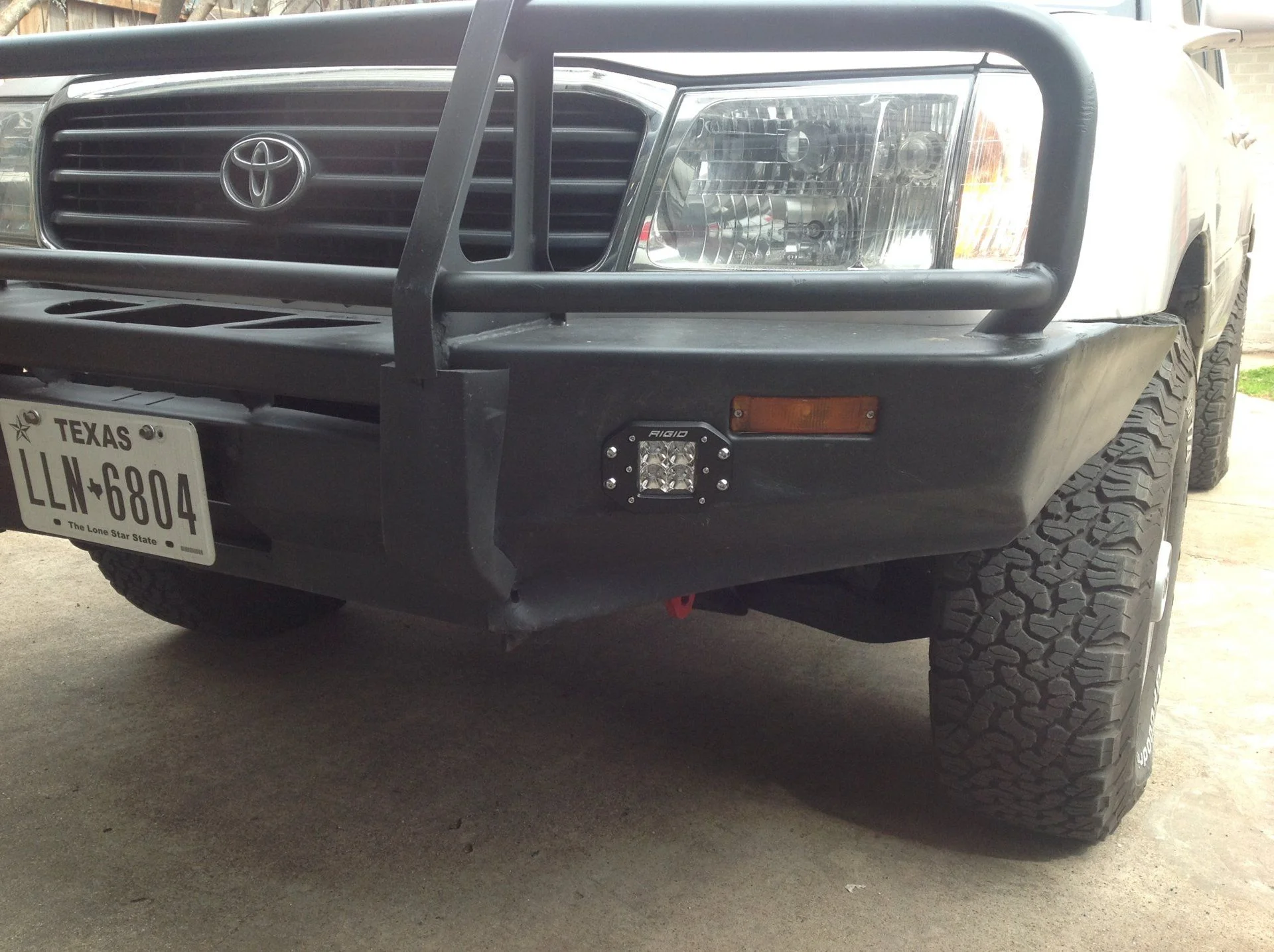

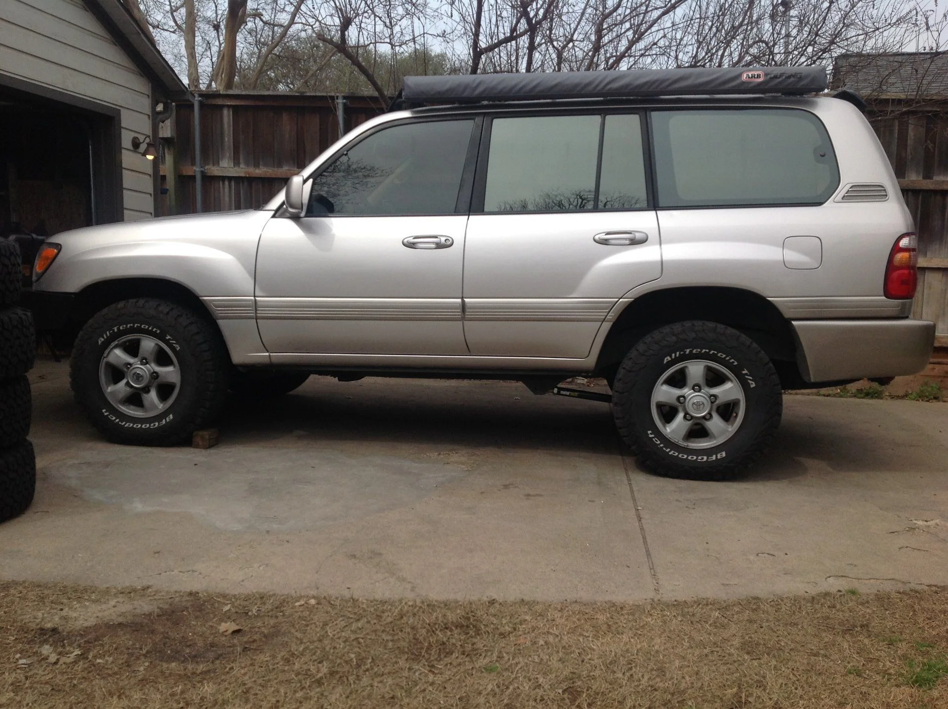

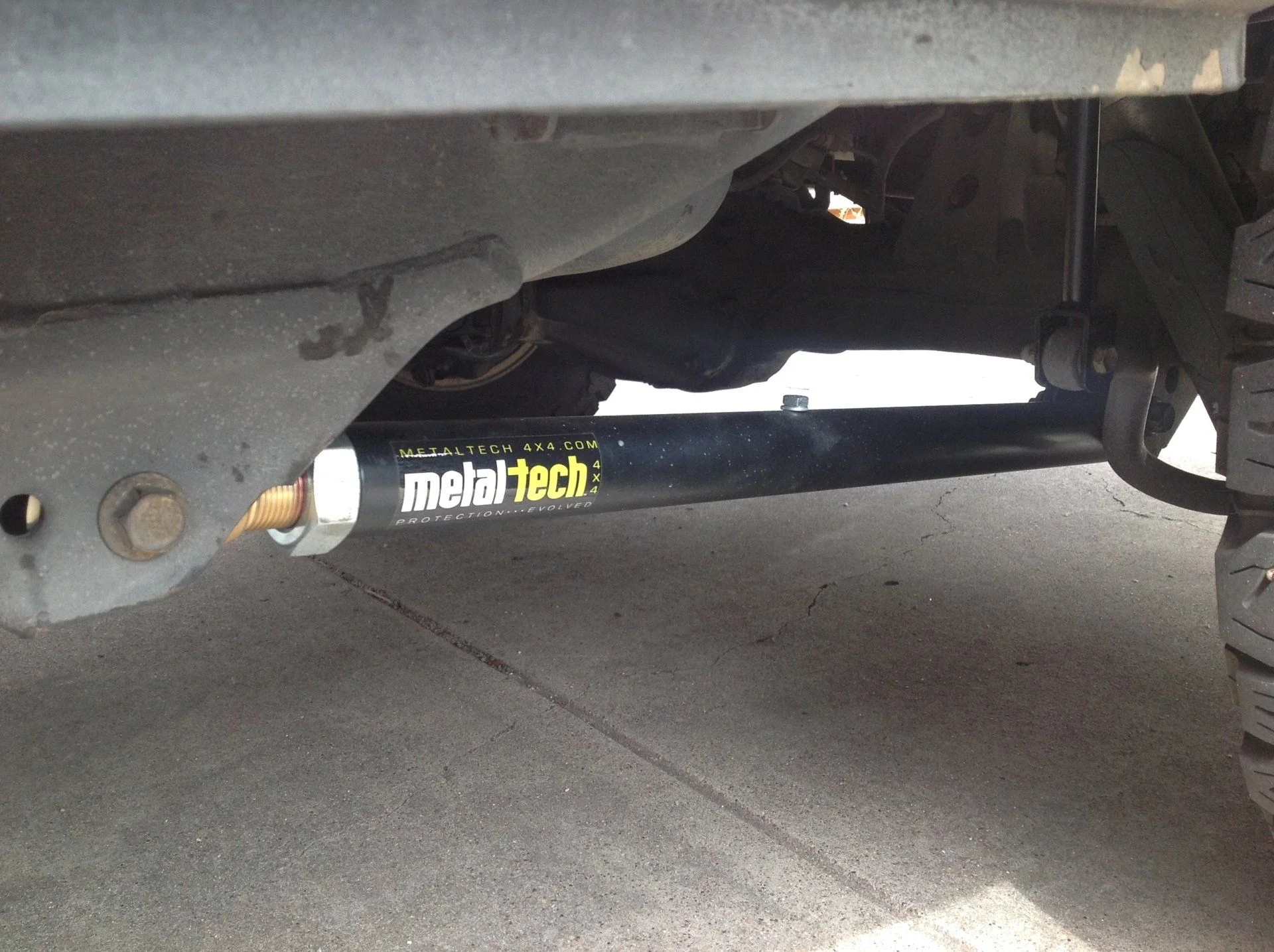

Busy few weeks. New rear upper/lower metal tech control arms, new front/rear extended sway bar links, new diff drop, new 50mm rear coil spacers, new OEM rear drive shaft and new to me Tundra take offs with BFG 275/70/18s. Also cut in some rigid flush mount Amber fogs into my ARB, wired into my factory fog light switch. Love the new stance and the new wheels. Definitely feels more planted on the road, all the bushings on my rear arms were shot.

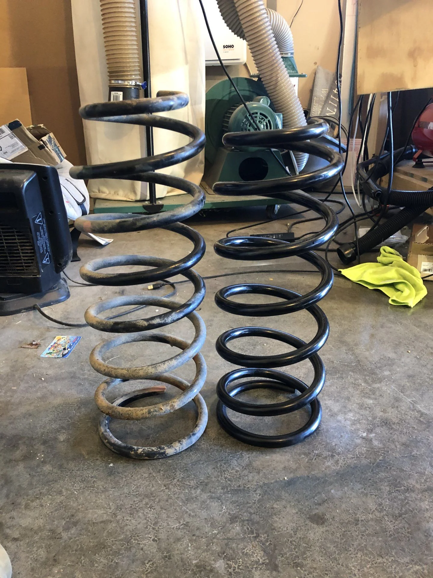

Ok this is more I’m doing this right now...I’m installing some Old Man Emu springs 2865, now everything I see says that these are for 1.5” lift medium duty up...are they really shorter than the OE springs...everything was stock on this vehicle or at least shocks were and I thought springs....is that for real? So are they are stronger compression?
Much stronger spring, it will not compress as much as the stock springs. Just did the same thing about a week ago. You’ll see all is well.

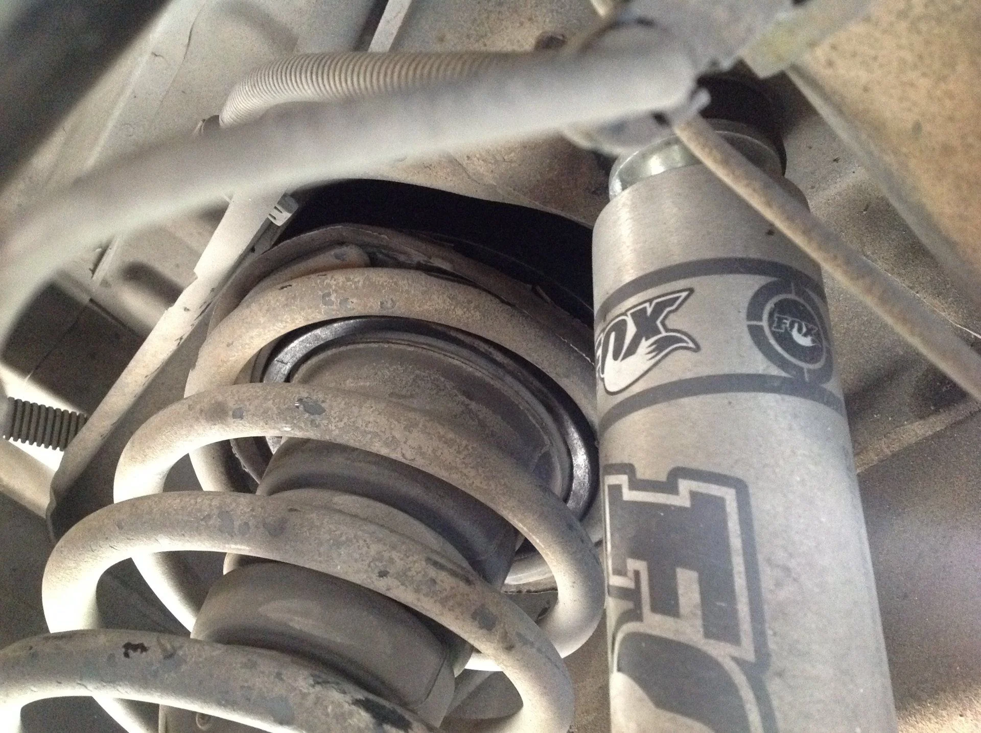

Took off OME shocks and installed Tough Dog 41mm fronts and 45mm adjustable rears from @TRAIL TAILOR . Still have the OME 865 medium springs.
So far so good. Fixed some crazy squeaking and a much less tooth-rattling ride.
Hard to get a good shot of the rears installed.
View attachment 2232003View attachment 2232004
Looks like your UBJ boot might be torn?? Worth a look due to the build up on it.

Those are nice, who makes them? From appearances the look to be 16” as well... can you post a link to the website?
Thanks, I really like them. Had to get the heat gun out and push the fender liners out of the way and flatten the pinch welds. No rubs so far.
