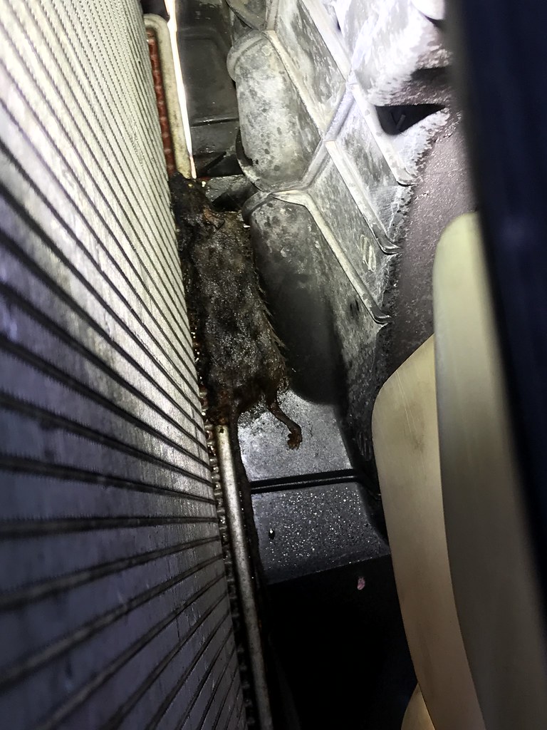

Replaced my radiator, 2007, 200K miles OEM unit. I'm gonna go ahead and blame it on this rat, there's no way a 100 series rad would leak at this little mileage. Top looks new and not browning either.
It's such a joy wrenching on this truck without rust, everything came out so easily and i didn't get tetanus. I didn't even curse once, and this job is very simple, a few bolts and just pull it straight up.
