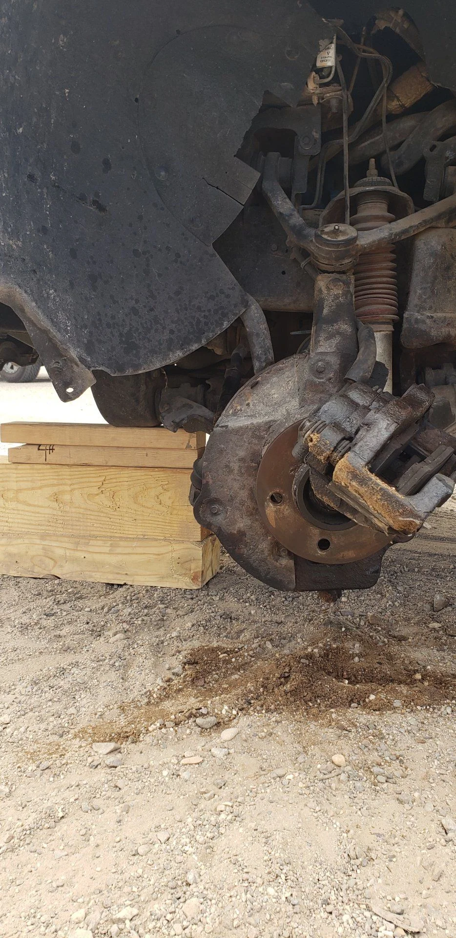

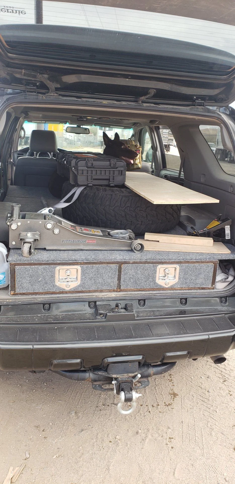

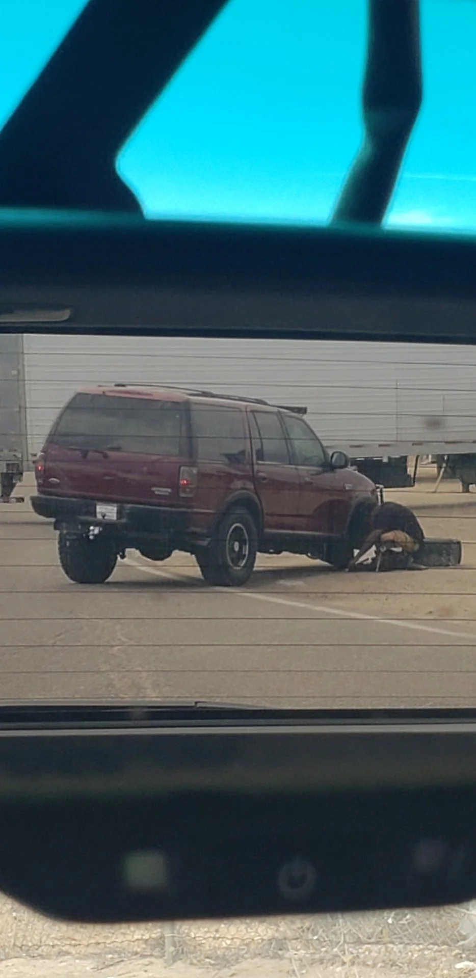

All of the studs sheared off on this guy near my house so I went by the garage to get my jack and blocks.. He said nobody else even asked if he was okay. I gave him a small can of El Pinto Hatch Medium chile before leaving. I was given a small can of chile as a welcoming gift to Albuquerque by a stranger once and it stuck with me.

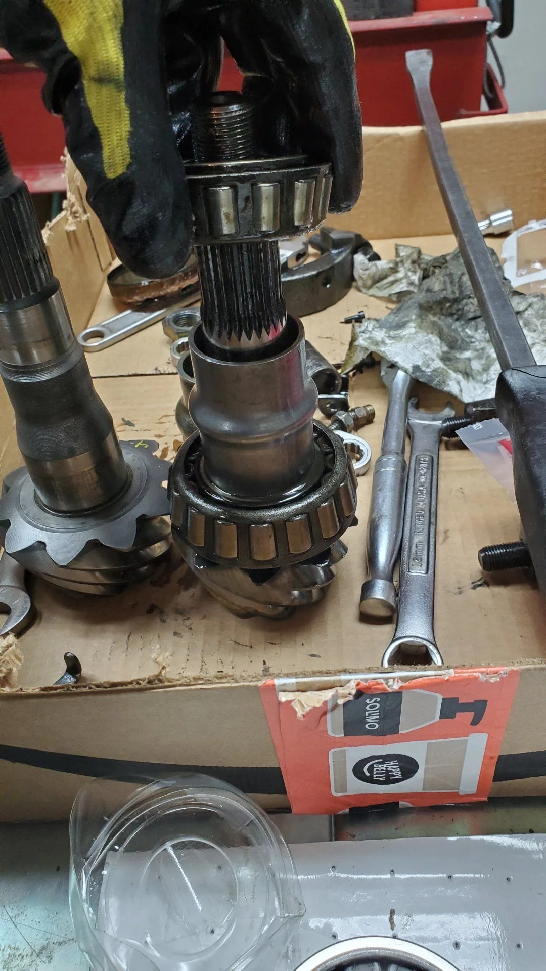

Tore the rear diff apart, trying to locate the source of a whine. Looks like pinion bearing pre-load was down to zero and the crush collar might've lost its mojo, maybe due to the extra power put out by the turbo, not really sure. This is a rear wheel drive 80 and with an additional 100hp so I wonder if the crush collar got more "crushed" which caused the pinion pre-load to go down to zero in-lb. Just a WAG as I'm not a diff expert by any stretch.

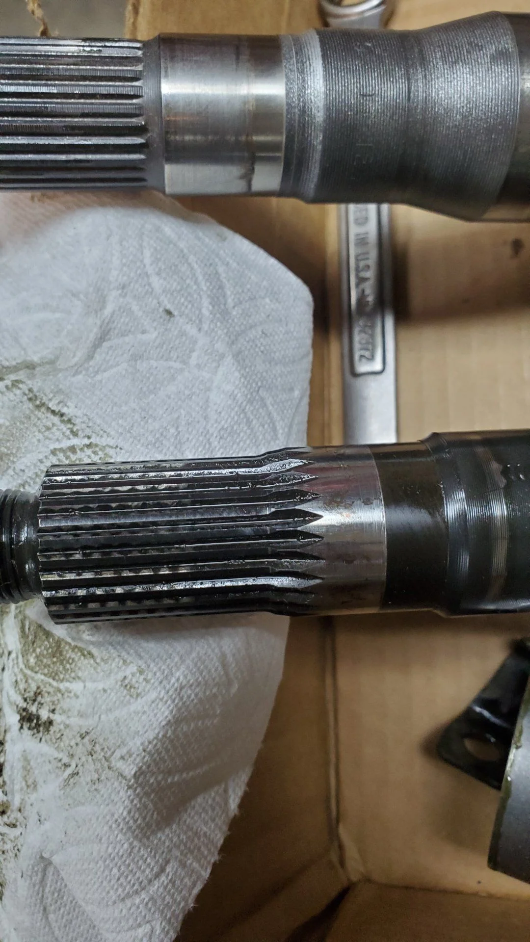

The pinion slid off manually vs pulled off by a puller so it might've spun in it's home position, thereby contributing to the whine I heard
I brought out my old OEM pinion to compare the home position of the pinion bearing and noticed that the current pinion is shiny versus the old pinion which is dull. That leads me to believe that the pinion bearing might have spun. :bang:
Time for a solid spacer I'm thinking. I'll order one from Cruiseroutfitters which is where I got my master rebuild kit from last week.

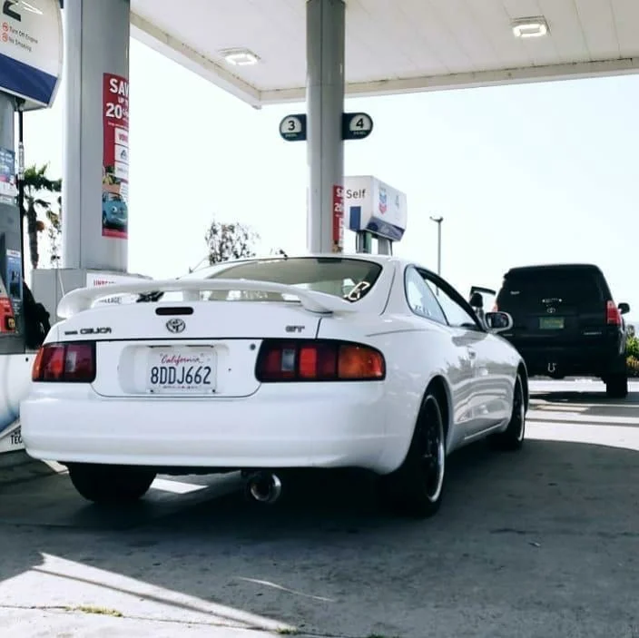

Sarai and I just got back from the San Diego area where she drove the 4th gen 400 miles home, a lot of it through strong winds and through the curvy mountain highways (a first for her!). I kept an eye from the rear view mirror in the cockpit of this 1997 Toyota Celica GT. It's in far better shape than most of the stripped out TOTAL JUNKERS I've seen all over this half of the country, and even parts of the rest where dealerships want 10,999 for a 150k ST Coupe. No, this liftback was being worked on as a project by a guy and his son. He's a Toyota technician, used to work for Nissan, and really took care of this car. They swapped out a lot of the interior with nicer cloth seats, replaced a lot of missing trim, did the timing belt, water pump, thermostat, brakes, radiator... The time came and he doesn't want his 17 year old son in a 25 year old project car, so they decided to sell it. The kid wants a 350z but his dad already told me that's not happening either. We spent about 3 hours Saturday and 3 hours Sunday with them going over the car. I need to replace a distributor o-ring and either clean up or replace the EGR, and then take care of the gearbox oil. It needs an alignment, and I'm pretty sure it's sitting on clipped springs. I have a box of oem parts including original springs to put back on and make it feel roadworthy again. It needs one new wheel stud. For a 25 year old car, it rides just like my '98 Accord used to. The transmission feels better than my 2008 xD and it's 11 years older. 120k miles. I don't think I will daily drive it but I will take it in and out of the garage. It was a LOT of fun to drive back the whole way and I can't wait to improve it. I have been "working on" this acquisition for over a year now and it paid off.

Nice! I am sure you will enjoy that. I have a 2000 Celica GT with 125,000 miles (I am the original owner from American Toyota). It's not the fastest vehicle on the road with its 1.8 liter 140 HP engine and a manual five speed, but it's a lot of fun to drive. Mine is also white. Enjoy!
We have a 2015 chevy sonic sedan with a 1.4 l turbo. makes 138 hp and weighs in at 2800 lbs. All about the same as what you bought. Our s seems more than fast enough for us.
Gets 34 mpg average.
That Celica looks much more sportier than our 4 door sedan. Enjoy. :steer:
That's slick! 1 owner! Keep it forever. I almost prefer the 1ZZ engine to the Yamaha 2ZZ for reliability. You can make those Yamahas scream at 8000 rpm though. Whew. I bet that's a blast. I stopped looking for a 6 Speed GT-S a while back because of how much people liked to beat on them.
