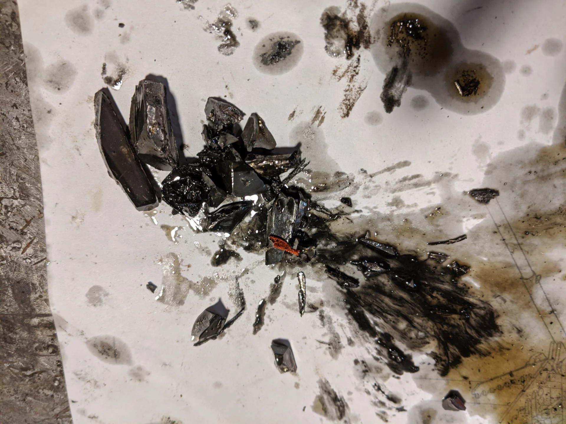

Busy day yesterday. Replaced the fuel pump in a 2000 LX that my sister bought last week, dropped the front diff in a hundred to have a look at it to see damage and put it back together. While I was sweeping the garage thinking I was done for the day my wife let me know that her battery light was on when she took kids to school. Got to replace the alternator in her GX. The diff was pretty trashed.

What would cause a diff to fail like that? I always thought that Cruiser/LX diffs were pretty stout. No offense, but that one's a mess.
Pre '03 front diffs were a 2 pin vs a 4 pin design, which apparently was there inherent weakness. Someone correct me if I'm mistaken.
This is a truth regarding the spider gears inside the carrier but the damage I see is on the ring gear so it was some sort of ring and pinion gear interaction failure.
Is the 100-series front diff reverse rotation? Going backwards with slipping tires and having one grab would do this.
@mbarela could shed some light on this subject :hmm:

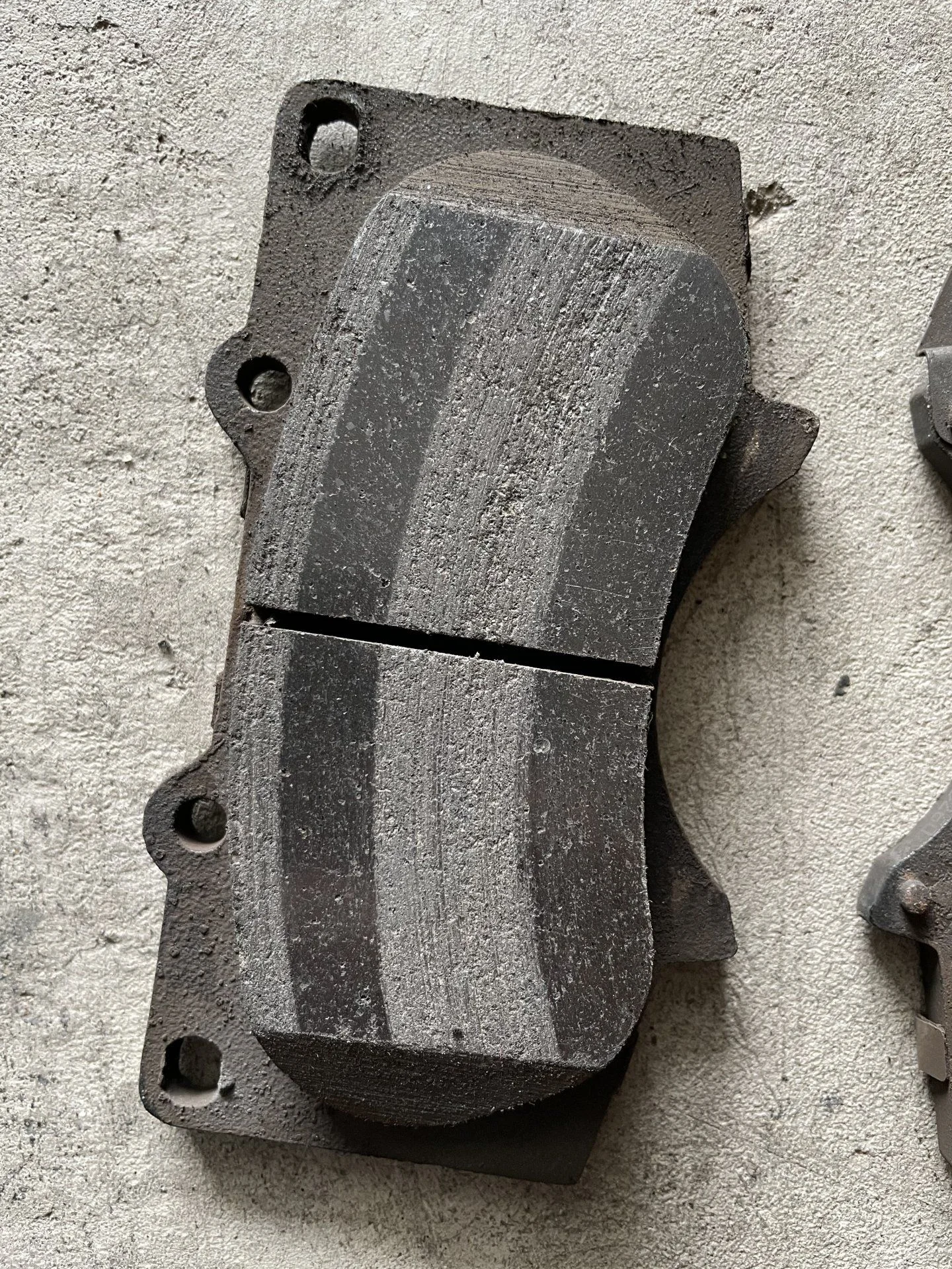

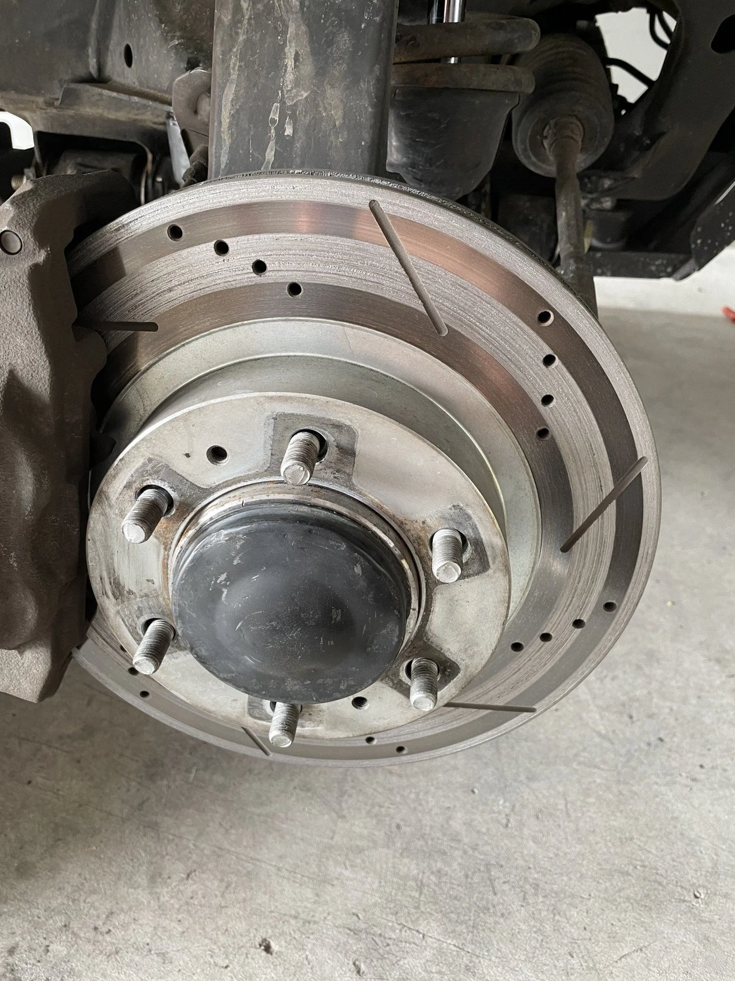

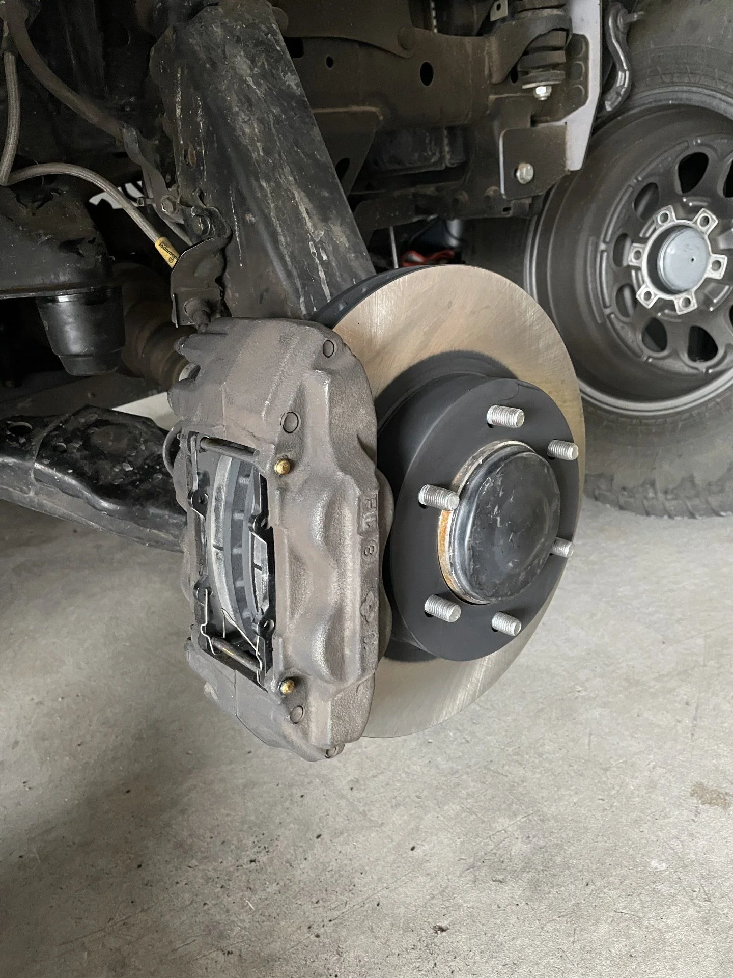

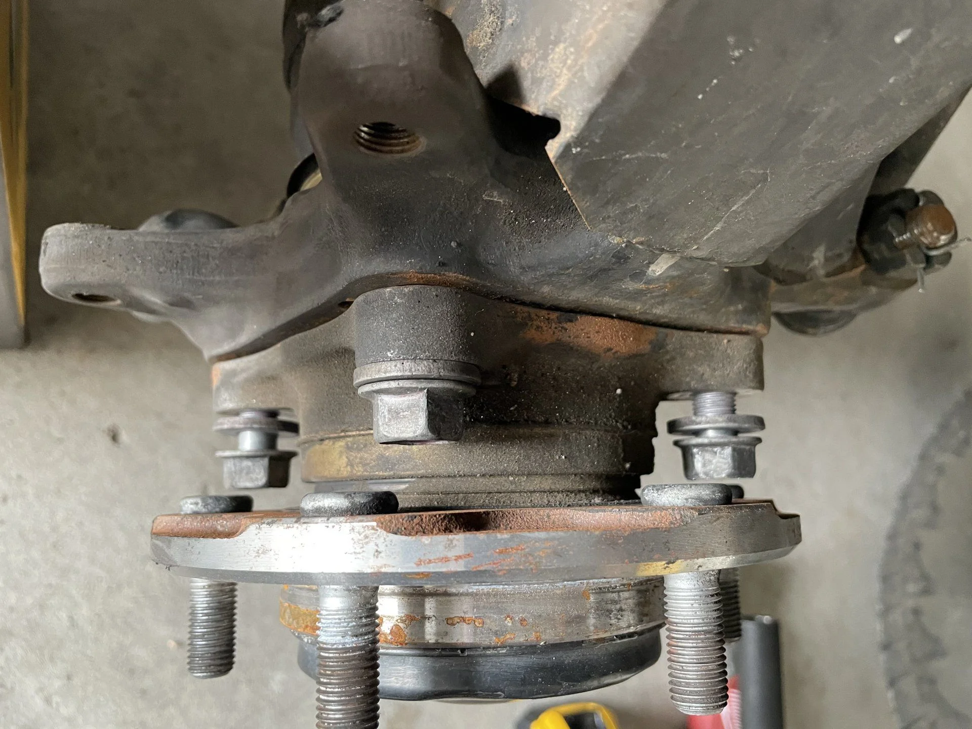

Had to replace my basically new brakes after a wheel bearing assembly got loose somehow and trashed the passenger side. Luckily I was able to grab the parts at Larry H Miller with the mud discount. Don was helpful and a nice guy.
All finished up. Before I figured it out I thought my master cylinder was going because of the hit and miss soft pedal. When the bearing would shift, the caliper would push the rotor in to the caliper wall and pedal would sink. Brakes are back to awesome!
shoot dang, you weren't able to salvage the previous fandangle rotor? Bummer.
Is one able to have those slotted/drilled rotors resurfaced? I thought no. However the pad was also bad so in my mind it’ll just ruin the rotor again.
Resurface the rotor. Replace the pads.
Not only can you resurface the rotors but you can also resurface the pads. Simply lay down a full size 8.5 x 11 Garnet sand paper on your dining table then move the pad in a figure 8 pattern. This will get rid of the imperfections and ready for round 2.
