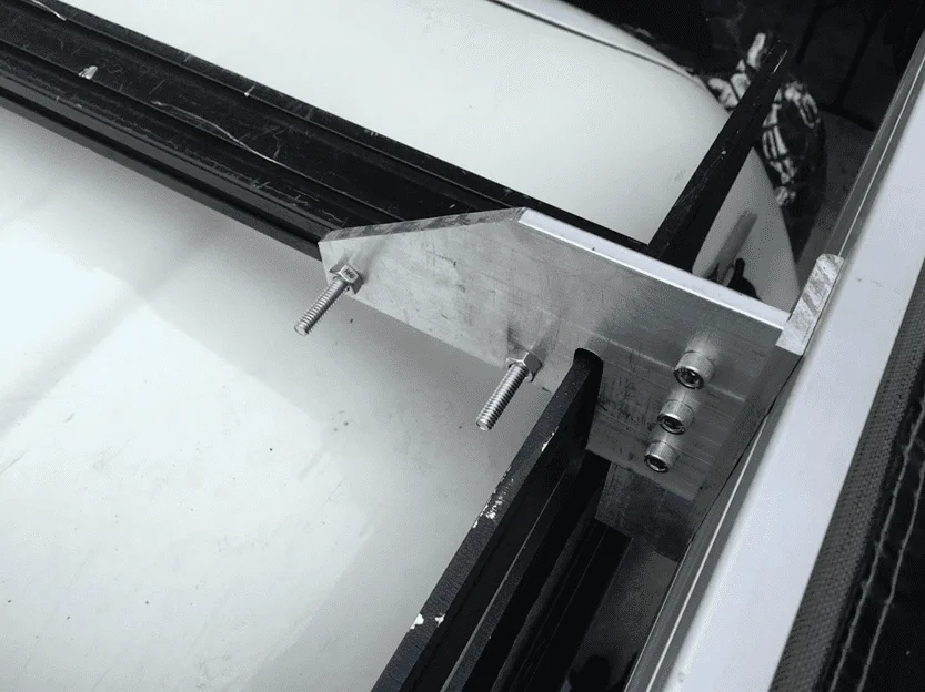

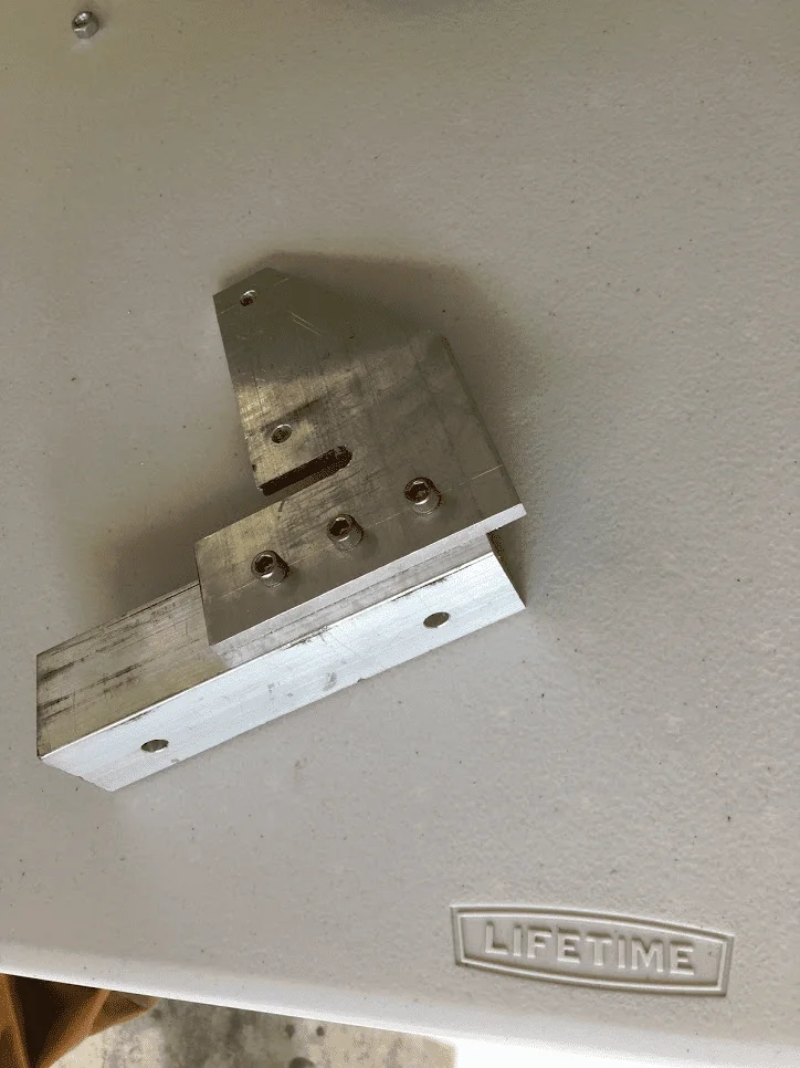

Haven't done much on the 80 recently, but I did buy a nice foxwing awning from @ajy4490 (who has a very nice 100) last Saturday and spent the afternoon getting a preliminary mount rigged up. I used some 1/4" aluminum plate and angle I had.
I made two of these:
They bolt to my Prinsu crossbars like this:

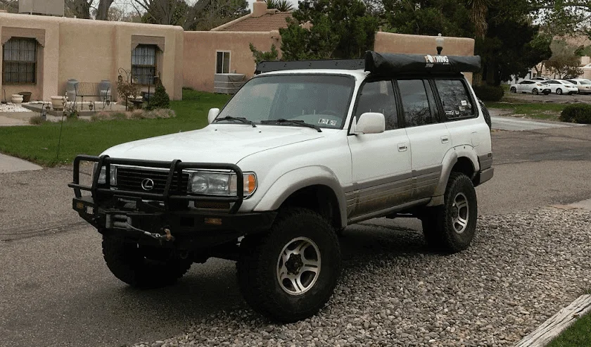

I have it nice and low, about 3/4" above the doors, and I'm pretty happy with that height. It seems to be high enough for me to stand under, but I haven't camped with it yet so we'll see if I need to bump it up a bit.
It came out pretty sturdy actually, but unfortunately I can't get in the garage now so the end goal will be to rig up a quick release with <1 min install/remove time. That will have to wait though. Looking forward to getting to use it.
for people searching for inspiration: Prinsu Rack 80-Series Foxwing Awning mounting mount

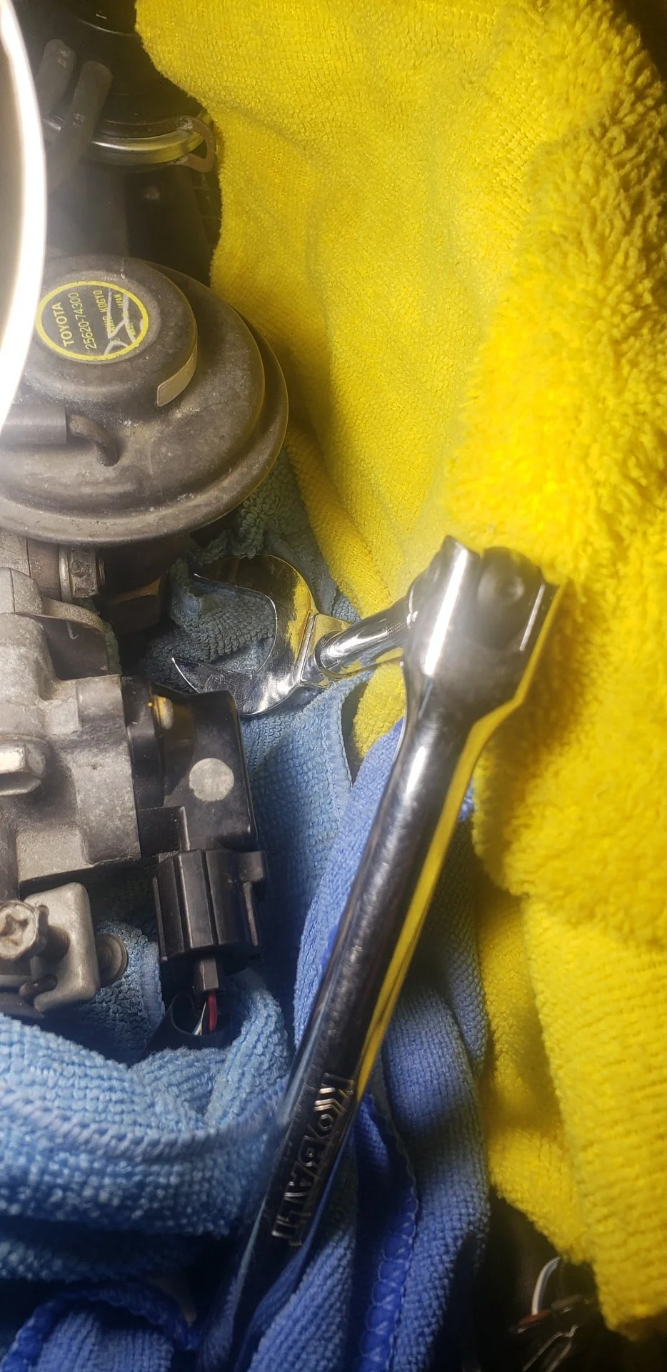

I've replaced the VSV and the vacuum solenoid on the Celica, and both Oxygen and Catalyst came back as complete during test driving.
Definitely getting MO POWA BABY and overall better operation, but intermittent poor idle (almost stall) after revving up and coming to a stop. Not all the time.
EGR still showing incomplete, and I'm hoping the valve is just sticking open a little. I've got a 24mm crows foot being delivered on Tuesday to get the old valve off. Trying to get this old girl emissions checked and registered this week. Wish me luck.

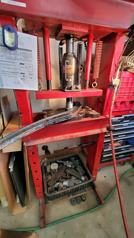

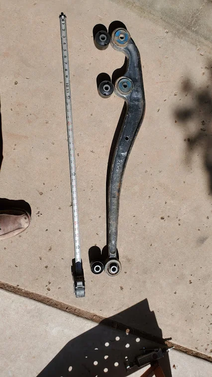

Was a busy weekend for the 80. Stabbed the third member into the axle housing, finally after receiving it from Zuk last week. After that, dropped both front radius arms and swapped the bushings with OEM.

How did you cut the alum so purdy like? I see a drill hole at the end of the slot but the edges of the slot are uber clean.
I cut the big exterior cuts on the table saw with a carbide blade. I made the slot with a jigsaw (drill hole at the end like you said) and then cleaned up with a file. I think in real life it probably doesn't look quite as good as the pictures!

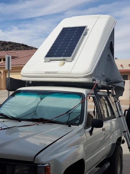

Solar on the roof tent. 100W. Not so sure about the structure of the tent. Hope it holds.

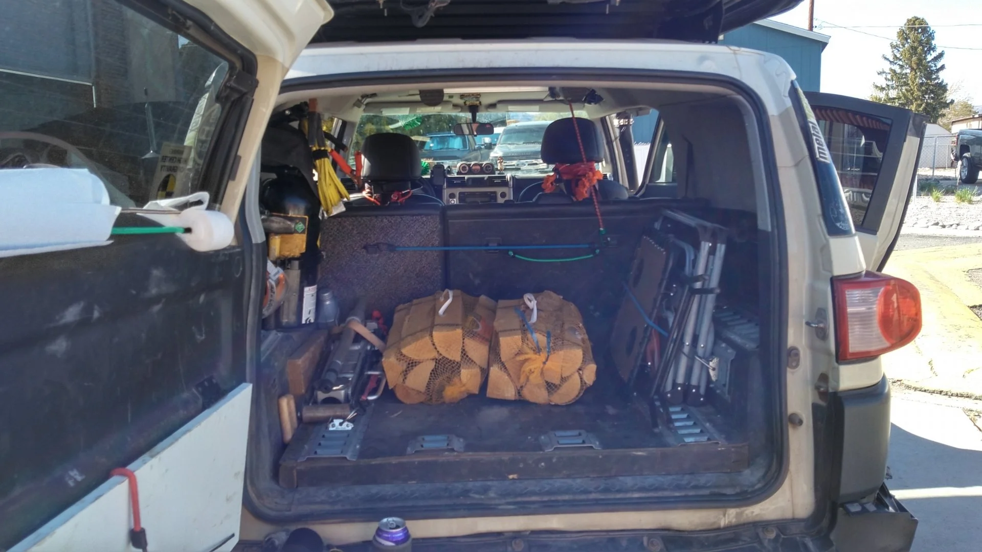

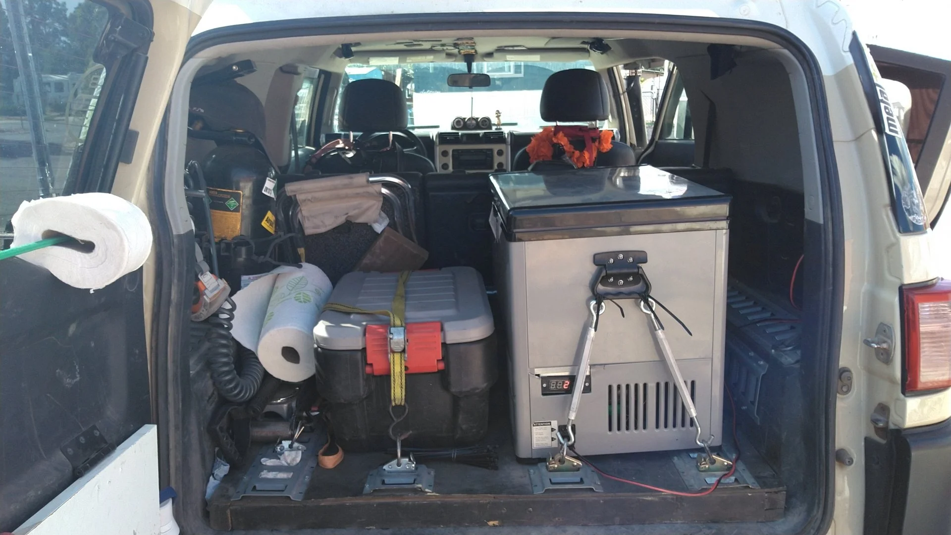

Cleared out the back. Refrigerator died (free to whoever wants it, pick up only, los alamos) so I cleaned the back out and reorganized. All recovery gear and tools that were in the container are now in bags on the rear seat floor boards and back to a cooler (for now ;) ) . Overall, trying to get back to making camping simple.
Bummer about the fridge, what kind is it?
How hard are those bushings to press out?

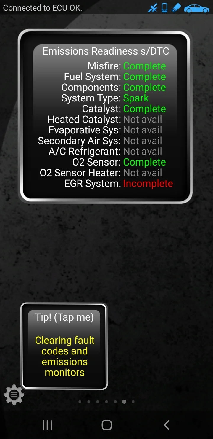

Got the EGR valve switched out. O2 and Catalyst came back testing complete again. I'm not seeing the stutter/stall I was having two nights ago, but EGR system still showing "incomplete". I'm hoping after another cold or hot start tomorrow it will finish its self test and show me it's good to go. First time doing anything like this with a check engine light.
EGR related hoses, hard pipes and passageways tend to get clogged with soot so check all of them. The EGR system usually relies on a EGR temp sensor that tells the ECU that hot exhaust gasses are in fact reaching their destination, which is usually the intake for a second pass through the combustion. This lowers NO & CO2 for cleaner tail pipe emission.
If your temp sensor isn't achieving the setpoint, then the ECU knows this and will not set the flag, which I think is happening in your case. One of the cause of the buildup of soot is that the EGR valve isn't opening up when it should so the passageways might be clogged with soot. This could be due to the vac modulator valve that operates the EGR valve isn't doing its job. So, check all that.
Your vac hose routing under the hood will show you all this. This is tedious but well worth the effort. Blow through each hoses and passageways to make sure they're clear. Often times you have to clean out passageways with a thick copper wire, like a #12 solid copper ground wire made for a house. Some folks use a tiny drill bit to clean out short clogged passageways then blow out with an air comp. The FSM has detailed troubleshooting steps for modulators and VSVs as well as the temp sensor.
