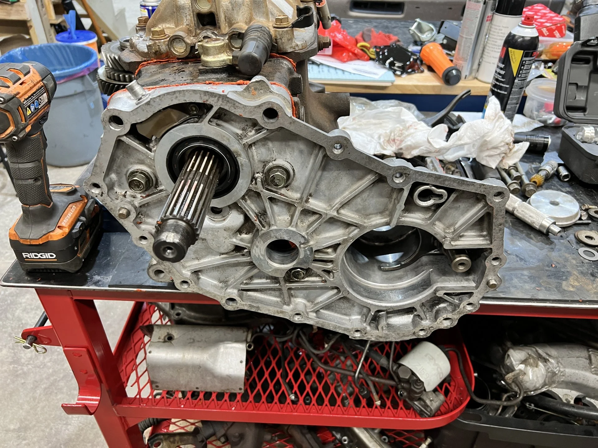

The shifter for the hi-low is has a rod that protrudes through the case. The linkage is clamped onto the end of that rod after the case is assembled. Upon assembly, you can very easily knock the shifter out of position and it will drop into the case after you have everything RTVed and bolted up. Either installed the linkage to the end of the shifter rod or put a tag or tape on the end to prevent it from dropping back into the case before you get the linkage attached. Either way keep a strong magnet handy. I can imagine it dropping even while you’re installing the clamp to the end.

Actually the way to install the back half of the case without fear of dropping the shifter into the case is to install the internal hi-lo shifter and attach the outer linkage arm and tighten it down. Of course the arm is free of the linkage. Before you install the back half of the case note how the internal linkage must rotate to contact and interface with the notch in the hi-lo shift rod. Once you have the case lined up with the idler shaft and large bearing in the upper left corner you push the case half on and rotate the shift arm into place.

After struggling with getting things aligned without dropping it into the case, this is how I decided to do it in the future. If I ever have to go back in…

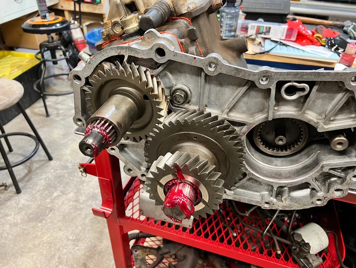

I started the rebuild on the split case for the 62. I back tracked a few times to fix mistakes and double check all my doubts.
It’s going well for my first time into my case.
