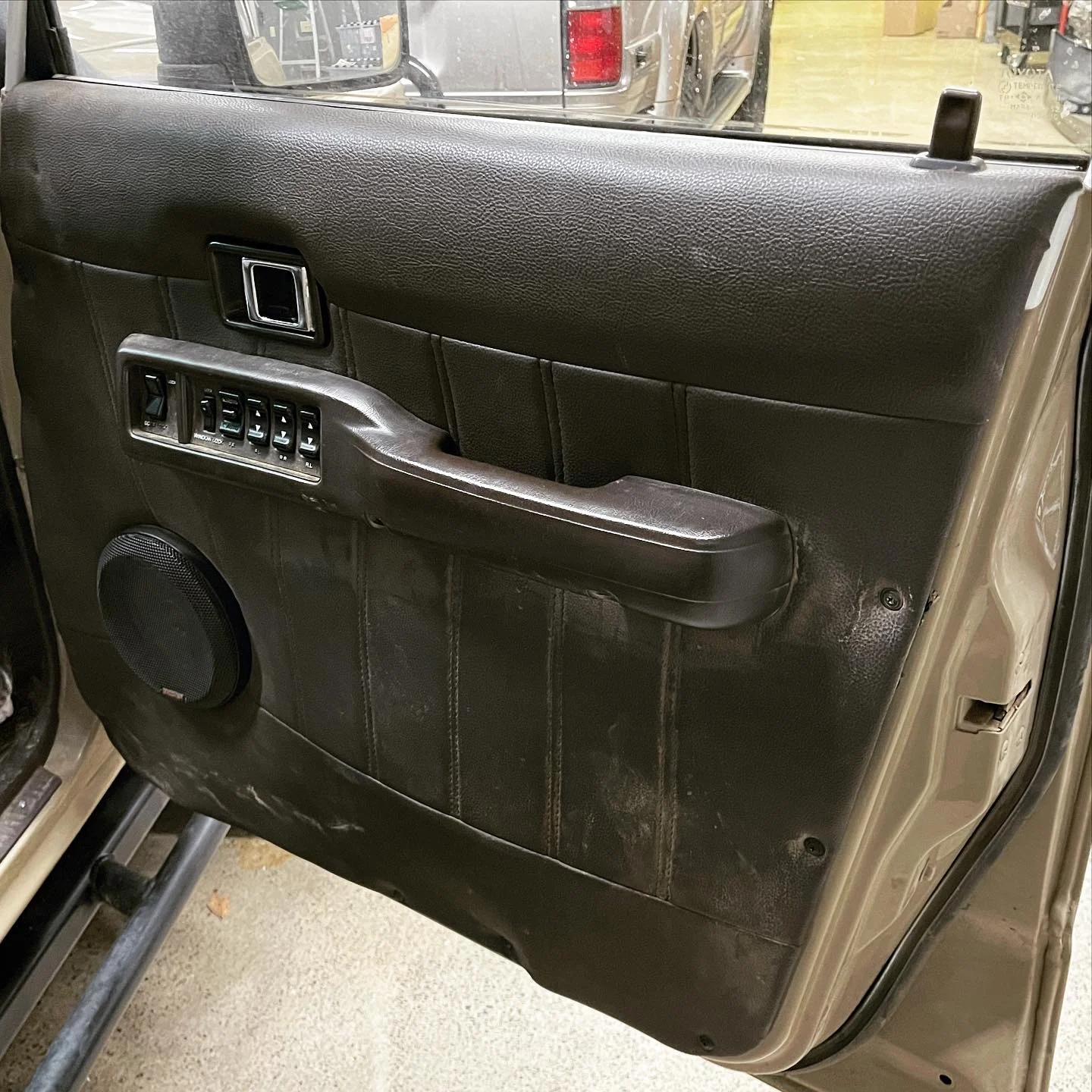

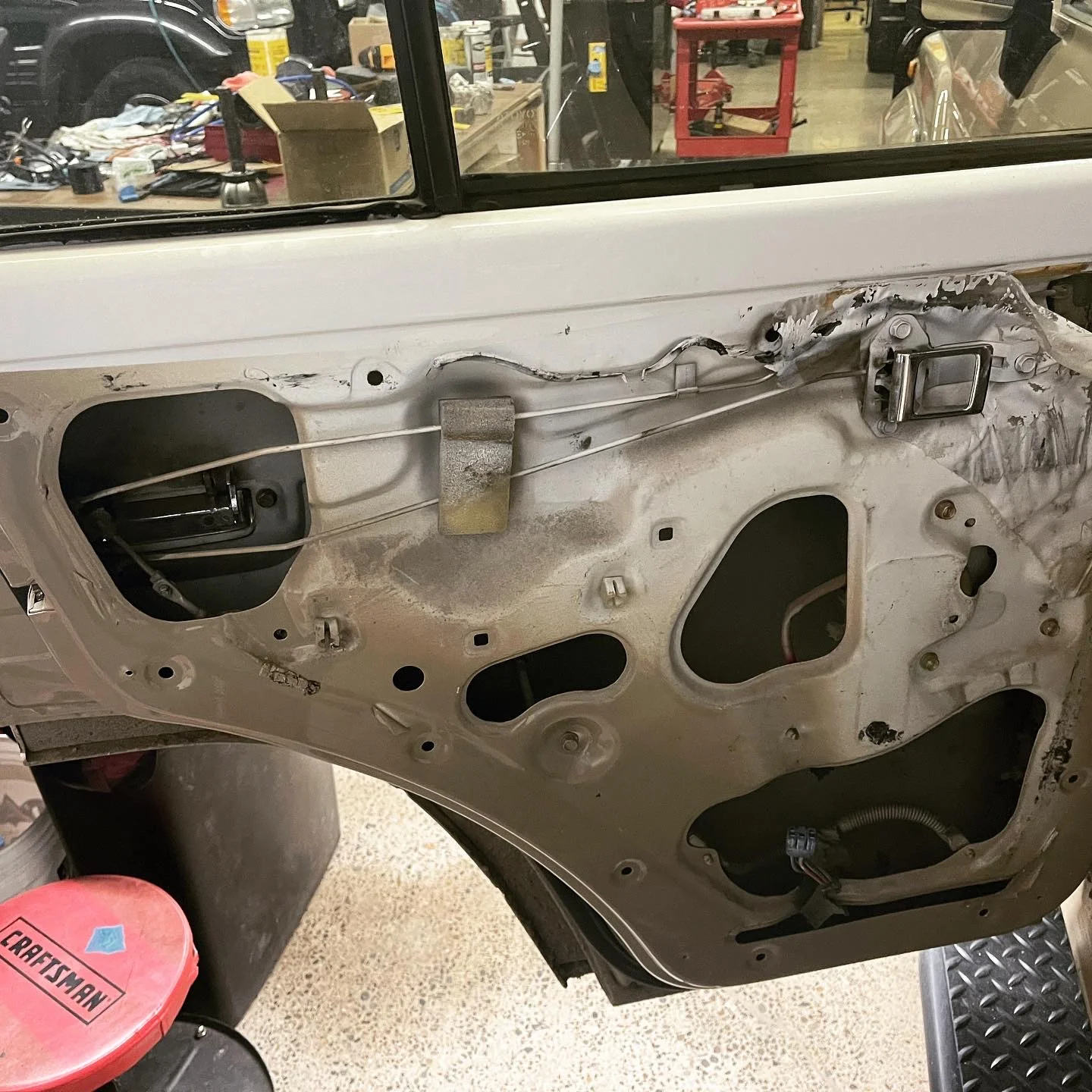

This #HJ61 deserves its own thread but I don’t have that kind of time. But it’s back for some minor nits.
It’s high 20s/low 30s here and there was heavy drafts coming from the doors. On top of that the door locks were a struggle to operate. Finally the fender flares were all falling off due to missing hardware and broken tabs.

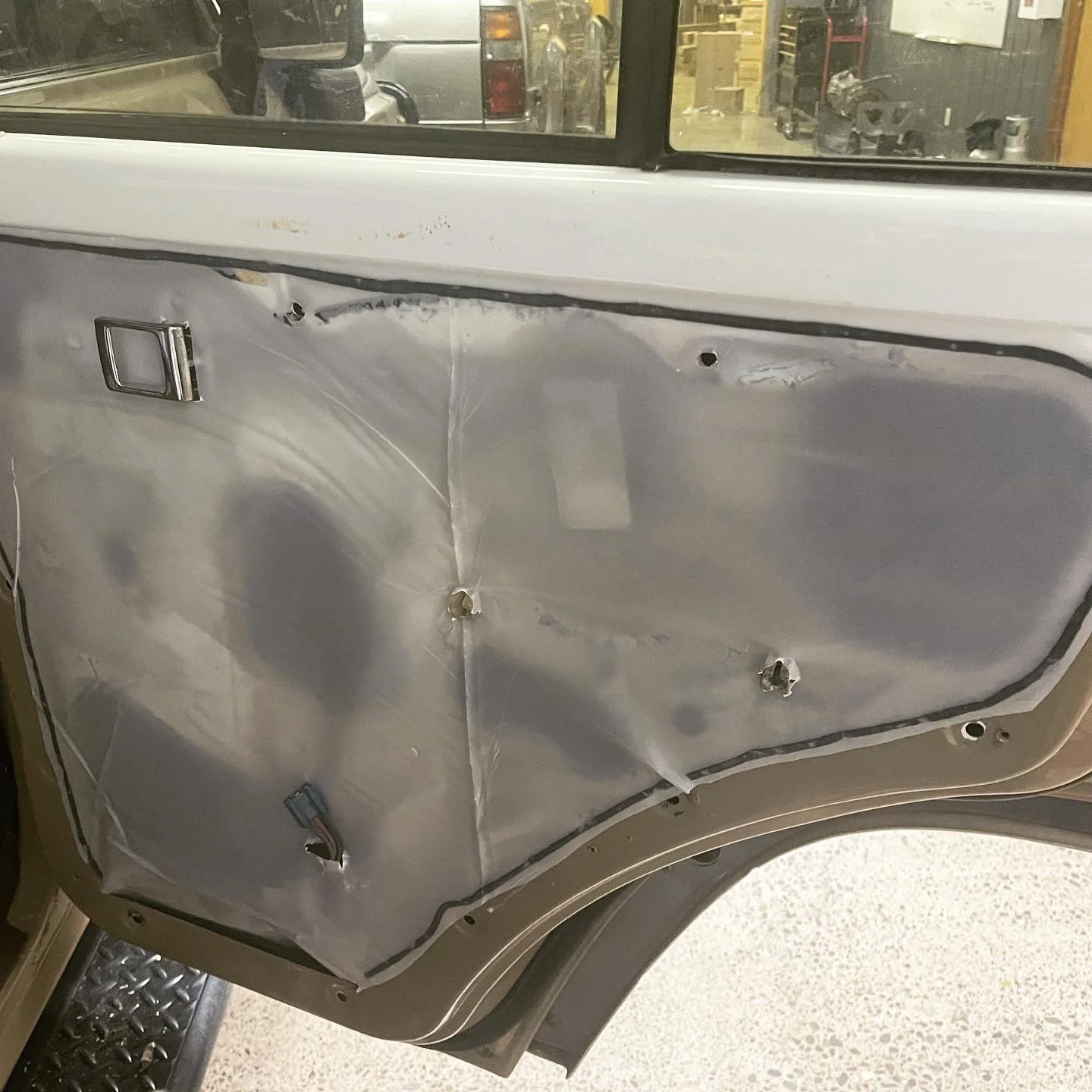

Turns out NONE of the doors had any vapor barrier. The shop that brought it into the country is a total joke. I’d be pissed if I was buying this truck from them. Frustrating.
Anyway, cleaned out the inside of the doors and cleaned all of the pivots on the locking mechanisms. They were a mess. They needed cleaning and lubing. All good now.
Seam sealer butyl rope and plastic was used for the vapor barrier.
The fender flares (so jealous) were all either missing hardware or tabs were broken. Not too many options so used strips of aluminum mesh and JB Weld and it’ll never break there again. Found some replacement hardware and it’s hood to go. Fender flares are tight, doors are vapor barrier and locks are butter smooth.

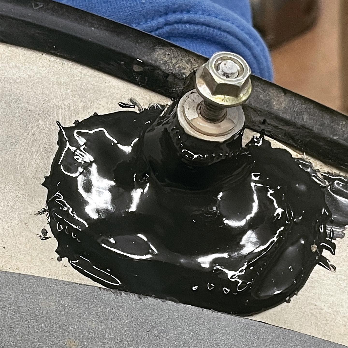

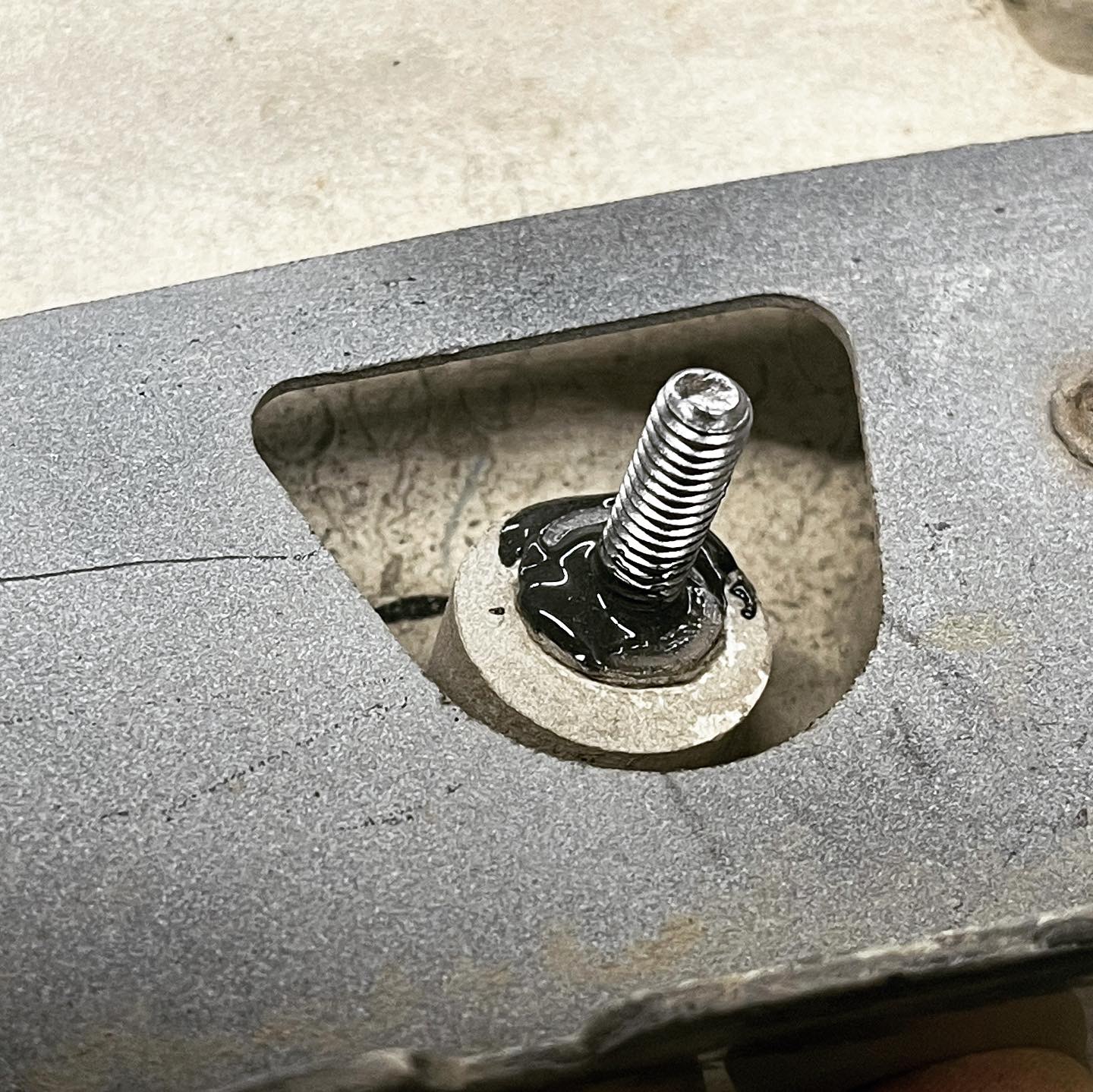

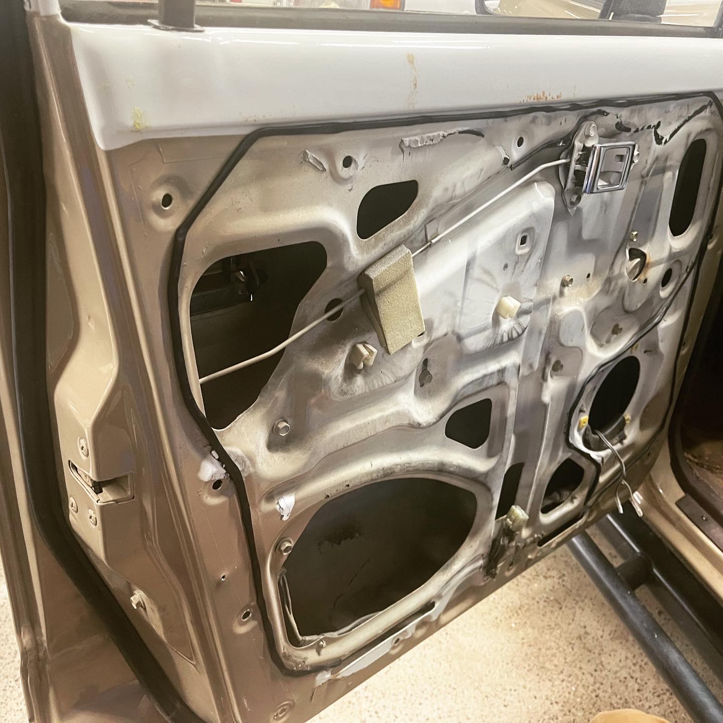

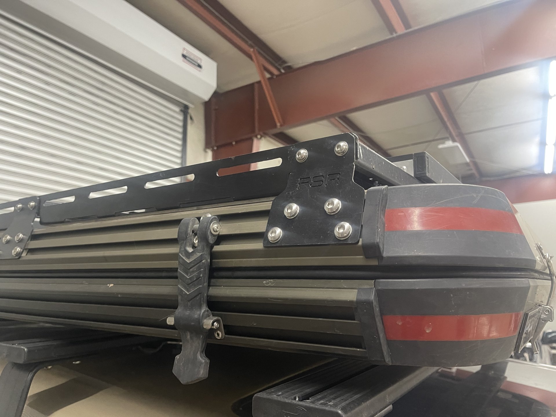

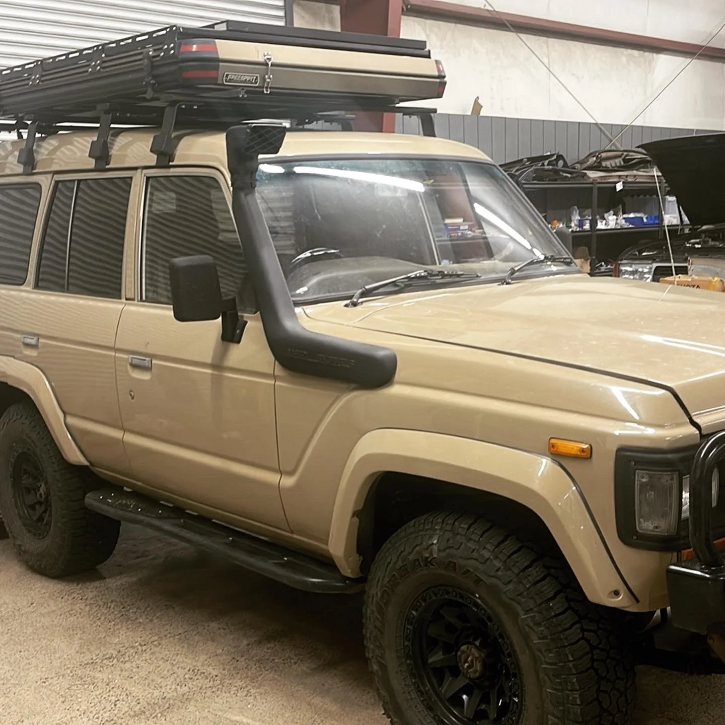

Is that a Freespirit RTT? That rack that is bolted to it is cool, any info?
Yes and the rack is Front Runner. Definitely don’t recommend the rack. I have to fix it temporarily until a new rack can be made for the high roof.
I meant the rack on top of the RTT, is that an add on accessory? I like how it's bolted to the rails.

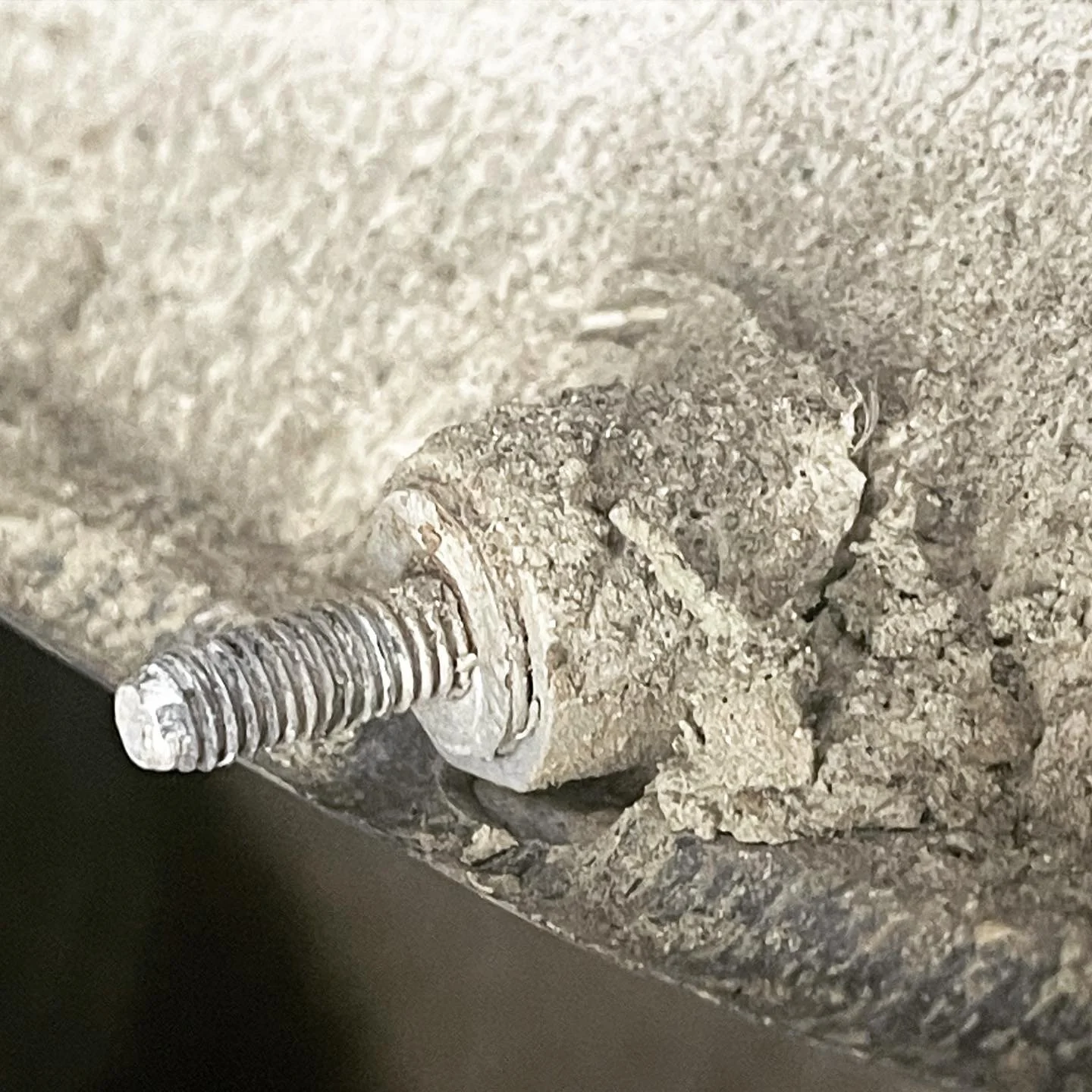

The worst thing that happened to me doing this was that all the screws snapped off removing the access plate. I still haven't fixed that or the skid plate for the same reason.
It wouldn't hurt to much to inspect the vapor separator. If it is cracked, JB weld. It's more likely cracked lines. Your fuel inlet line is likely turned to stone. Refresh the lines with fuel line and use your air compressor to find and blockages. Your oem charcoal canister is also likely defective. Most of us have either remedied it or are about to.
Oh man, that reminds me that I snapped a few of them on mine too. Dang it!
