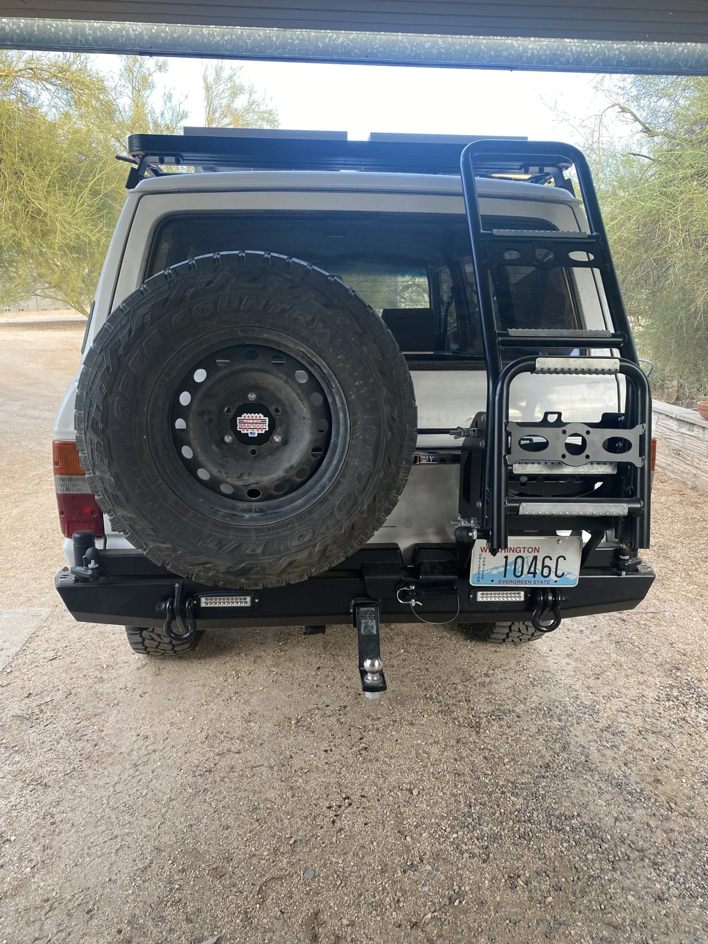

New 4Plus rear tire carrier/bumper…Dave does some great stuff!!

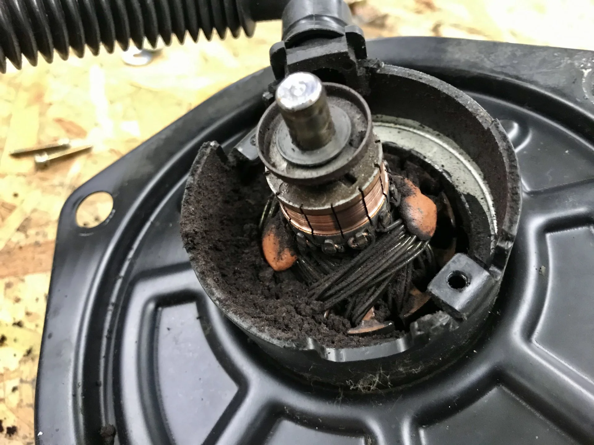

literally did the same thing just about a week ago!!
right at the end of my thread is what i did to fix it. runs like a top now
at least you’ve still got some brush material!!
if you want to replace it rock auto sells replacement ones. i got one to put on my shelf just i case my rebuild didn’t work.
Nice intel on the brushes. I found the RockAuto china motors yesterday, better than nothing right!?
Other than replacing or fixing the blower motor and installing new foam on the rest of the HVAC ducting I got these units wrapped up today.

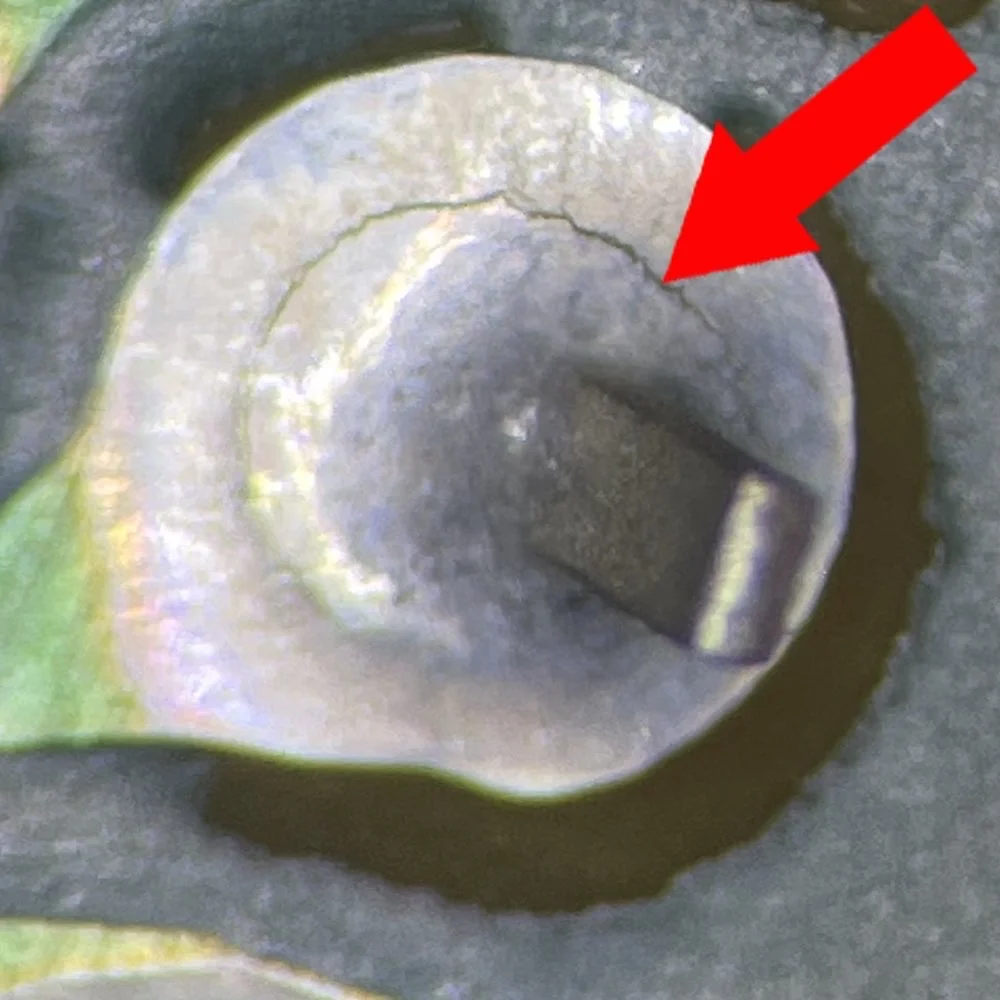

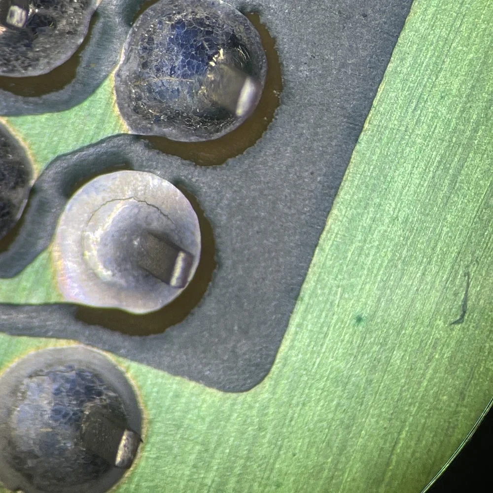

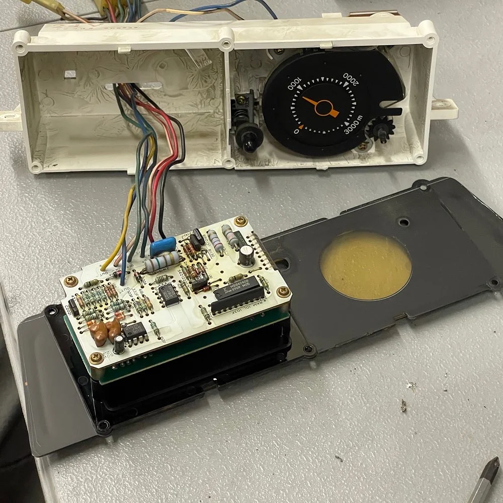

Worked on a customer’s HJ61
Ever heard of someone talking about a “cold solder joint” when referring to a circuit board or maybe talking about the AC amplifier or other PCBs in your Land Cruiser? Well a customer’s sub tank controller in the sunroof panel (HJ61) wasn’t working. Luckily I have a nice 20X microscope that we use for inspecting printed circuits and other old school boards. Most modern stuff is solid state and embedded so can’t mess with it.
But think of a cold solder joint as a literal break in the wire. No power, ground, nor communication occurs because it’s a break in the solder. This particular board had nearly a dozen. It was useless.
Fixing it requires using solder tape or a “solder sucker” to remove the solder after heating it up then resolder the joint.

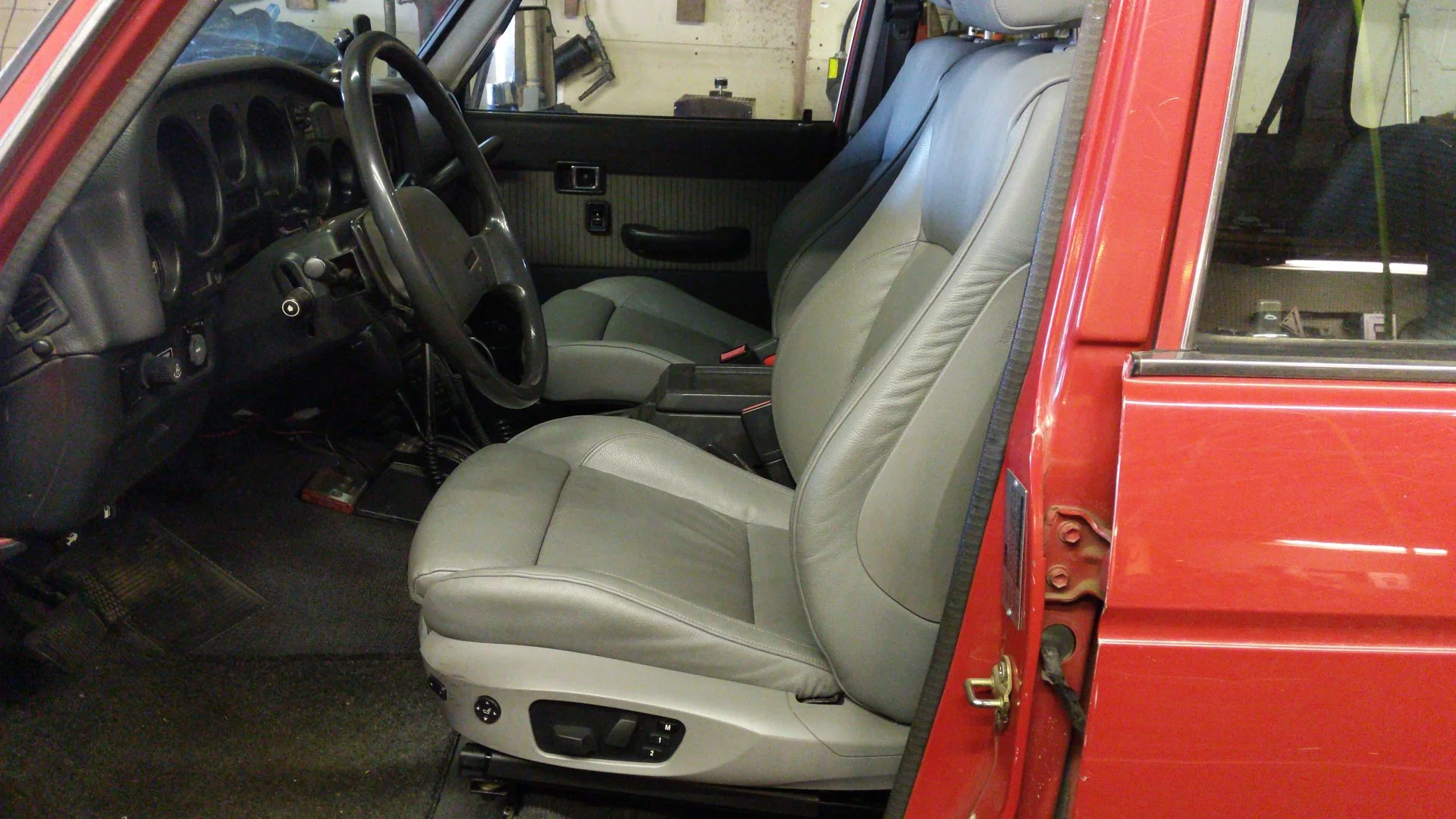

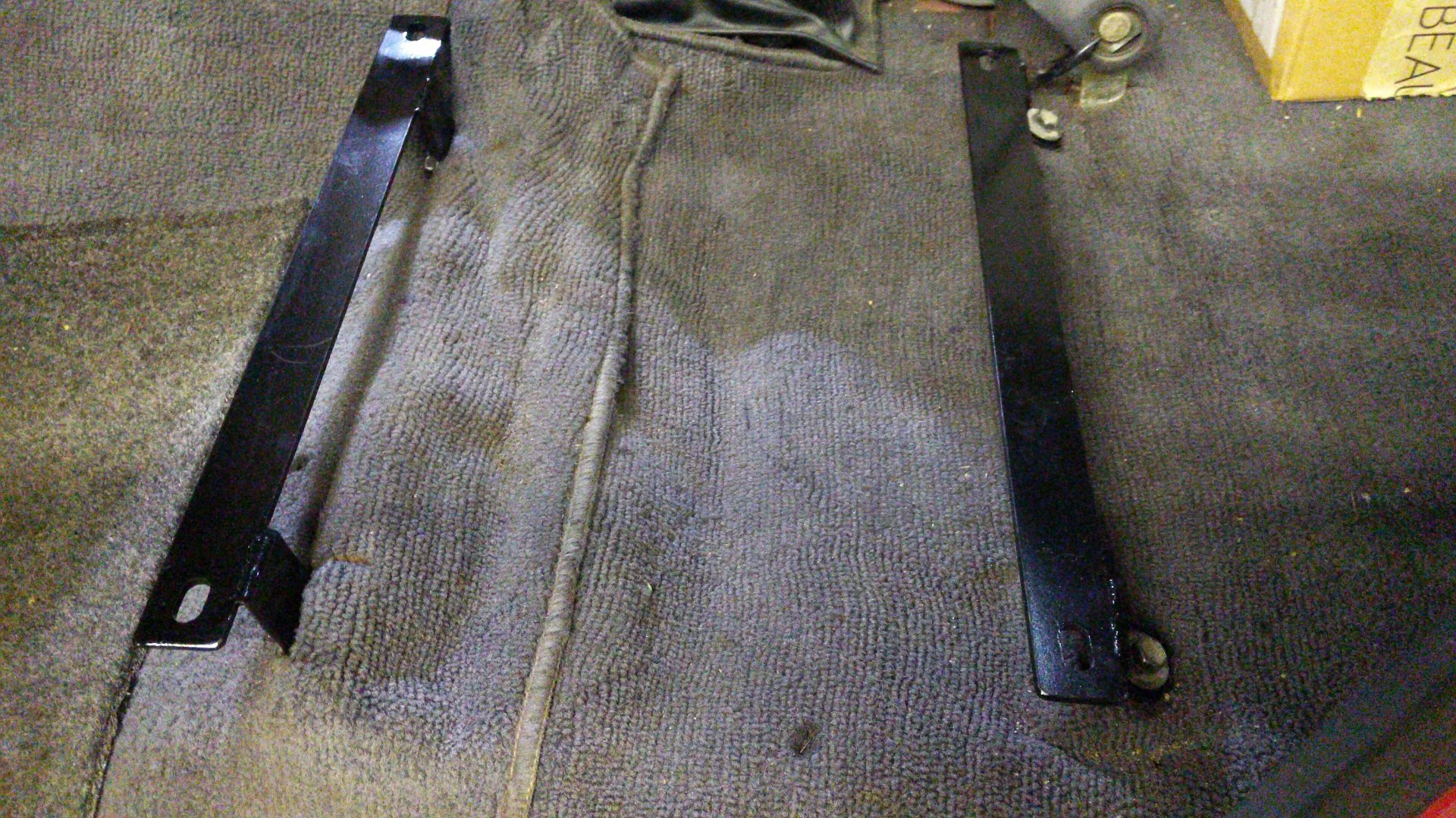

I got my BMW E90 3 series sport seats installed. I had to make brackets cause Torfab didn't have any in stock, oh well saved some money and it wasn't that hard. I have a small subwoofer under the passengers seat and it just clears thankfully.
They fit perfect and I have a feeling this is going to be one of my favorite upgrades! Just waiting for the ebay car side seat plugs to come in so I can get the electrical done. Then the plan is to have the rear seat reupholstered to match, redo the door cards, possibly make some new rear cargo area panels, and new carpet.
View attachment 2864304 View attachment 2864306View attachment 2864305
Absolutely love this look. That color match looks really close. What color BWM seats are those? I’m on the hunt for something similar. Thx.
