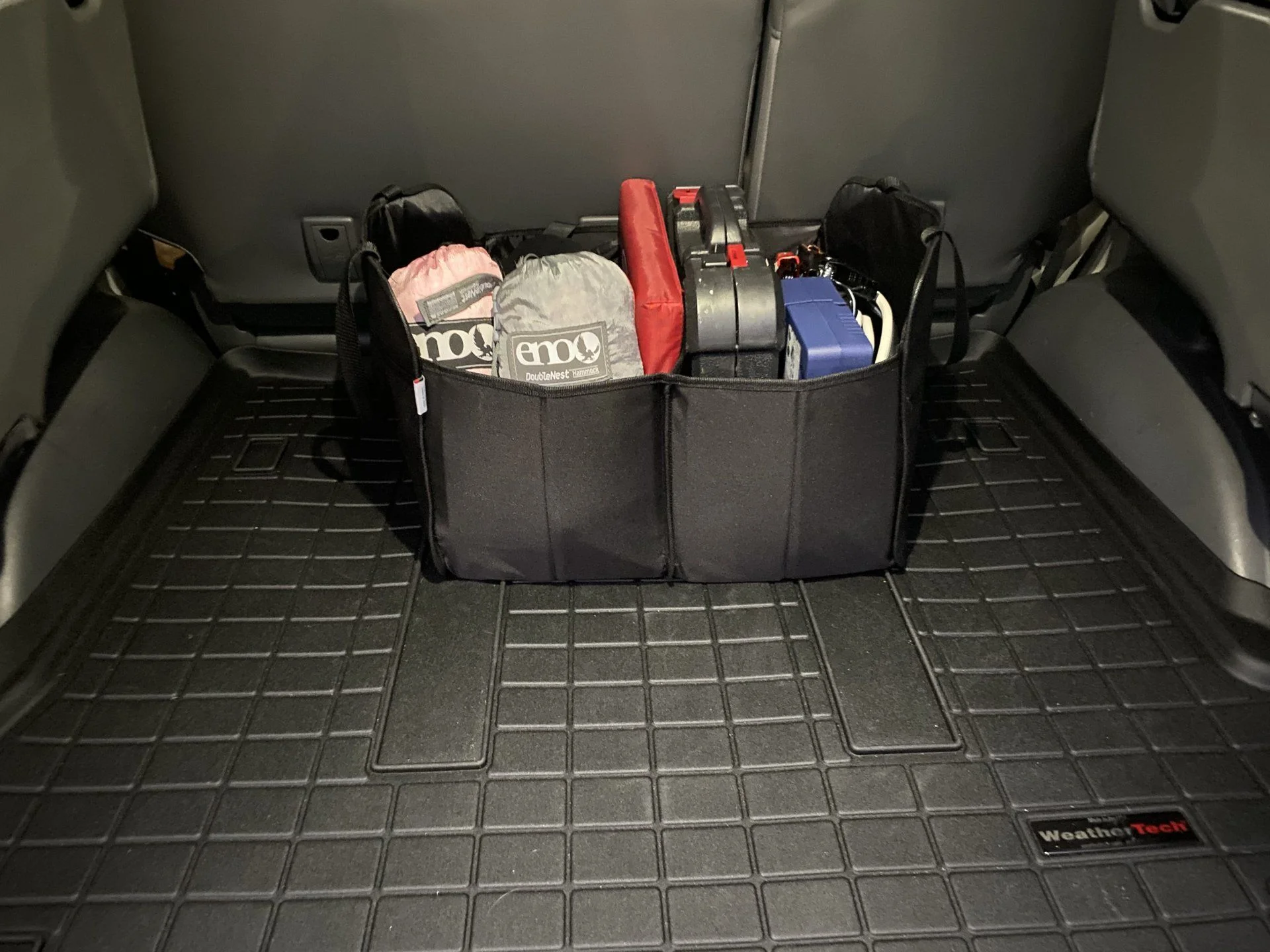

Got Weathertechs for the rear seats and rear cargo (the guy we got it from only had the front 2) don’t mind the 3rd row seats lol they will be coming out soon, we just bought this thing and I live in a smaller apartment and haven’t had time to drop them off at my dads place lol.
baby steps lol. Hopefully getting sliders this upcoming weekend.

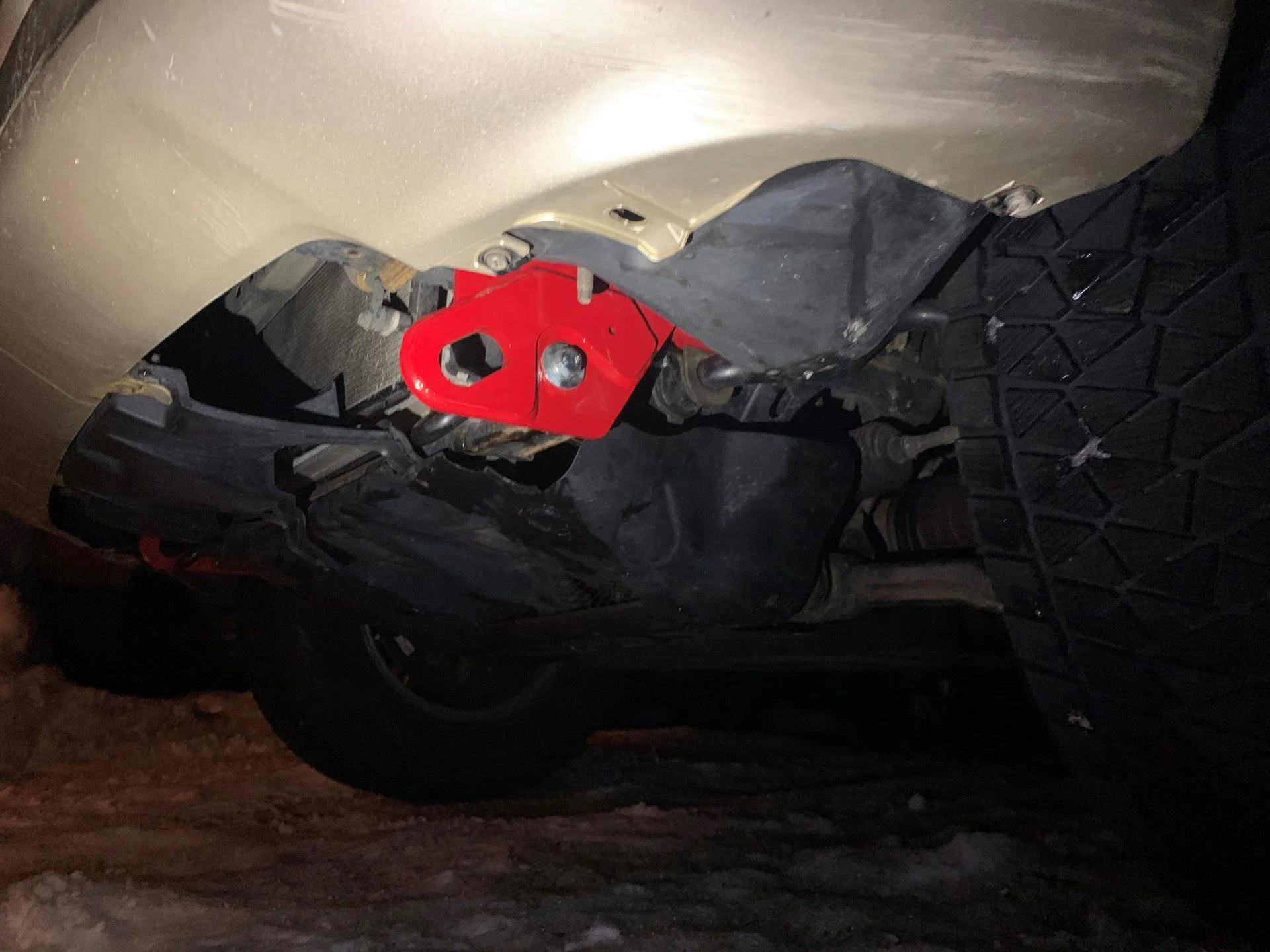

I added Apex Overland recovery points to the front. I know there is dispute as to the viability of the factory hooks on the front, but I subscribe to the "tie-down" camp and want something strong enough for hard pulls.
The melted pit under the truck made it easier, but also wet and cold to lie under there for a while... A garage would be sweet. The recovery points mount at 4 locations on each. Two beefier bolts replace the sway bar bracket bolts:

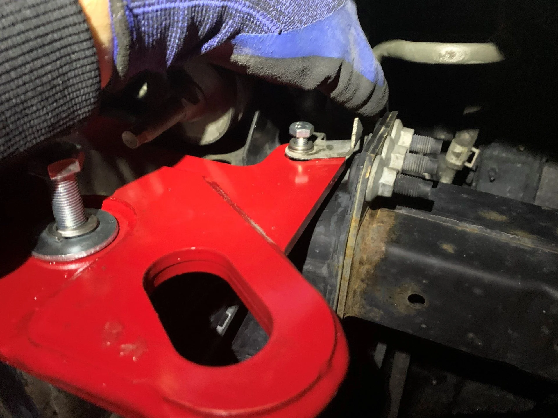

These were serious to get off with just a ratchet. I don't know if that's normal for the sway bar bracket bolts, but even after breaking them free, they fought the whole way out. After removing those, you use the large, empty threaded hole with an included 19mm bolt and reuse the higher bracket thread hole with a new larger 14mm bolt.
Note that the new bolts are larger than the stock bolt for the bracket and the sway bar brackets. This means you'll need a smattering of sockets/wrenches to remove them and then bolt on the larger sizes. I made the mistake of sizing sockets to the new bolts, and promptly rounded off the first sway bar bracket bolt by putting too large of a socket on it. They aren't the same.
I obviously haven't had the chance to really test these, but they look and feel fall more solid. And they look slick. Let's be honest, that's half of why we do this!
I had the same experience installing these on my truck. The sway bar bolts and brackets were the only difficult part but everything else was easy
Everything else was pretty simple, I agree. It's a good kit. The only other problem I had, which I think was specific to my truck and why I didn't mention it, was the skid plate. It's my understanding that the skid plate has small hooks on the front edge that allow the skid plate to swing down after removing the bolts. Well, somewhere along the way, mine got bent/broken (probably from impacts) and my skid plate didn't swing so much as drop directly onto my face in sub-freezing weather. That sucked.
For anyone interested in these points, the kit from Apex Overland is great. Just be ready to muscle off the sway bar bolts, and do yourself a favor and double-check you skid plate contact points.

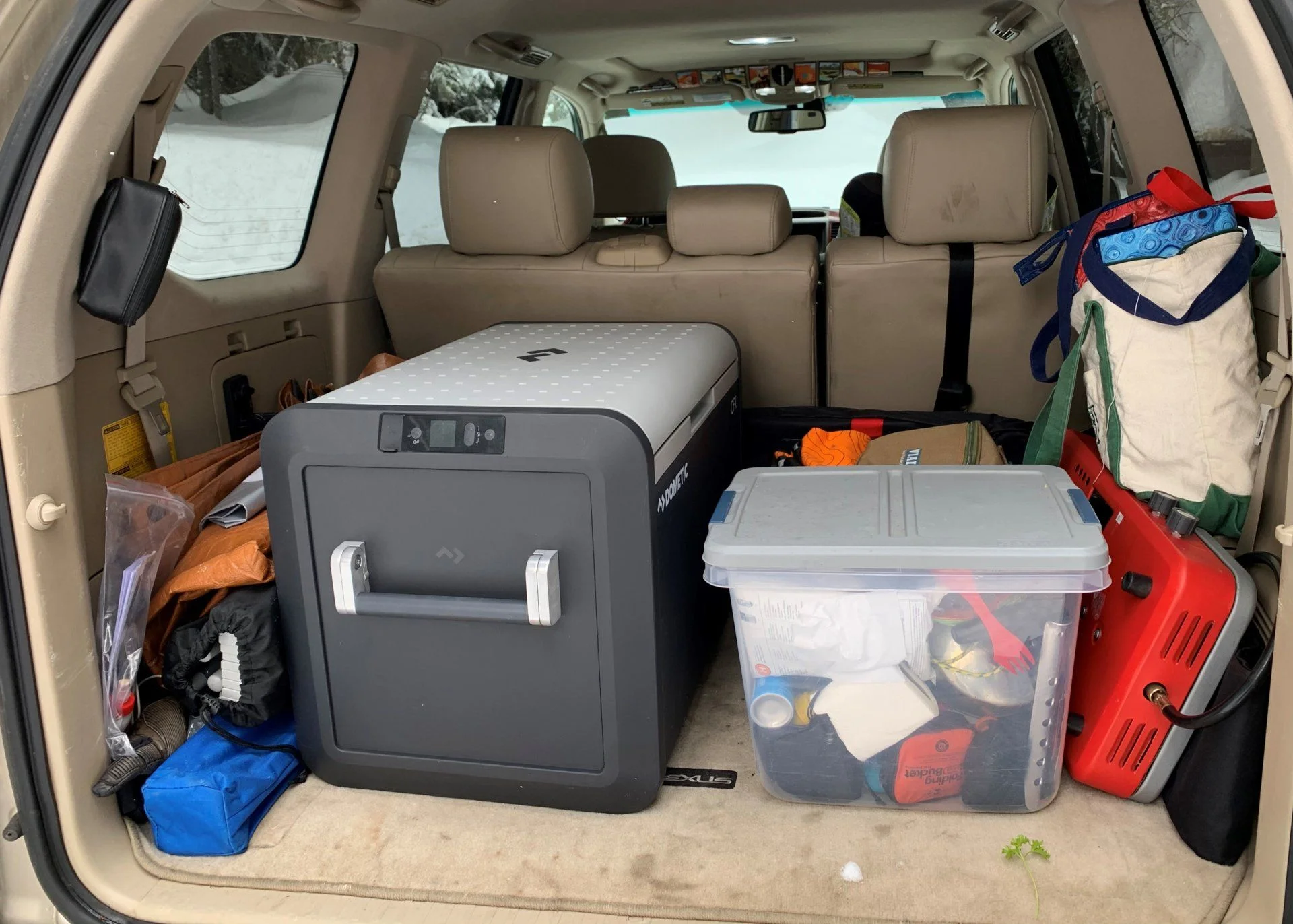

My Dometic CFX3 55im Fridge/freezer arrived and works great off the Blue Sea panel in the back. Next step is swapping the starter battery for a X2 AGM, and then building some drawers and a proper enclosure for the fridge. Between trips, it'll be a backup chest freezer for the house.
