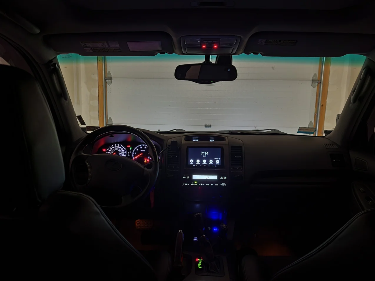

Love a clean OE+ look.I ditched the column mount for my SG2 and installed it in the overhead console with this new mount I got from ben3dbuild on Instagram.

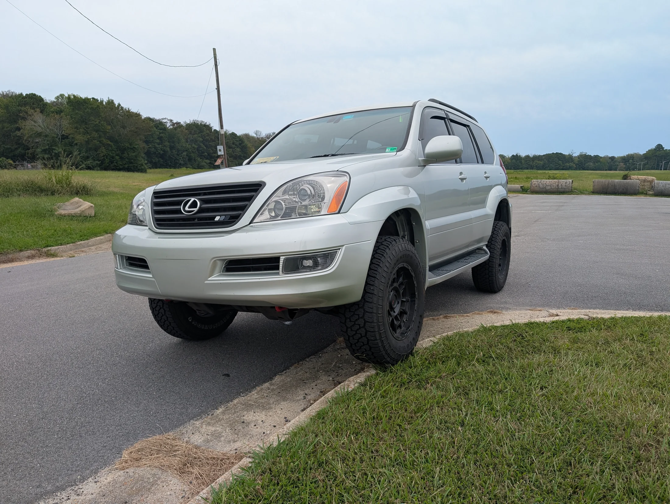

Don’t forget your post check ride re torque. I only did visuals along the way and lost a shock bolt on the rim rocker trail a 1000 miles from home.Finally installed a two inch lift that's been sitting in the garage mocking me for the last few months and a few other bits to round out the weekend. Made sure to take it off road to test. Those Home Depot parking lots better watch out!
And don’t forget to carry spare bolts, nuts, and bushings for various suspension components. They seem to disappear sometimes on hard trailsDon’t forget your post check ride re torque. I only did visuals along the way and lost a shock bolt on the rim rocker trail a 1000 miles from home.
I gave all the hardware I touched a wrench check yesterday but will do it again when I get home from work this afternoon. Your post from when that first happened to you prompted me to put a dab of blue Loctite on my lower shock bolts.Don’t forget your post check ride re torque. I only did visuals along the way and lost a shock bolt on the rim rocker trail a 1000 miles from home.
