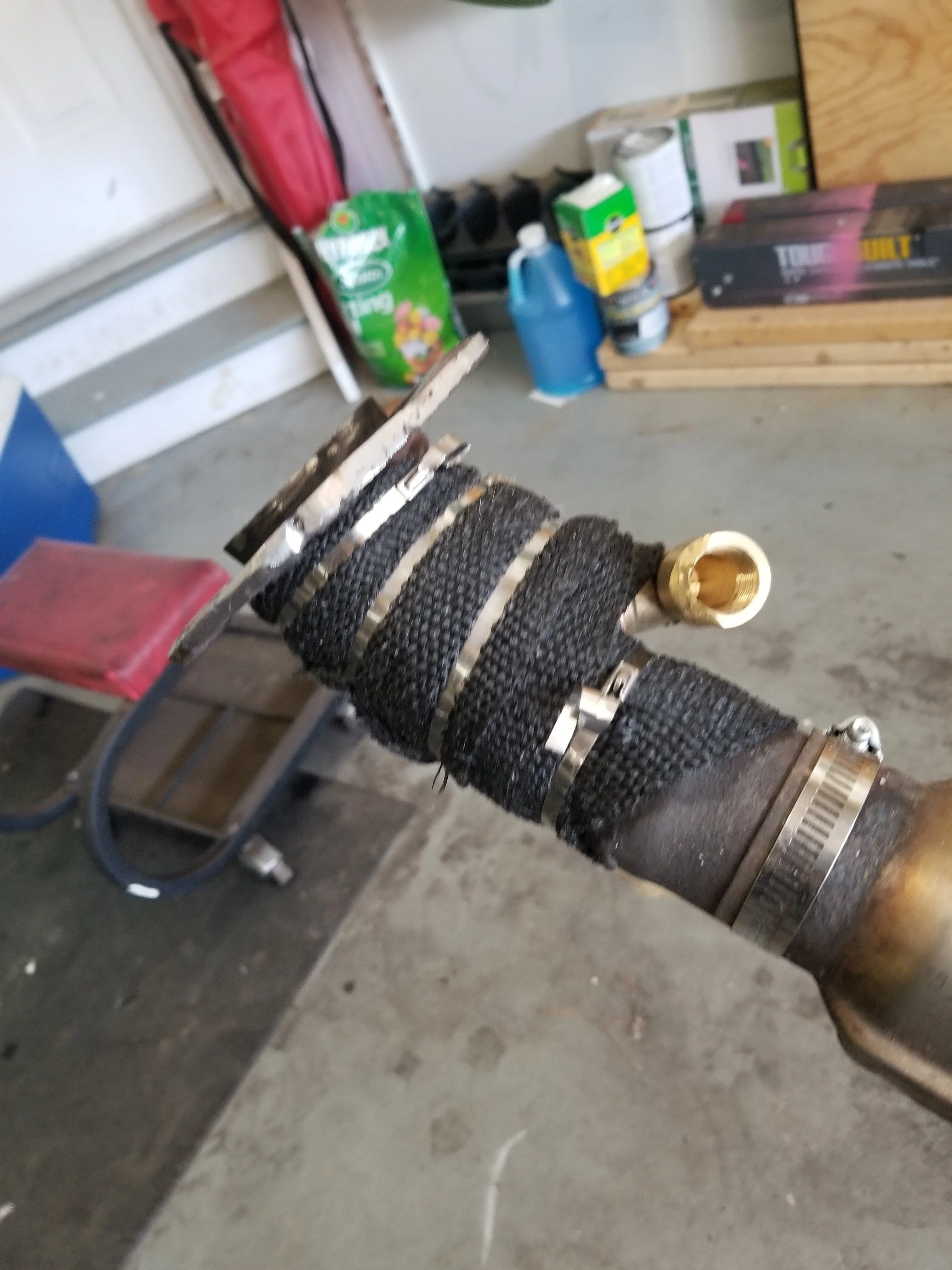

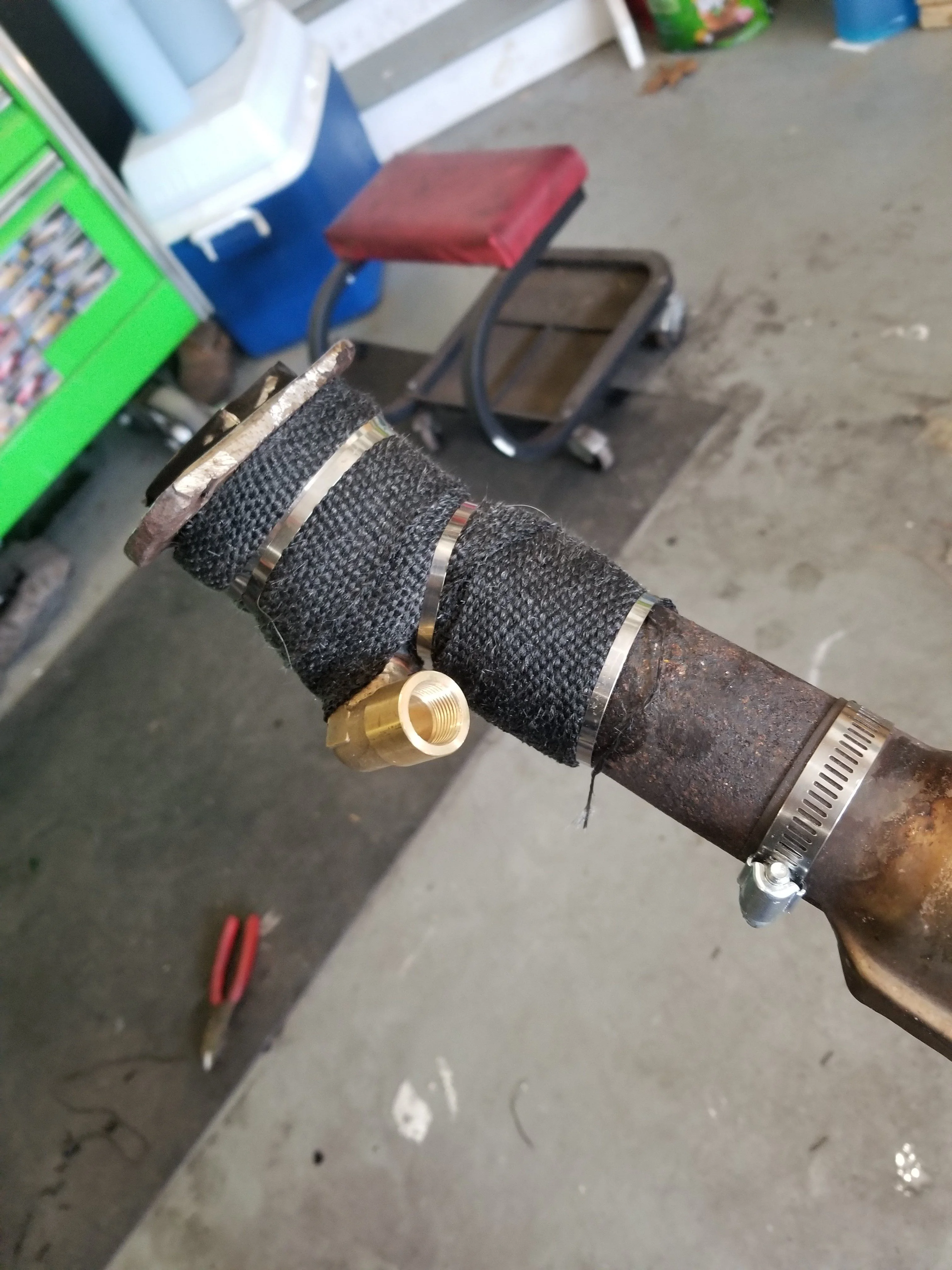

First was fixing the exhaust that the previous owner screwed up, mind you Woody and I didn't make it much better but it doesn't leak now!
Woody welded what he could up on the thin metal but there was still a pin hole in each side. So I added some metal putty and then used some exhaust wrap I had to really make sure things would stay in place.
We also installed some o2 sensor spacers due to the fact that the converter material was long gone.
I will spare you how the flanges that everything mates together looks, it's not pretty, and not my best work, but it doesn't leak so I will take what I can get.

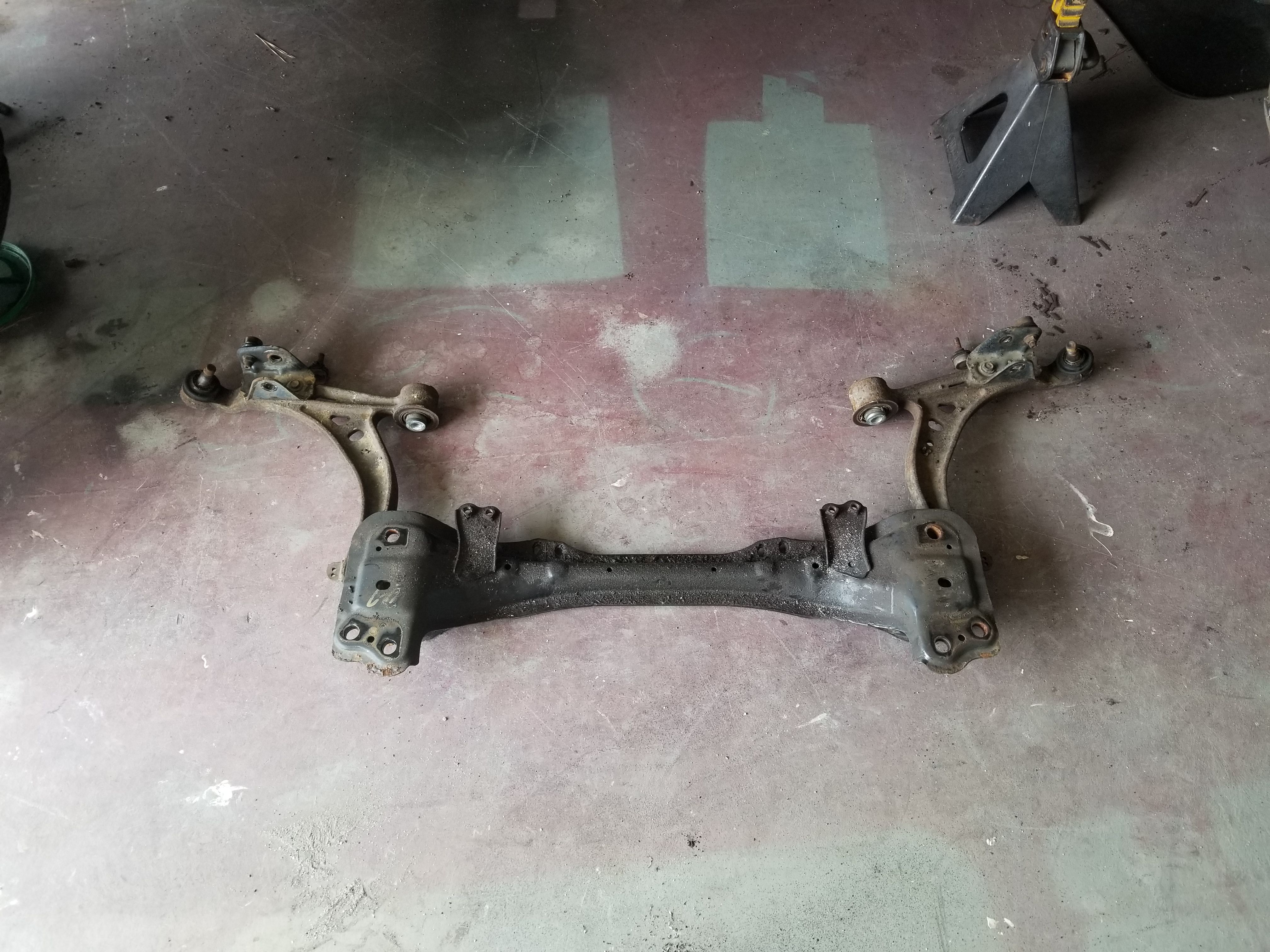

Now that it runs.... again... Its time to make it so it can actually drive down the road. The front lower control arm bushings are shot. and in typical Toyota fashion, the front eccentrics were fine and fell right out, the rears with the bad bushings were seized in place, like on every IFS truck I have worked on... I tired to get in there with a sawzall but was having zero, but cool feature, the cross member that the rear of the arms bolts to comes out, because that is all it holds, I wish the 4Runner was like this -_-

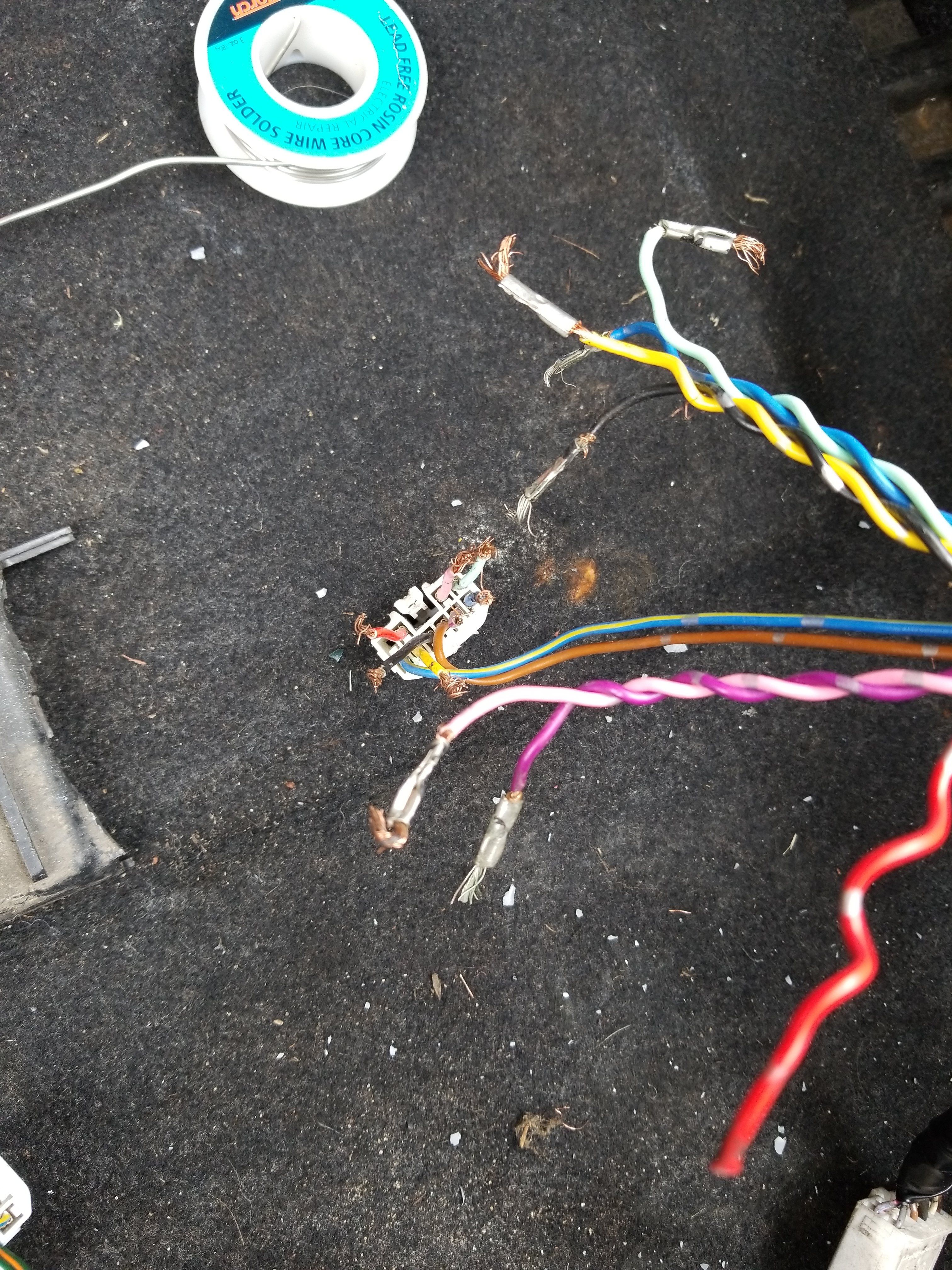

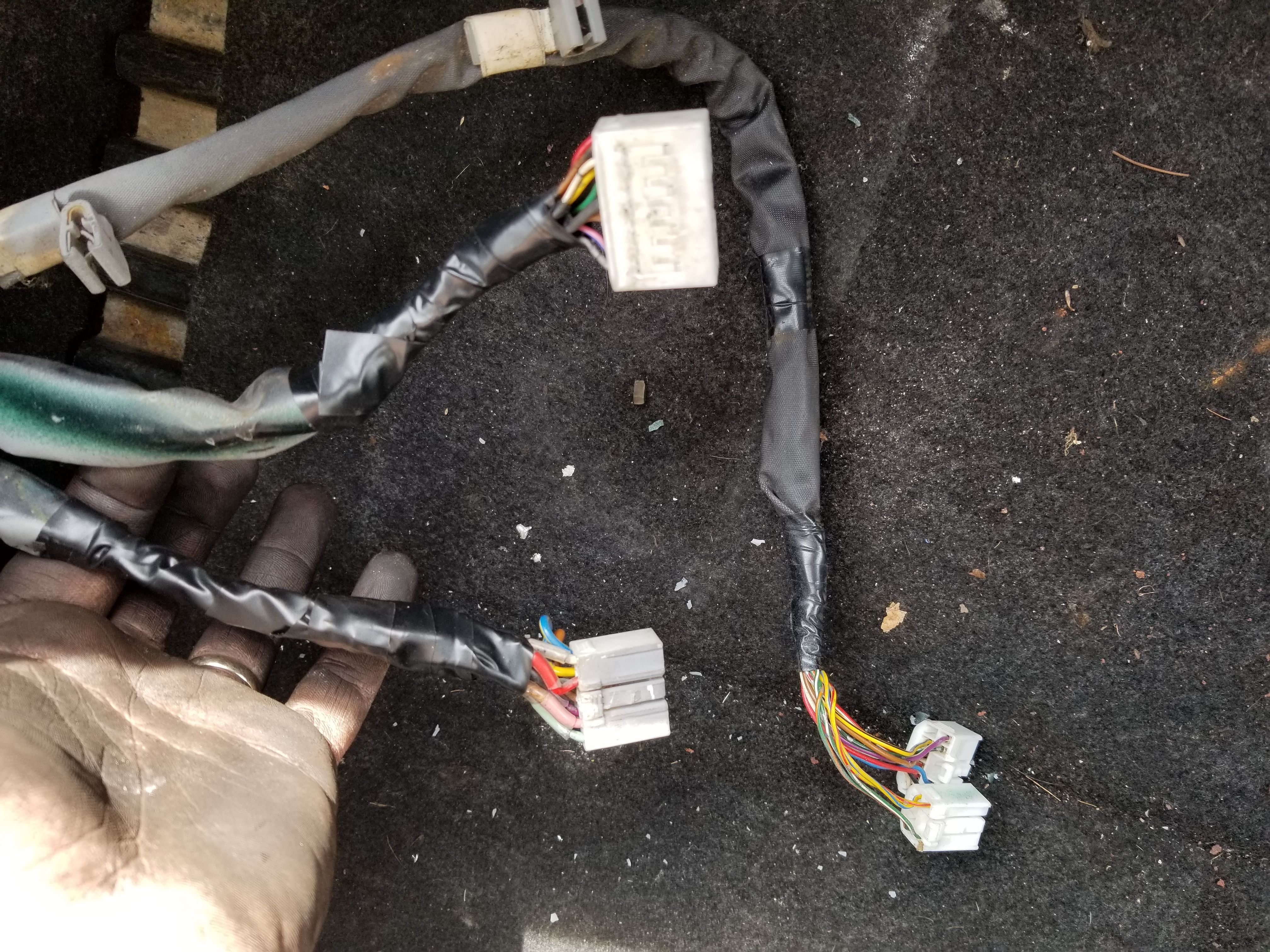

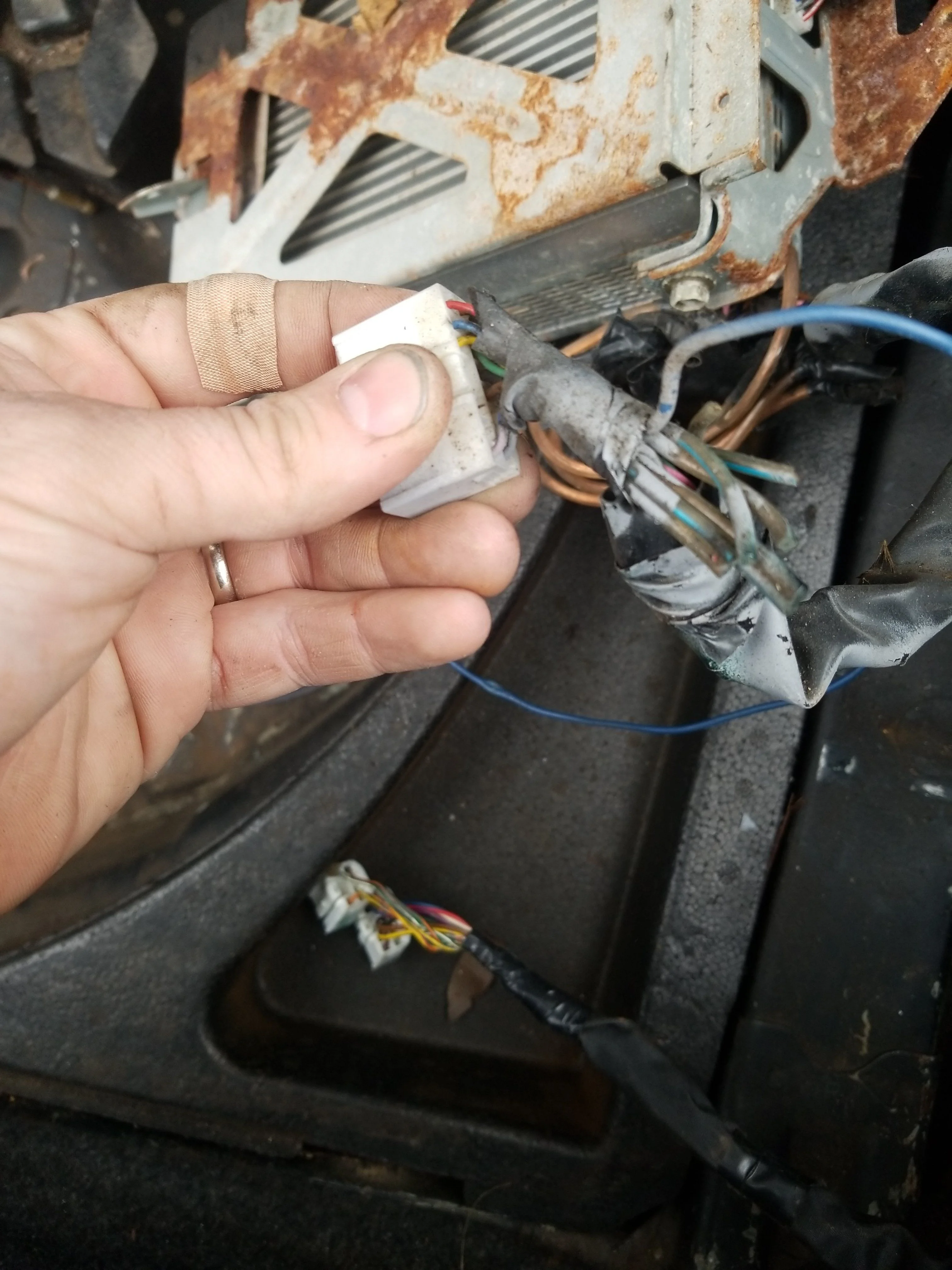

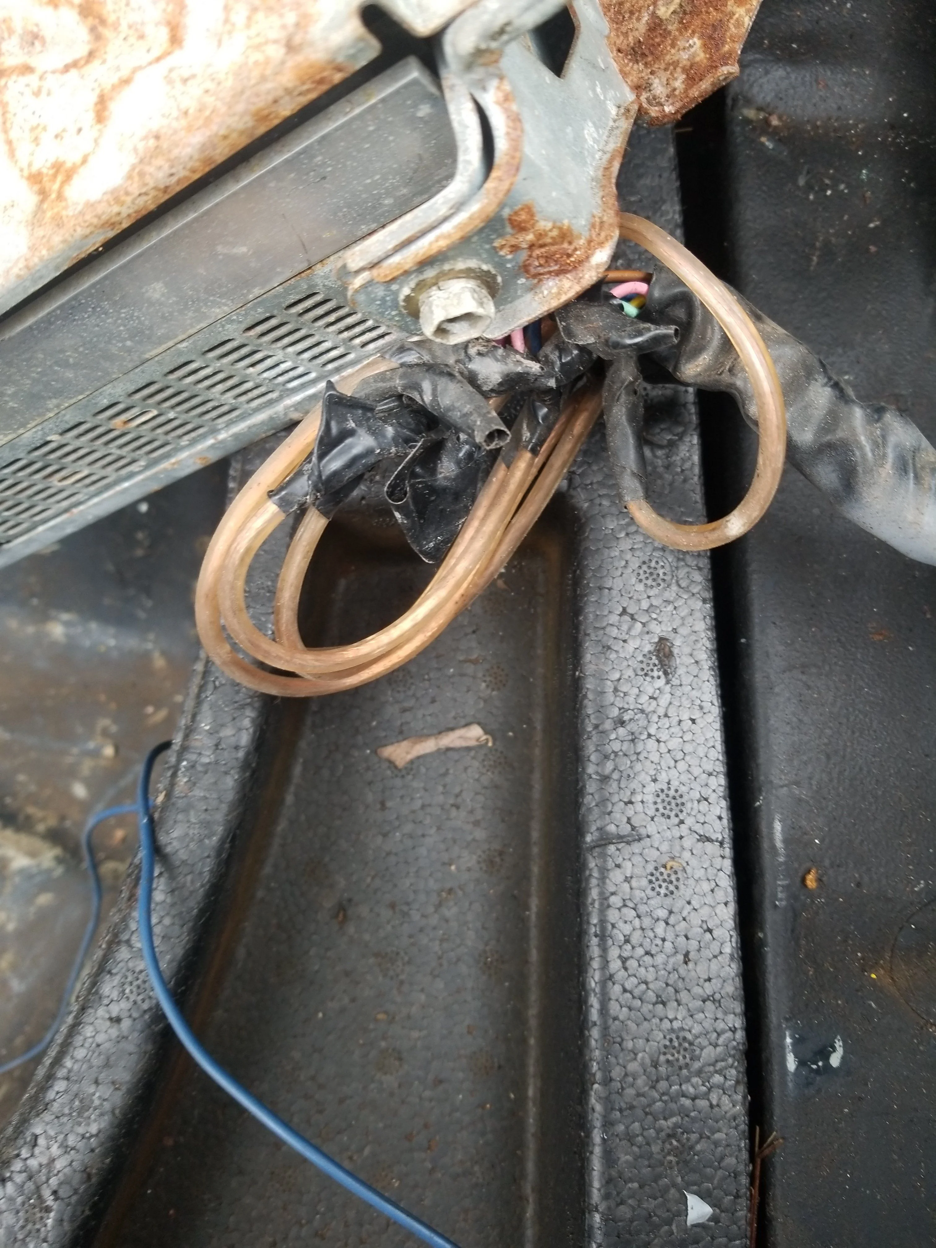

While I am waiting for eccentrics to arrive I thought I would tackle the radio situation, since one did not come with the car. I figured I would go back to stock since I didn't want to mess to much more with the wiring in the car and since apparently I have the most optioned out version of it, requires wiring I don't want to get into to put an aftermarket unit it. I scored a stock unit and put it in, replaced fuses but they popped instantly. I start tracing wires and find this mess in the trunk where the factory amplifier is. Some people just need to put their tools down, turn around and slowly walk away.....
I became a little productive this weekend. Some success, some failure, figured if I got moving I would get the ball rolling.
First was fixing that shottt wiring only to find the amp is shot.

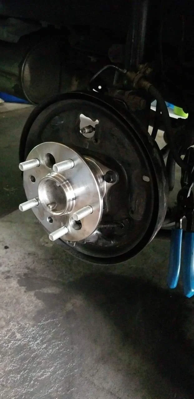

Next, in preparation to sell my Camry I figured I would knock out the wheel bearings that started to make noise recently. This job turned into a snow ball of trouble. First, while trying to remove the drum, I thought I had the adjusted back enough, I guess I didn't not only did I wreck all the hardware, but also took out the wheel cylinder -_-
Then after getting that all out of the way, and removing the bolts for the bearing, it did not budge. Heat, nothing... Slide Hammer, nothing... I even left the bolts loose and drove on the bearing, nothing....
Finally I turned to the good ol' YouTube to see if anyone had any tricks, a couple of carriage bolts and nuts, and done! Now waiting for new wheel cylinders, Shoes, and Hardware.

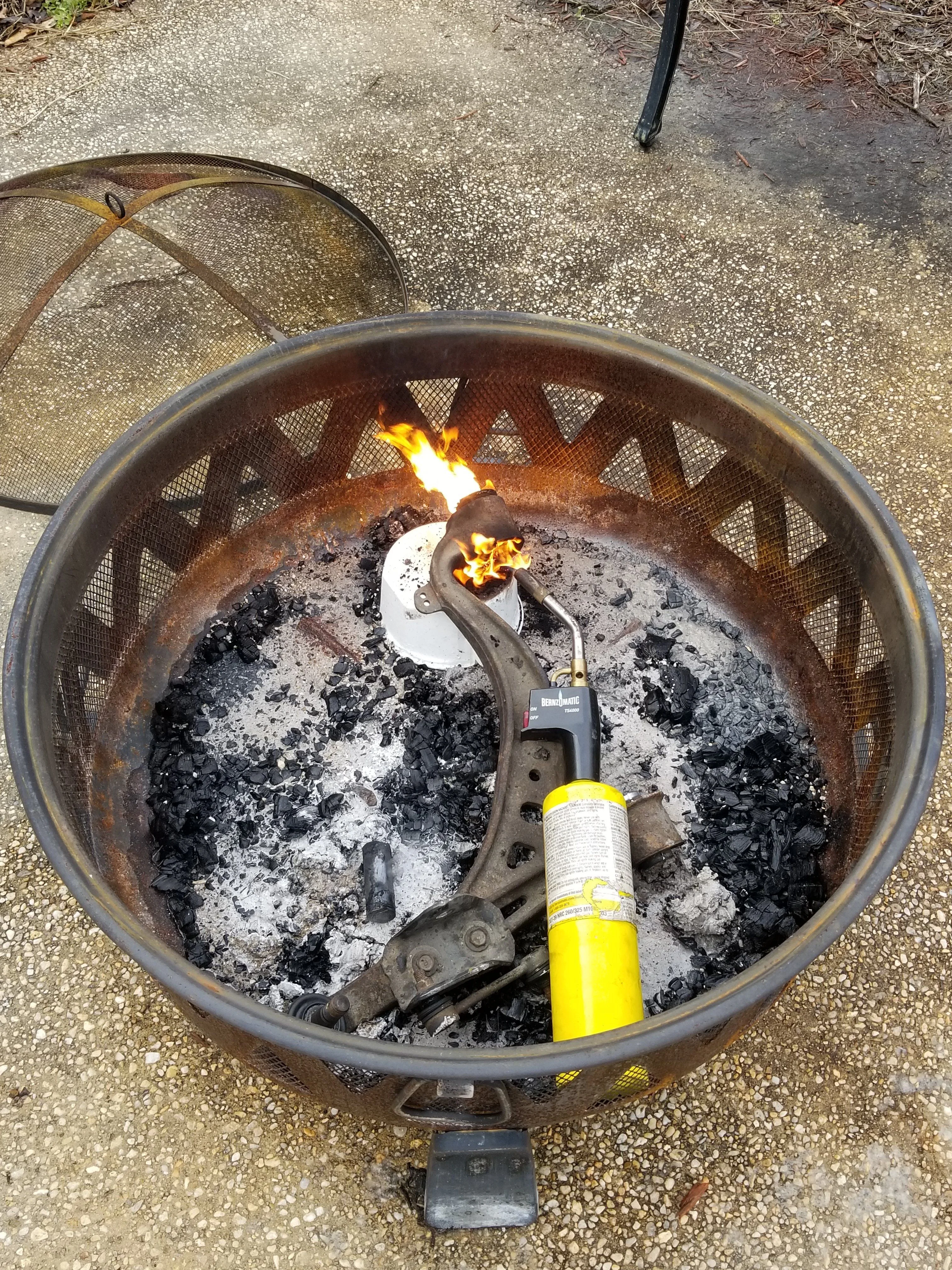

Finally, Trying to continue work on the SC400, started burning out the bushings in the lower control arms so I can drive this thing without feeling like the front suspension if going to fall out.

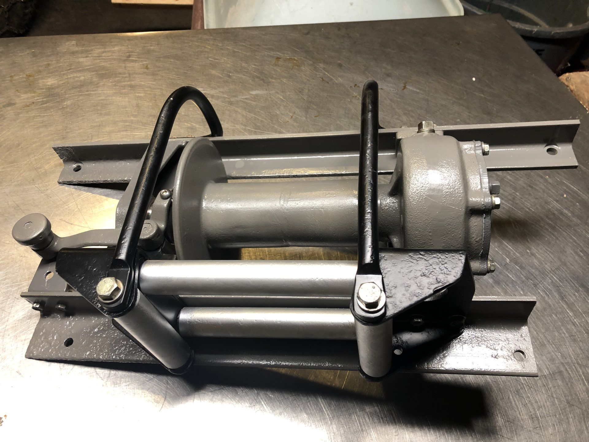

The winch looks awesome! Let me (us) know when it gets to eBay. These things are pretty powerful and can really operate fast when need be just by increasing your engine RPM. I've seen a few in operation and was always impressed. Quite the coolness factor, too......…..
Thanks Gary if you’re interested pm me I’d rather it stay local anyways.
Not interested in buying but interested to see what a nicely restored and pretty much complete looking setup brings on eBay. Do you have the shifter handle?
Yep the only thing missing are the 2 yoke connections on either end of the driveshaft but those can be fabricated by any tractor supply shop.
