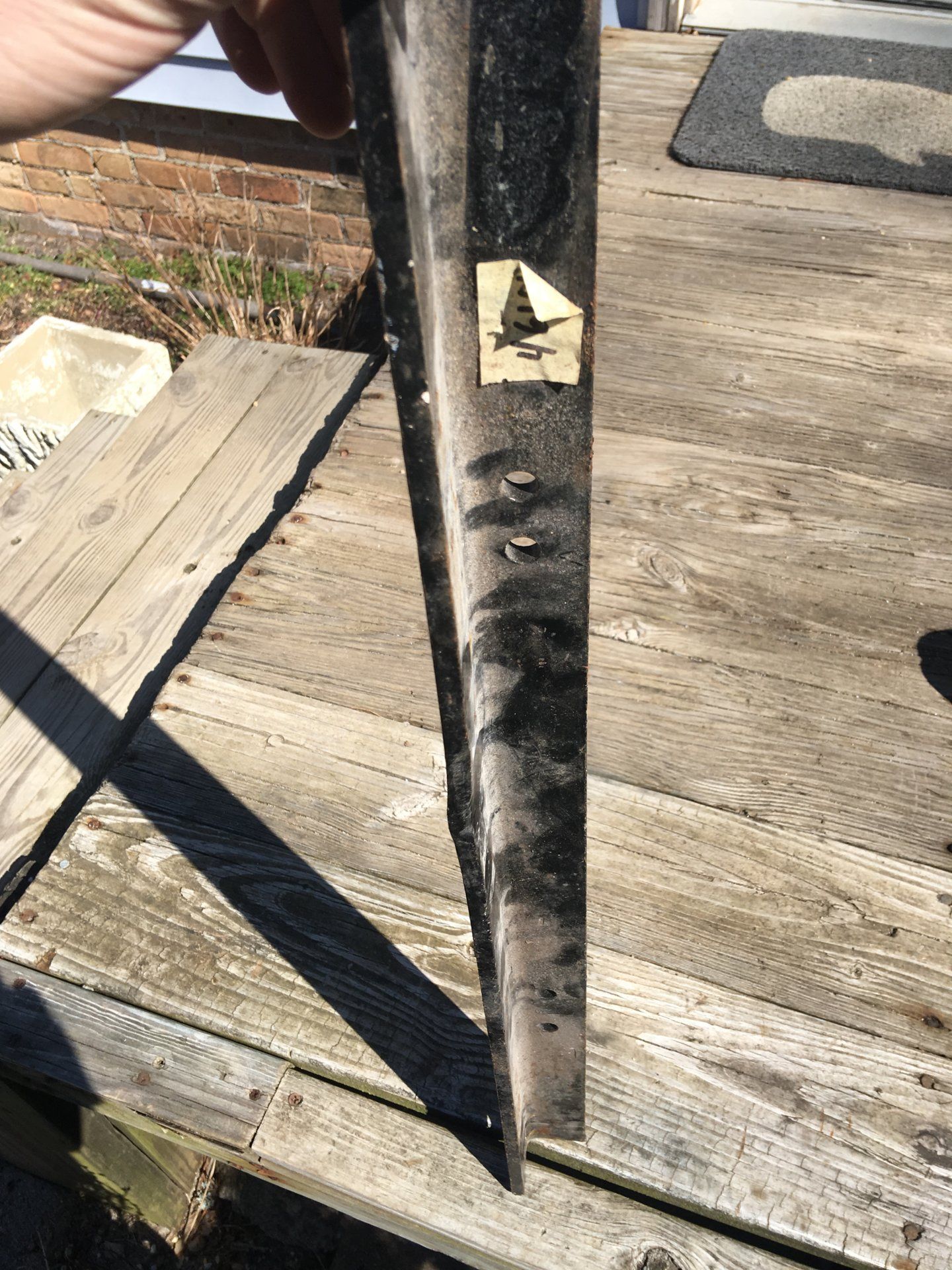

Yep the only thing missing are the 2 yoke connections on either end of the driveshaft but those can be fabricated by any tractor supply shop.
I would highly recommend getting that done befor it hits the market.
I can see someone willing to drop much coin on a turn key, bolt in PTO solution.

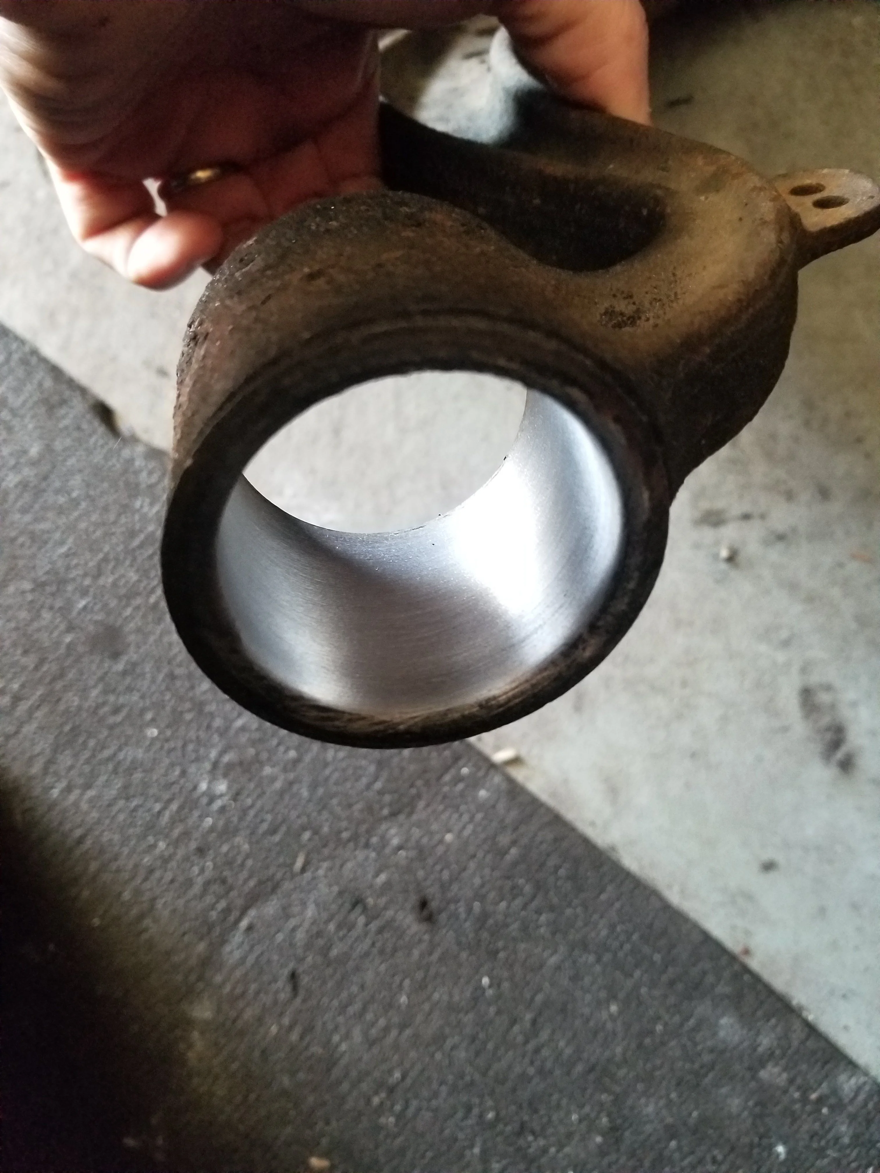

Got the bushing burnt out and new one installed, don't have a pic of the final product but I thought the cleaned out bushing sleeve looks neat.

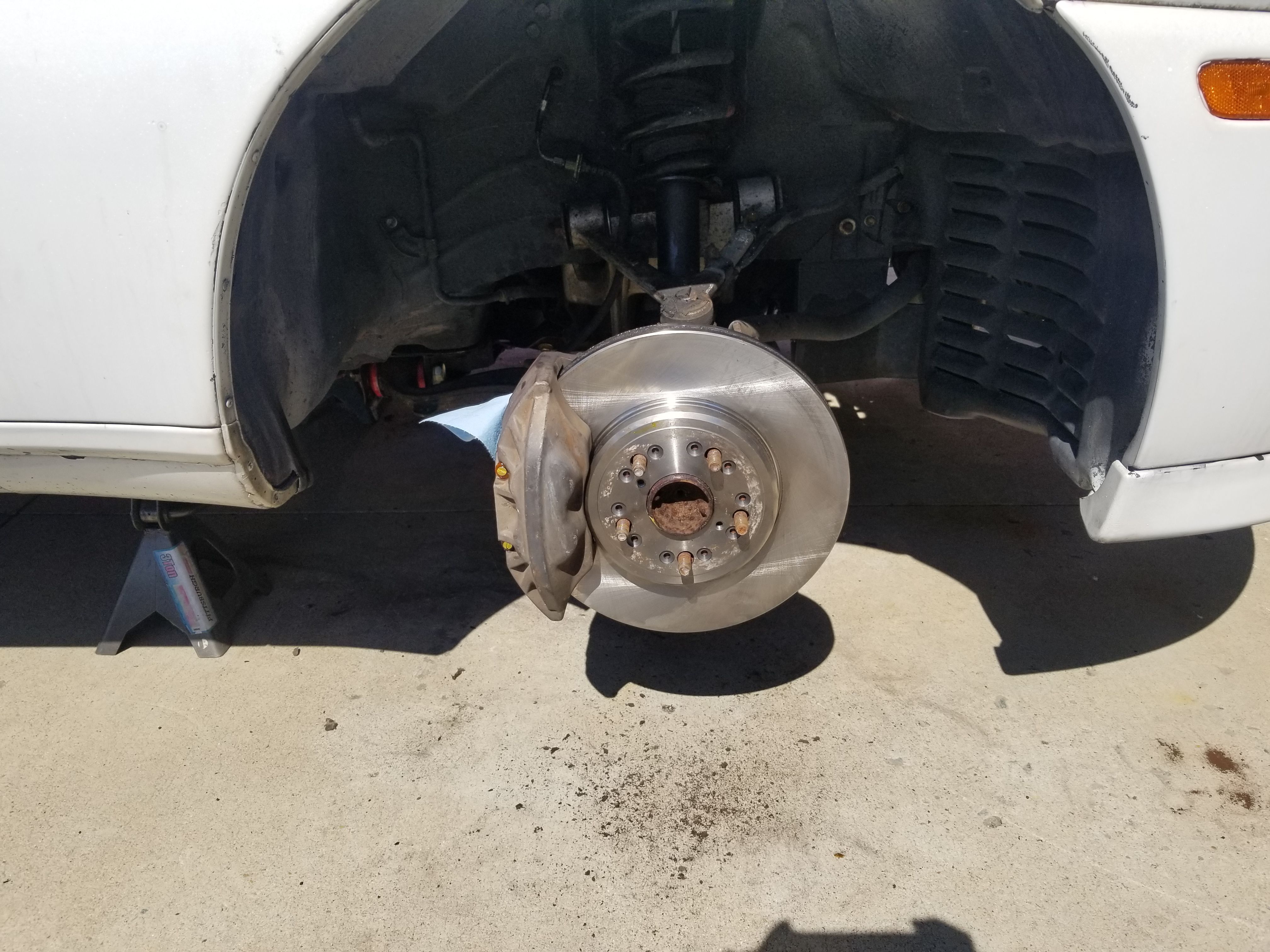

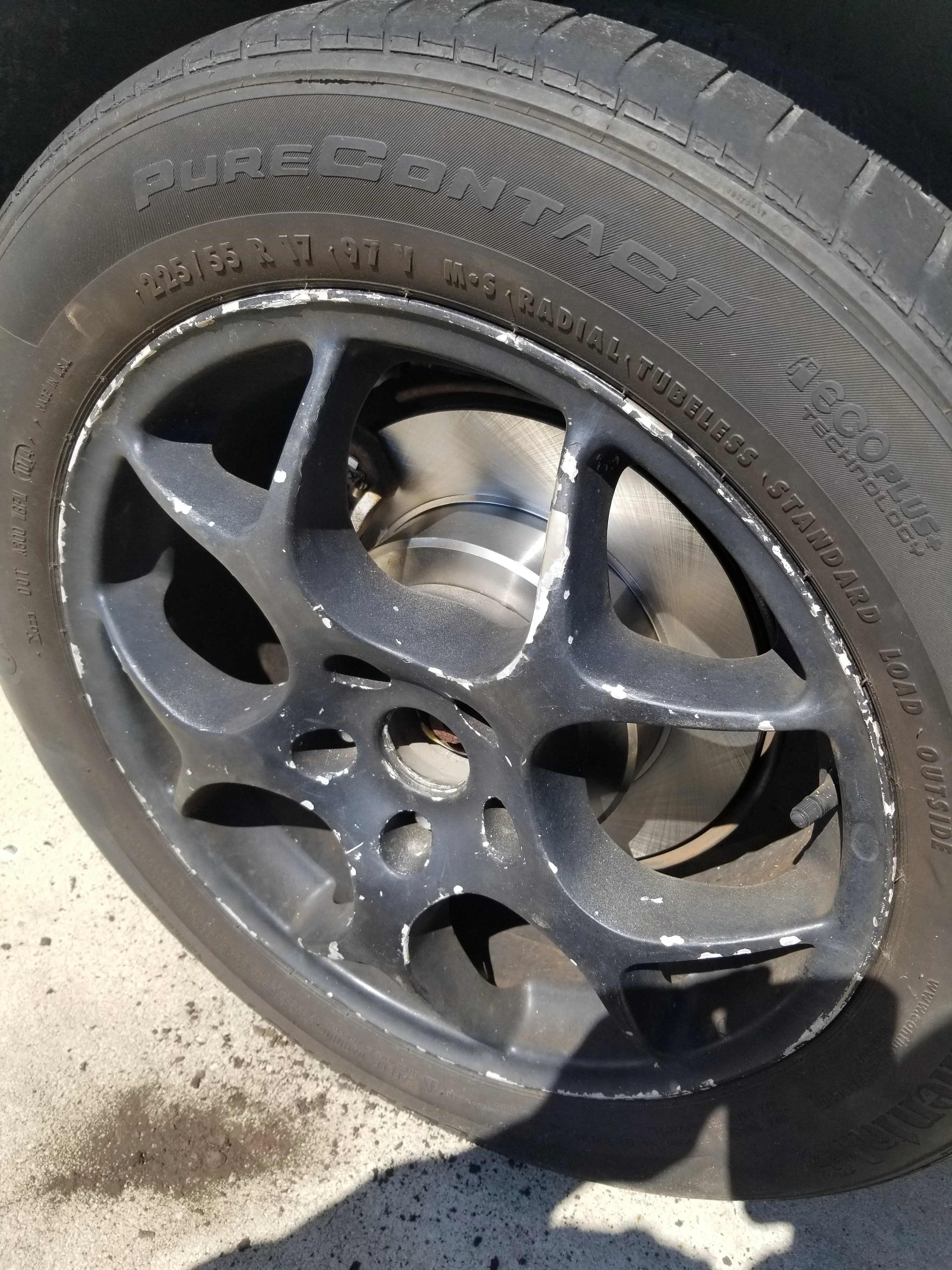

Then I did something common for the SC400, a big brake upgrade using LS400 calipers and rotors.
I had to remove backing plate since the new rotors are slightly larger and do not clear, I will most likely modify them later and put them back on.

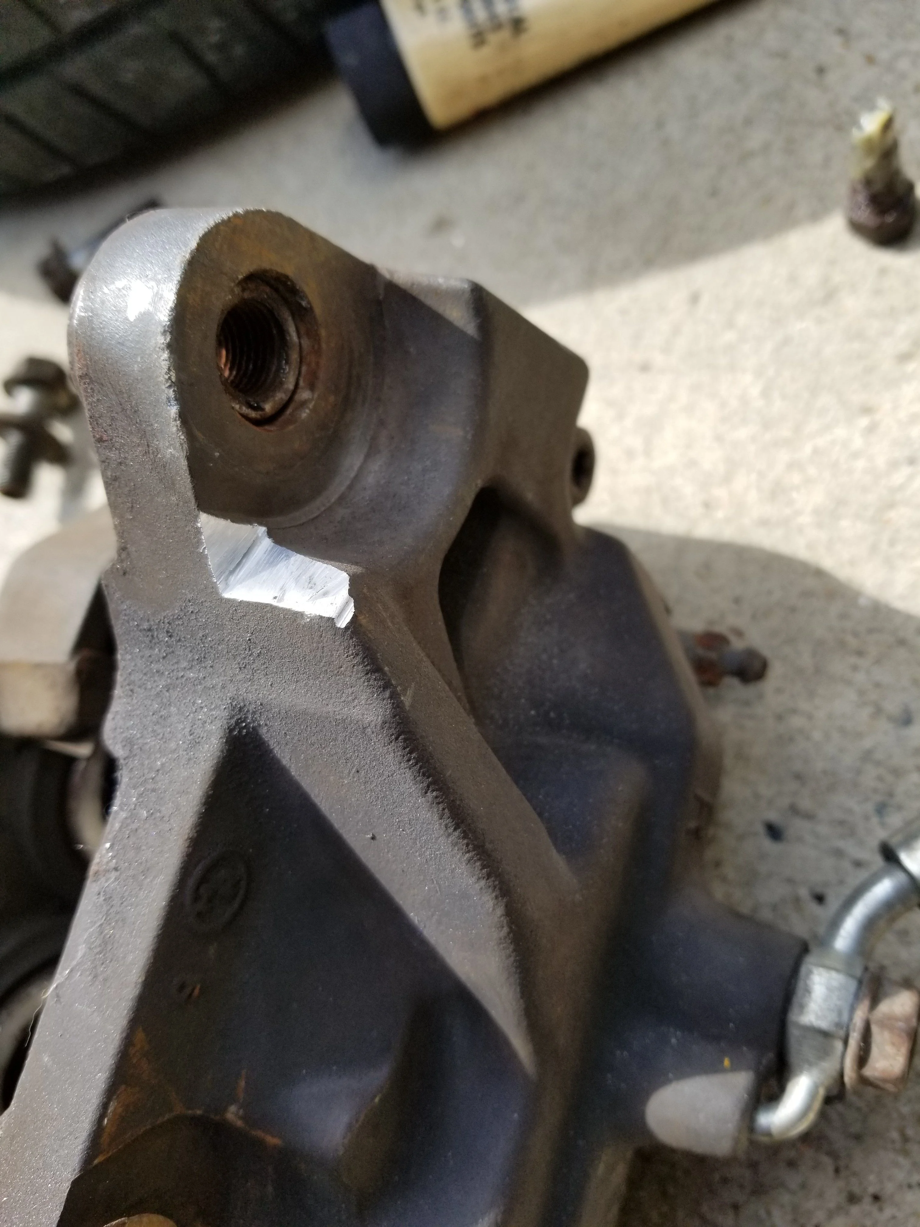

Next I tried bolting the new calipers on but they wouldn't go, I thought it was interfering with the rotor but come to find out a little ear on the caliper itself was hitting the bracket on the spindle so out came the cut off wheel, took a little material away and all good!
Nice new big brakes, car really stops great now, hopefully with some new front brake lines (left front a little rotted...) it will stop even better.
I also did the rear brakes because they were so rusted I thought they were locking up, come to find out when I took the rotor off, the emergency brake shoe material was off the shoes, so I will have to get those on order and get them replaced.
