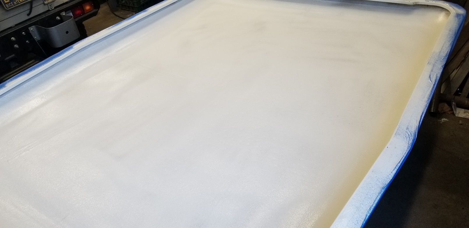

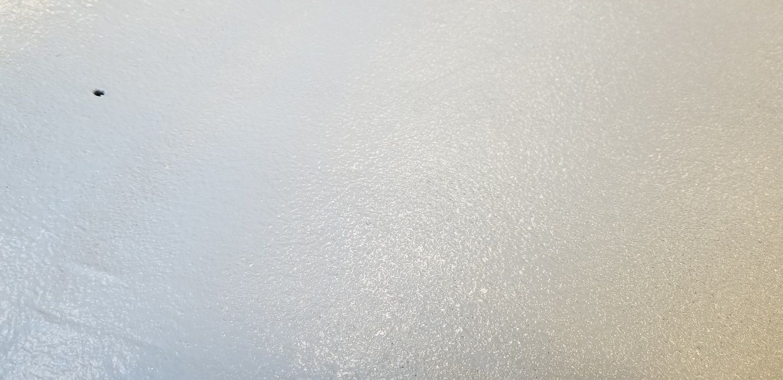

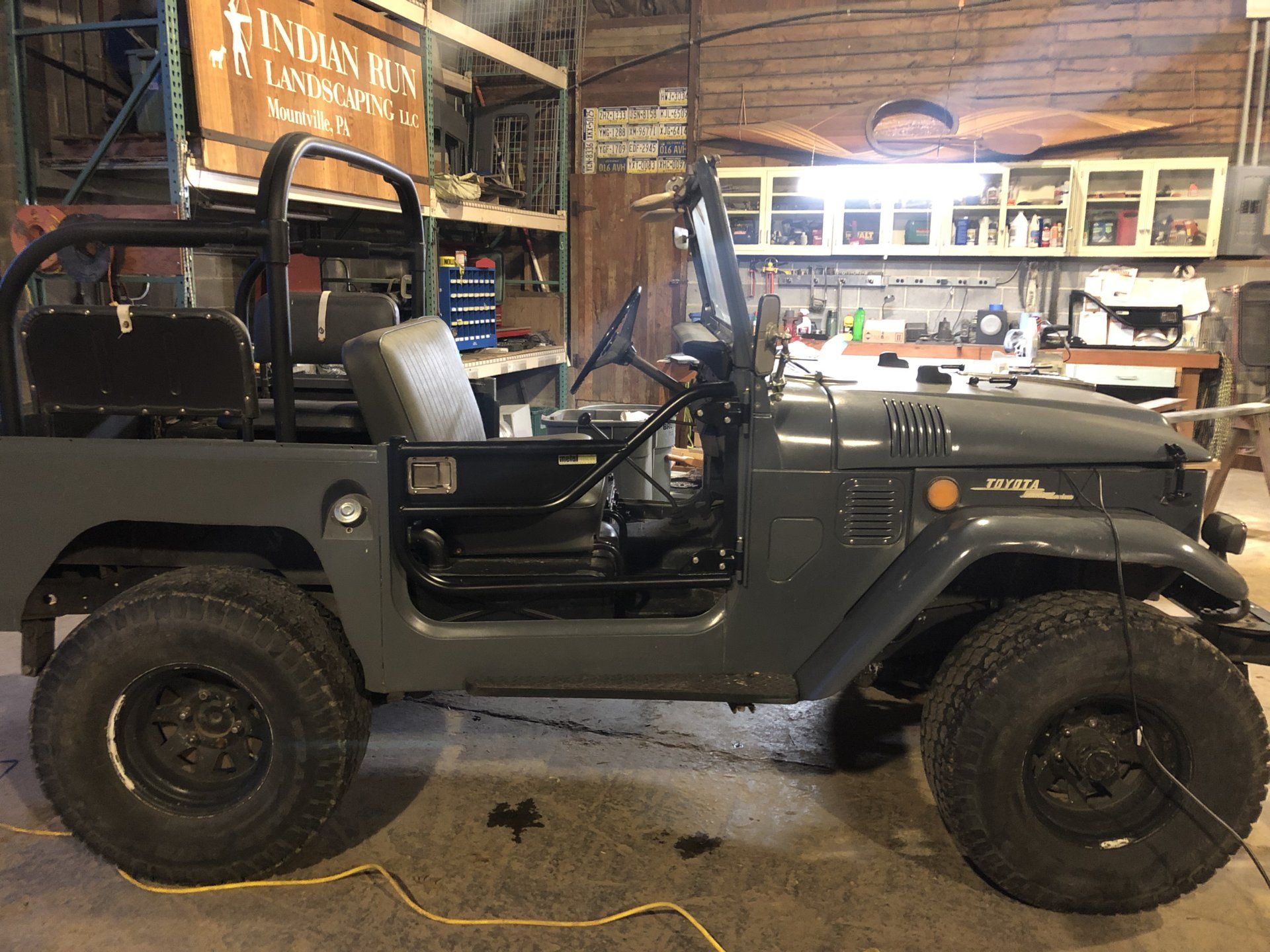

Its pretty thick for being rattle can stuff, albeit two part epoxy stuff, so I'm thinking it should do pretty good soundwise...hoping it does well insulation wise as well.
oh im liking these.

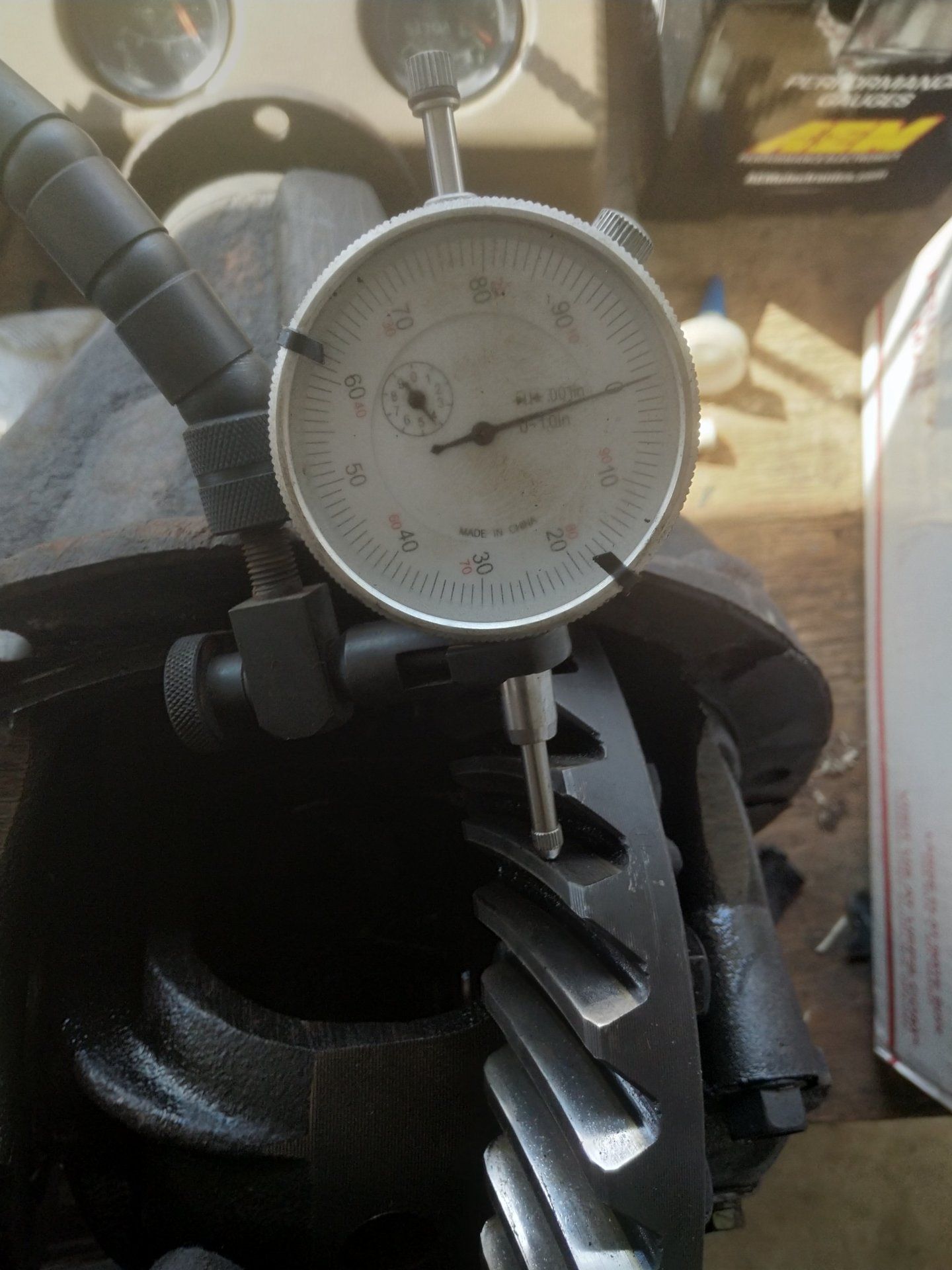

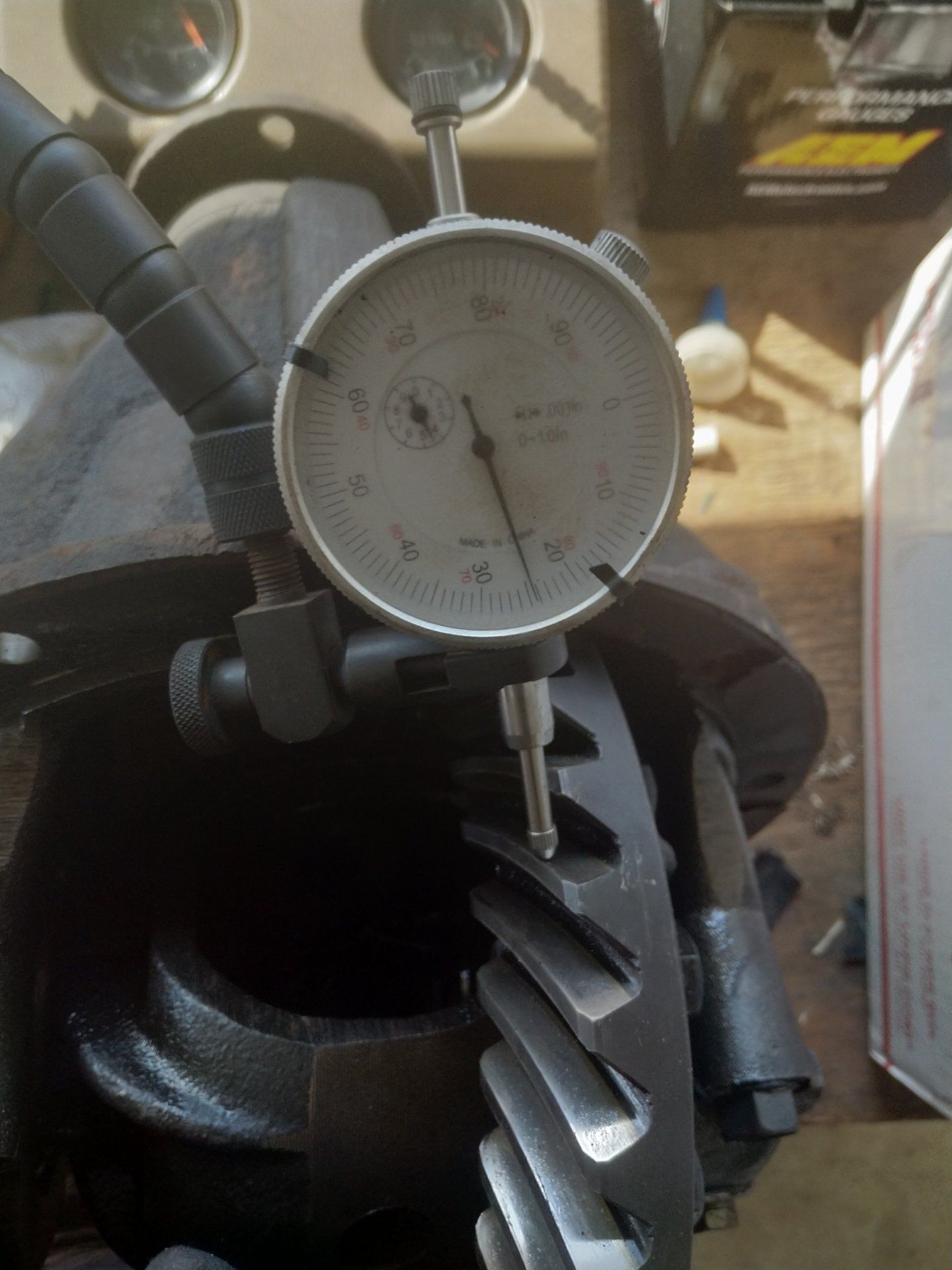

This is where it was parked when the TCase came apart, now a drive shaft rebuild, diff swap, and of course I find a bad wheel seal probably caused by a hot wheel bearing....
She needs the attention! That old diff had over 25thousanths backlash.
and that's bad?
I think it's getting there.
It still works, hadn't chipped any teeth, but it has three times the play of the one I'm putting in. It leaks at the pinion and I have a drive line vibration which didn't change with a different driveshaft.
