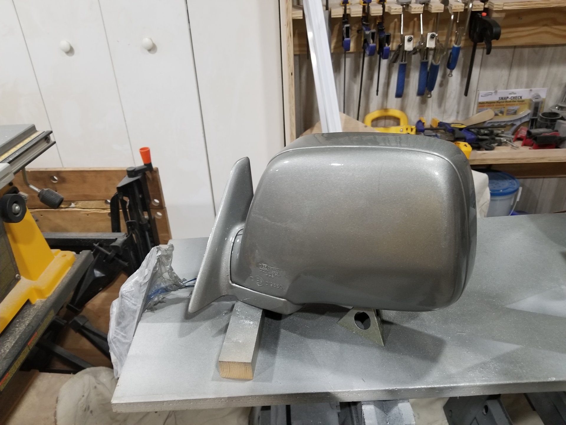

Yes, so much better!
Did you remove the fenders to paint?
Yes I did remove the fender flairs and replaced the rubber pads. The cruiser is slowly coming together and the to do list is getting smaller. I also replaced the u joints up front because there was a noise and vibrations over 55 mph.

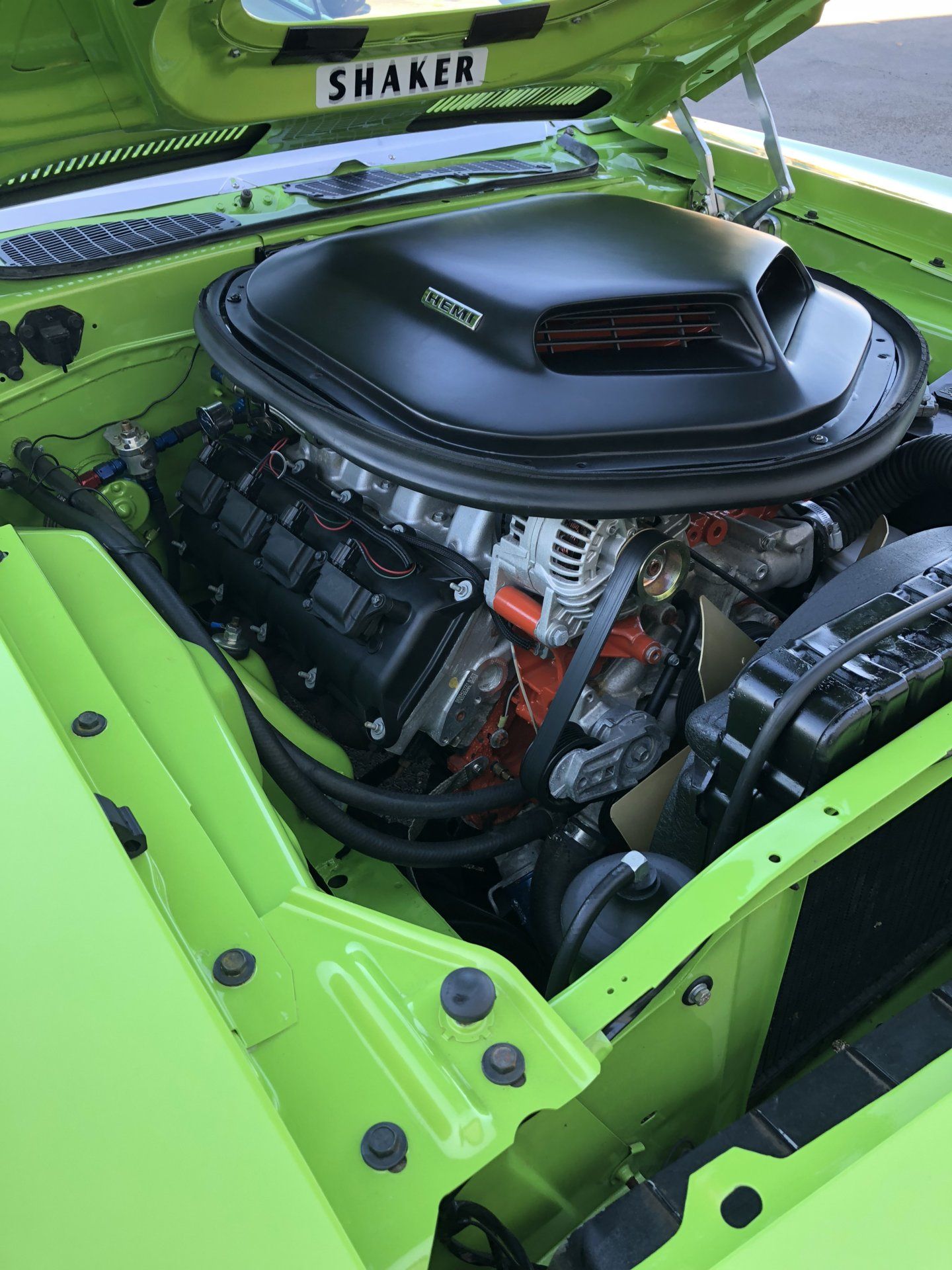

Some really cool stuff at the shop this week.

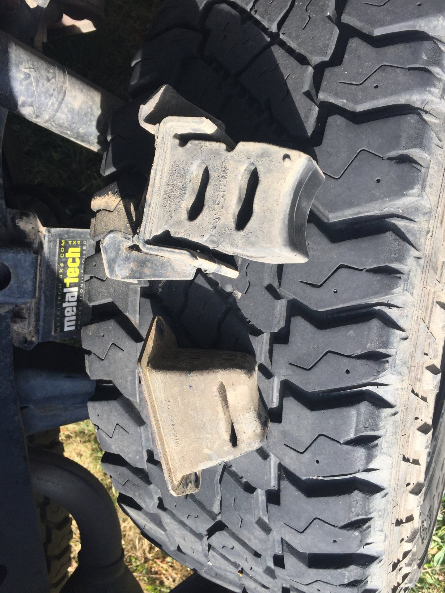

Been doing some work on the 40 since coming home from coal mine. Had to disassemble and re-do my passenger side front spring pack. Using 60 axles under my 40 means that the passenger side spring mount is kinda custom. Had to remove a broken 1/"2 bolt and redo the threads. Put a spacer in on my spring pack and all seems well. Trimmed the skid plate a bit where the exhaust pipe was hitting it and rattling. And put a trail tamer seal kit in the front axle, new bearings, seals all that jazz. Topped that off with an oil change, used one of the Toyota oil filters donated to the coal mine raffle by Beno- the front axle kit was also a raffle prize from 2017! She runs pretty good now!
