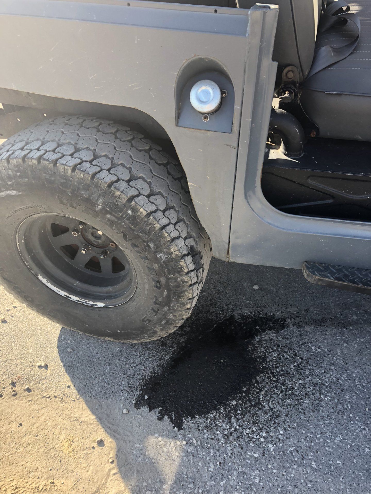

Did you have a full tank?
It must have picked fuel out the cap.
If it was the filler neck it would drain under the tank. All that is inside the tank.
Tank was full and it definitely came out the cap. Wasn’t parked on a steep slope and hasn’t done it since. Well...no one freaked out over the picture so I’ll mark it up as a fluke and run her.
How long was it parked in that spot? Tank looks to be black, if it was there for a good portion of the day with the sun beating on it was probably just some good old fashioned pressure release. Especially if the tank was full.
My 40 does the same thing on a really hot day (or direct sun) with a full tank

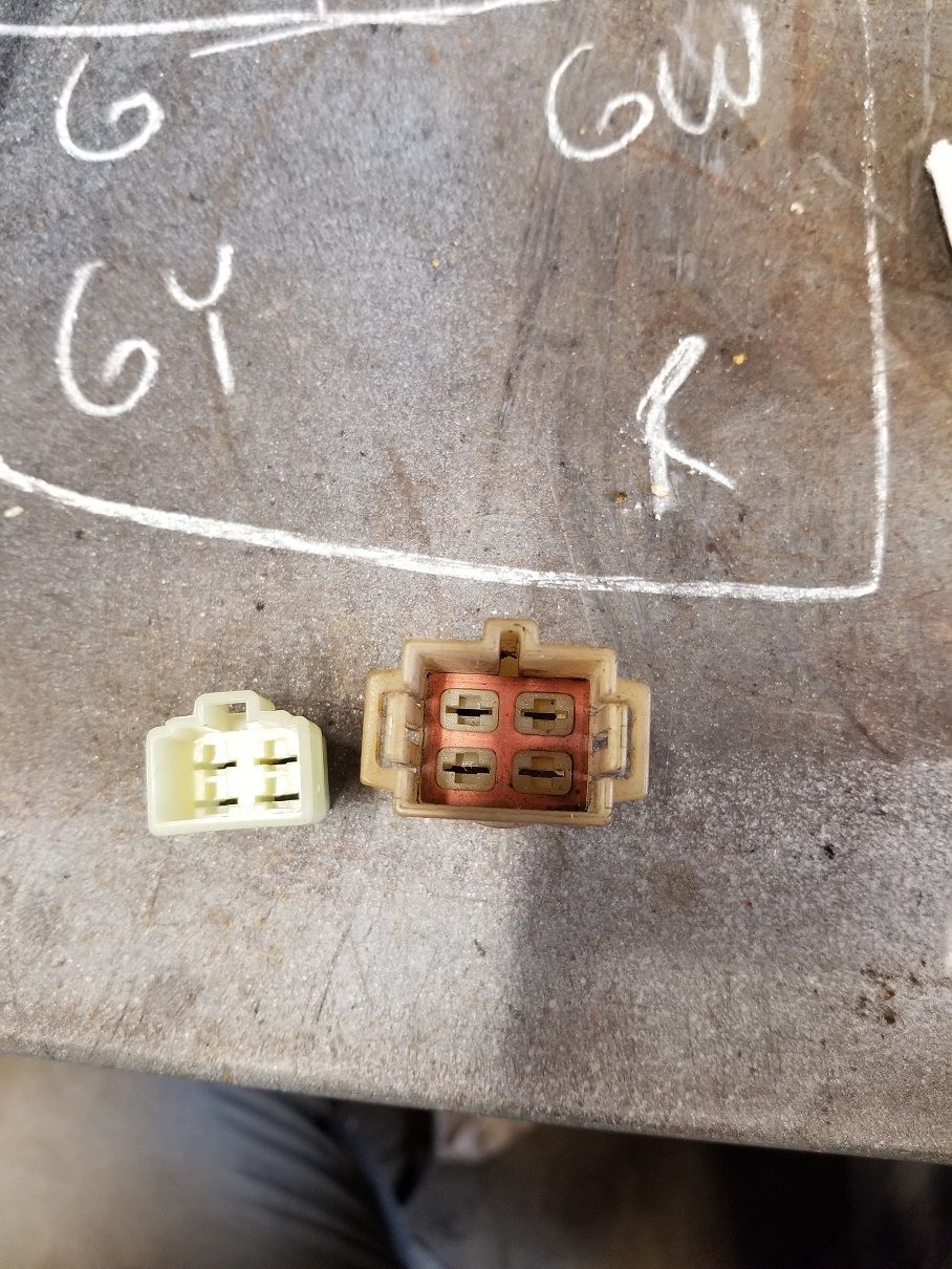

decided i wanted new shiny and bright lights to replace the tired oes ive been nursing way too long for some reason.....and apparently had an early senior moment. the 75 is built on the bones of a 77. not much left that is 77, but the wire harness is one of them.
so i was faced with some disappointment this morning as i tried to plug the new lights in.
lucky decades of ownership and nearly the same of mud time has learned me that toyota rarely makes large changes, this was no exception.
73-75 used a simple four slot plug, the 76-L used a weather resistant four slot plug, but the actual male and female prongs are the same....so ten minutes later....new lights with an old plastic plug.
