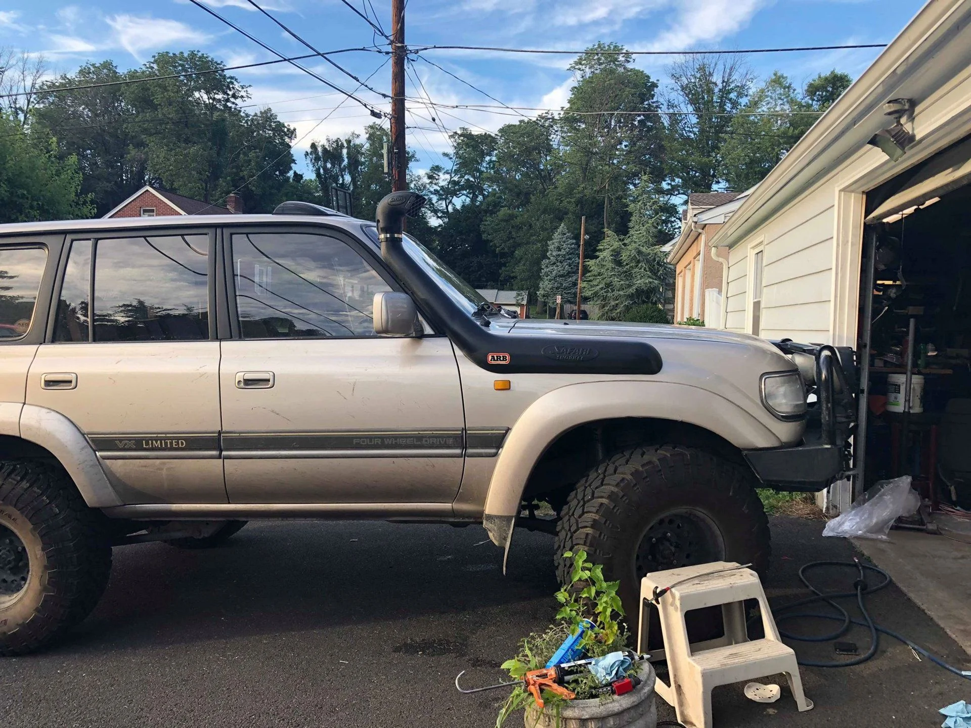

found a used safari snorkel for next to nothing so i got an ebay special and used the stainless hardware for the install. template was useless but with some guesstimations it went in pretty well. next up sliders!

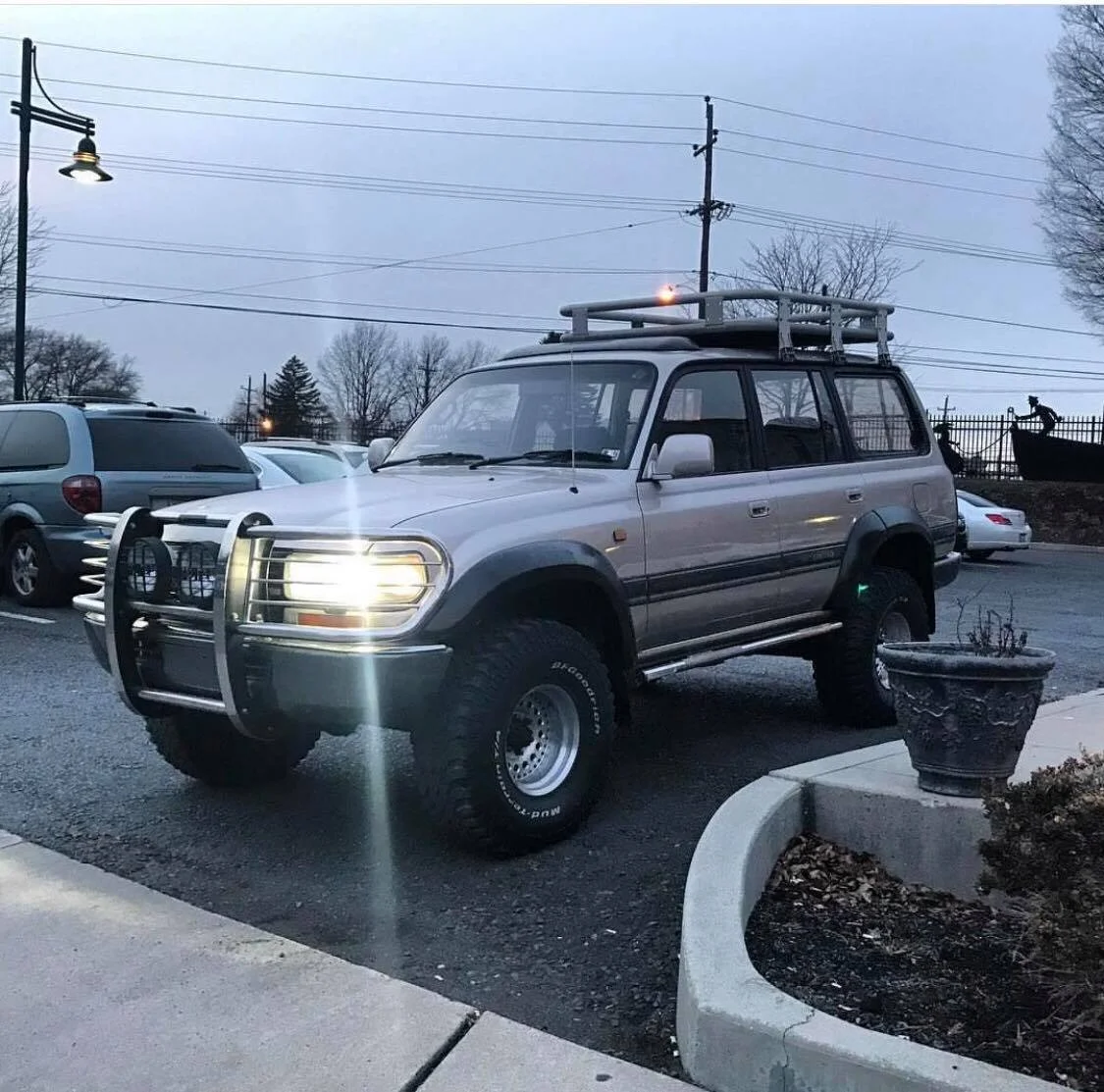

Just putting some feelers out there for my REMCO aluminum roof rack, stainless tube side steps that mount in the same spots as stock running boards and JAOS offroad challenger stainless brush guard that came on my HDJ81 when i imported it from japan. As far as i know neither were offered in the US. The roof rack is lightweight and very strong same with the brush guard. it might even brush off a deer impact.
pm me if you're interested
