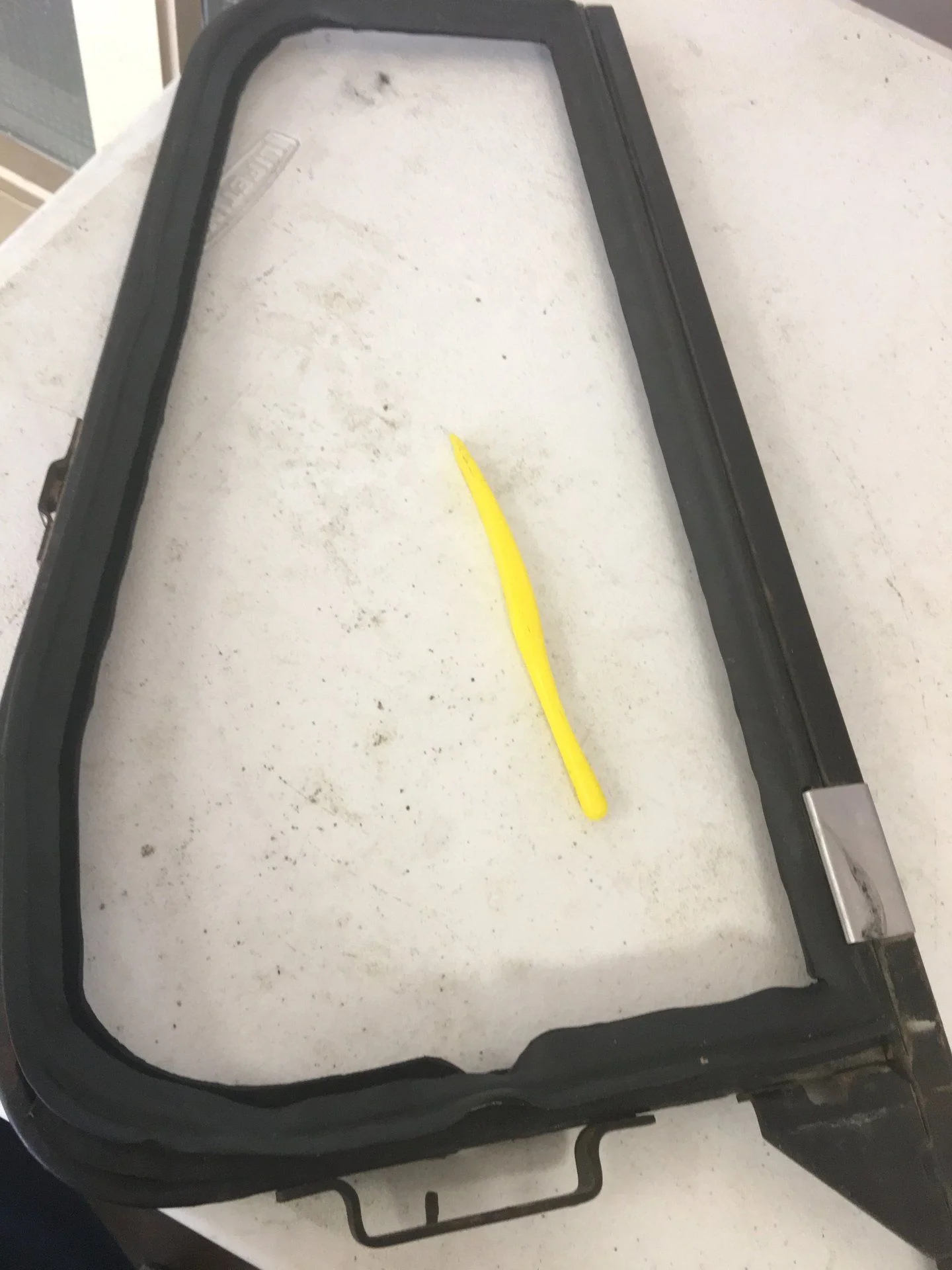

4- The f’ing vent seal is leaking (I am certain this will be unsolvable short of welding it shut) and it’s tearing again (I’m on #3 at least). Is everyone else replacing the rubber every 2-3 years? I’m thinking some type of indestructible fabric behind the rubber?

For the vent seal be sure the orientation of the rubber is correct. ie. Right rubber on right window. Don’t ask me how I know and they’re a pain to replace.

Rubber flap seal? I have a new SOR one on the shelf and reading everyone's review of how they do not last makes me want to use it as a template with something with a better durometer. Pretty sure that's the word i recall from casting rubber part research. A leather punch (i have one should i ever loose weight and need to shorten a belt) would work to make the holes and some EMT shears to cut the shape. Possibly something cushier that will conform when closed might be better?

For the water leaks--trying different "rubber" compounds that are more UV resistant and keeping them pliable with protectants.
As has been said, rubber seals under the hood hinges, and a dab of silicone around each bolt hole. Using small amounts of products like 3M Strip-Calk can help with unevenness in weather stripping.

For the windshield vent, on my next replacement(number 3 I think), I am going to use silicone sheet....not rubber. Might think about using some of the ceramic coating on the rubber(I have a new rubber gasket if I don't cut a silicone one). Don't weld the vent! Best part of those old 45s.

Erik- Yes the rubber flap seal is the culprit. I have a new Toyota NOS rubber piece that could be used as a template too but I won't be putting that on as I can't risk it getting ruined too. Thinking something with a reinforced component could help keep it from cracking? I'll work on the seals under the hinges and appreciate the tip on silicone. Hope the screws come out ok but I doubt it. I do have some 3M seam sealer if required as well for the cowl.
