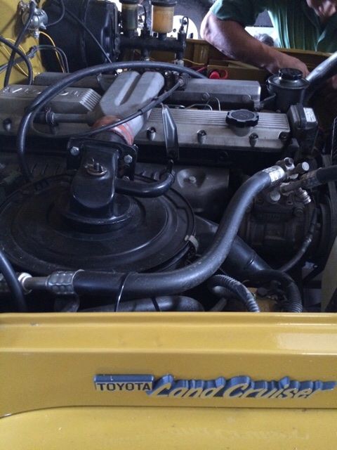

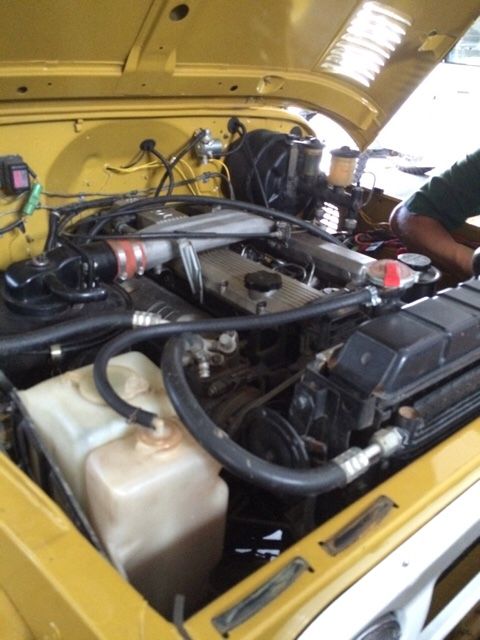

I've driven and worked on the truck being imagined, 1HZ, h55f, split case in a restored 40 and I can attest to how well it works. Non-turbo, doesn't need one either.
