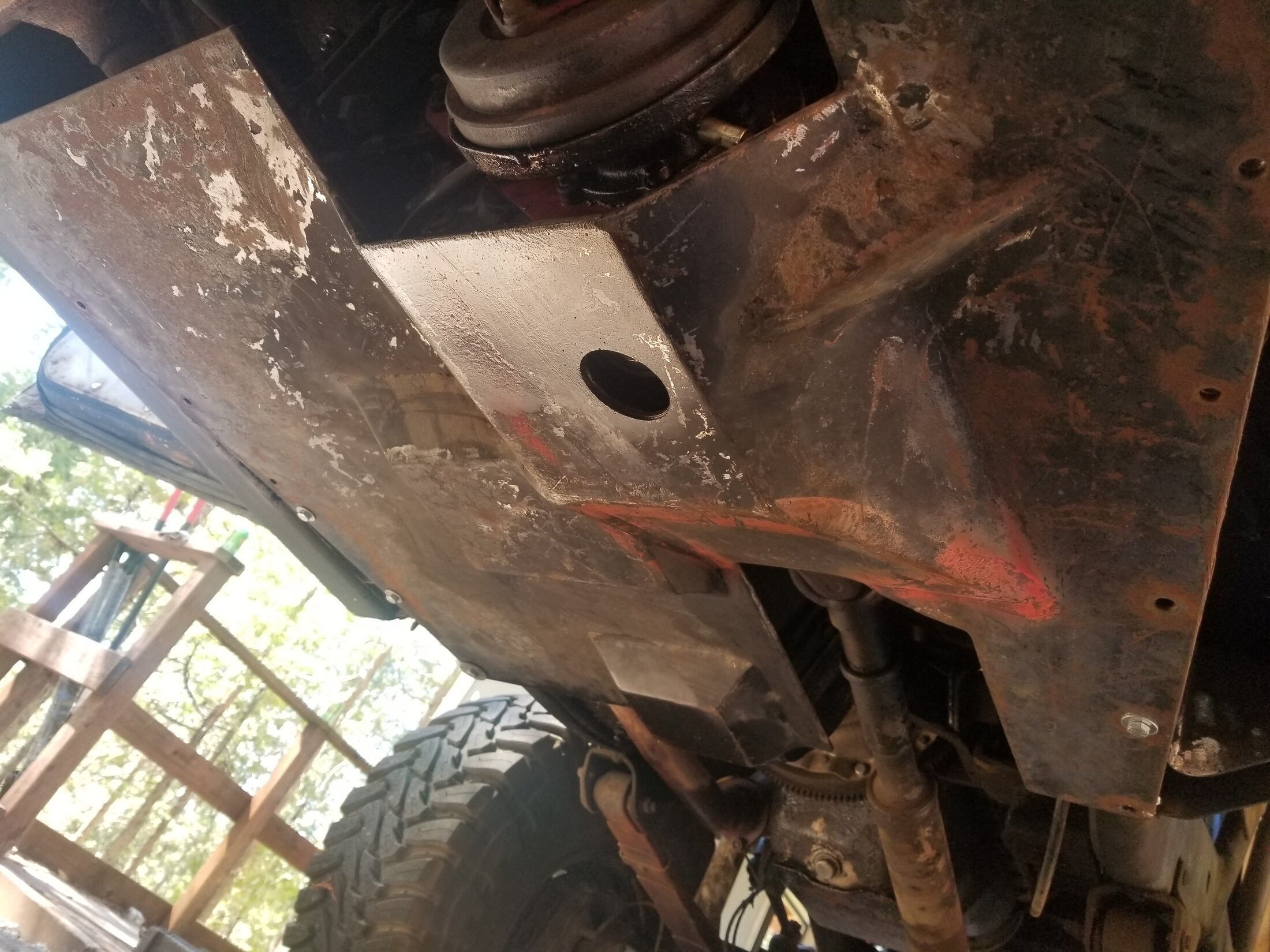

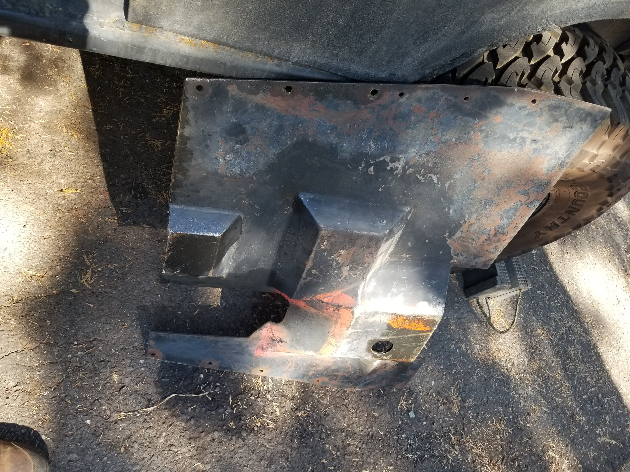

Mine is 1/4" and probably weighs 100#, but it's bigger. It started out as cardboard too and fits up close to the drivetrain. I have been unable to bend it as yet
