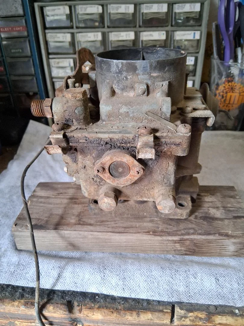

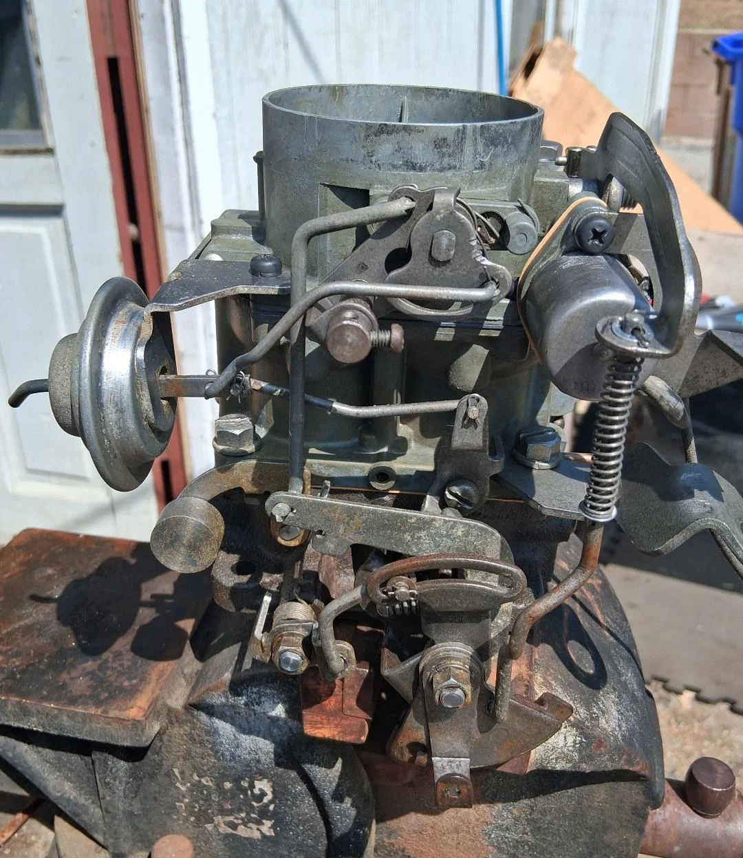

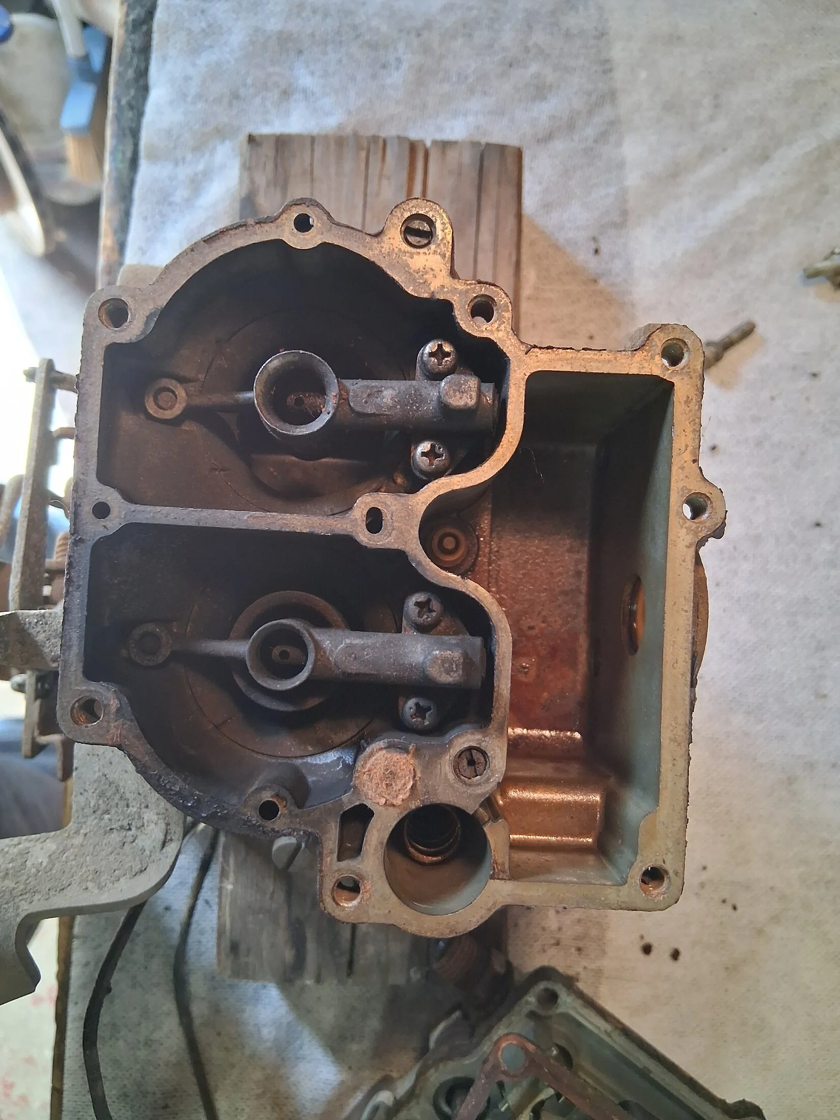

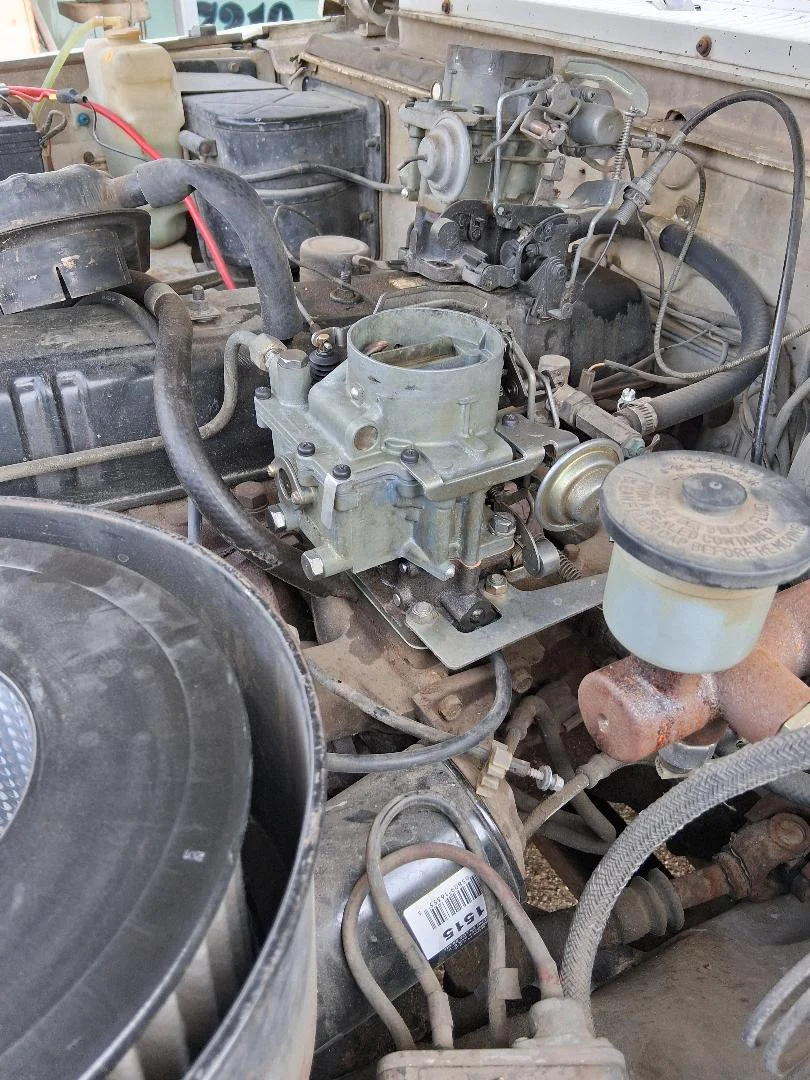

Lots of Great stuff on here. I am guessing your running a 1F motor. all the carburetors' people listed are Great carbs. I have helped guys over the years and the 1F carbs are really simple once you have spent time rebuilding them. Where in Calif are you located ? I had a buddy send me this from Oklahoma the 40 had not ran since 1993. Gotta love a challenge. I always test run a new build before I send it out to make sure everything is in good working order. Happy to help

I’m in Marin Co. I’m running the original f145 for the truck. You sent me parts for this carb last year, thank you!!

I’m pretty sure that’s my carb…the shop that’s doing a little engine work just got it back from Cali
Right on. Mick sent me a video after the installation.
Mick is great! He grew up with my boys. He’s done some good work on other vehicles for me in the past. I should have it back soon, waiting on a replacement radiator to get here and be installed. Looking forward to driving it. Thanks for the help on the rebuild!
