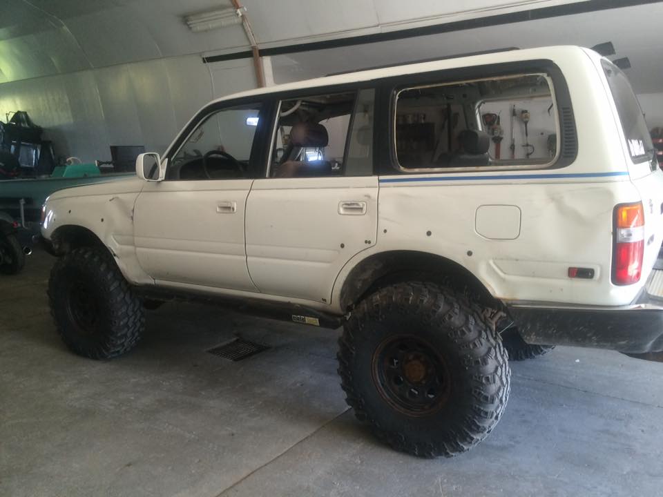

Deflared....took about an hour and a half this afternoon... and some touch-up superwhite II :hillbilly:
Before and after

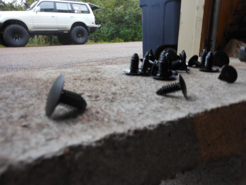

(12) 3/8 and (12) 5/16 automotive inserts from Ace Hardware. They come in black.... Three coats of Duplicolor....
some are a hair loose....but it'll do until a coat of Al's or the like gets applied...

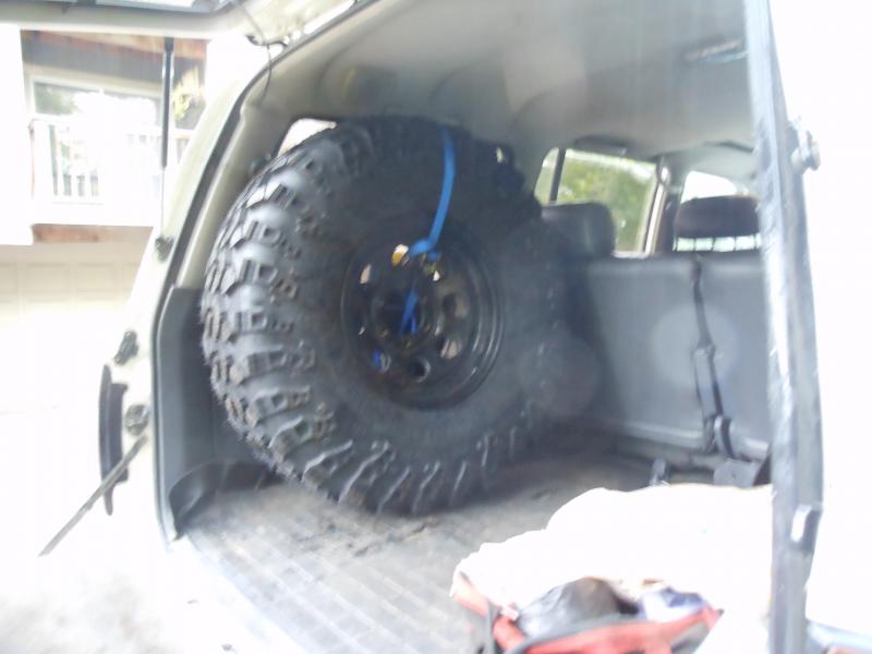

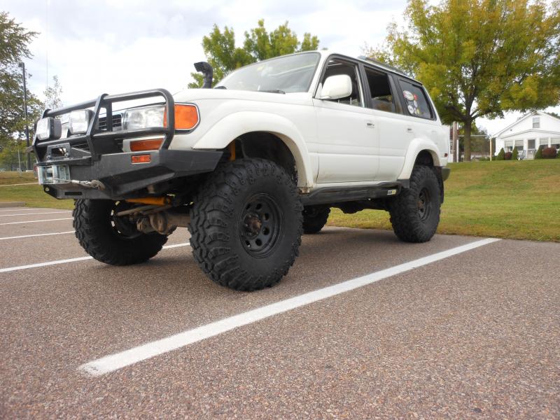

Reattached the stock mud flaps, might trim them up a bit. Two 10mm bolts at the trail and they're off. Hopefully the "nothing better to do's" will leave me alone, the tires really don't stick out too much (right officer?)...we'll see how it goes. Ratchet strapped the spare to the 3rd row bracket, for now. It's actually pretty secure. Tire carrier rear in the distant future.
Next- Fall Gathering 2012 in NH, in less than a week! Finally will get some decent wheeling pics, and see how the new treads do.

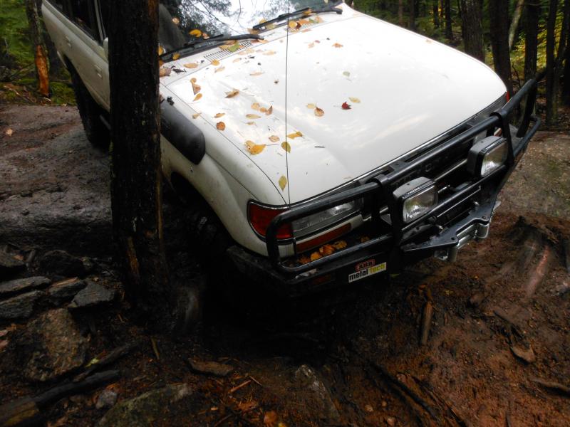

almost lost the snorkel, and then almost flopped her coming down this 3 foot ledge.... For some reason i find myself drawn to trees on the passenger front fender....:hmm:
