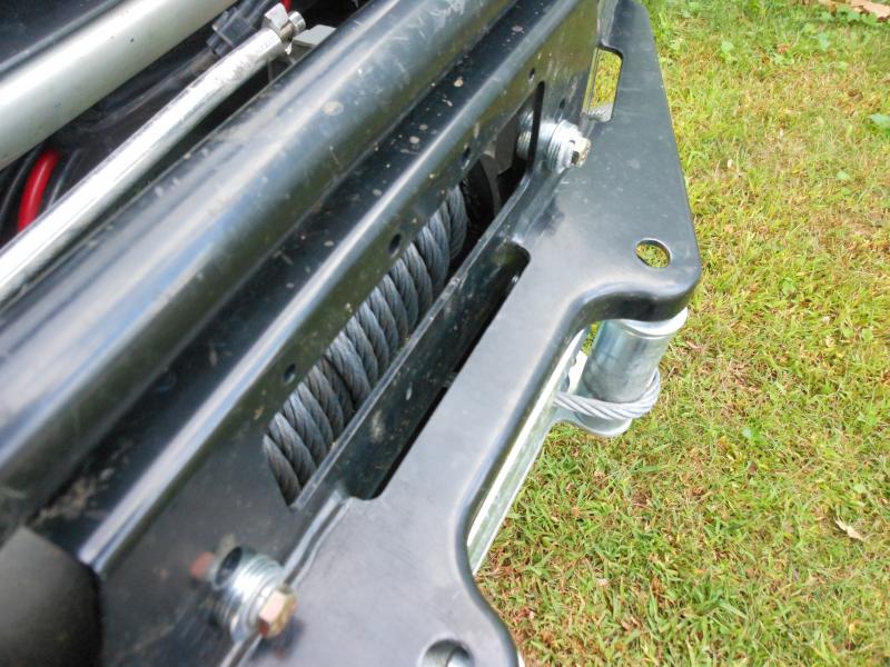

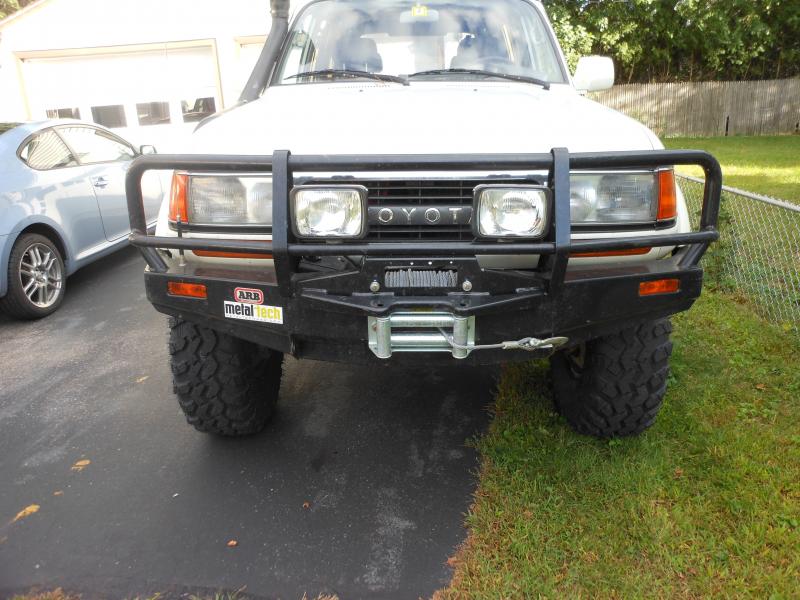

finally received my back-ordered winch from Metal Tech. Will have it installed in that empty void on the ARB this week :D

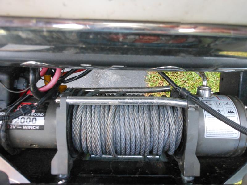

couple of new additions.... Got the Engo 12K winch mounted a while back... Had to use washers to space the winch back to clear the angles on the ARB. Looks like crap, but its on and tight.
about a month ago, on it's first pull up a steep muddy climb, a guy that pulled line for me failed to notice that the cable was bunching up... and it broke the two rear guide bars. :bang: But the winch worked great, used it twice to pull the 80, and helped out a mini truck as well. Slow, and noisy, but you get what you pay for. I had the wiring box mounted to the left side of the grille, but this caused high temps on the highway. Haven't gotten a chance yet to relocate it under the hood.....Where's the best place to locate it?

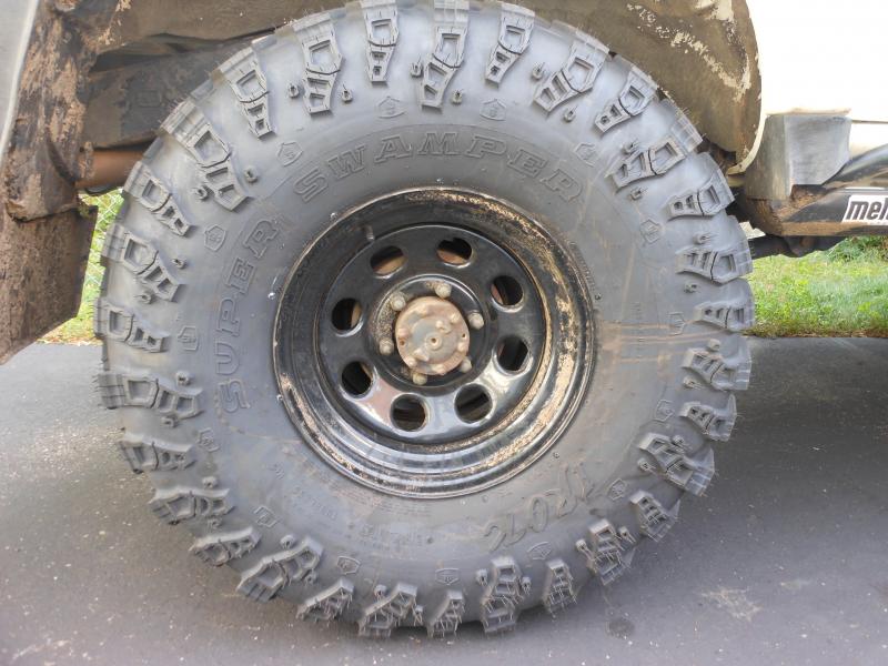

and moved up to 37" IROK radials. The Destination M/T's were getting worn down and beat, and after easily slashing a side wall, had some convincing to do to get something a bit tougher. So after about a month of pleading with the wife (THANK YOU!), on went the Swampers.
No rubbing so far, will give them a good test at the Yankee Toys Fall Gathering in two weeks. Balanced with equal tire balancing compound.... The radials ride smooth and quieter than my worn Destinations.
