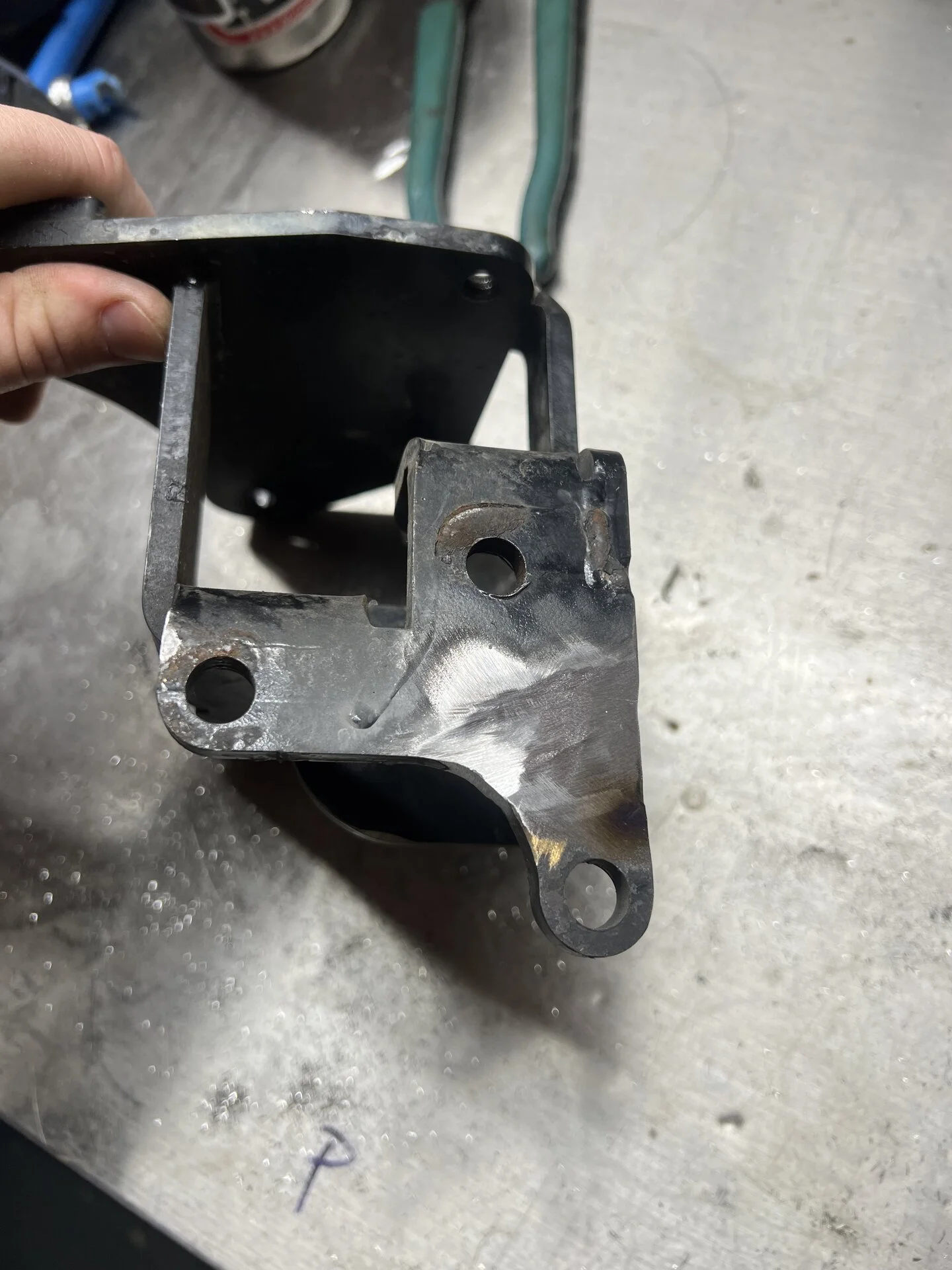

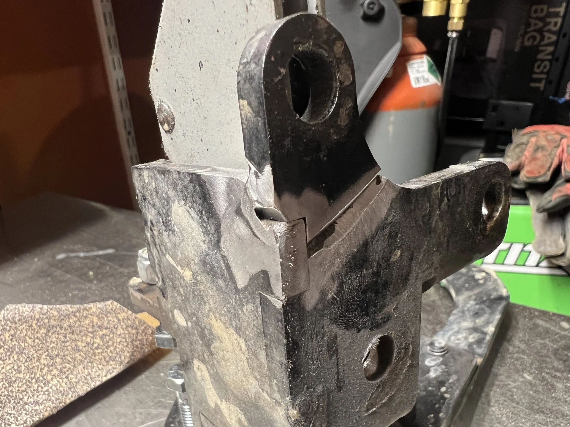

Hey mud. It’s been a while since I installed my VA kit. It works just fine, but there are a few things I don’t like about it about a year of use. Last week the bracket that holds the compressor and alternator broke in half. Don’t know why. When it broke it rammed the AC compressor into a rad hose and caused a coolant leak, which is how I found it all. The location of the alternator is so close to the battery that I have had to repair the alternator plug twice. The battery is moved all the way back, on the oem tray at least. I’m looking at mounting an oem compressor with oem mounts and plumbing it into the VA kit. I’m sure someone here has done this. Wondering about fitment. Specifically what you did about mating the AC hoses. Did you have custom ones made? Enjoy these pics of me glueing back together the bracket today .
Looks like a nice repair. No clue why it broke, flaw in the metal maybe. Add like a 10 gauge or 1/8" piece of steel to that base, skip weld the perimeter.

for anyone that was curious, vintage air reached back out to me after i left them a message. the guy explained that i was not the only one who had this happen, there was a slew of them all from right around the same time area of production. they dropped a new bracket in the mail to me. the only other issue i have to sort out with this thing is that the alternator is too close to the battery. the battery rubs up against the plug on the back of the alternator and i have repaired the plug twice now. the factory tray is moved as far back as it allows, i am currently trying to come up with a clean way to move it all back another inch or so.

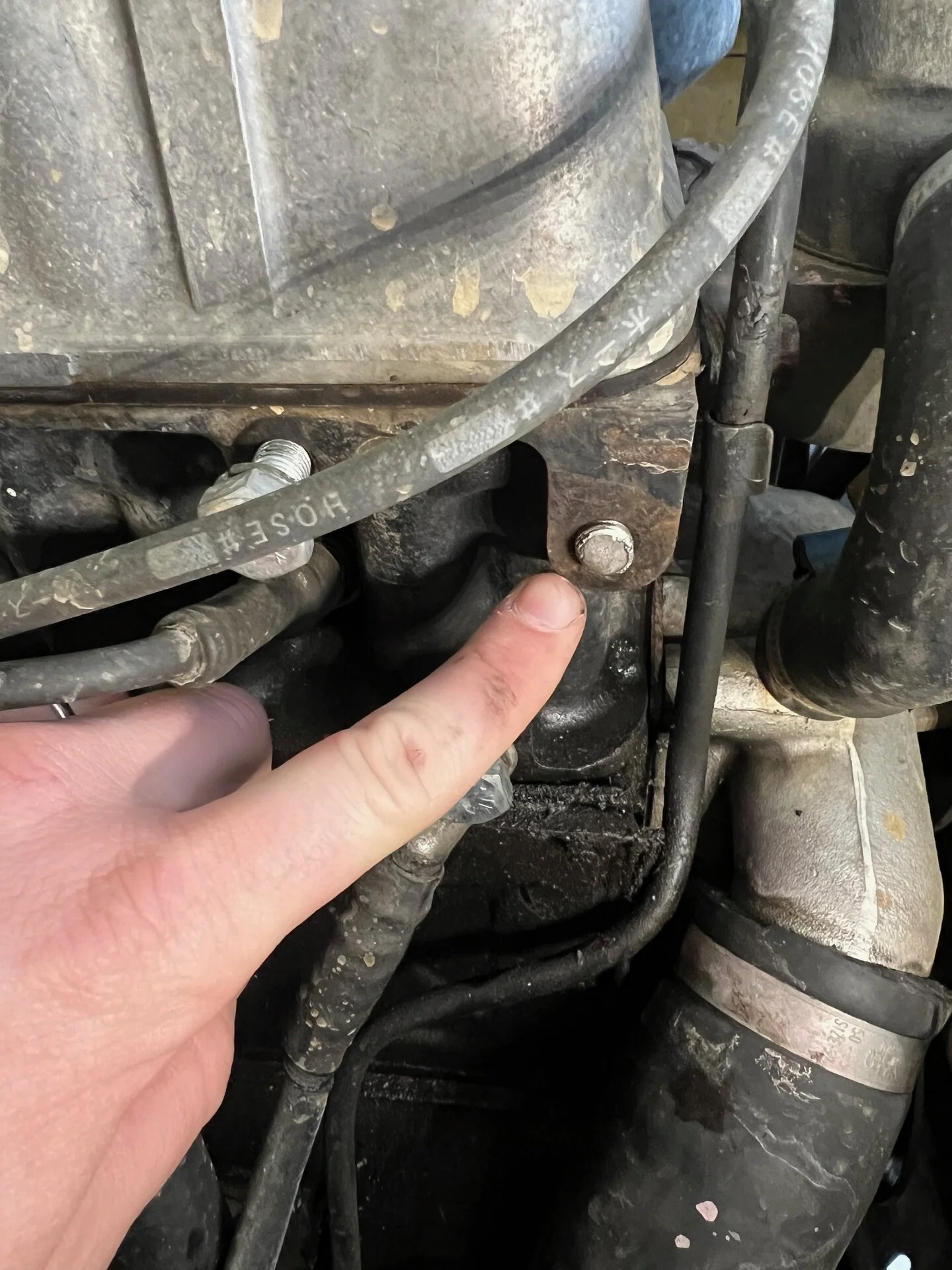

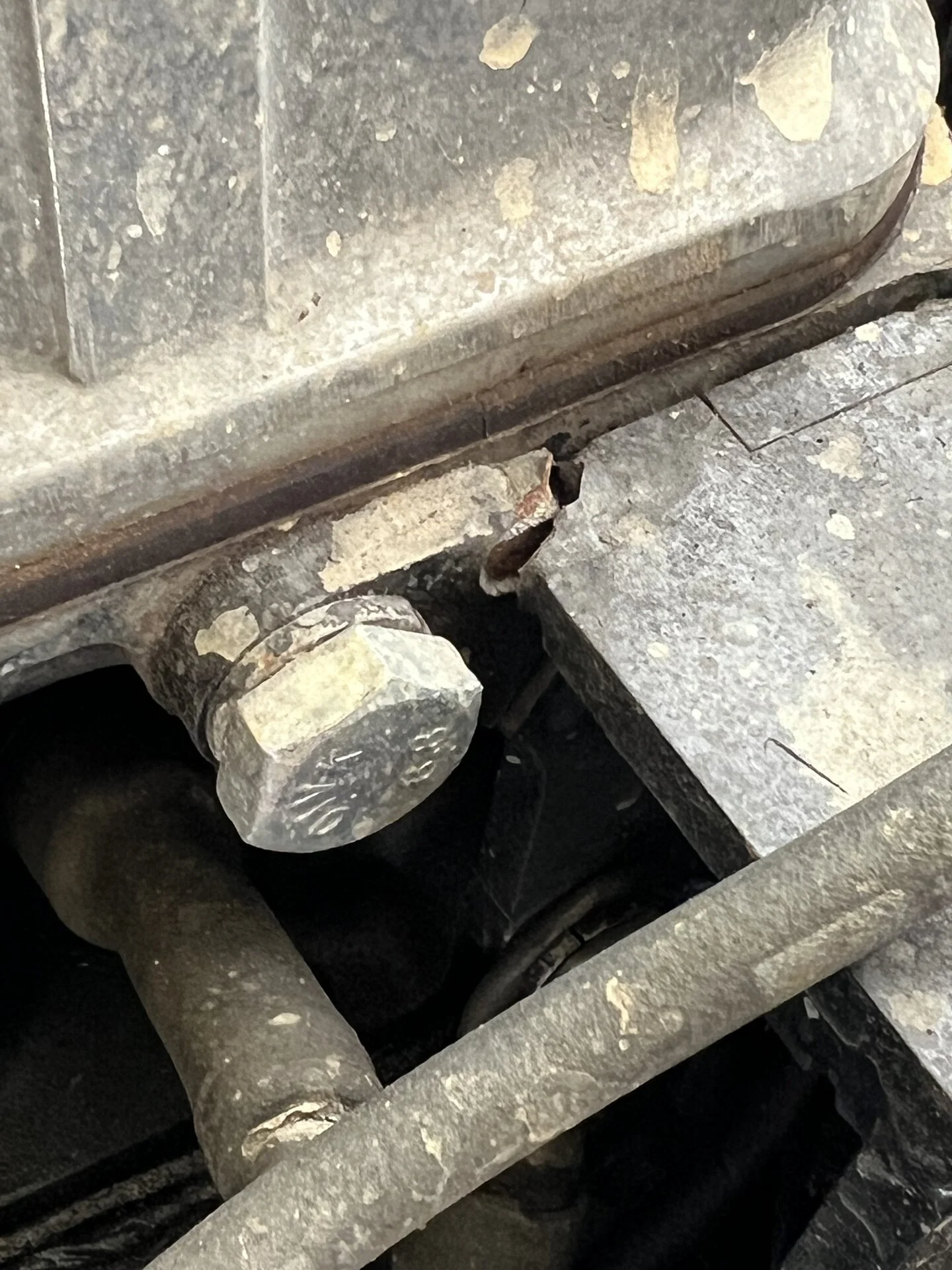

i purchased my system in summer of 2022 i believe, and received it later that year. i am using the bracket they supplied that holds the oem alternator, just below their compressor. good info on the factory ac battery bracket, i have already started looking into this. in my opinion, this crack is due to stress and leverage. its pretty difficult to get enough tension n their compressor because they dont have a tensioner. in fact, its a big pain in the arse. that paired with the compressor sticking out forward of the mount put a lot of stress n the bracket. i should also mention, i found one of the mount bolts sheared in half, the head gone and the stud still in the block (very forward hole near alternator), i believe when the bracket broke the initial snap probably broke that M10 bolt.

yeah, not really concerned with the brand of bolt. it only broke because of the VA bracket snapped in half in the first place. i have a stash of M10 factory hardware in a bucket somewhere, i may dig some out and use this go around.
