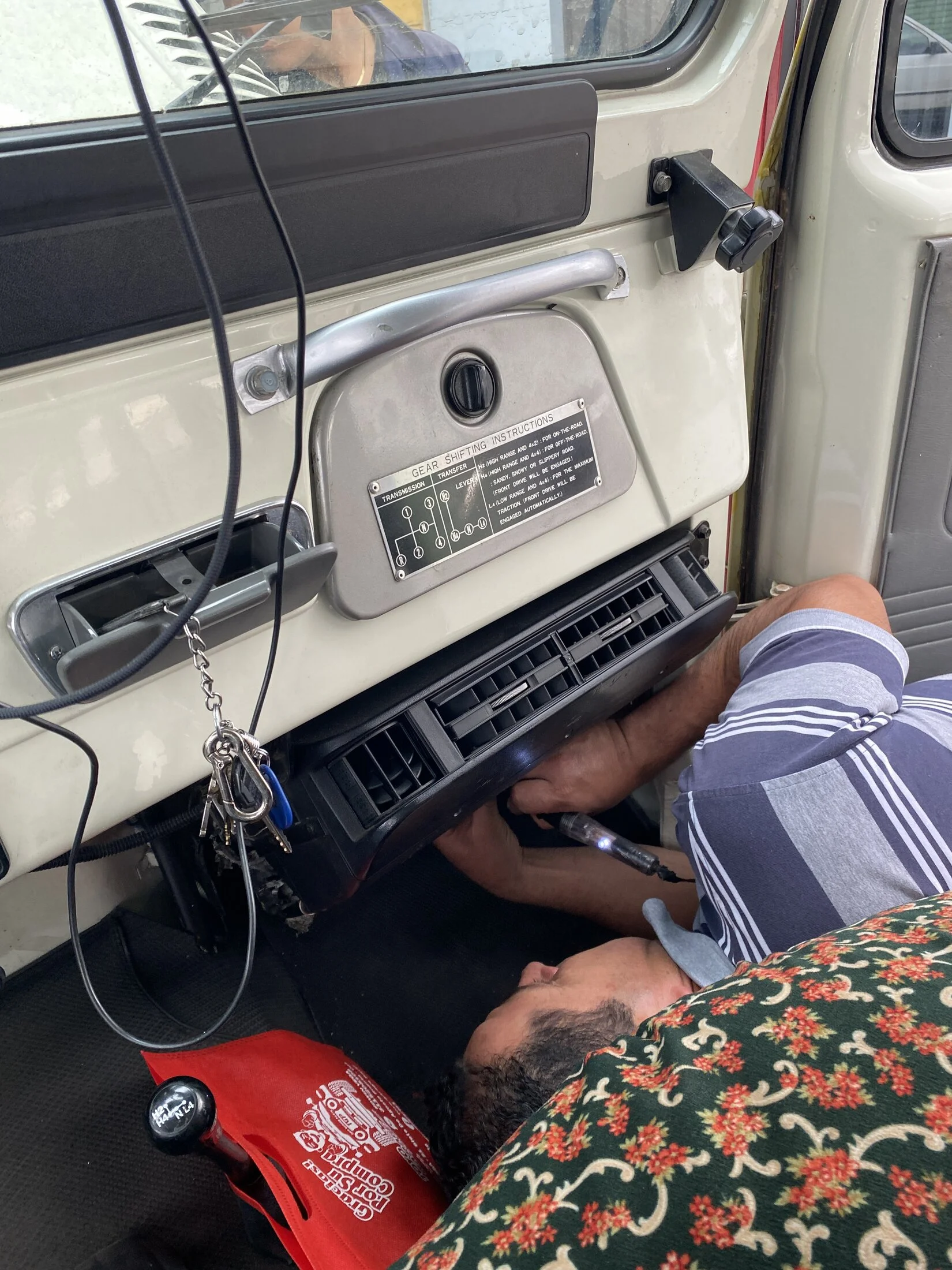

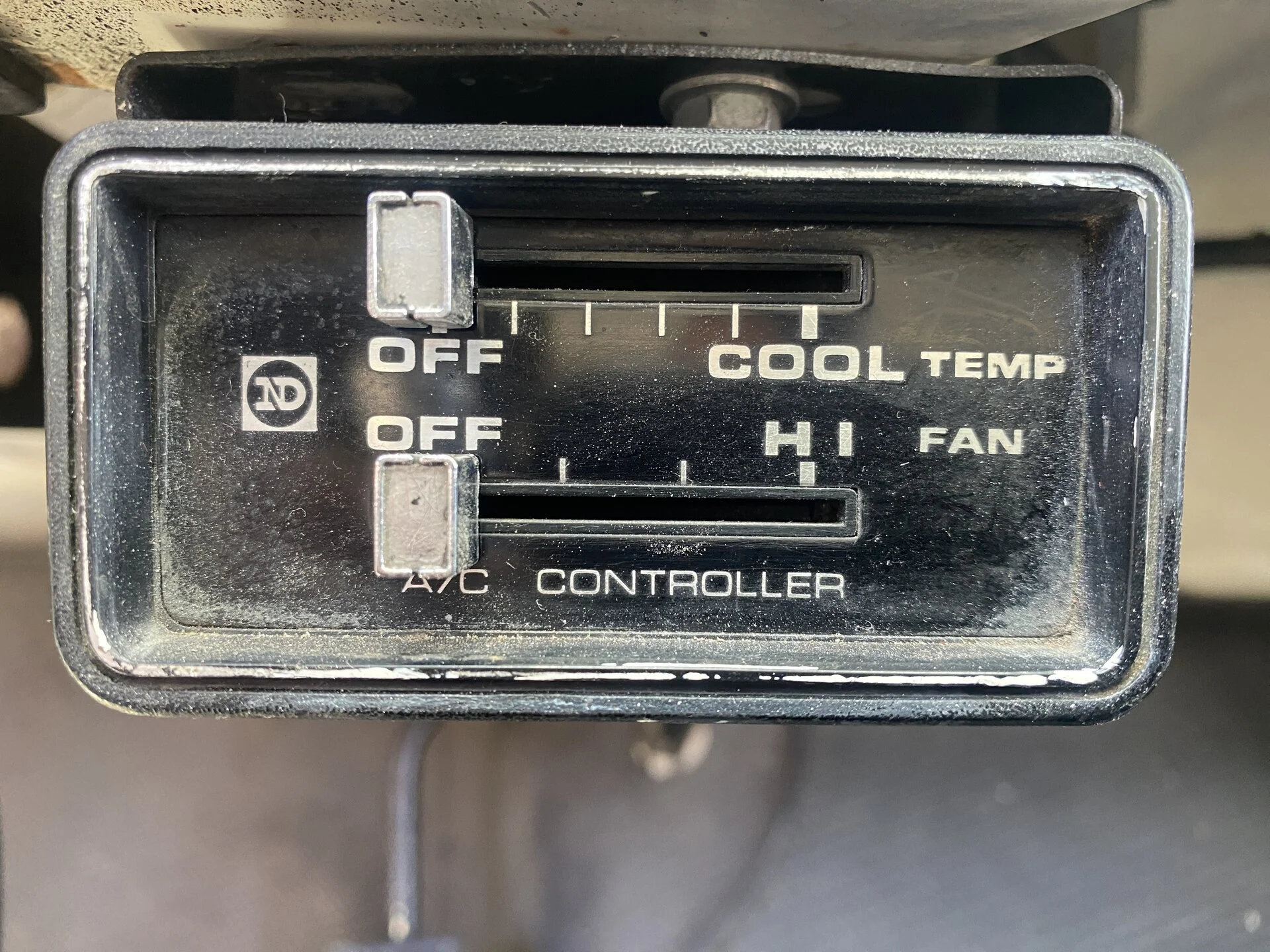

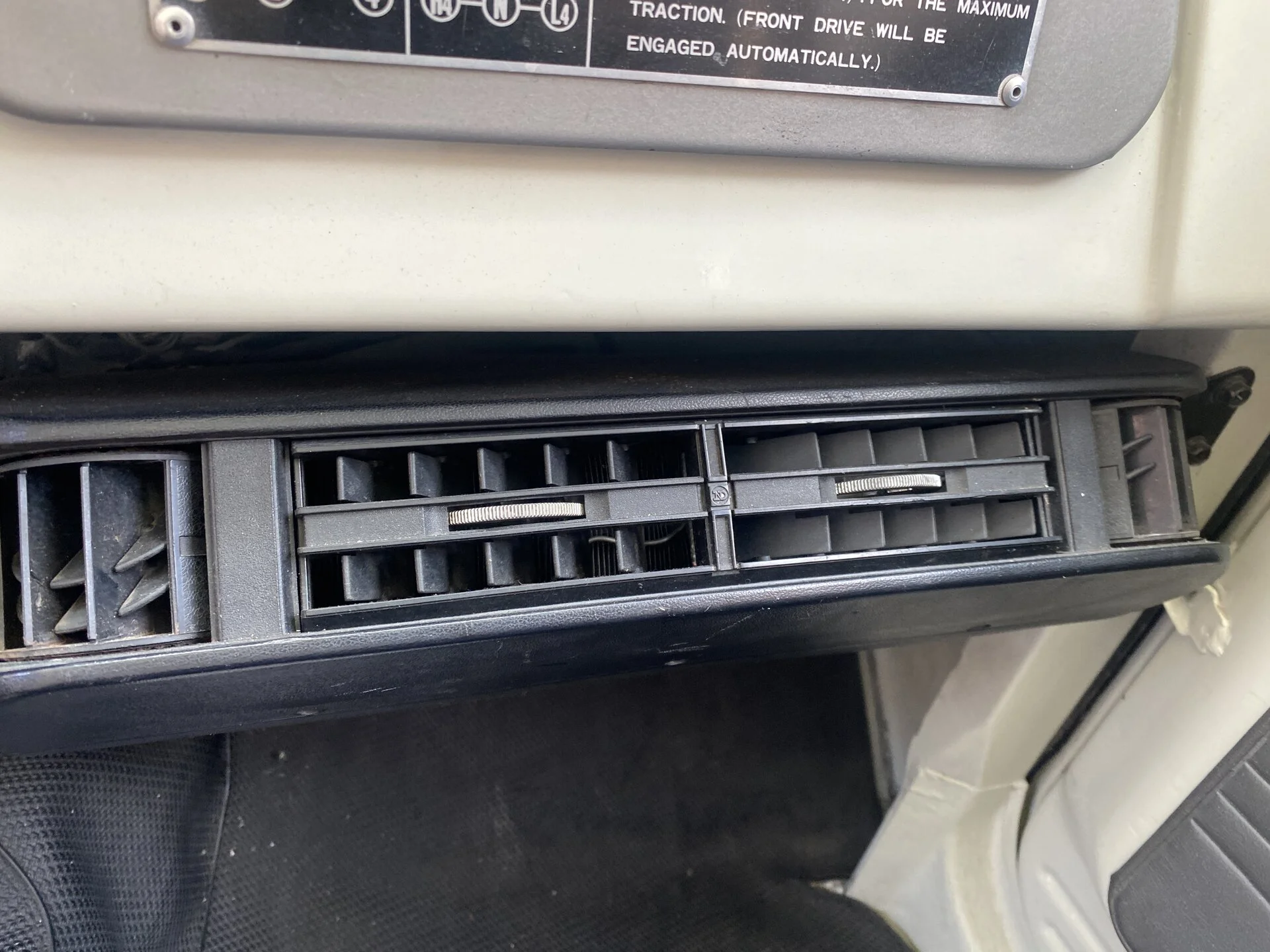

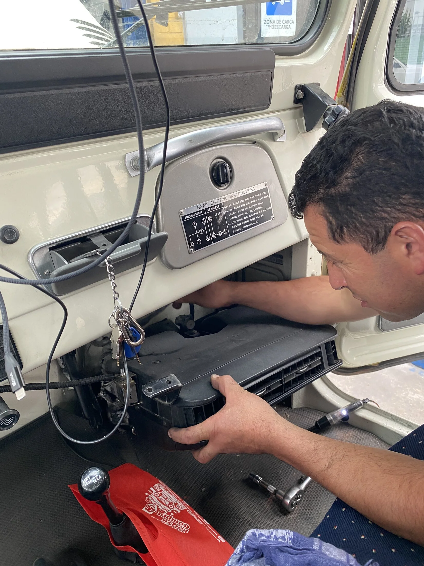

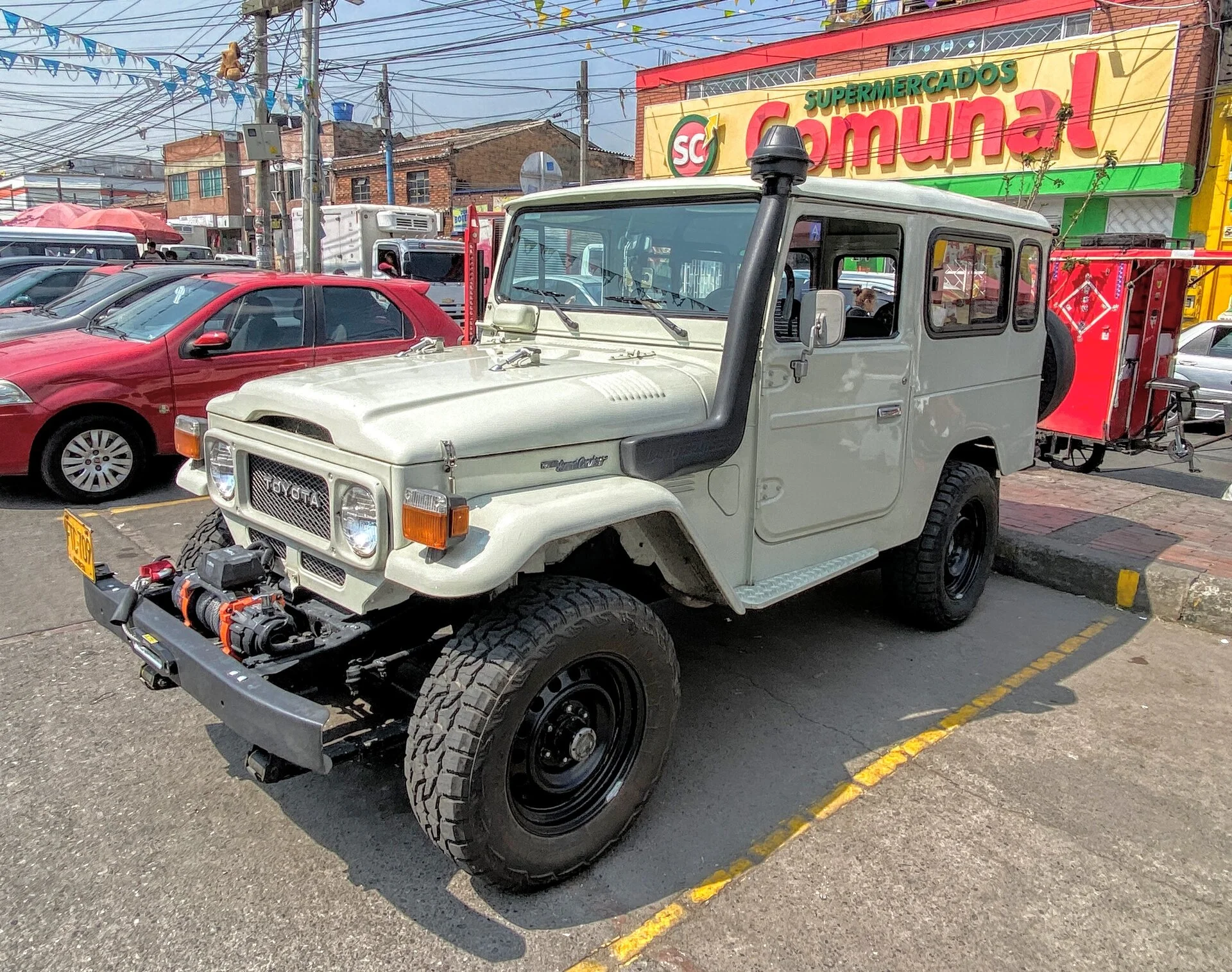

Hello, I have a 1981 FJ43. I’m return to Florida in a few months and will be importing my truck. Currently I have a vintage air system (A/C unit) in my truck and all the parts are there. I want to get it running before returning to the Florida heat. Right now the system is non operational. When I bought the truck the blower was running, but the A/C would not engage or blow cool air. Now that I’ve finished the body work etc, I’d like to tackle this project. Where do I start? Thanks.

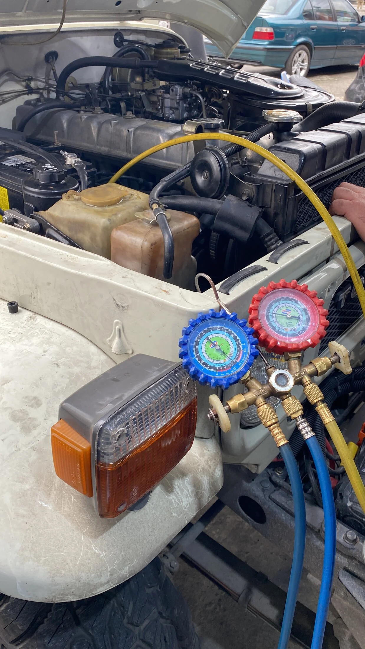

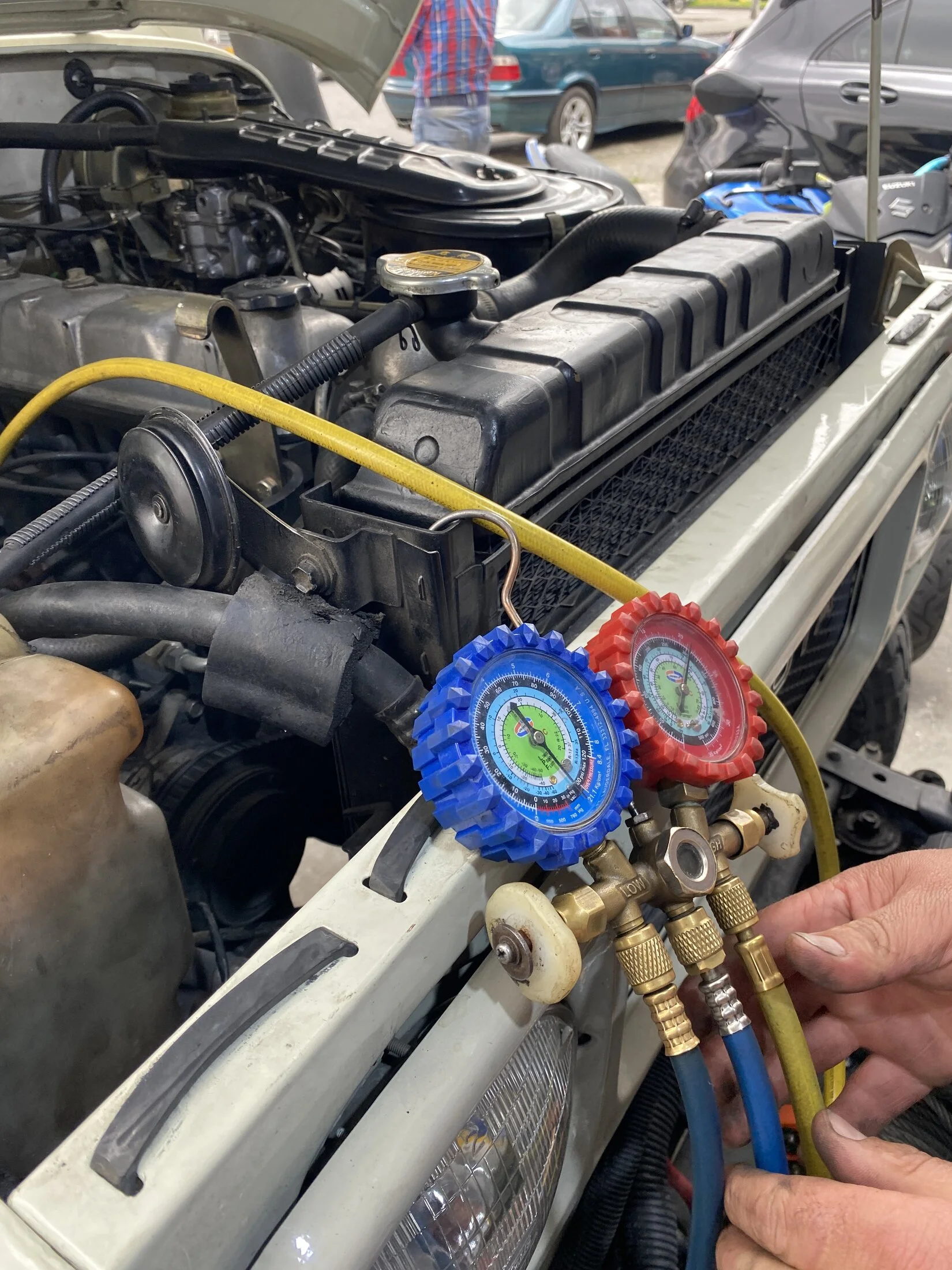

A vacumn needs to be pulled and checked for leaks, we will also charge with nitrogen for a leak test
when the system is charged, there is a low pressure switch if the charge is too low and a high pressure switch if there is blockage and the charge gets too high
is there anyone you trust that can do the work?
