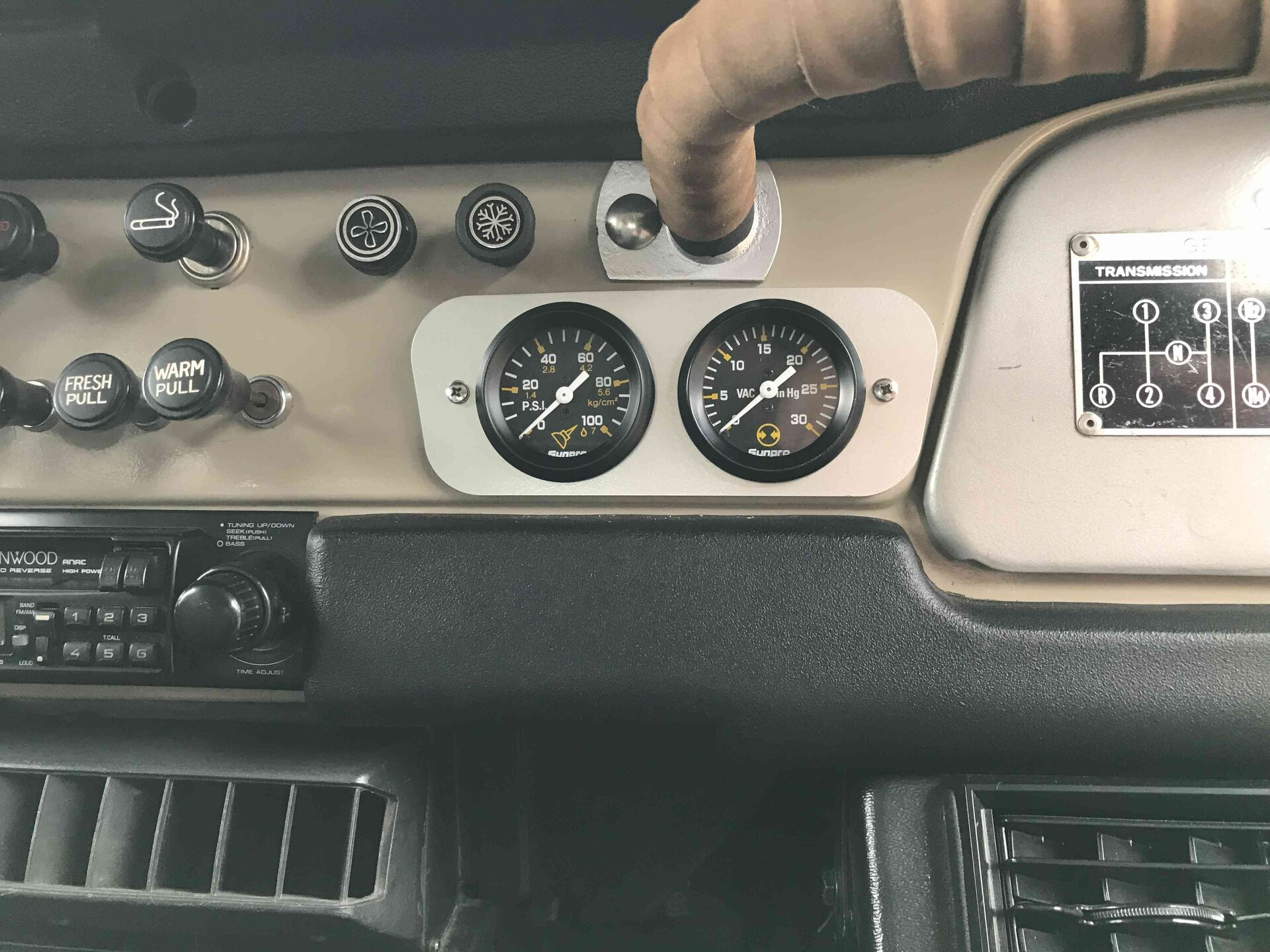

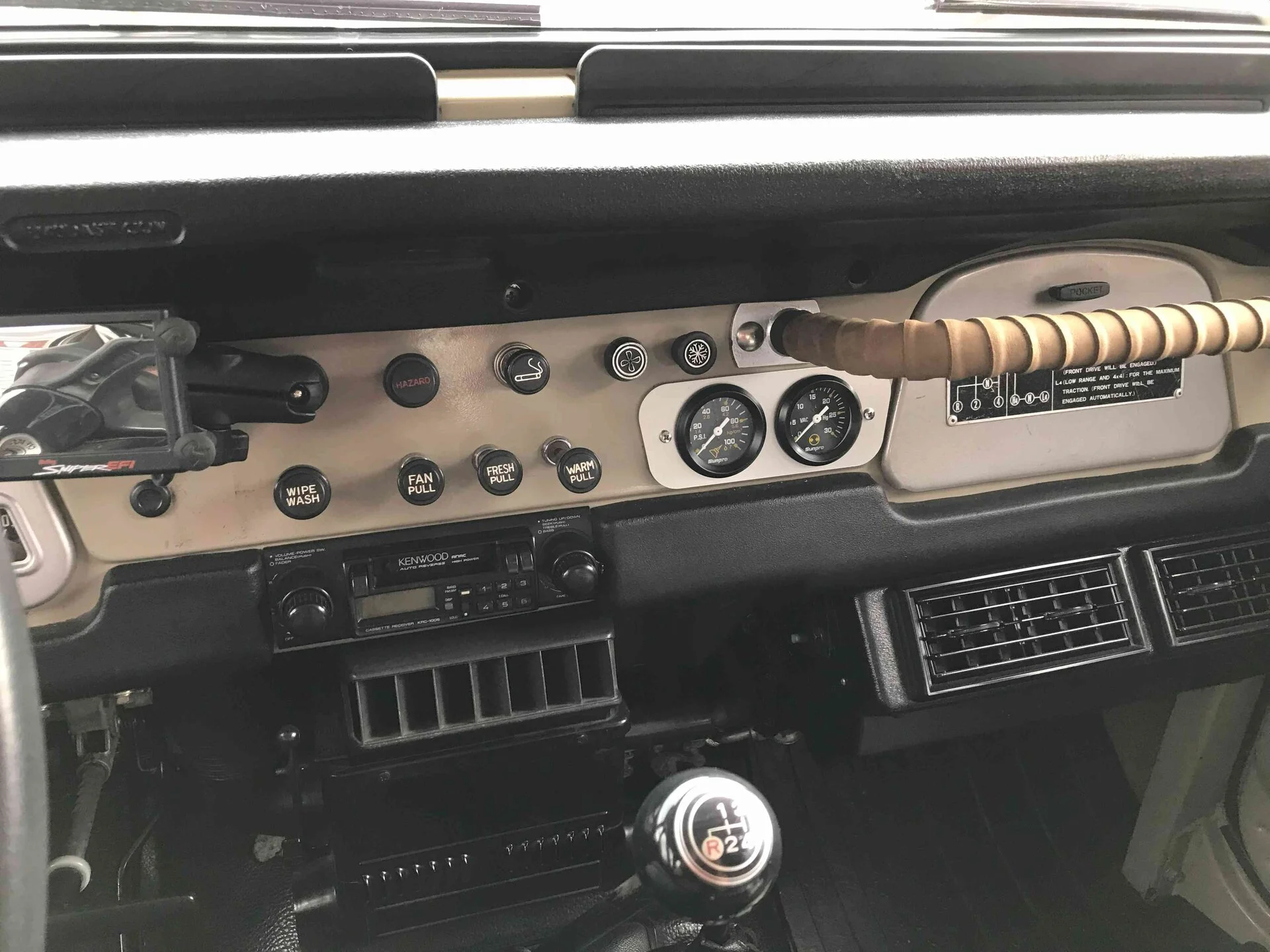

With an unnecessary ash receptacle, I just purchased a dual 2" gauge plate and these vintage gauges. I have since installed some of the autometer angle bezels for a better visual from the seat and ordered some new Veethree gauges. Once they get installed, I'll update my thread accordingly.

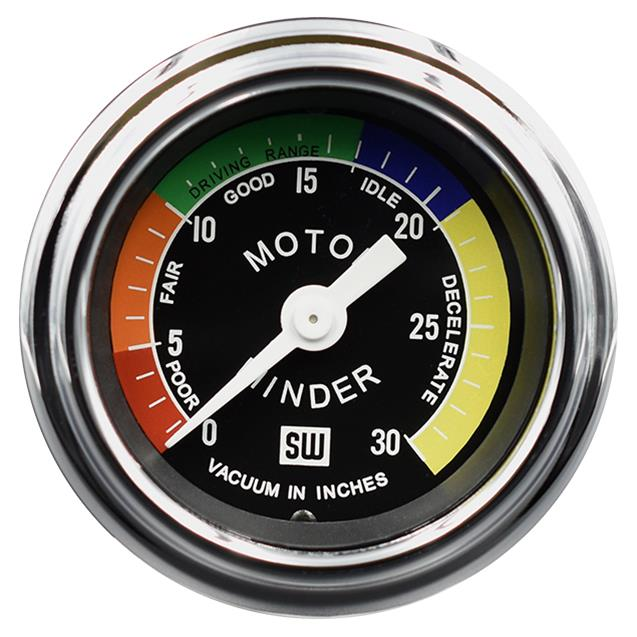

As for using the vacuum gauge, below is a Stewart Warner Motor Minder Gauge, aka Vacuum Gauge. I believe keeping the FJ40's 2F in green while driving would be the equivalent of how the 'eco mode' light works on my Corolla. (Yes, I'm aware it isn't the same gas mileage/nor the same engine/nor the same vehicle....just showing how the gauge works.)
Something about that motor minder gauge I like. Interested seeing the Veethree gauges installed on your rig.

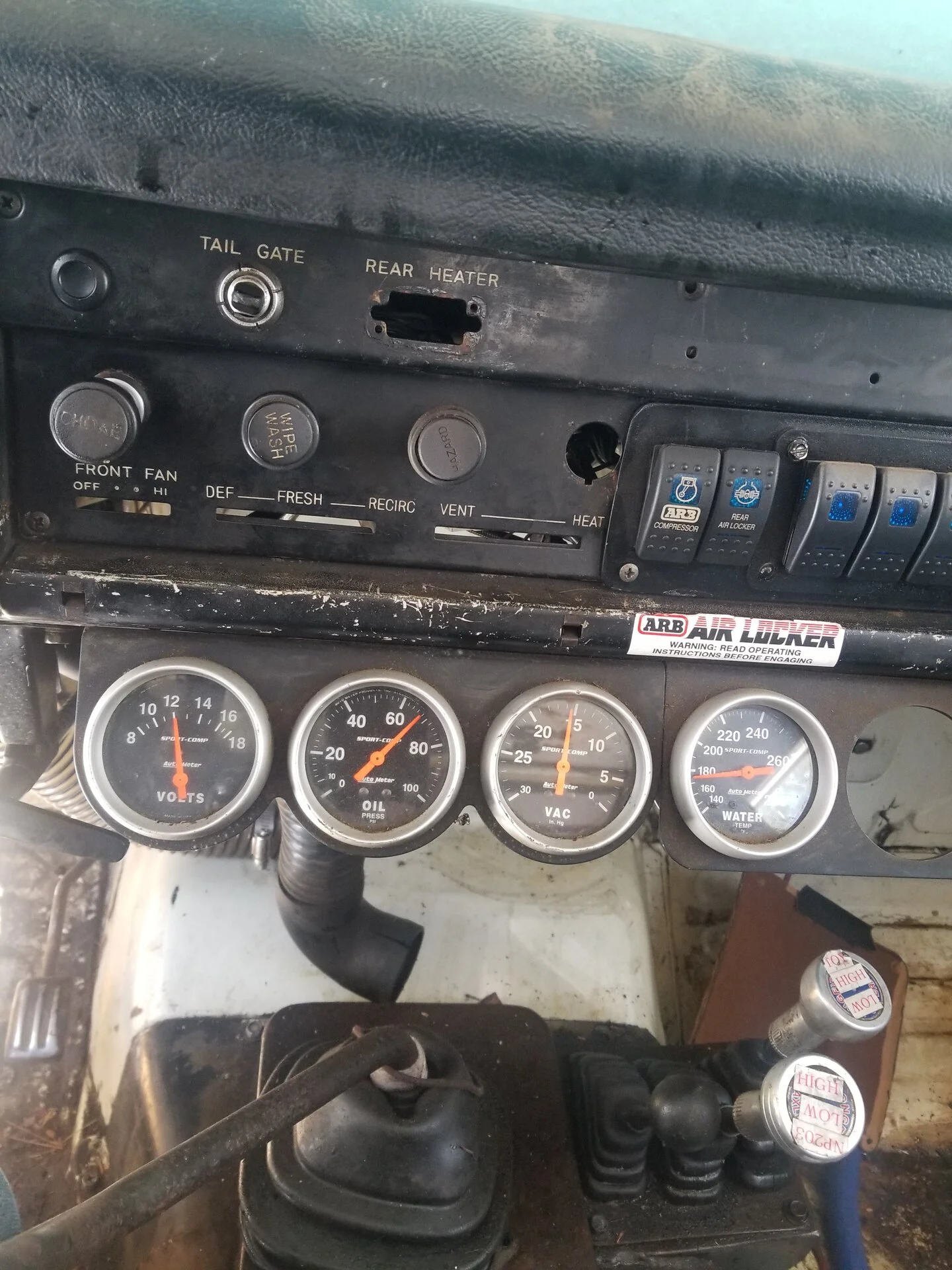

I have vacuum guages mounted in most everything I drive, especially my Landcruisers. And I have installed several dozen in customer’s rigs over the decades. Why? Because of the solid lifters.
Unlike most people on this forum, I drive my trucks very long distances. Things happen under extended hot driving conditions. On several occasions, the needle has started to flicker long before there is a ‘noticeable’ problem. Hopefully, only a valve adjustment is needed. But if you don’t catch the flicker because you don’t have an in cab mount, things can escalate long before you reach your destination.
In 1994 I learned the hard way that the distance between a flickering needle and a burned valve is less than 90 miles.

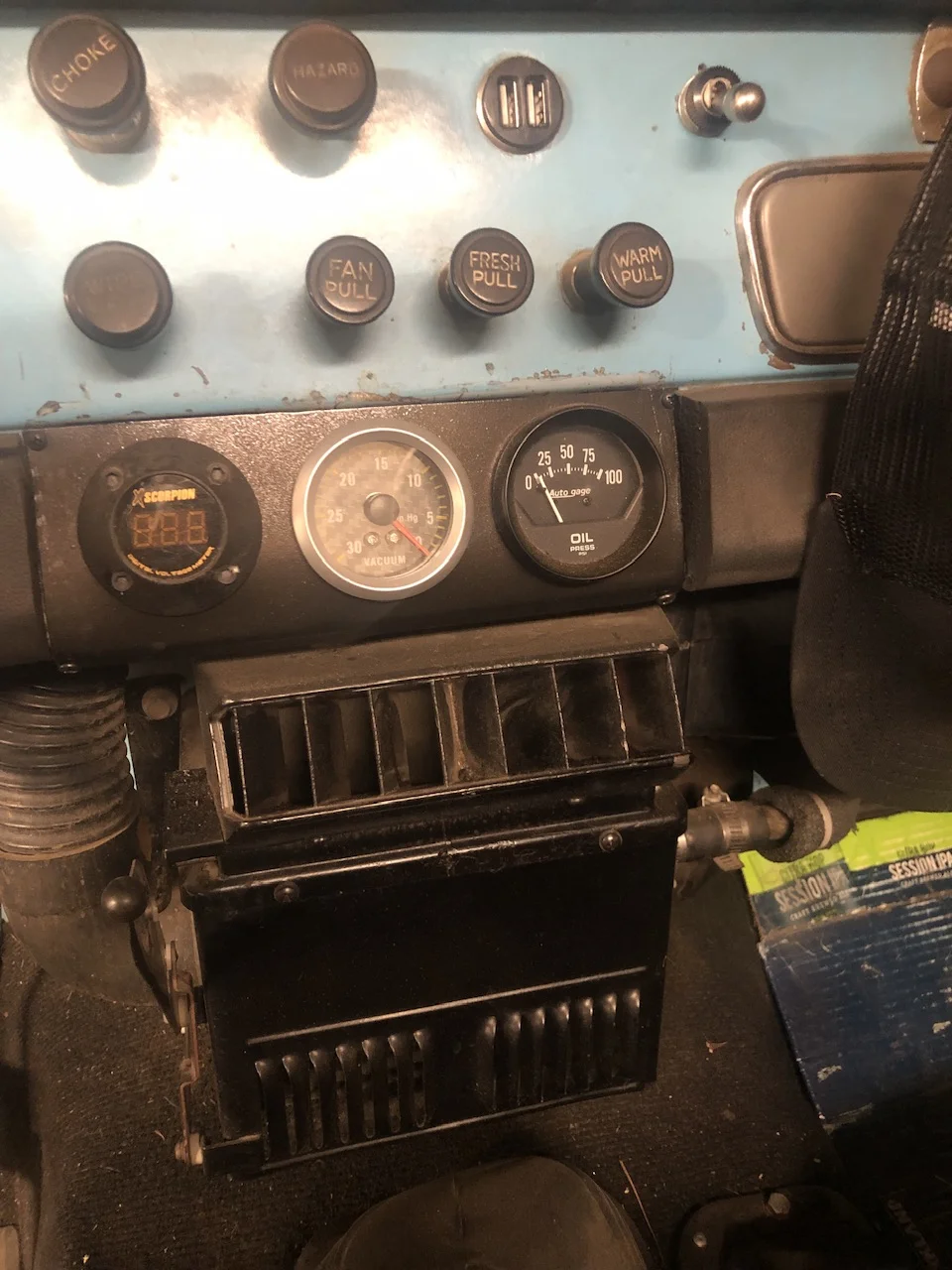

I stuck a vacuum gauge in my center console . I drive this truck up a big hill regularly (Mt. Lemmon Catalina Highway) from 2500 feet to 8000 feet.
The vacuum gauge indicates how much gas pedal the engine wants. There is a sweet spot shown with the gauge…. If vacuum drops to zero, you’re giving it too much gas.
Easy install.
Some bonehead had already cut a big gaping hole in the dashboard for a radio that didn’t work. So I just made a little face plate.
