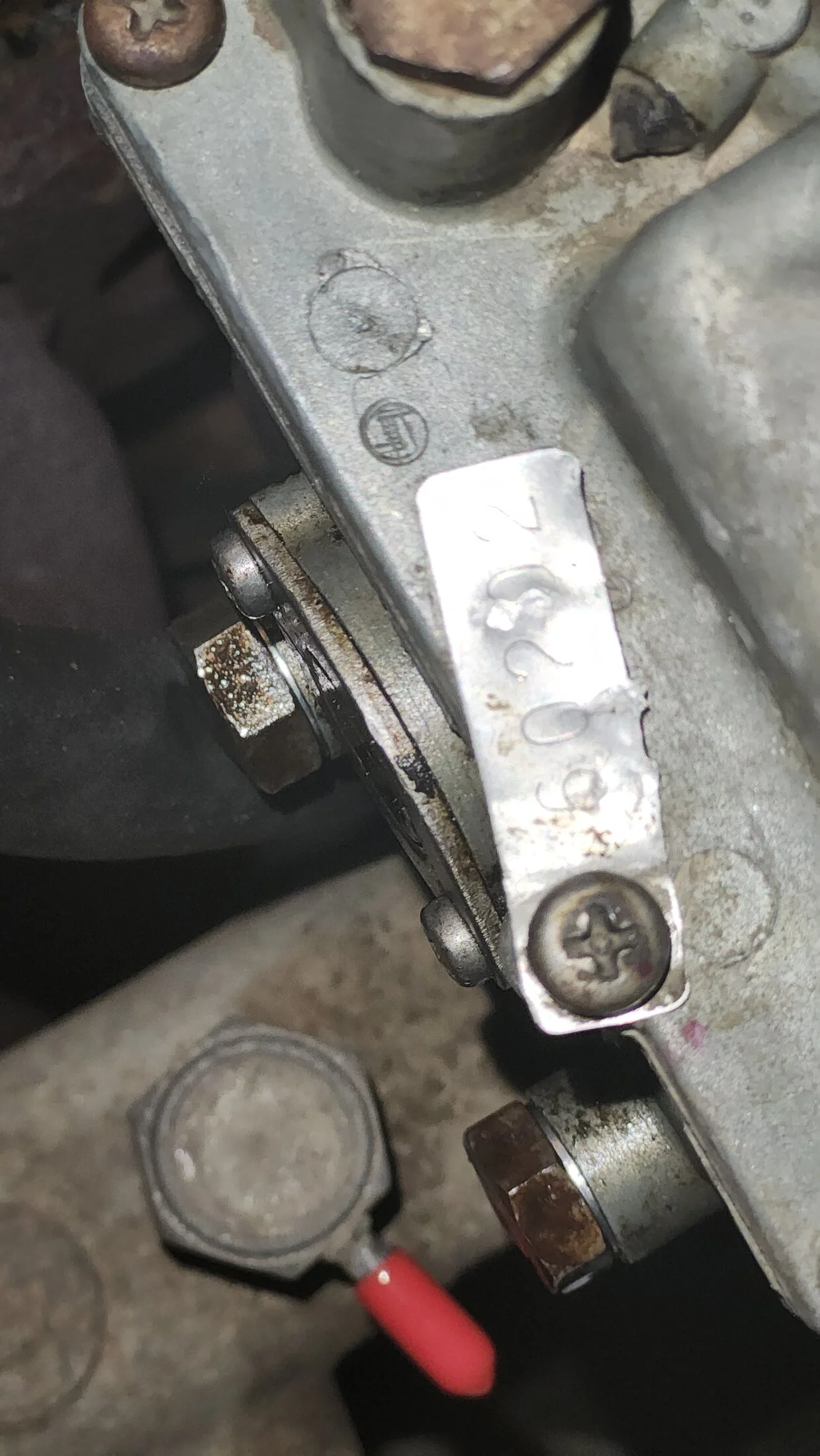

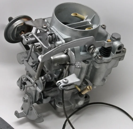

Also. My carb appears to be different than the image shown. The diaphragm linkage only connects to the choke and doesnt have the throttle positioning link lever shown also connected to the diaphragm. Not saying over the last 53 years something wasnt put back together wrong, but not many have worked on it. It's a stock April '72 carb i believe which is sounding like a transition period from cruiser outfitters.

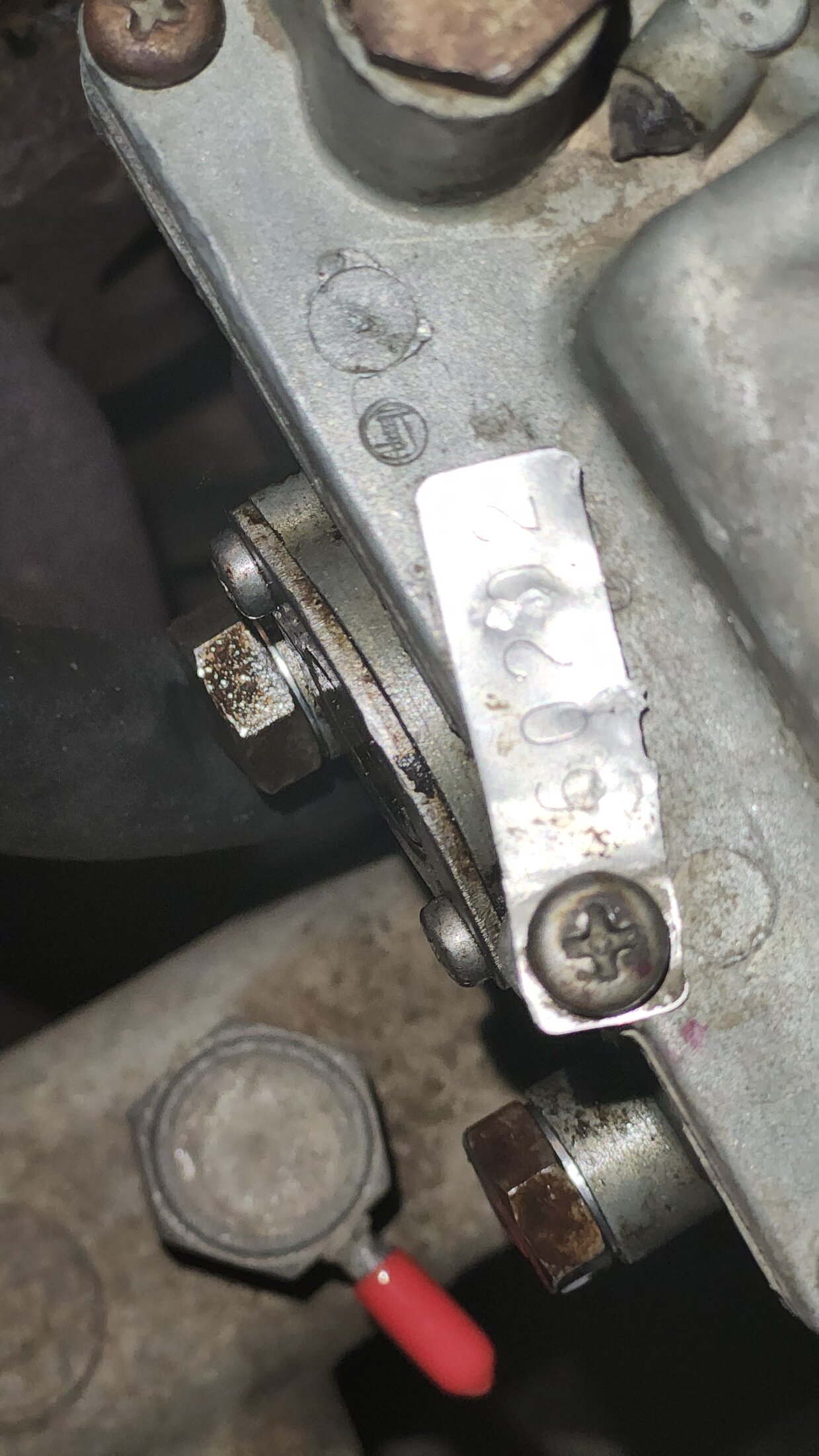

It's pretty beat. But there...

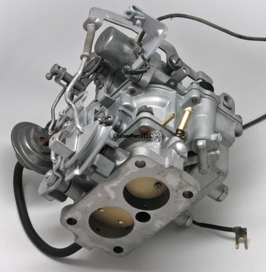

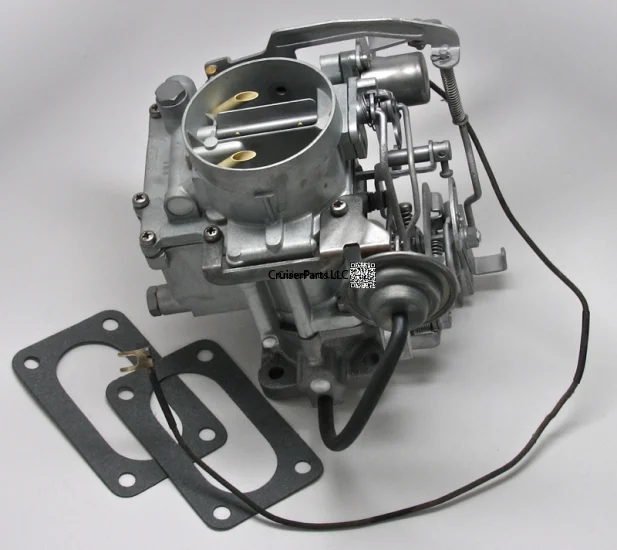

The place i quietly just low-jacked these for tech. use reference here only purposes pics clearly have it stated its a 21100-60202 ...
your thick aluminum ID tag does sa
y 60202 right .,? hard to say 100% ? but i say it does :idea:
however , i am not well versed if this is your carb exactly or not ?
all i do know FACT : is it is a
F1.5 2bbl
only @65swb45 and you know for sure ........
i know also FACT : @Spike Strip has a NOS 21100-60202 he can pull from his complete every single USA Spec. NOS 21100- 's 1962-9/87 all lined up in numerical order inside the cozy dust-less black velvet top adorned solid Cherry shelves of Mrs. Alf's former Glass double Bifold Doors Former Dinner Ware Hutch .
