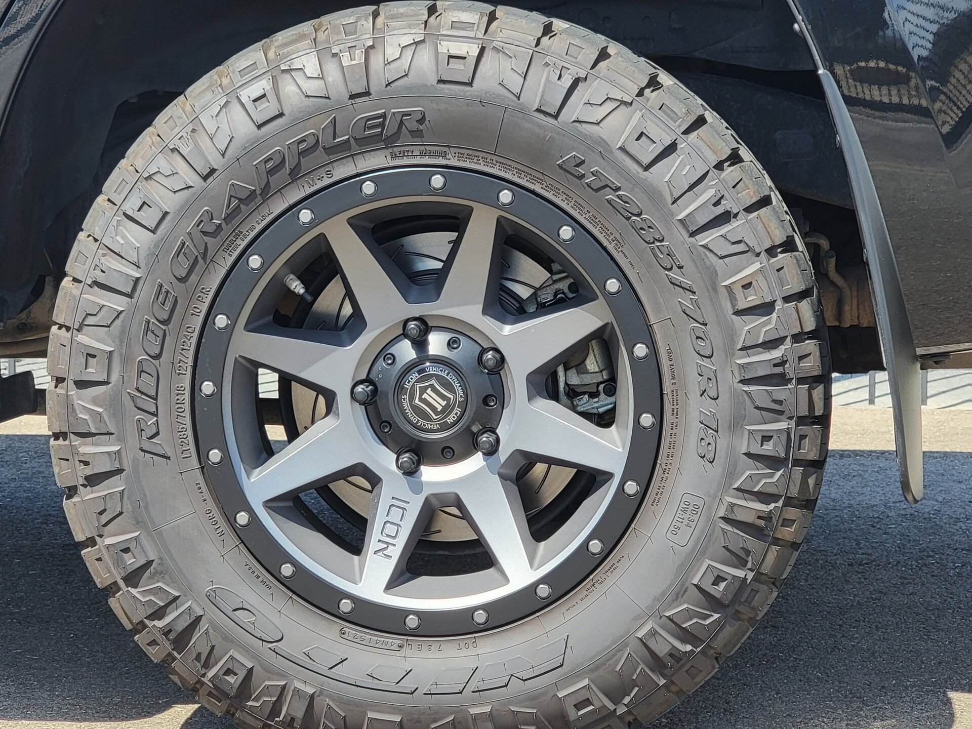

One thing to be watchful for on the BBKs is the clearance requirements for the calipers - often requires larger wheel diameters. Not sure of the situation here on the 200 exactly, but something to do the math on.
I ended up doing the D-Line PowerBrake rotors with their pads and all new OEM calipers at 115k (2 were seize) and I cannot complain a bit. Feels tight and very grabby when you get into it. The modulation is constant and perfect for a big 200 even when trailering.
I went with the D-Lines because I am running the RockWarrior 17s and the full BBK or Powerstop kits don’t fit.
