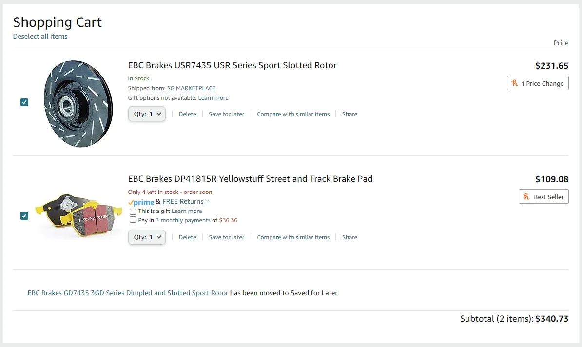

I am running EBC rotors, EBC orange pads and SDHQ braided lines. Definitely a noticeable difference in braking performance. Added benefit is that modulation is improved as well.
Very pleased with my EBC setup, i have some intermittent chirping in the back (i have yet to disassemble to figure out) and i can get squeal on very very light friction with my yellow pads when the rotors are hot but thats it. Otherwise fantastic thus far.
They even make a yellow stuff “truck” pad now.
I will say the cheap stoptech lines I put in are already showing wear up front. Not happy with that.
