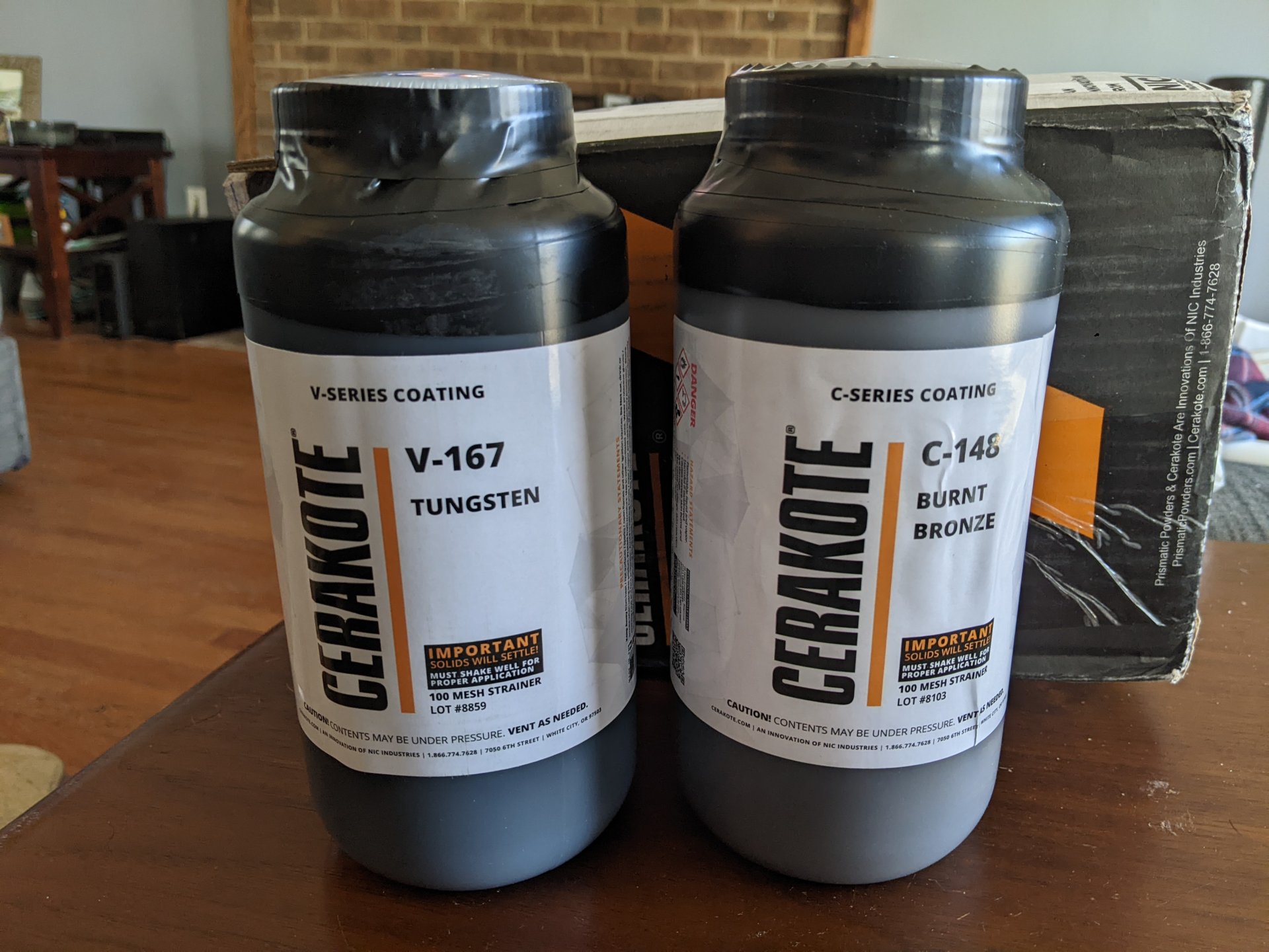

Good to know, that saved me a load of grief. I also didn't know I could Cerakote myself. More good news! How do you do it? All I can find on their website is "call us for pricing".
Found the color page! That's an insane number of options! I'm going with Prison Pink for Charlie's headers and Stormtrooper White for mine. :rofl:
...and it'll stick to plastic! Now I have a solution to all my flaking PVD chrome. And a coating for my LX570 wheels Toyota covered in worthless paint.
Thanks, Johnny!
There's a ton of info on their site including application guides. The process specifics depend on the coating, but in general:
1. Degrease
2. Sandblast with al-ox
3. Bake at 250* for a bit to get the trash out
4. Degrease again
5. Spray cerakote with hvlp gun
6. Air dry for some coatings, or bake on at 500* for a while.
DDone!

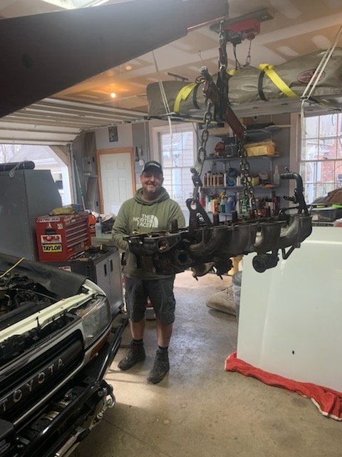

Well, the easy part's done. Only broke 3 sensors on the way out. Head's in the shop and is promised by Friday.
I decided to pull the engine wiring harness down through the lower intake, instead of pulling it up. I just do things like that.
It would have worked well, if the intake side of the engine harness hadn't been rotten as a November oak leaf. Now I'm short three sensors (yes, one of them is the rear knock sensor) and the Engine Coolant Temperature sensor connector housing, from the harness side. That thing shattered and crumbled when I touched it.
Here's what the block looks like; I'm hoping the crap in # 4 & 5 came out of the bottom of the head.
Note the massive coolant crud caked onto the transmission connector. And Charlie wondered why his gear indicator lights didn't work.
Here's a little surprise I found waiting for me, under the intake (that appeared to have dripped down between the injectors). A look at an unknown oil leak, ABOVE the oil filter (that's a new one on me). If you look close at the photo above the oil filter, you can see the ECT sensor connector housing, or what was left of it, prior to lifting the head (it's the frontmost sensor on the head).
