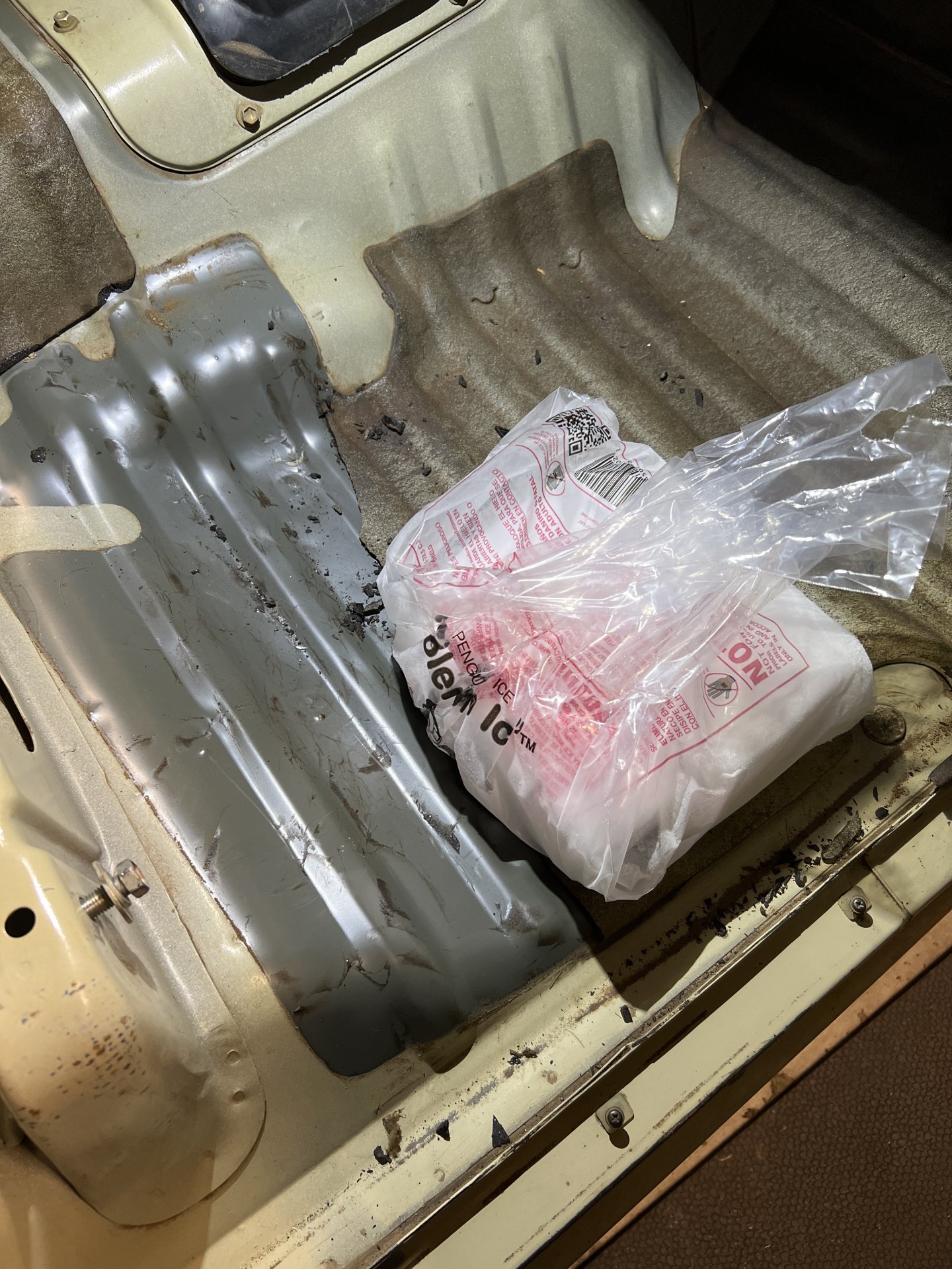

Well I’m not out in the snow today but I’m working with ice. Finishing stripping the factory insulation out in preparation for full sound deadening and new carpet kit. Lots of work being done on the truck lately.
Dry ice makes it so I can strip this passenger section clean in less than 10 mins.
How are you using the ice? Hand-held blast gun?

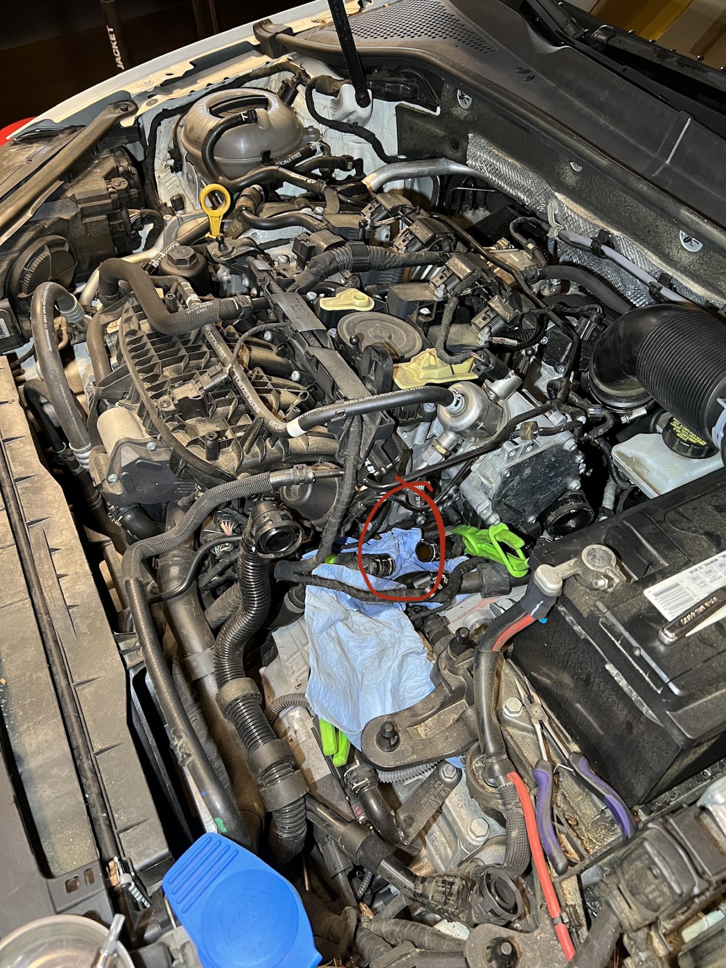

Not cruiser related but I was reminded why I don’t miss owning German cars with their “creative” engine packaging.
My wife drives a MK7 VW Golf SEL and I had to replace the heater valve that electronically opens to allow coolant to flow to the heater core. Car was taking 20-30 mins of driving to start producing heat, long after car was up to temp. Buried under everything and not much space to work. Think it’s time for a water pump though…which VW decided to put under the intake manifold
I worked on one of those once. Just once.
