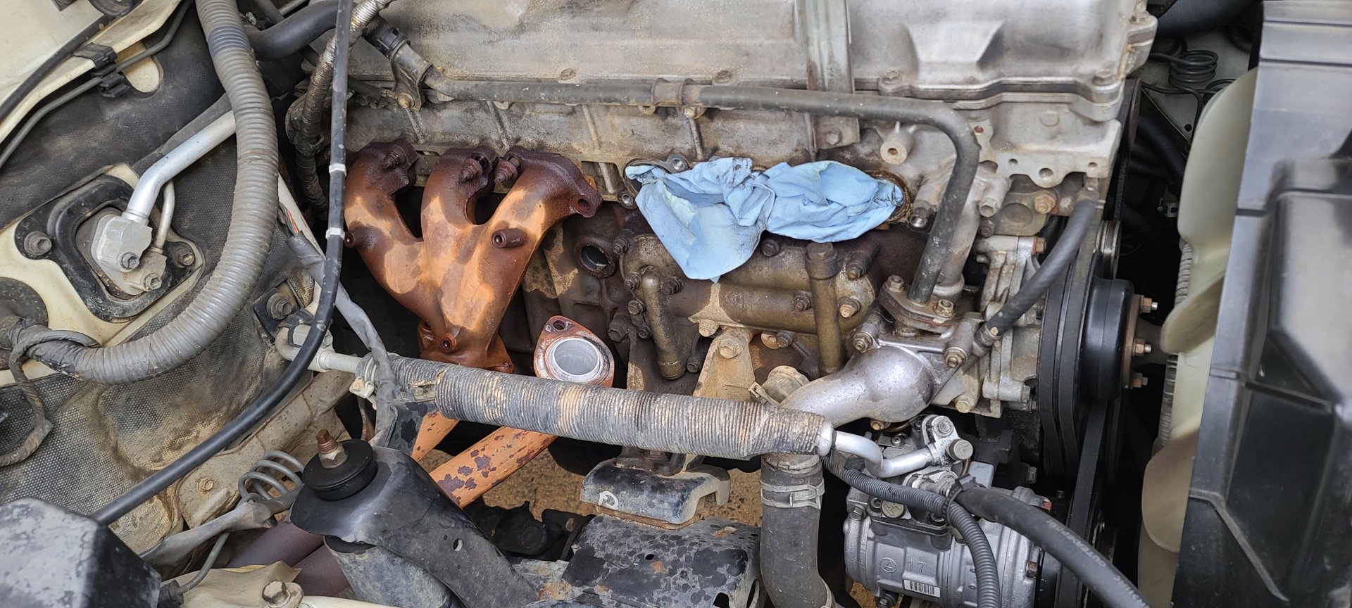

FZJ80 head gasket R/R:
What's the preferred tool for removing the upper/lower, rear exhaust header nut/stud? Really long 14mm ratchet wrench?
Any way to get an air tool in there? Without removing the transmission cable and A/C line, I mean.
I tried a std 14mm impact socket and swivel on the lower, but it won't turn far enough for me to get the extension in it, and I can't reach the upper at all.
I've unbolted the front header and removed the nuts from the lower rear header to the pipe, so, if all the starts line up, the head can come out with the rear header attached. Maybe.
Poor image, they're behind the kickdown cable, in the rear corner.
I pulled mine with both exhaust manifolds and the lower intake manifold attached. It wasn’t a problem.

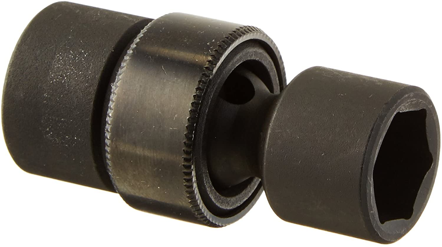

I'll try that; my 1/2" wouldn't clear.
I used the same. Socket on a swivel to get to that back set. Rices we use a short swivel. Steve’s I think we put the swivel on the nut then attached the socket or extension.
