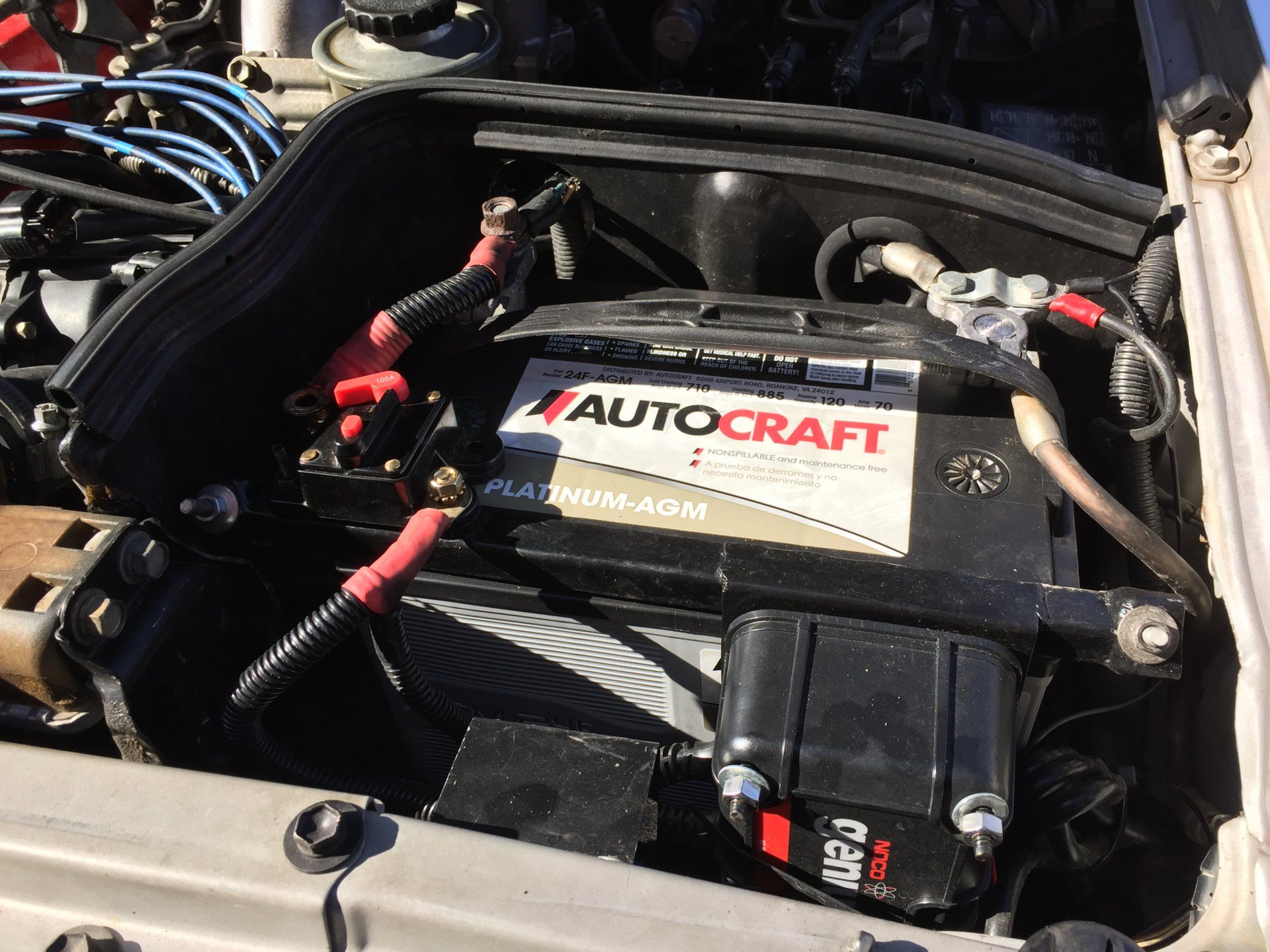

Finished engine bay shot. Moonshine is back in business!!

Brit got called in so we got in the 80 to drop her off and..click click. Battery sitting at 9.2 volts. Used the Aux battery to crank it.
My current battery is a Gold Advance Battery installed at 5/2015, so it didn't last nearly as long as expected.
My question is what battery should I go with, I'm thinking AGM. I'm hesitant to put an Optima in there, and there is a lot more AGM options available today than there was in 2007, Last time I bought an Optima.
It used to be that Die Hard Platinum P2s were rebadged odyssey batteries, but that is no longer the case.
@Cruiserdrew clued me in to the fact that Duracell batteries are rebadged Deka batteries, which are on the same playing field as Odyssey. You can find them at Batteries Plus Bulbs. No personal experience (I have two of the Die Hard batteries referenced above, AGM, going on 5 years with them, nothing but praise).
retailmenot has batteries and bulbs coupons. the batteries and builbs website also has coupons that may also work on their vehicle batteries. I almost went with a pair of those in my camper, but they didnt have any in stock in my area, and i needed them right then
$40 later, back in business. Went with a Autocraft Platium AGM. Advance was going to swap it for free, but I asked about paying the difference in upgrading.
I called my brother, who worked at Interstate Batteries, he said Johnson Controls makes them so it should be good.
I know it's good though because It also passed the @JohnVee marketing. No crazy font with “extreme” anywhere or pictures of wild animals ripping through it.

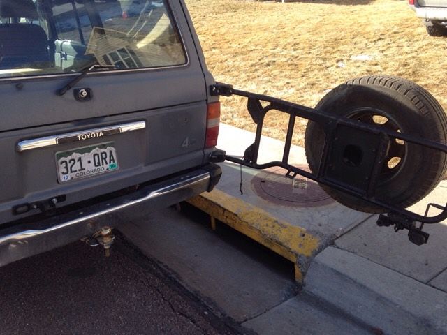

Hey does anyone have any ideas how to strengthen something attached to the body? I'm gonna put on a tire carries that attached to the rear passenger side. I did this on my last 60 and just used some 2 1/2" washers going to 2" down to 1 1/2". Outside of that all I can think of is a maybe making some kind of backing plate but not sure how big or think it would need to be to be effective.
I'll see if I can't find a picture of what I'm planning for your viewing pleasure
So you can see I used washers and that was it. I was able to hold my weight on it and swing out without any issue but I wanna make sure I do it better this time If I can.
Don't do it, man. Either get a tire carrier bumper or relocate the tire to inside the cab (I fabbed an in-cab carrier for less than $30 with 1" square tube from Home Depot). I did see this little ditty a while back and it seems like a decent option if you have a receiver for a hitch.

Here's my home-brew solution:

@roadstr6 so please don't take this as I'm not believing you I'm just curious as to why not do it this way? Is it just concern for the body splitting at the bolts or something along those line?
On my other 60 it didn't give me any issue and held me at 220lbs on the whole swing.
I think it's personal preference. I wouldn't do it either, but there's no reason it can't be made strong enough.
Grab a piece of sheetmetal and form it to fit the contour of that panel on the outside. Trim it down to cover the area where your bolts will go through. Get some 3M seam sealer and glue it in place from the inside, holding it in place with a small soccerball or handball. Deflate the ball, put it in the cavity, then inflate it a bit, making sure the panel stays in place.
Once the seam sealer has cured, drill your holes and use your washers as normal. This way you'll have a 2 ply outer skin instead of single ply and it should be much stronger.
So I want to do it but the more I think about it I see the cons. Last time I didn't care the body was crap in the back and I just wanted the space.
Maybe this would be a good project for my welding class next semester....
My wife just made a good point how mad would I be if it tore... lol

Agree. I would not want a cantilevered oscillating mass hanging off the back via sheet metal. Every bump and dirt road will be contributing to metal fatigue. Not that the OEM bumper gives you much to work with either.
Can't help but try junkyard builds that swing out cost me 15$ lol
@Rice i had that feeling in the back of my mind but the cheap side of me made me ignore it...
If I can count on mud for anything Its sound advice, good people and help spending money on new cruiser stuff!

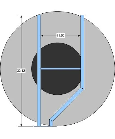

So I'm thinking about trying to make a bumper from some 2x4 steel and then build off it for a carrier eventually.
Something along these lines seems simple enough.
A few years ago I had a CJ8 with a spare tire carrier mounted to the tub like you pictured. When I bought it there was a hole the size of your fist where the metal at the top mounting point had fatigued and cracked. The PO had the whole shebang immobilized with bailing wire. I just don't like the idea. I'm sure it could be done better as Johnny said, but it would take a lot of work and it's just not worth it to me.
Forgive my crude drawing I'm neither a fabricator nor designer lol but I'm thinking of starting with the base of the bumper like in my other picture and then move up to this.
You could probably re-use much of your $15 carrier if you rig it to attach to a sturdy bumper. I would do that rather than try to re-invent the wheel. You'd just have to change the hinge point to mount to a spindle and re-do the pull pin set-up to a bumper-mounted latch. The carrier itself is probably light and strong enough for normal duties. It's just how it mounts to the body that worries me.
I had thought about that and might end up going that route if not just for the sake of trying and if I screw up welds or something it's not raw materials I have to go buy again.
