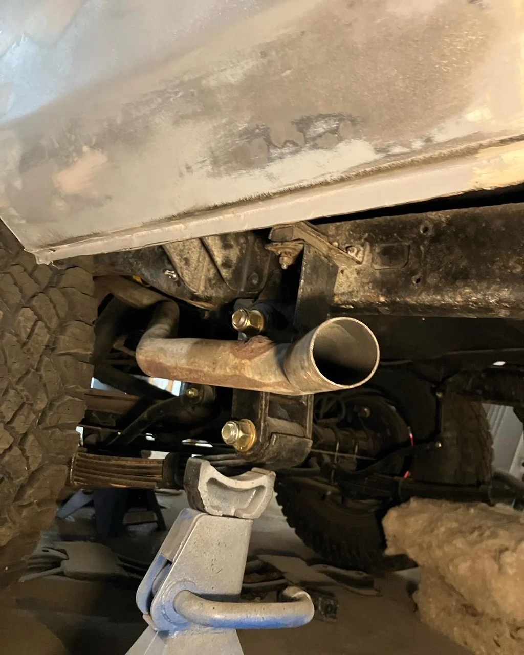

  • Exhaust installed:

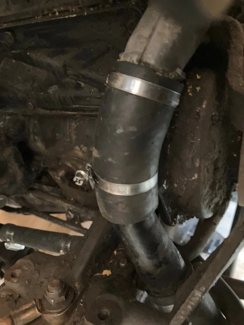

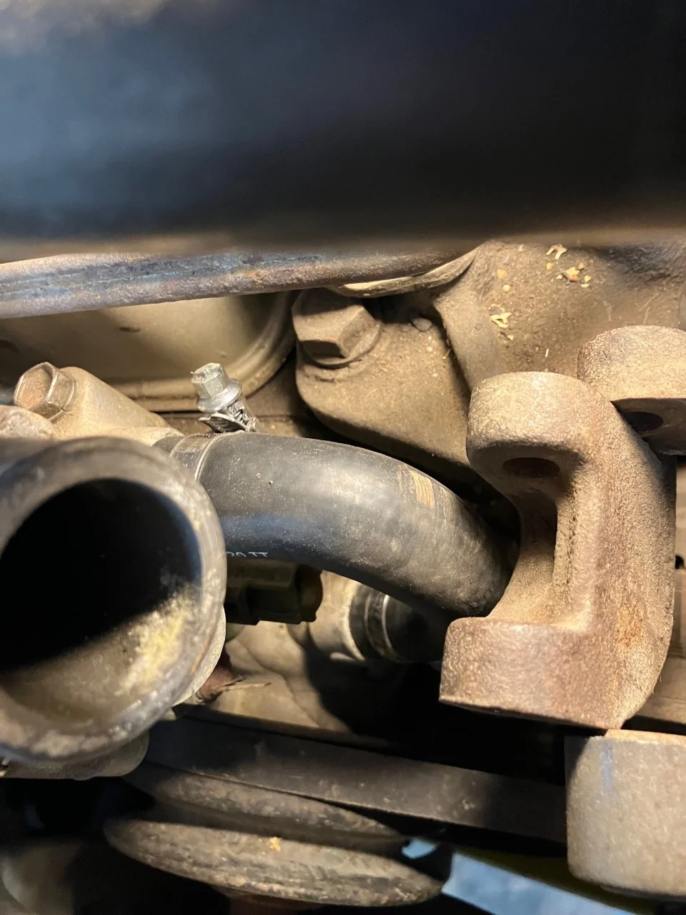

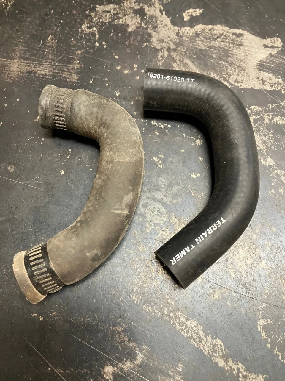

But first, some boring but important stuff: rad hose replacement. I swapped out the old, crusty rad hoses in favour of a brand new kit from Terrain Tamer. Replacing these is a pain in the arse, but I figure it's easier to do in a heated garage than in the rain on the side of a trail somewhere. Here's a couple pics for good measure:
New bypass hose. Installing this one entailed removing a ton of stuff from the thermostat housing area.
Upper rad hose:
Plus whatever this hose is called. I deleted my A/C a while ago, which made replacing this hose much easier. There's no way to access it with the A/C compressor in place. Still a miserable and messy job, though.

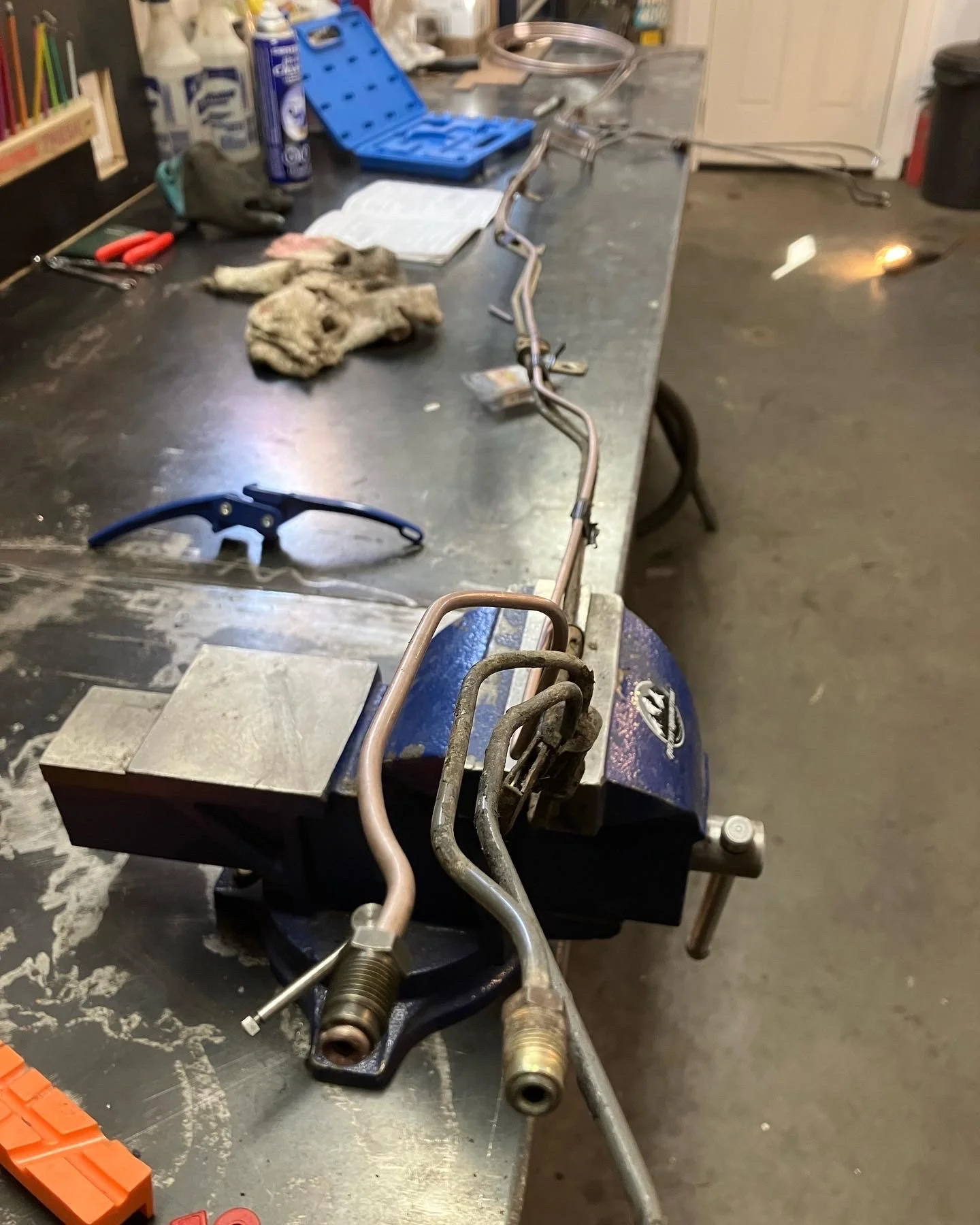

The last major piece I'm missing is brakes, so yesterday I made a new hard line to tie in the rear brakes. I bought a 25' roll of 3/16" copper-nickel brake line from a local store and bent it to shape, adding a flare and fitting at each end. To get the new line to more or less follow the path of the old line, I used the stock line as a guide:
That worked pretty well, as least up to the point where the stock line took a hard right toward the LSPV. Anyway, I shaped as much of it as I could, and then bent the rest to fit once it was on the truck.

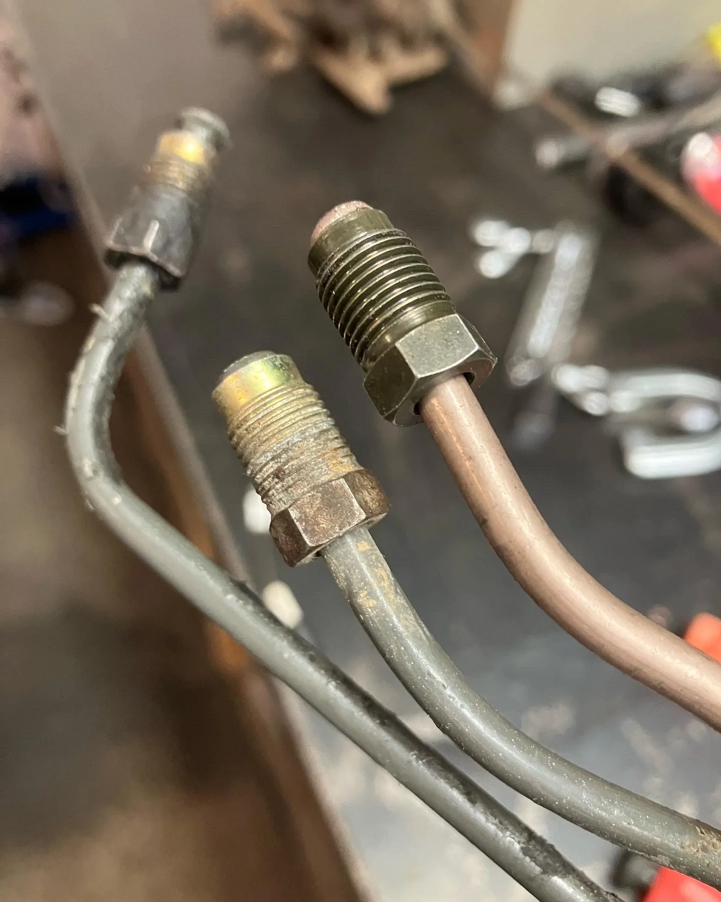

Fresh fitting and double flare at the front of the new line:

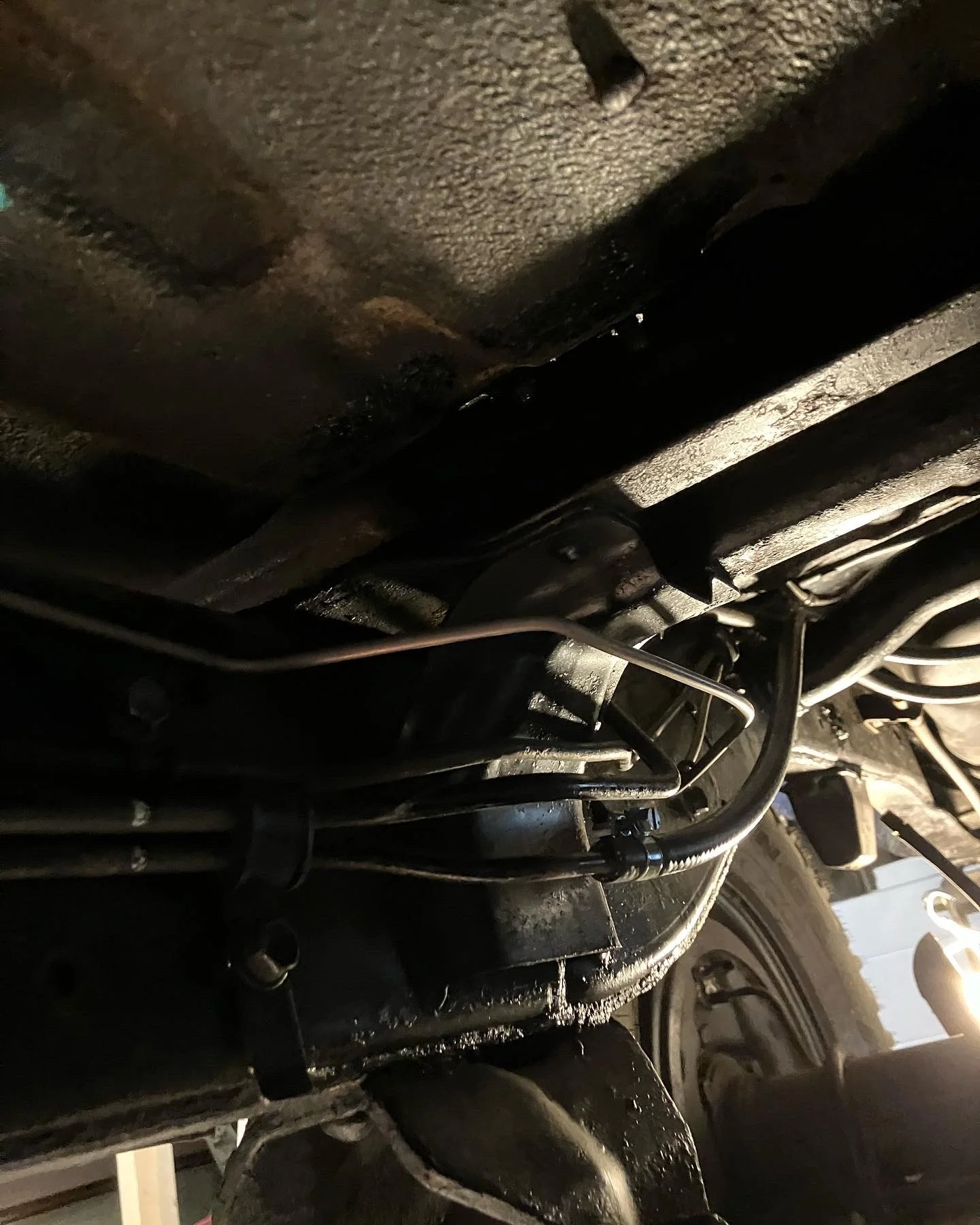

To mount the brake line to the frame rail, I enlarged some existing holes in the frame and popped in a few nutserts. I decided to run the brake line high on the inner frame rail, to protect it from dents etc. The copper-nickel tubing is really soft and easy to work with, but I'm afraid it might be more prone to damage than the stock steel line. Here's a pic of the line where it kicks out around the cross member and up and over the rear shock mount.

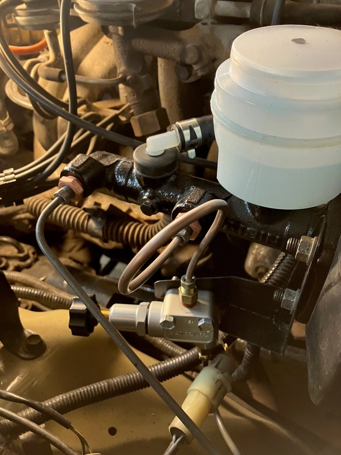

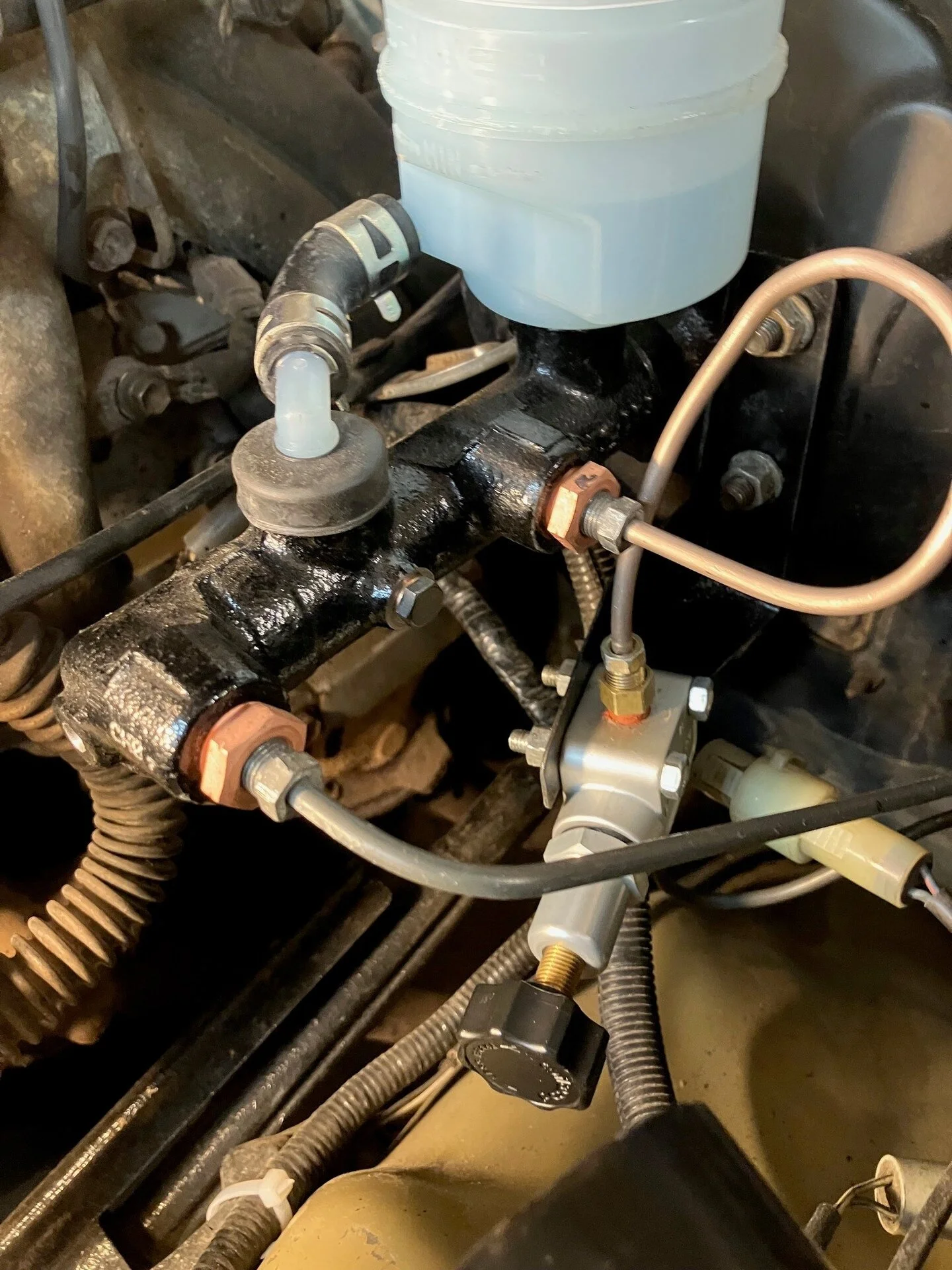

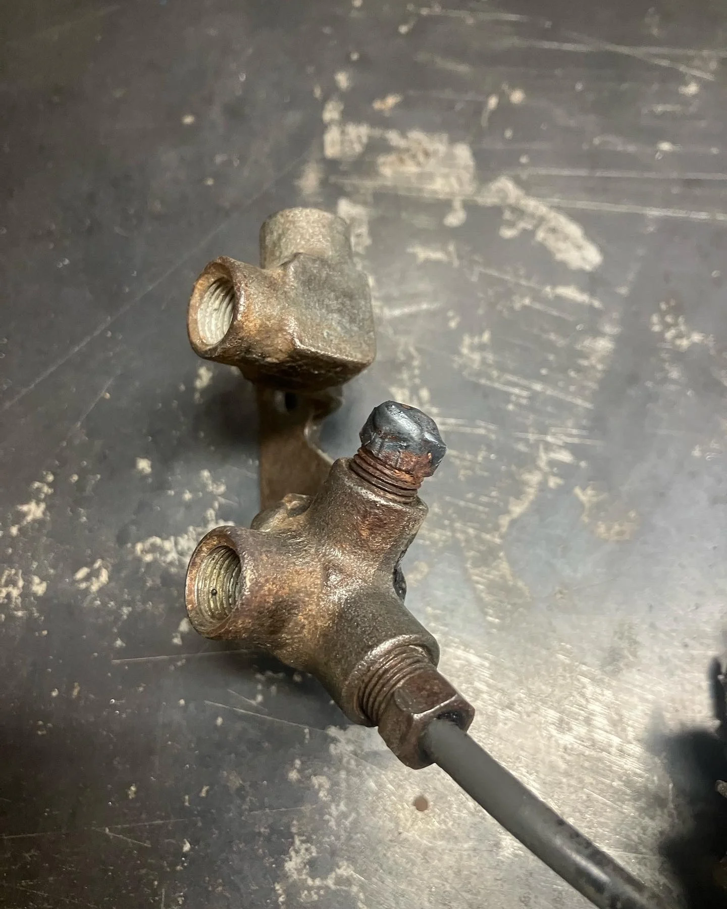

Finally got the brake system buttoned up with the install of a manual proportioning valve in place of my rusty, crusty LSPV, which I'll be putting in the dustbin (once my truck has passed safety, anyway!).

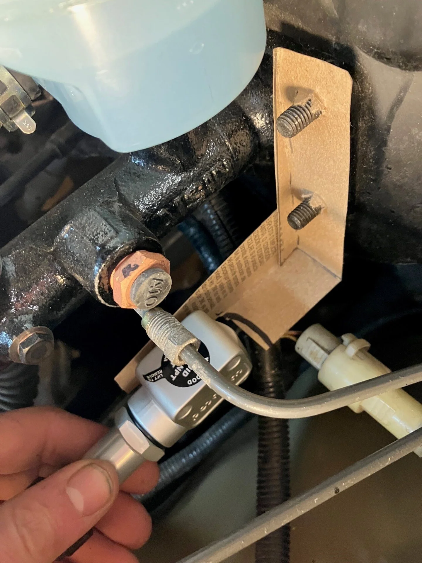

I decided to mount the Wilwood PV near the master cylinder, using the brake booster mounts to hold the bracket. Again deployed my CAD skills to create the bracket design, which I then cut out of some 18 ga sheet:

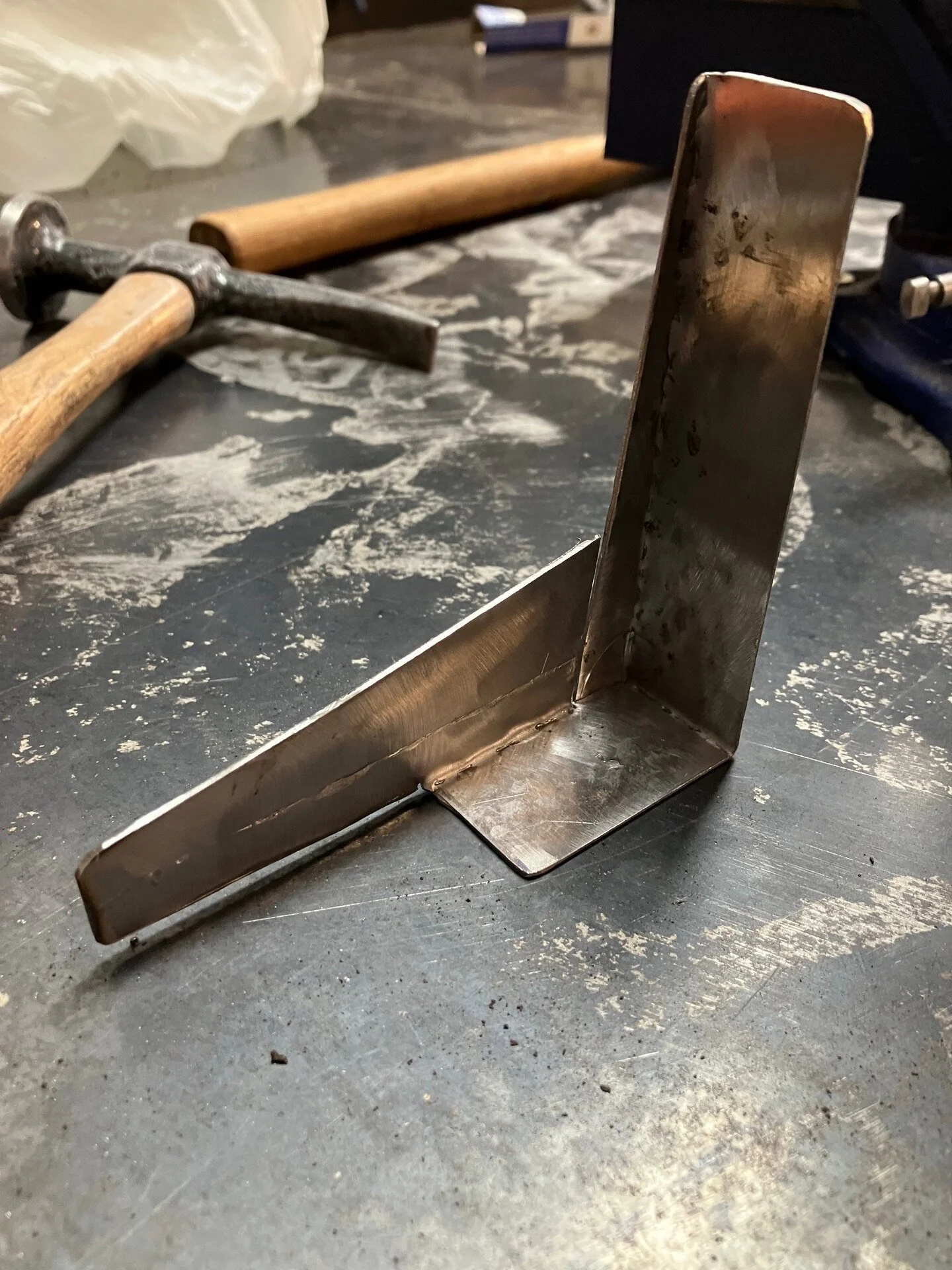

Here's the cardboard bracket recreated in steel. I simply folded the steel over in the vice, and then welded up that one little gap:
With the PV mounted to the bracket and the bracket mounted to the brake booster, I reinstalled the master cylinder and set about routing the brake lines. I was able to re-route the stock lower line to the "out" port on the valve, though I did need to change the fitting (the PV uses NPT threads instead of metric), so I had to cut and re-flare it. Then I made a new line from the MC to the "in" port on the PV. This is the final product:
All in all, this job went pretty smoothly, and I'm happy with the location of the proportioning valve. Having said that, I'm no expert on braking systems, so if anyone sees anything I should do differently, please let me know!

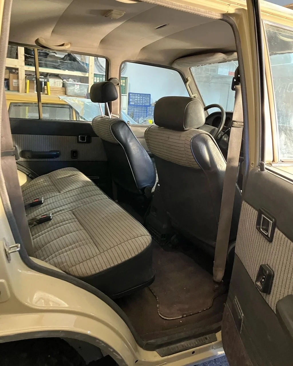

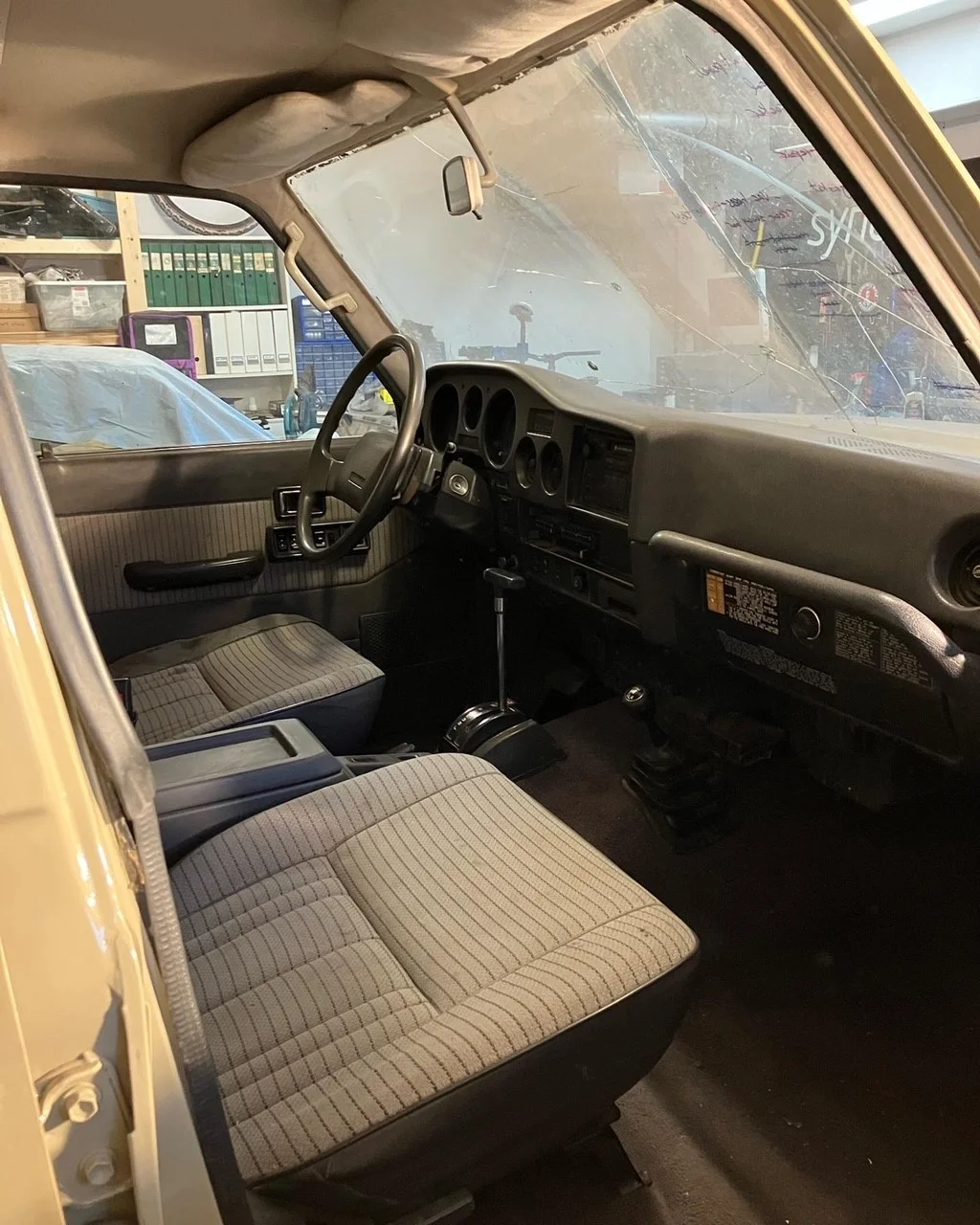

Got the interior all back together. It needs a good steam clean, but all in all the carpet and upholstery is in not bad shape. Door cards provisionally installed. I'll remove them later to install the vapor barrier, but first I wanted to make sure the lock and window mechanisms are working well. I actually had to swap in a new rear driver's side window, as the roller channel had fallen off the bottom of the existing one. That was a pain in the butt, but a worthwhile learning experience.
At this point, there's nothing left on my "to do" list but paint! We're going to turn my buddy's garage into a temporary paint booth and just spray it in situ. Should be fun!
