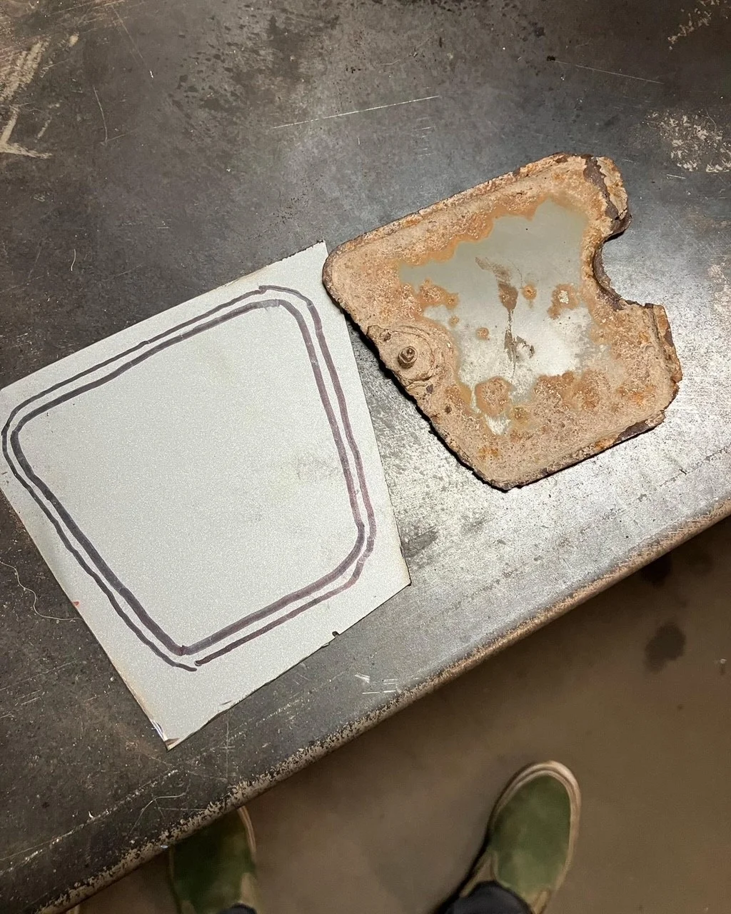

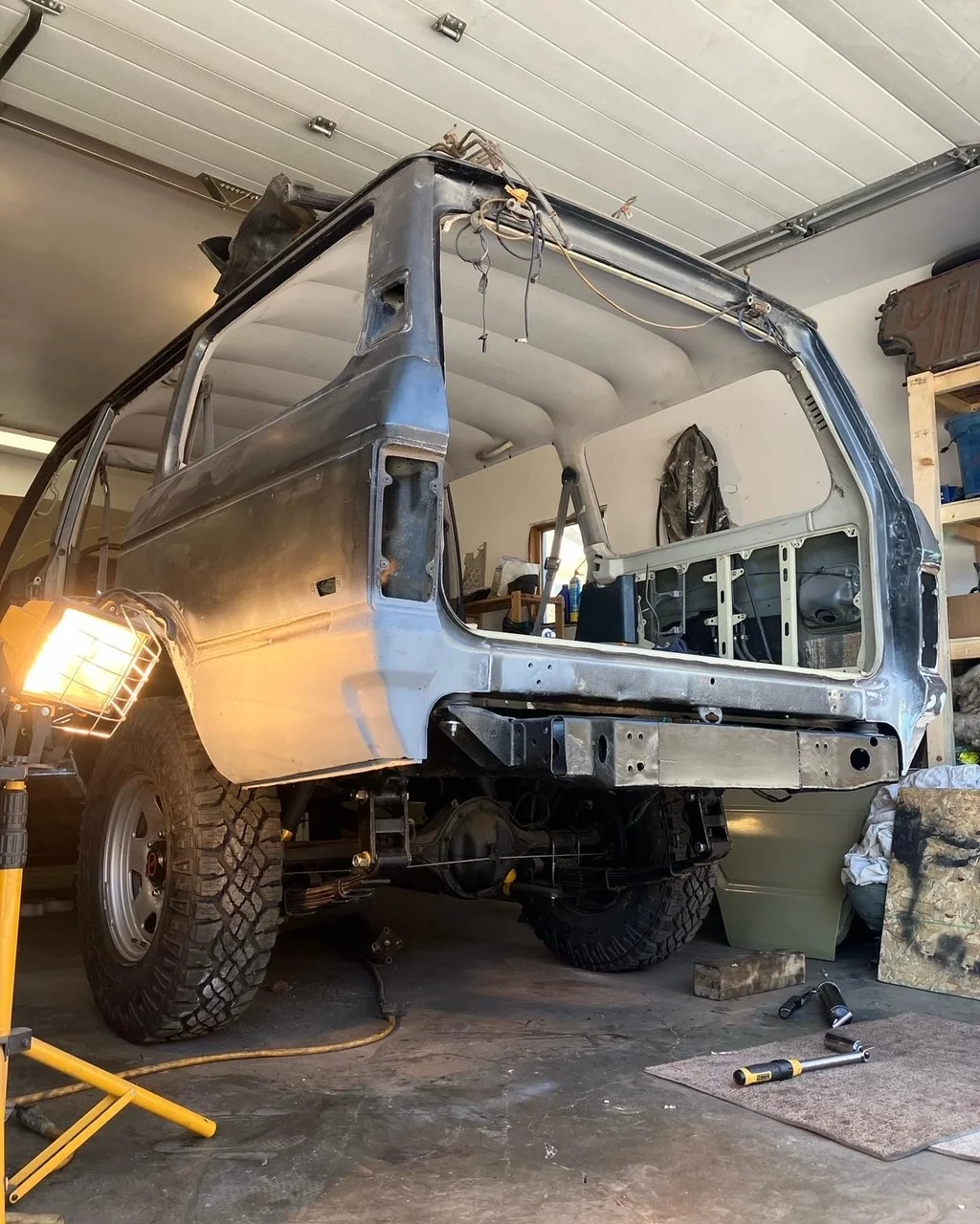

With the inner fender repair complete, I started work on the wheel arch. Only the very bottom section of the driver's side wheel arch was rotted, so this wasn't a huge undertaking. Here's the small patch ready to be welded in place. This patch will also serve to tie the wheel arch into the recently-installed rocker panel.
And here's the patch welded in place:
I still need to weld the inner lip, but I will do that when I burn in the piece that caps off the rocker panel, which is pretty much the last piece of rust repair I need to do on this truck. I think I'll take a break from working on the body to try and get some of the mechanical stuff sorted out. Next steps there include:
- installing fuel tank
- installing fuel lines
Maybe I'll be get this thing to fire in the not too distant future? Here's hoping.

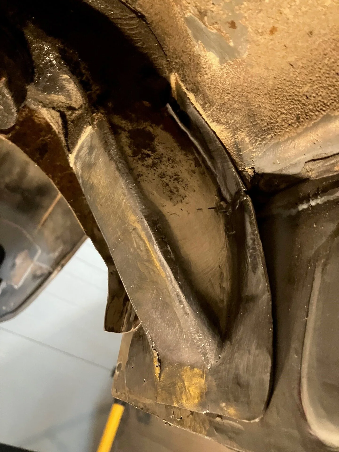

Oh yeah! I forgot to mention that I also completed the cross member repair. This close-up shows some pinholes that I've since gone back and re-welded, so don't judge too harshly:
Still looks a lot better than it did before!

Didn't get a whole lot of time off over Christmas, but still managed to check a few items off my "to-do" list.
The first item was this small section on the rear hatch jamb. A pretty simple repair, for a change. Before:
After:

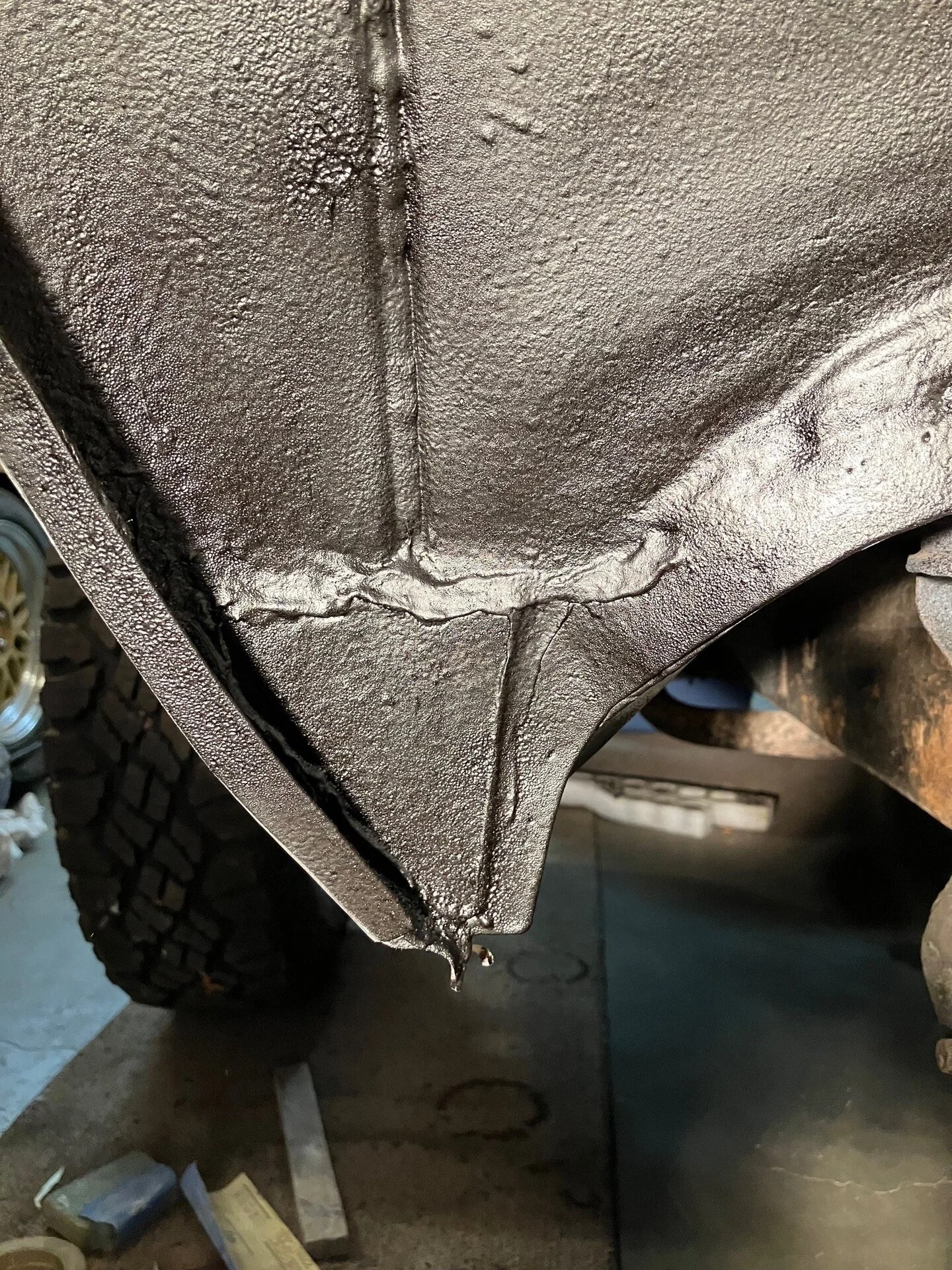

I got the inner fender repair all buttoned up. Here are a couple of pics of the rocker cap, all seam sealed and undercoated:
I also finished undercoating the underside of the cargo floor. I'm pretty much ready to zip the fuel tank back into the truck, which is a pretty exciting development. I spent some time inspecting the two sets of fuel lines that I have, and unfortunately they are both marginal, so it looks like I'll be bending fresh lines from front to back...oh well. Short term pain for long-term gain, I guess.

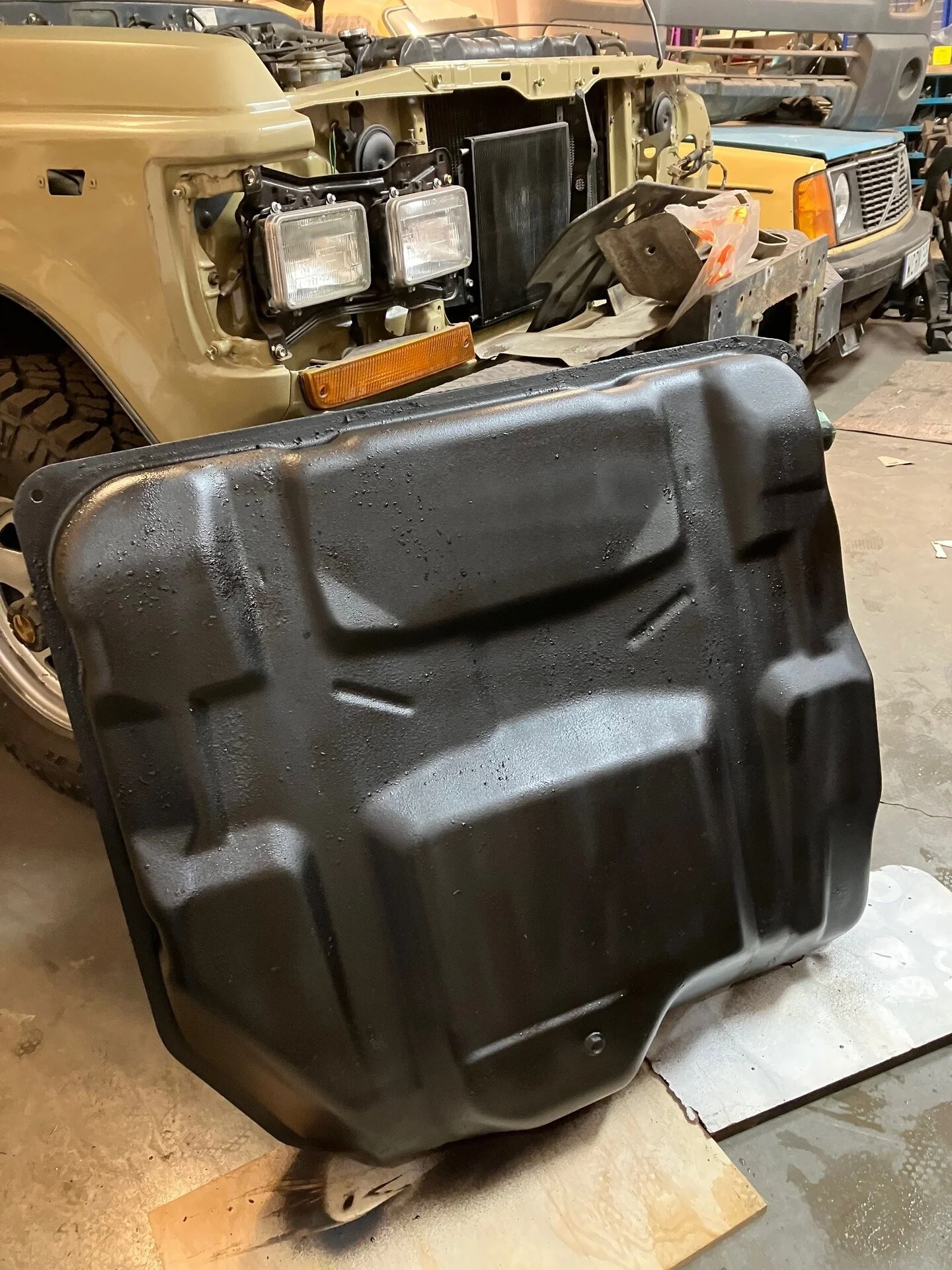

The weather has been much warmer these past few days, so I was able to finish undercoating the fuel tank in preparation for installation:
I think I'm going to spend the next little while focusing on mechanical stuff. I'd like to see if I can get this engine to fire. I also plan to do a Rodney flush and drop the transmission pan. While I'm in there I'll make sure the kick-down cable is adjusted to spec and plumb in my auxiliary trans cooler as well.

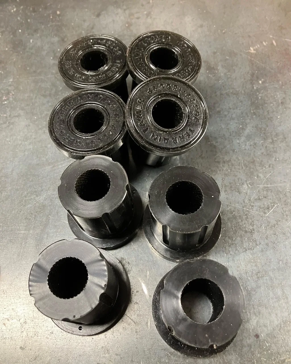

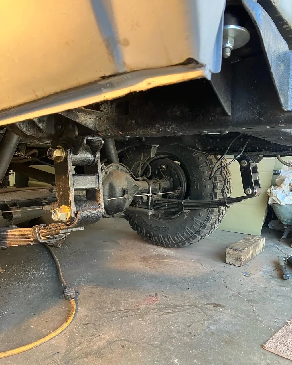

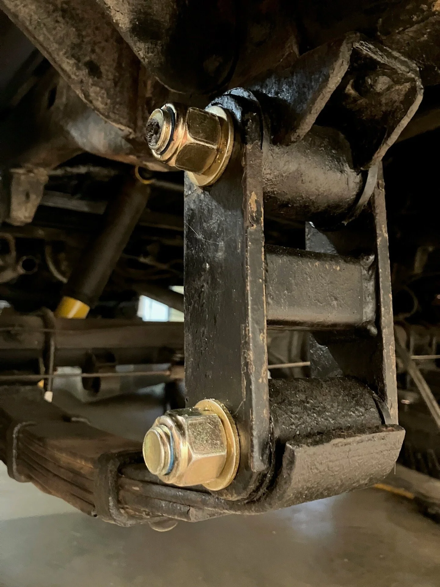

Spent way too much time over the weekend trying to persuade these shackles to squeeze over the new bushings. This is a job that I'd been procrastinating on, because I am just generally not a fan of suspension work. If I had to do this all over again, I would have bought some two-piece anti-inversion shackles. That would have saved a lot of time and hassle and pounding and levering and jacking etc.
Anyway, they're in...and unfortunately, the bolts are just a little too short, which means another trip to the hardware store. Replacing the bolts is no big deal. The hard part is done!
These Terrain Tamer bushings seem to be very well-made.

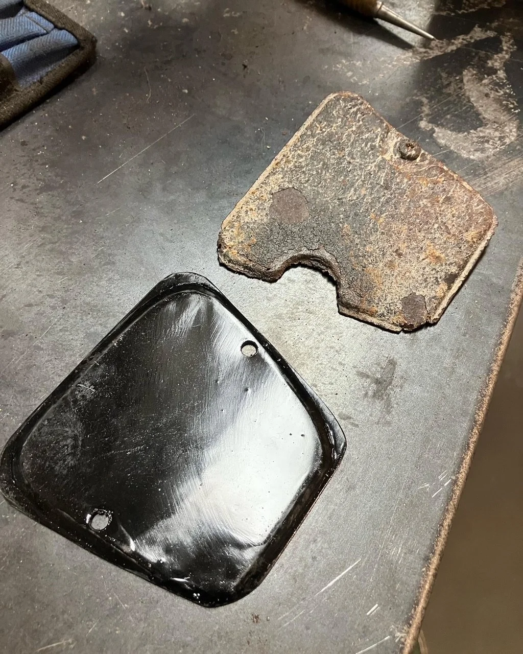

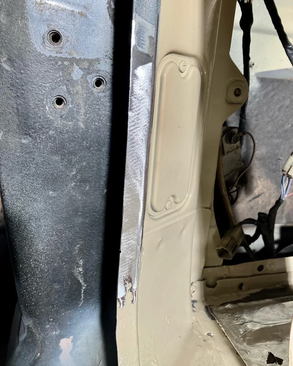

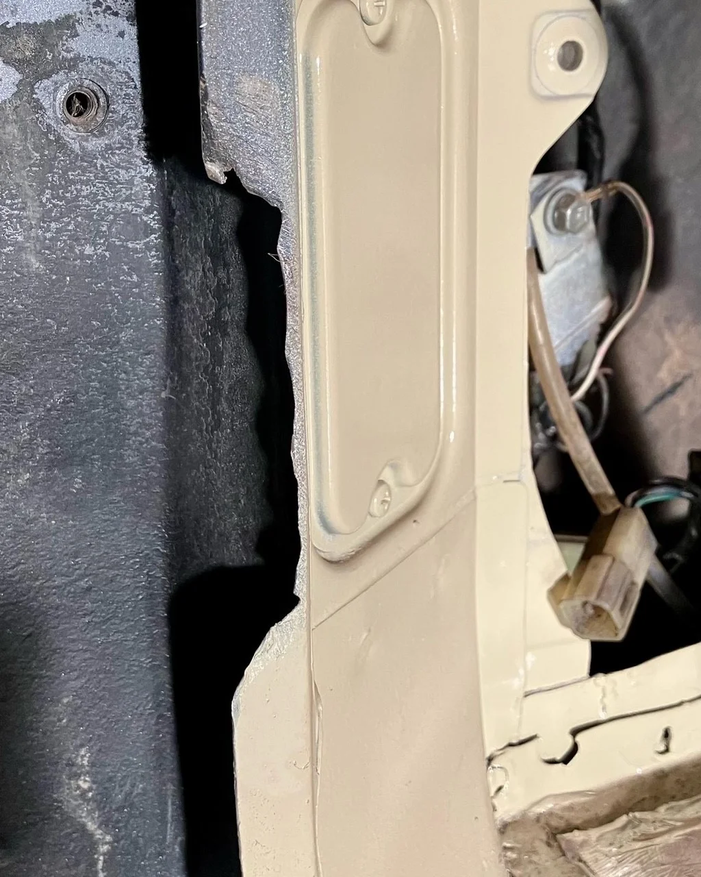

Continuing to pick away at some of the little details on this project. Last night I broke out my el cheapo bead roller to fabricate some replacement covers for the rear body mount access holes. One of the original covers was completely gone, and this one was in pretty rough shape:
I'm using some scrap steel that I salvaged from a washing machine that I found in an alleyway. Thanks Maytag for the free metal!
Anyway, I'm a rank amateur with the bead roller, but for a panel that no human eyes will ever see, this seems perfectly adequate:
I made up two of these and bolted them in. On the driver's side I'd replaced the whole panel that they attach to, so I used nutserts to mount that one. The passenger side was in better shape, so I used some hex head sheet metal screws to mount that one. Also reinstalled the body mount protector flap, again using nutserts. To try and keep water out, I put some self-adhesive weatherstripping on the back side of the covers before installing.

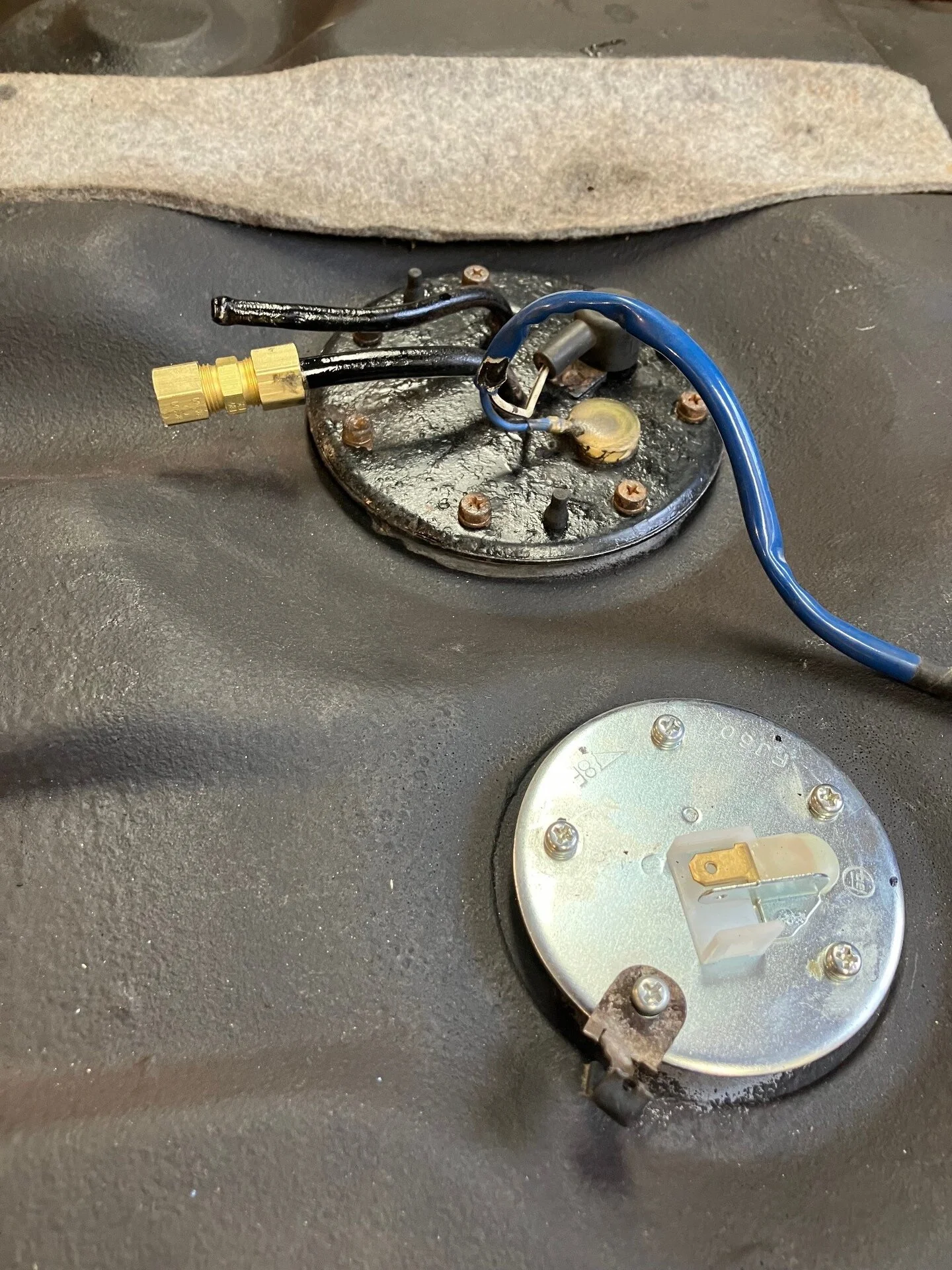

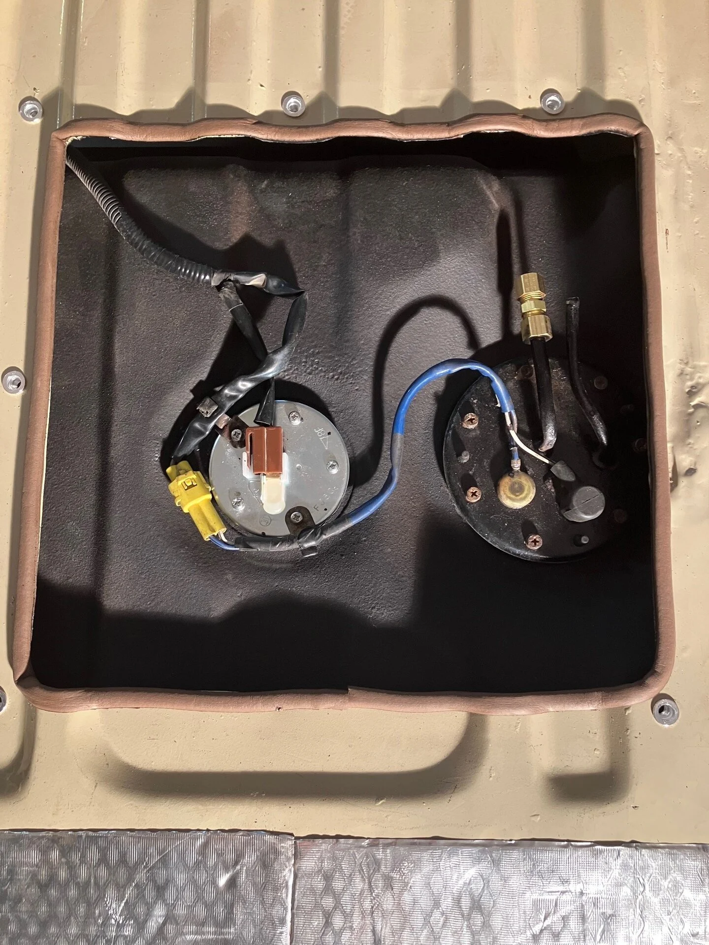

Finally felt ready to strap the fuel tank in place, but not before making some repairs to the fuel pump/gauge sender harness. I spent more time than I would have liked with my soldering gun, but you don't want an intermittent connection to your fuel pump, so I guess it's time well spent.
Before hoisting the tank into place, I affixed a 5/16 compression fitting to the fuel send line (the original send and return lines had been cut short by a previous owner). I'll add another short section of hard line that will tie into a piece of soft line and then into the stock hard lines that run along the frame rail. I flared the end of the return line, and will simply connect the soft line directly to it:
Looking down from above, I can already tell that his fuel pump access panel will be super handy:
A word to the wise on tank straps: should you find yourself in a situation like me, where you have 4 tank straps to choose from, don't just keep the 2 "best" straps and junk the rest. Turns out the left and right straps are different, and the two straps I'd kept were both rights. After fighting with the stupid thing for an hour, I finally googled it and learned that there are two part numbers for 60-series tank straps. Crap. Anyway, my workaround was to extend the left strap by 1.5" by welding in a piece of 16ga steel. In the meantime I may see if I can find a used strap locally. I don't have any concerns about the strength of the modified strap, it's just kinda janky.
I'm also very excited to install this beauty:
New OE filler neck hose. This had to be brought in from California, and the parts guy said there were only two left in North America. Some vendors on the forum (like @cruisermatt) are selling them, but buying from the dealer saved me a ton on shipping and duty, etc. Unlike the one I removed, this one is super pliable and should be relatively easy to install.
One final note: went back to the hardware store and bought longer bolts for the shackles. The nuts now fully engage the bolt threads, and I'm able to run washers behind the nut and bolt head:

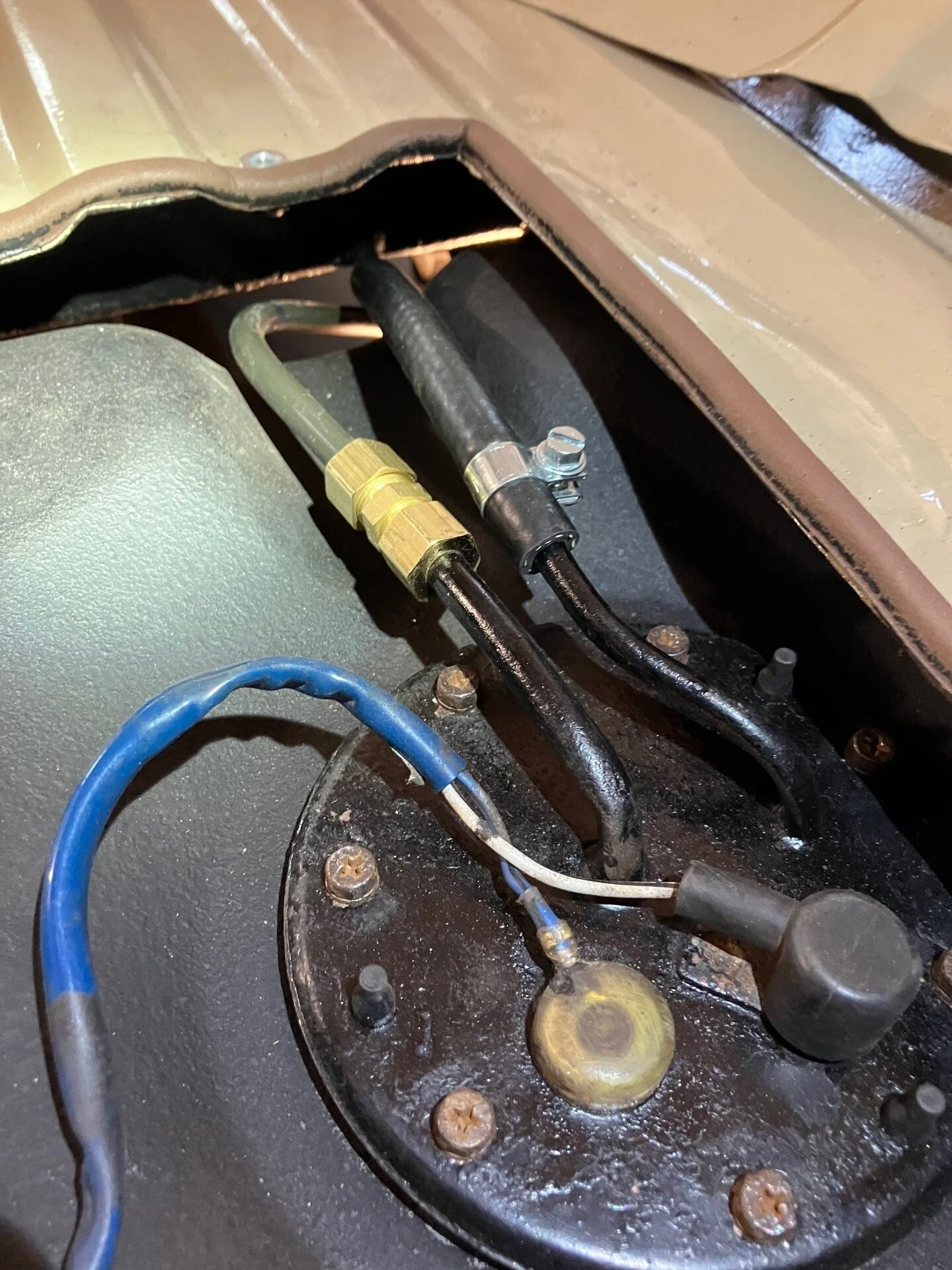

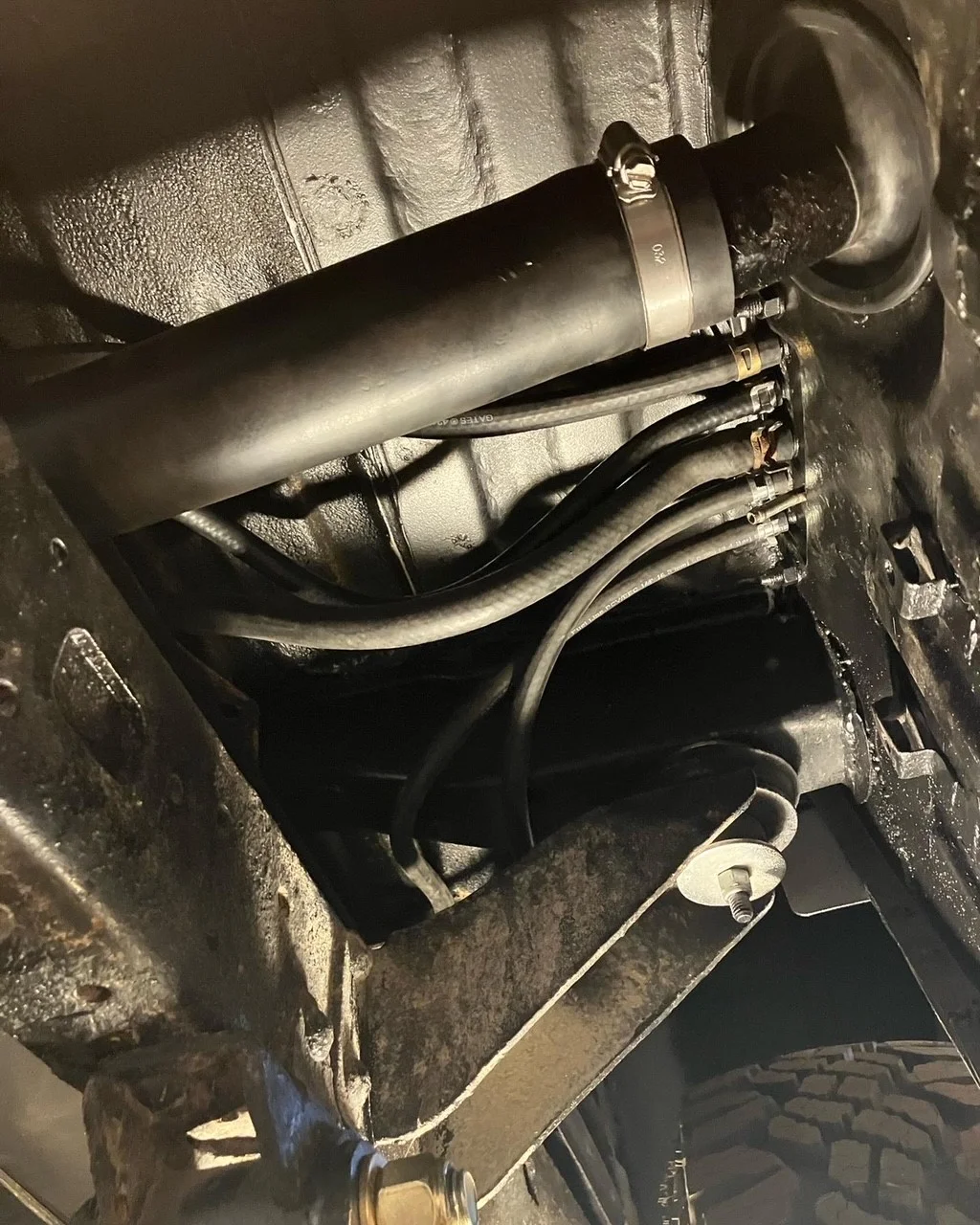

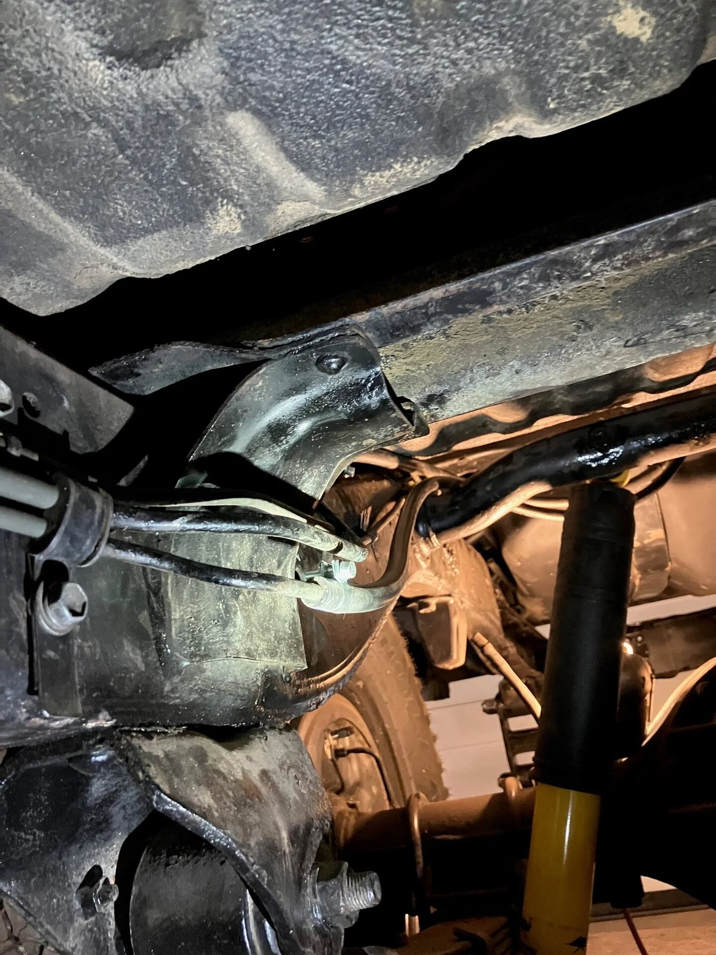

Got the fuel tank and lines installed over the weekend! The OG hard lines were in decent shape, except for the last 18" or so of the return line, so I deleted that section, put a new flare on the end, and ran a soft line back to the tank:
Also bent a new section of 5/16" hard line to reconnect the send line, again using a short length of Gates fuel injection hose to connect the tank to the hard line. I think it looks pretty tidy!
Installed all new hoses between the tank and the fuel separator, along with my new filler hose and grommet:

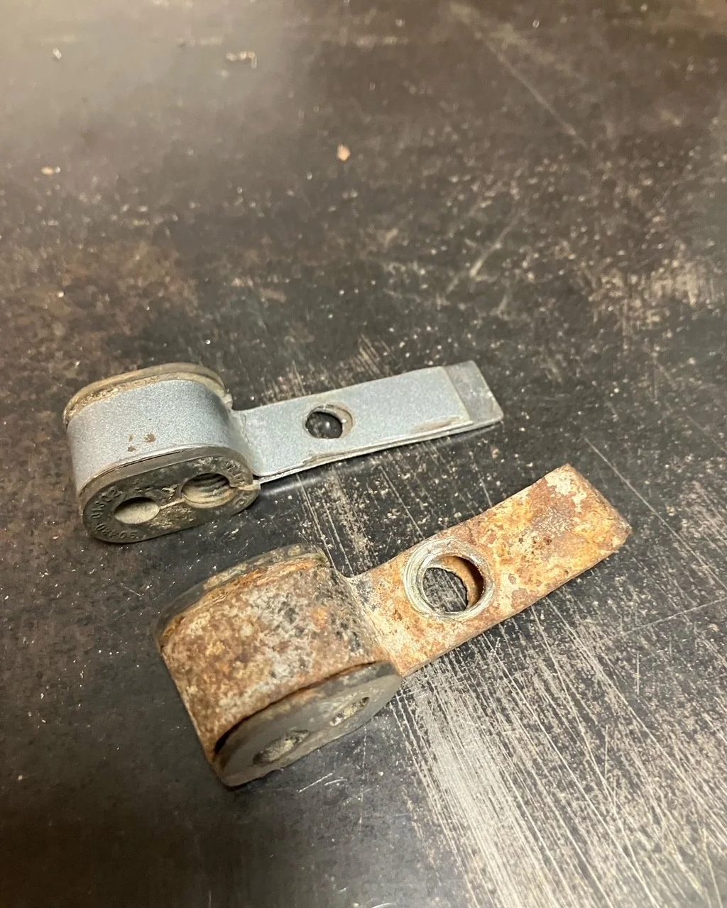

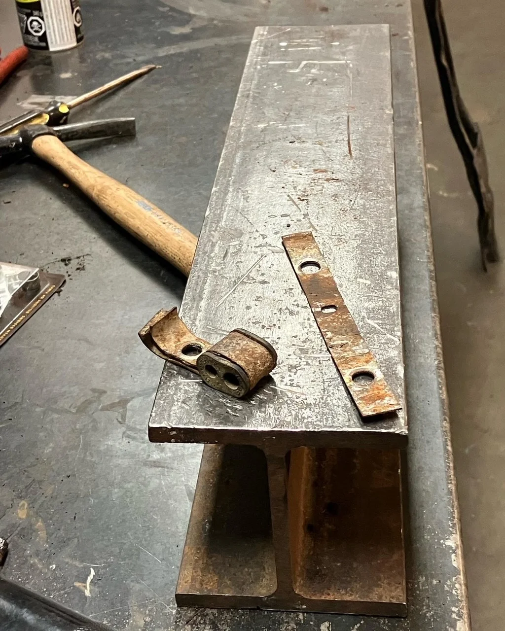

A lot of the fuel line brackets were rusted out, so I decided to make my own. I simply found one that wasn't too far gone, pounded it flat, and used it as a template for the replacement bracket, which I cut out of some scrap sheet metal I had laying around.
Then just bend to shape around the rubber grommet:
Still need to add once piece of evap line, and then the fuel system should be ready to go. Getting closer and closer to trying to fire this thing!
