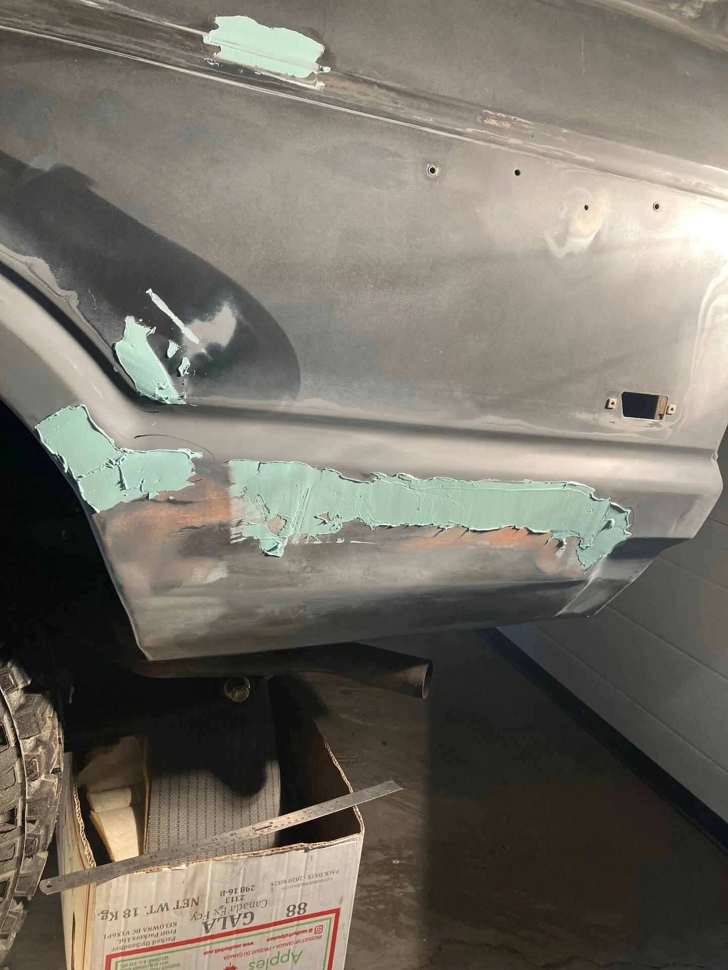

Got a good chunk of the bodywork done over the weekend. There isn't a ton of filler required - just a few spots here and there on the quarters and rockers. I'm no expert at this stuff - this is my first time doing any kind of blocking, but I think it turned out ok. After a couple of coats of sealer and a couple of topcoats (with sanding in between) any minor imperfections should pretty much disappear.
Glazing putty ready for sanding:

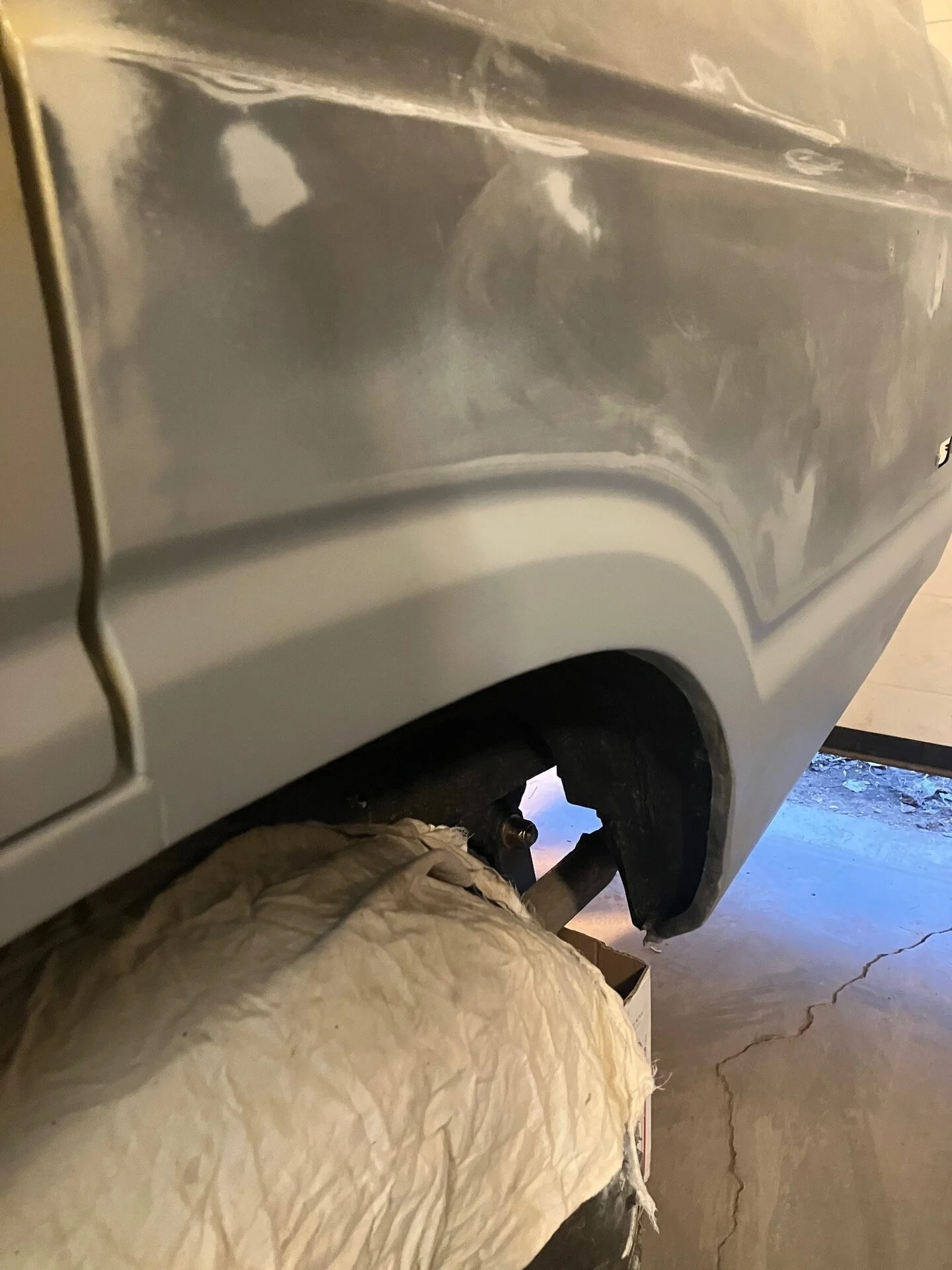

And all sanded out to 180 grit:
And after a couple of coats of etching primer:

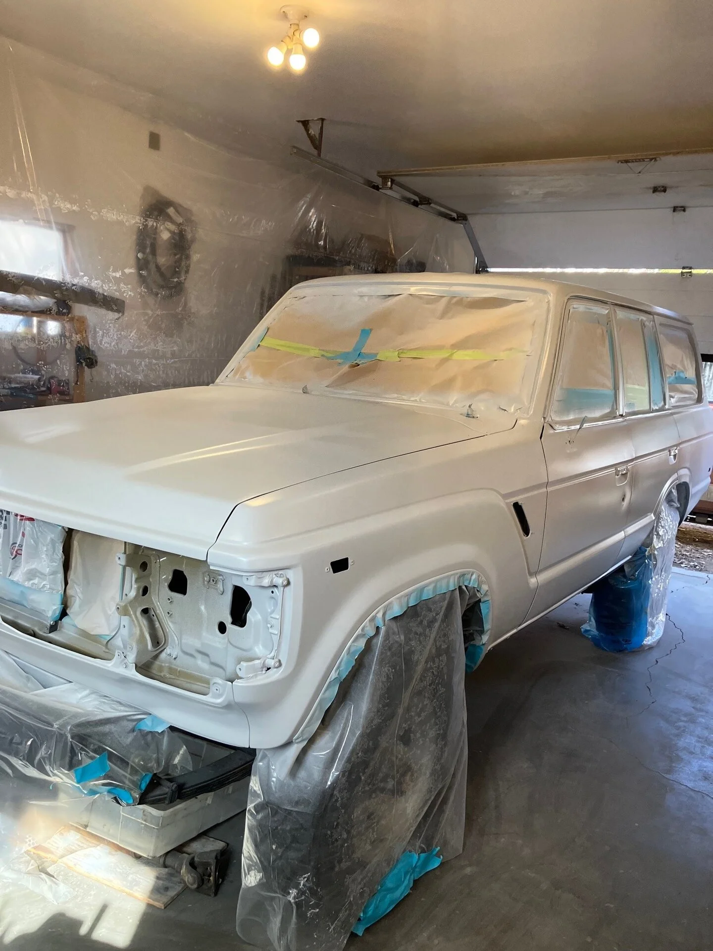

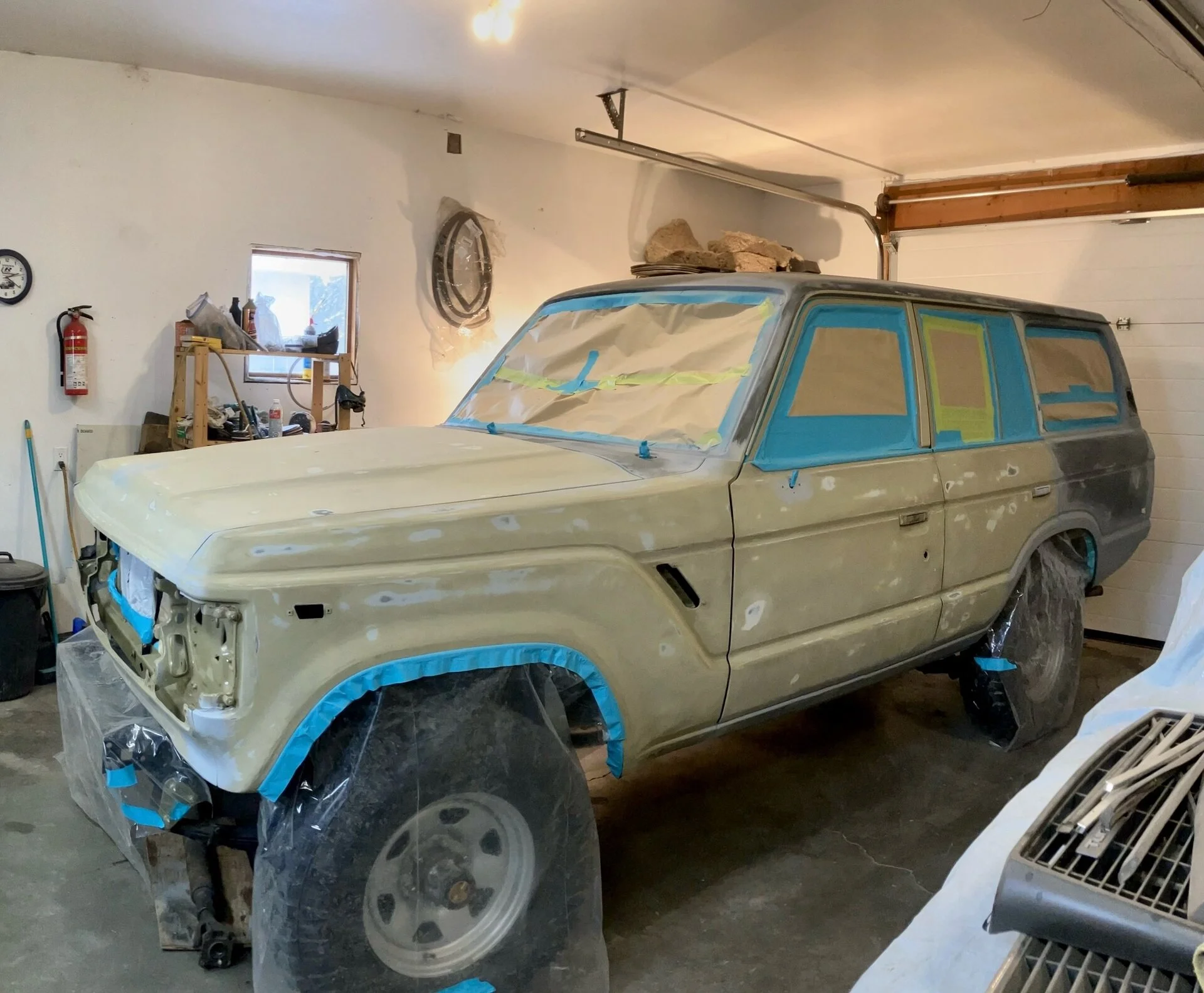

I believe that I have completed all of the body work and paint prep. The entire truck has been sanded to 220 grit, and mostly masked.
Just waiting for weather that's a bit warmer so that I can set up a temporary spray booth in the garage. Looks like that might be a week or two out with this winter that just won't quit.

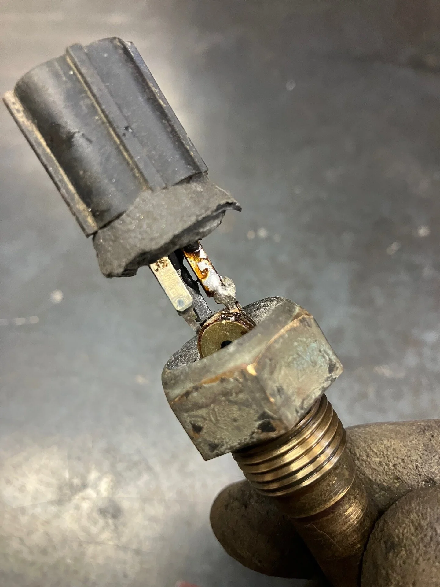

In the meantime, I'm picking away at little items. Greased up the u-joints the other day, and replaced this broken cold start injector time switch:
This is what one of these things looks like inside, in case you were wondering. One of the leads was broken, so you can also see my attempted repair, which actually worked but wasn't likely to last very long:
Shiny new switch installed:

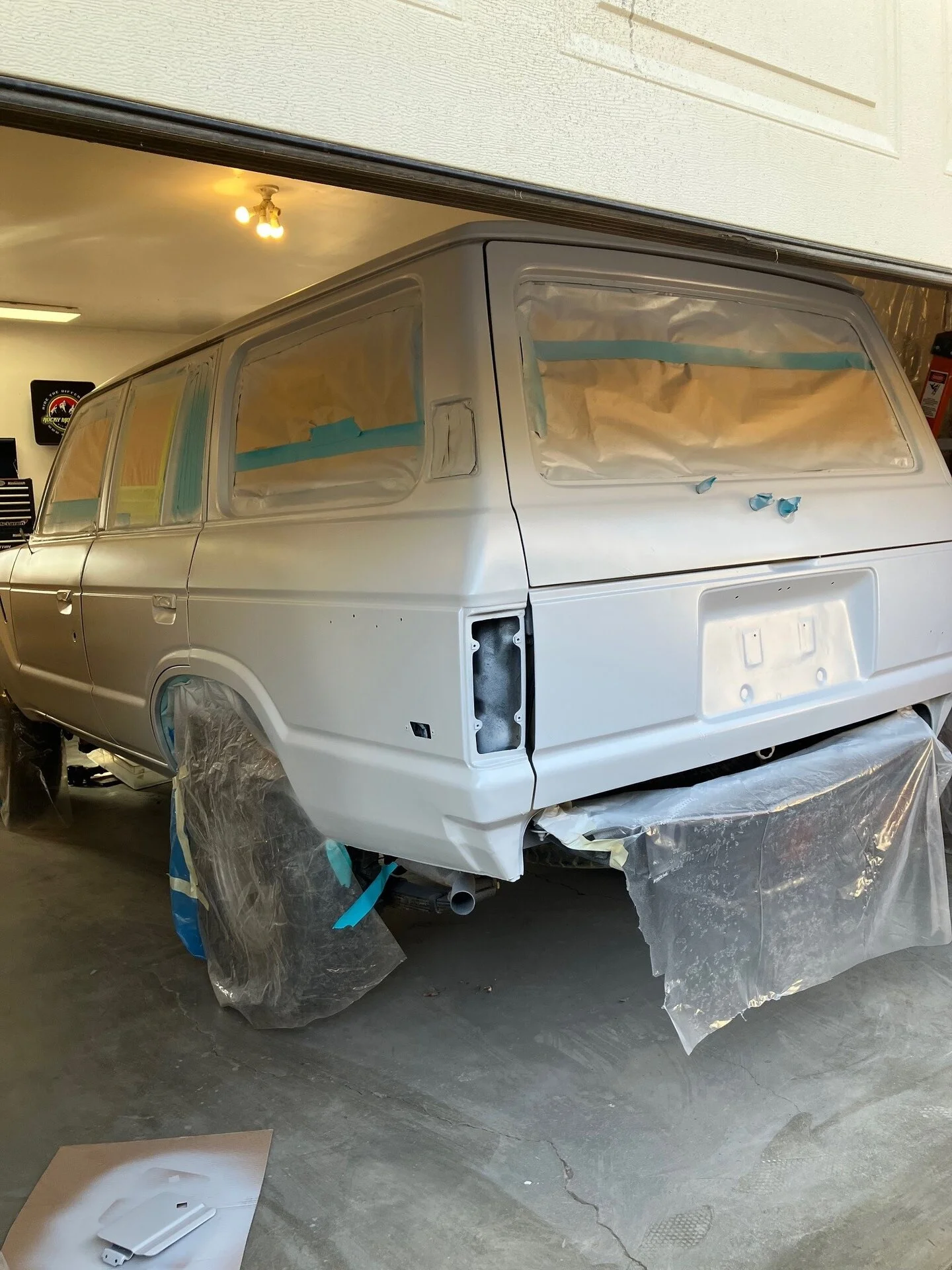

The 62 is finally painted! It was a fun but challenging process, and a ton of work! The results are perfectly satisfactory for a garage paint job done by a total noob.
The first step was laying down the sealer/filler. I'm using a 2K high-solids acrylic sealer. I laid down two coats and let it dry, and then spent the whole next day removing the many runs and sags in the paint. I then wet-sanded the whole thing with 320. I realized later that I forgot to insert the little filter thingy in my spray gun, which is why I think I ended up laying the sealer on too thick, causing many sags in the paint.
Anyway, according to youtube, the way to remove runs in paint is to wait for it to dry, then scrape it away with a razor blade. So that's what I tried, and it worked like a hot damn.
The sealer went on nice and thick, leaving lots of room for sanding out imperfections.

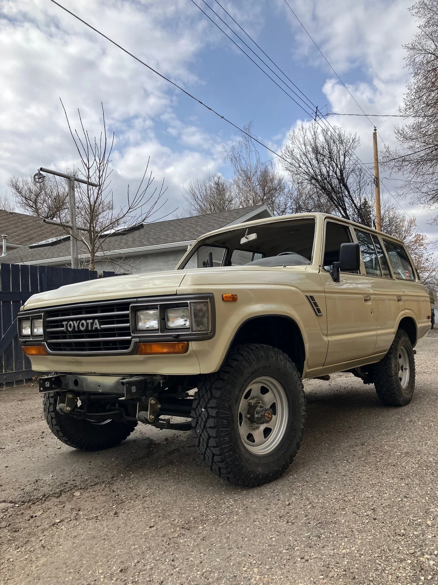

First pics out in the wild. Can finally stand back and check out the stance and see the true colour as it appears under natural light.
Of course my eye is drawn to the imperfections that I know are there, but overall I'm very happy.

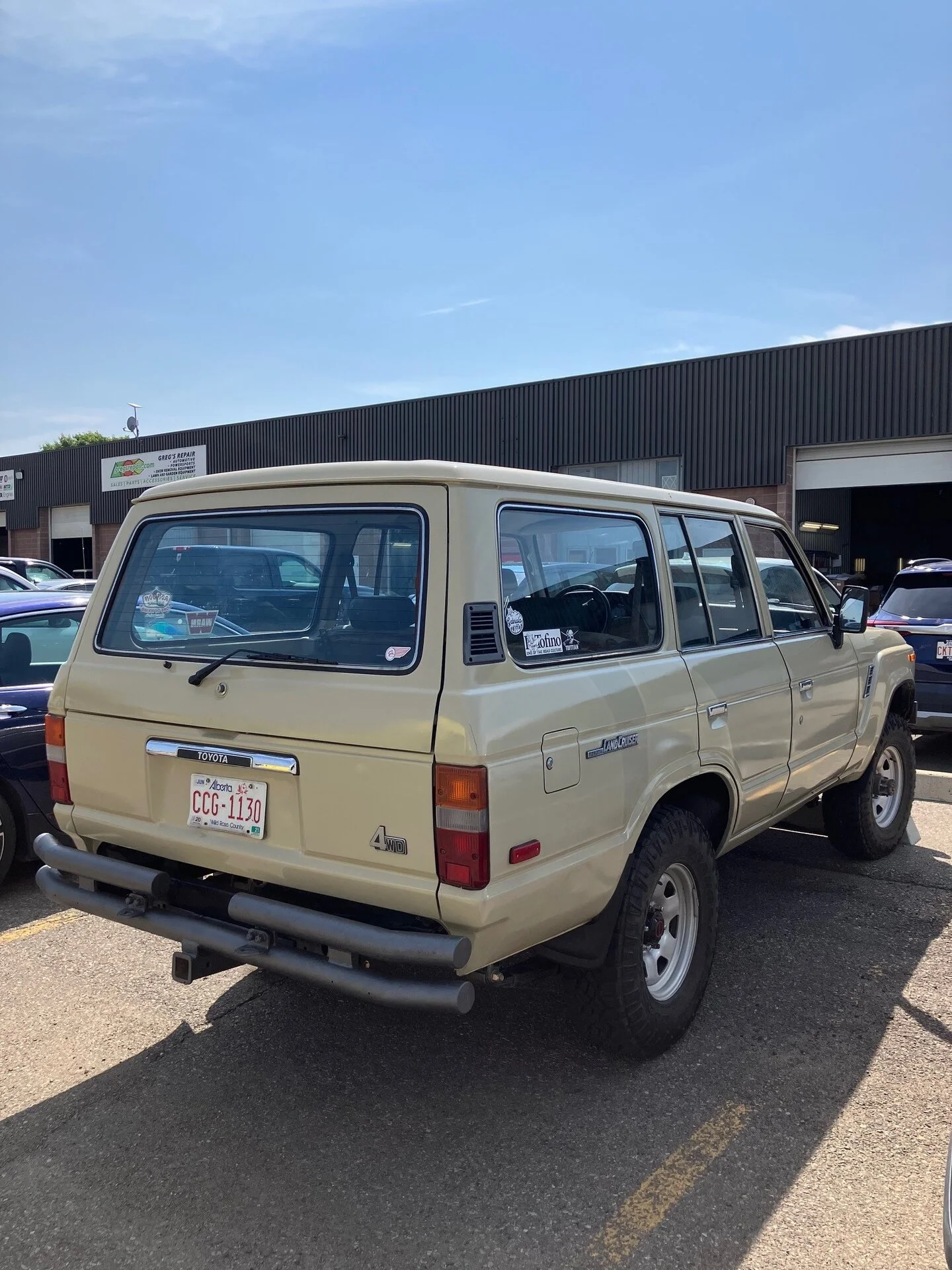

Drove it to the glass shop today, making two stops along the way, and at both stops I had a random dude come up to me and talk to me about the truck. Made me late for work! haha.

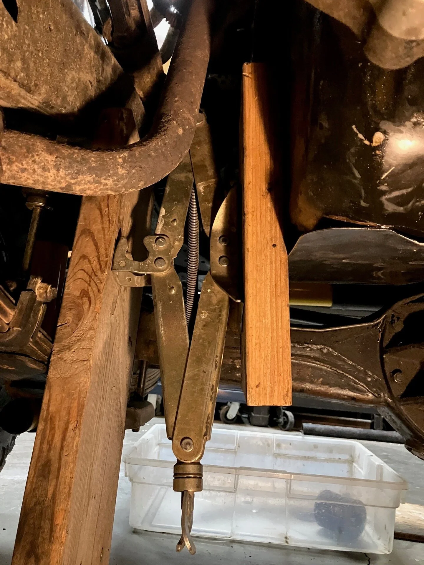

I knew that replacing the gasket would be a big job...but is was even more of a challenge than I expected. Probably put like 8 hours into this project. The first big hurdle was getting the oil pan off. Part of me was hoping that it would just fall off when I removed the last bolt. Fat chance! I beat on the thing with a dead blow hammer, tried using a variety of chisels and putty knives to break the seal, nothing worked. The old cork had basically turned to cement.
Finally I resorted to the "sideways jack" trick, and even that didn't work the first time! I ended up moving the jack to a lower part of the pan, to increase my mechanical advantage. Finally I was able to release the driver's side, and then had to do the same on the passenger side. I was amazed at how much force it took to free the pan.

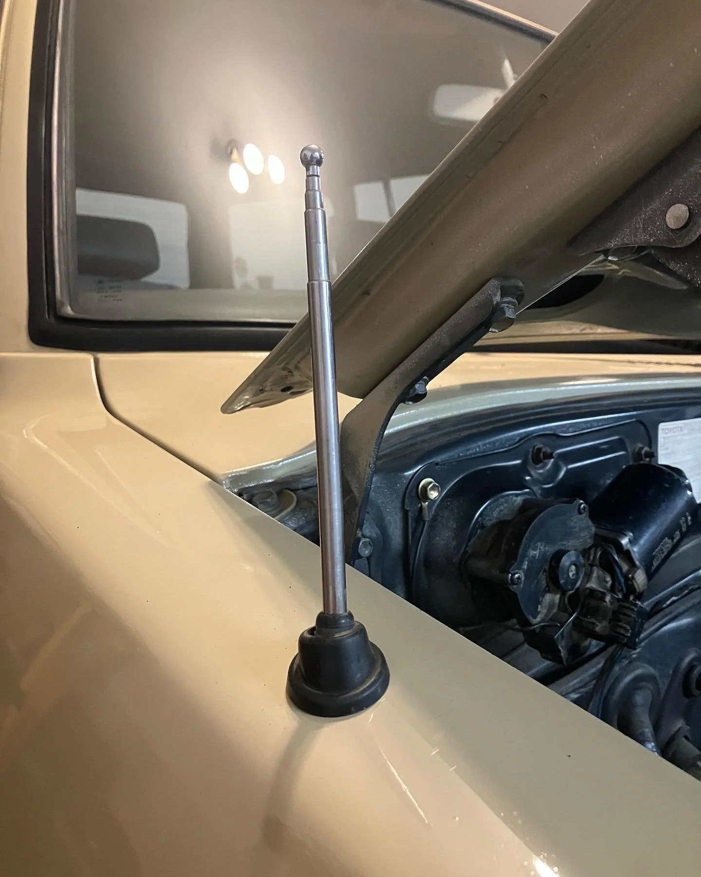

In other news, I got my power antenna installed, and it works!

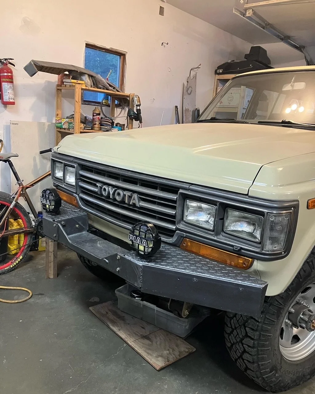

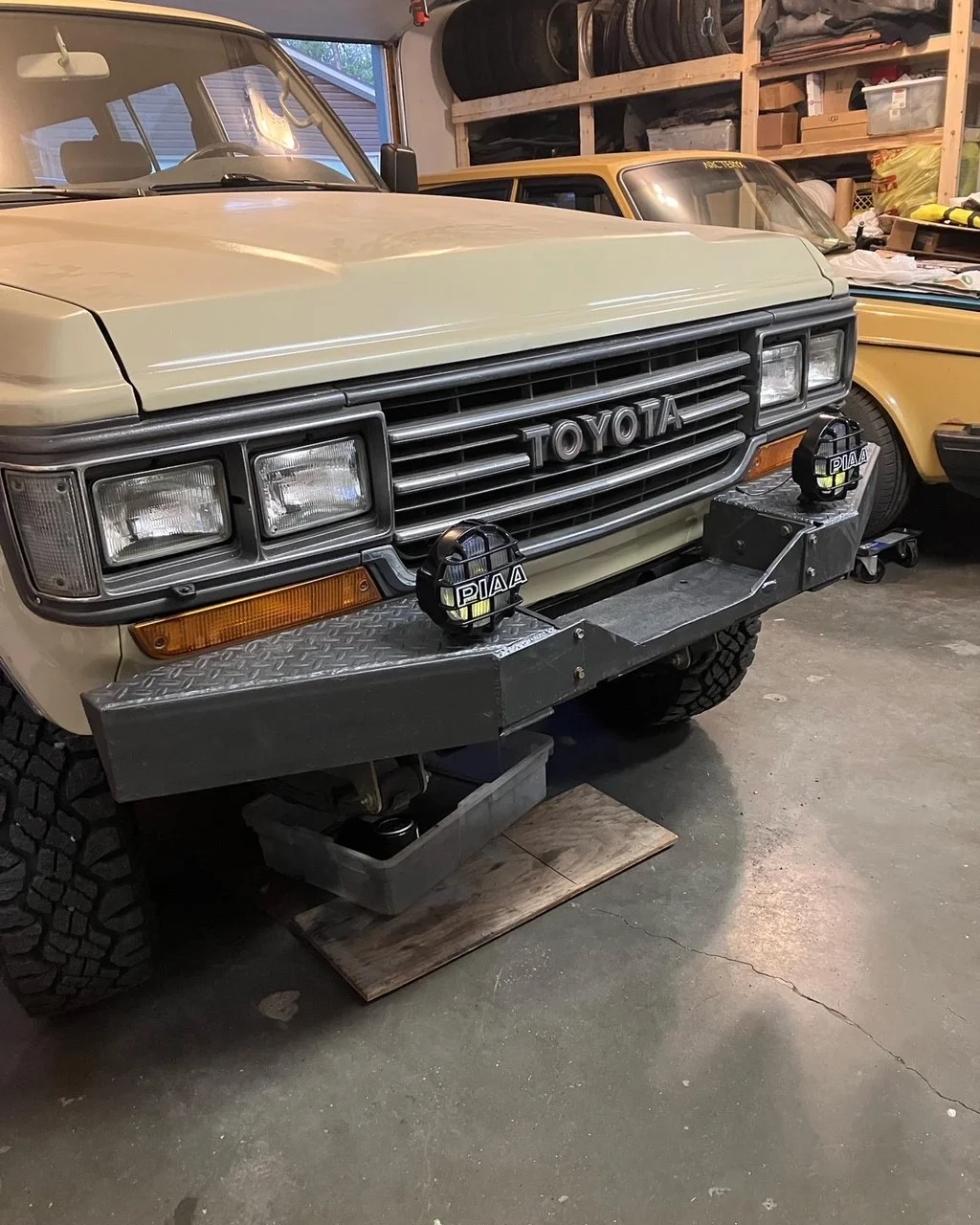

I've been debating what to do about a front bumper. The one that came with the truck was a massive, ugly homebuilt thing made from heavy steel plate and angle iron. It originally held an old Warn Belleview winch (which I am planning to put on my '72 FJ40, since it's period-correct). The thing kind of looked like one of those JDM "picnic table" bumpers that come on some 60s with the factory PTO winch. Not the look I'm going for.
Since I want to get this thing safetied and on the road, and since I don't feel like dropping $1500 on a new bumper, I decided to get out the ol' angle grinder and modify the old bumper to lower its profile and make it look less janky. The results are half decent! I was able to move the bumper in at least 4", improving the approach angle quite dramatically. I also trimmed the "wings" to follow the shape of the front panel.

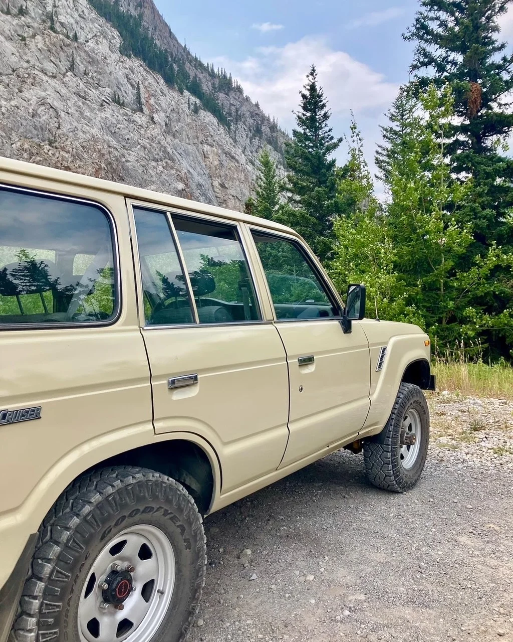

Put the truck through its paces this past weekend with a 1300km (800mi) road trip through the Kootenay region of BC. I was playing beer wagon for a couple of pals that were on bikes. Unfortunately, the ignition coil on my buddy's Triumph packed it in about three hours into the trip, so we ditched his bike at the home of a distant relative of one of the other guys, and he jumped in the Cruiser for the rest of the trip.
All in all, I'm super impressed with how this truck is shaking down. Only two minor mechanical issues cropped up over 5 days of mountain driving: the "window lock" switch broke off (meaning that had to jam a paper clip into the slot whenever anyone wanted to raise or lower a window), and the filler neck sprung a couple of pin hole leaks. Luckily I was within range of my family cabin on Kootenay Lake where my brother was staying, so we popped in for a beer. Parked the Cruiser nose-down so that I could pull the filler neck and get it sealed up with some tank-sealing epoxy. I didn't leak again for the rest of the trip. So glad I sold my spare filler neck to @kirvesmies :rofl::flipoff2:

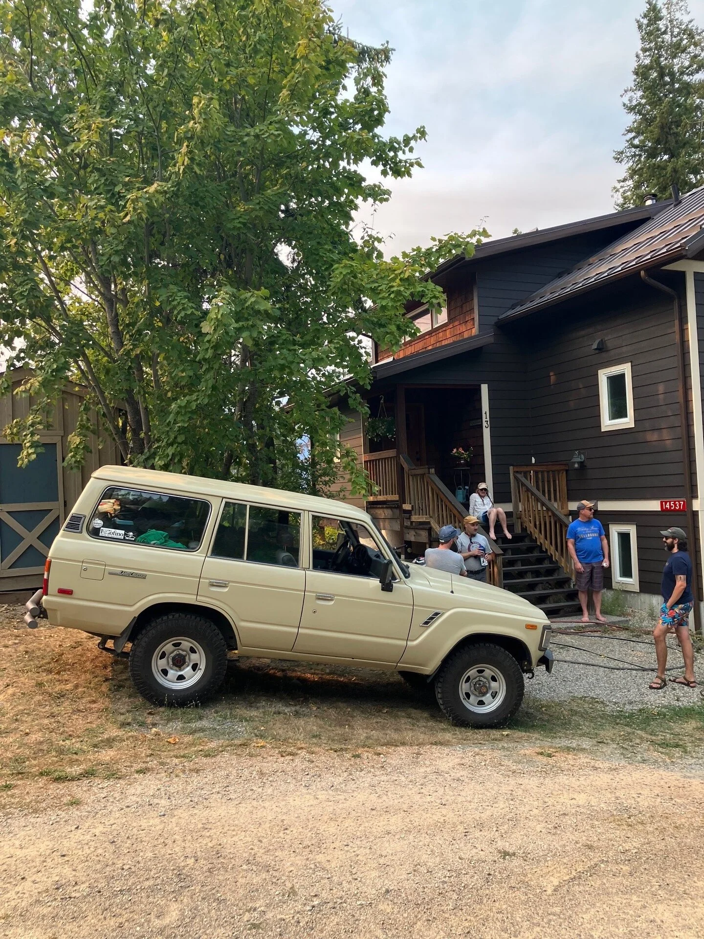

Stopped by my buddy's uncle's place in the Slocan Valley. He has some pretty cool old stuff in his front yard, including an old Honda 500 that we managed to get running (the CT-90 looked like too much of a project). The jeep is a '52 Willys.
