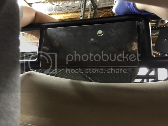

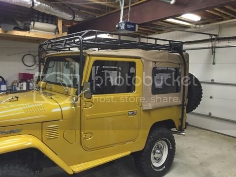

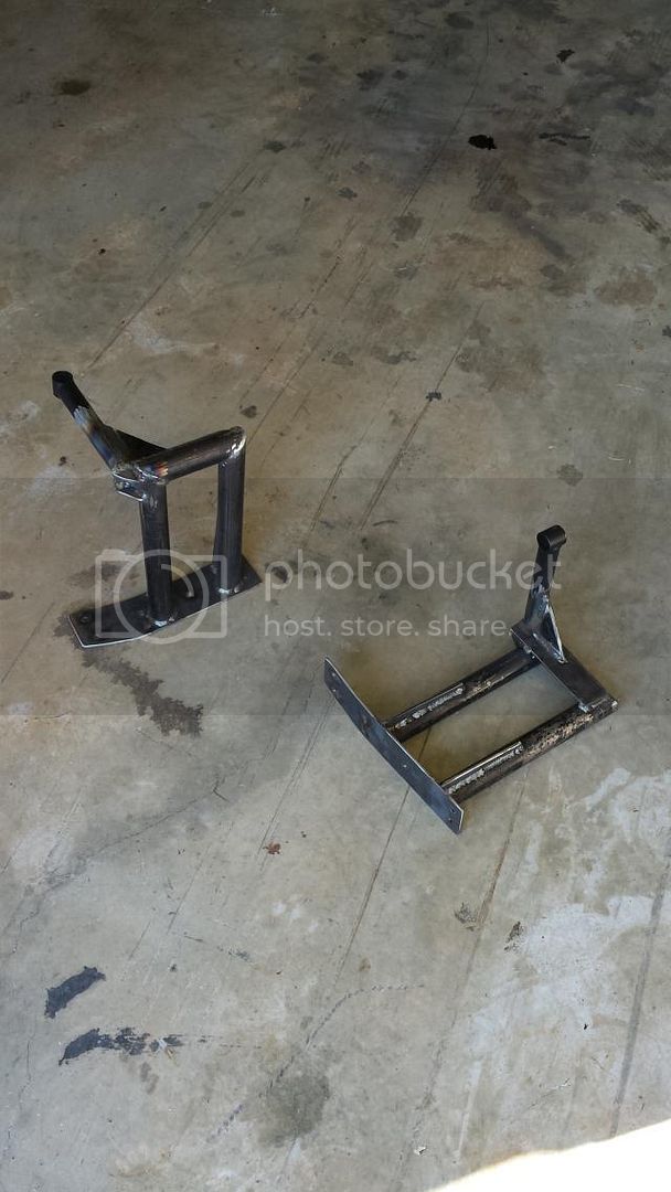

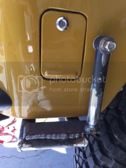

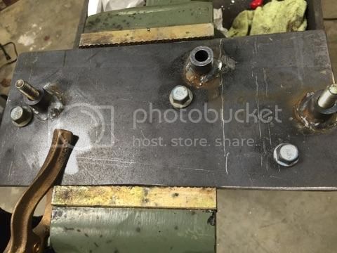

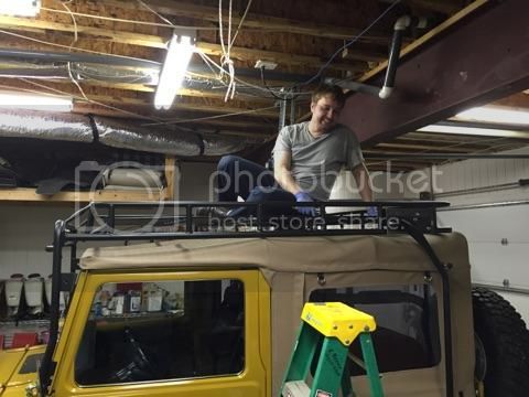

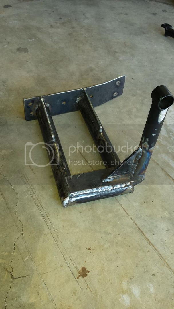

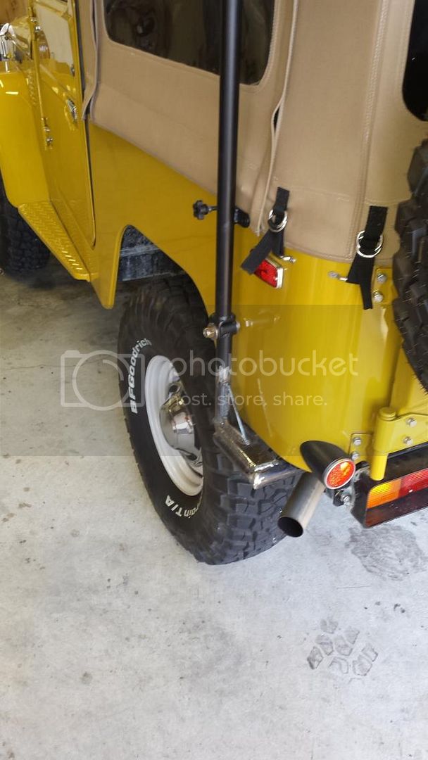

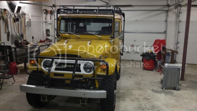

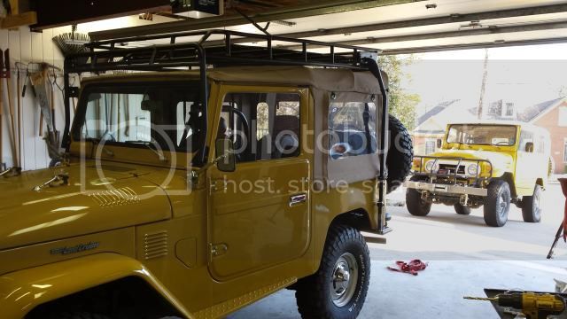

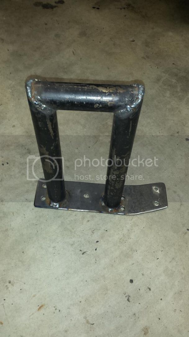

Tucker also picked up a gobi roof rack and ladder. upon fitment we were a bit disappointed to find out that it will not work with a soft top or with an auxillary fuel tank if the fuel door is on the quarter panel. Soo we went to the drawing board and fabbed up a couple of brackets to raise the rack up an 1'' or two and also move the frame mounts (which I REALLY did NOT like) up a couple of inches to clear the auxillary fuel door. Here is what we came up with.

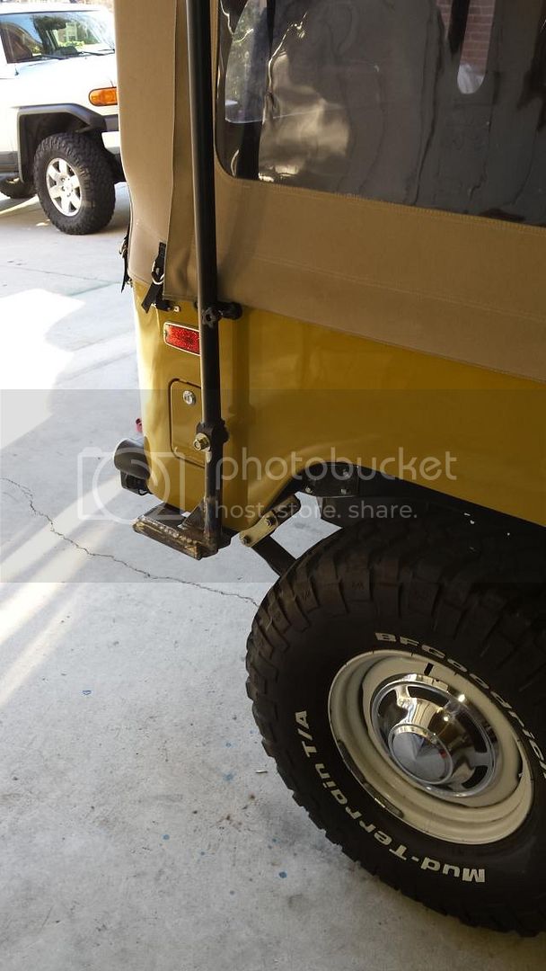

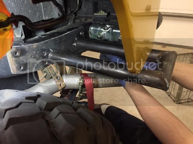

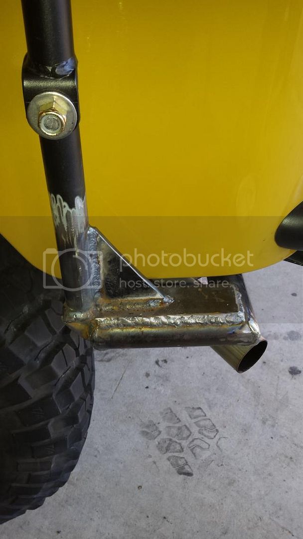

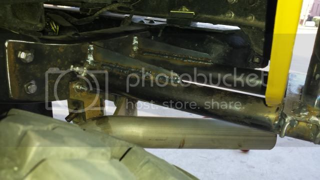

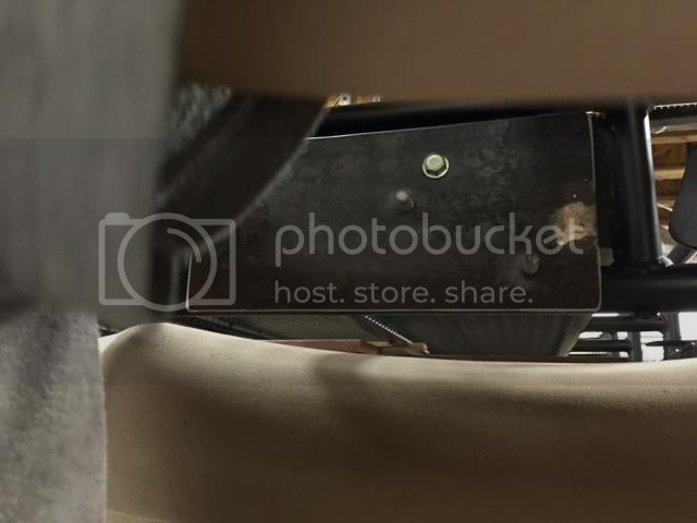

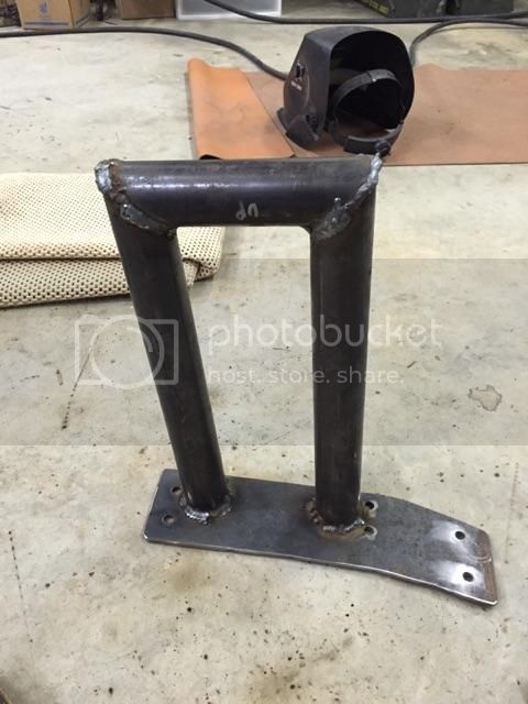

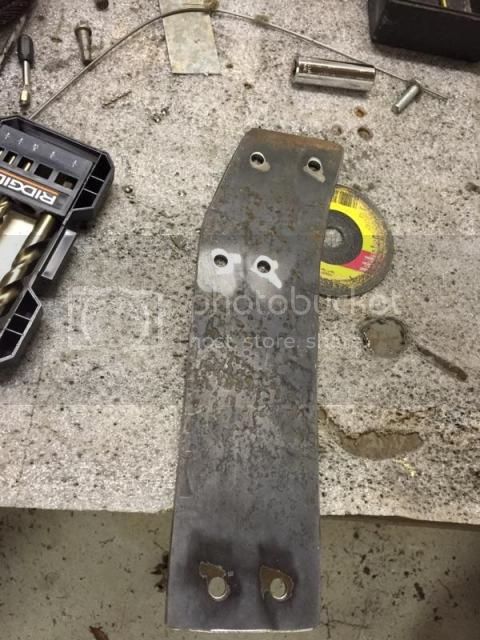

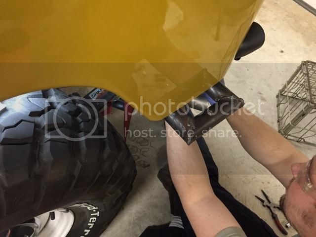

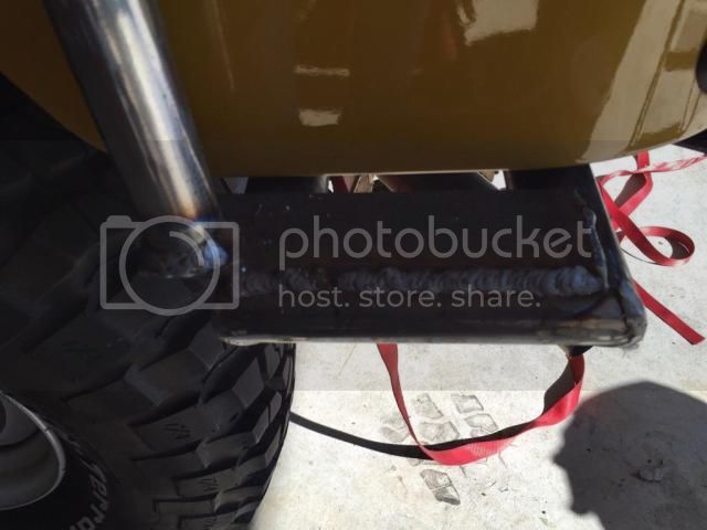

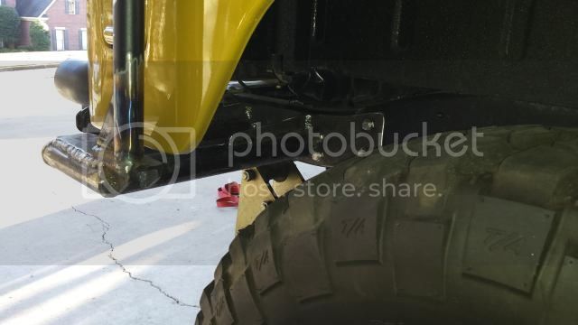

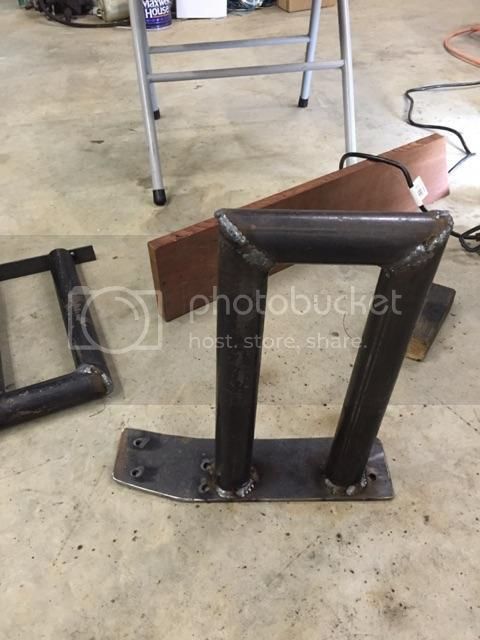

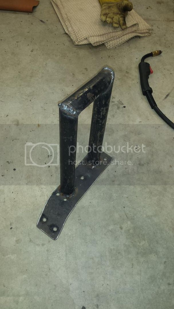

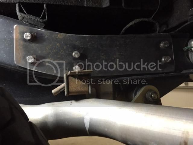

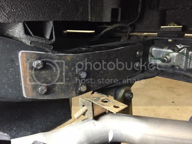

At this point the rack was functional but I really did not like the design of the rear frame mounts for the rack since they actually use the sheet metal on the quarter panel for support and have way to many sketchy brackets and gadgets holding the thing together. Since this truck has a shiny new paint job the mounts HAD to go. Saturday morning we got an early start and got back to the grinder, welder, and cut off wheel and came up with this! The plate bolts to the frame with 7 8mm bolts on each side and is extremely sturdy. It picks up existing holes in the frame so we didn't need to drill new holes in the powder coated frame. (powder coated or not I hate drilling holes in places where they don't belong) I wouldn't hesitate to use it as a jacking point for the high lift and it offers a good bit of protection for the rear quarter almost like a miniature slider.

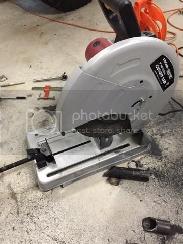

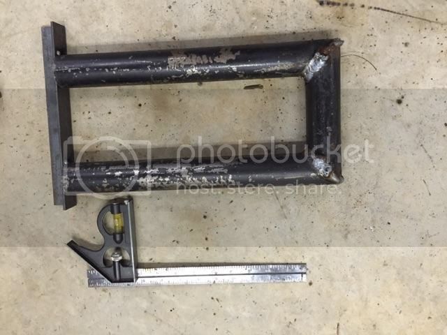

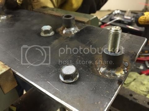

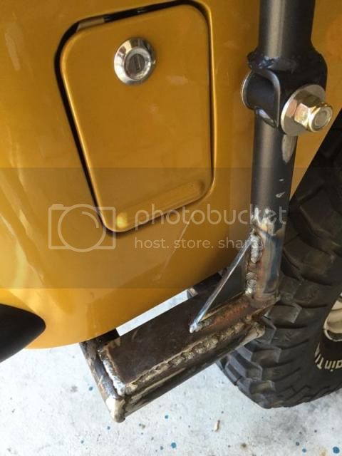

we used 3/16 steel for the plates and gussets and I believe the tube was .30? (pretty thick) the new brackets don't touch the body and are much much stronger. I reinforced the two horizontal tubes with 6-7'' gussets the vertical tube is reinforced on the back with 1/2 plate gussets. The tube we cut at 45 degrees with our newly purchased harbor freight chop saw :) I know my welds need some work to be pretty but they do have sufficient penetration at least and shouldnt fail in this life time. They will come off once again for black powder coat when we turn in the next batch of parts.
As long as the welds have penetration, like you mentioned, you're fine. You should see what the bottom of some of my frame plates look like. I hate welding upside down...:doh:
Always remember this: "A grinder and paint, makes you the welder ya ain't"

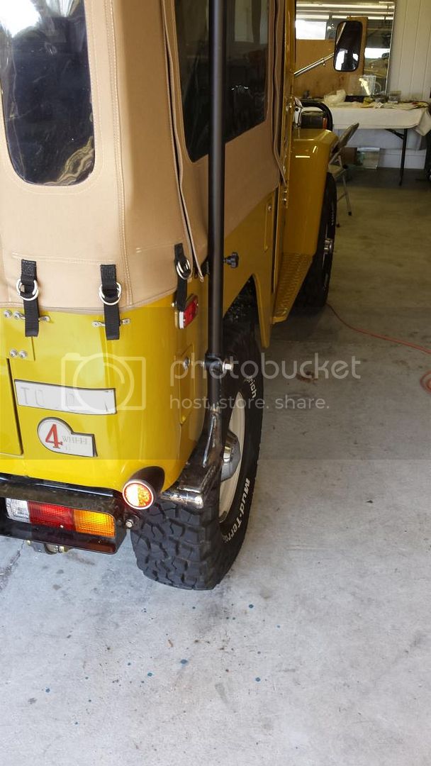

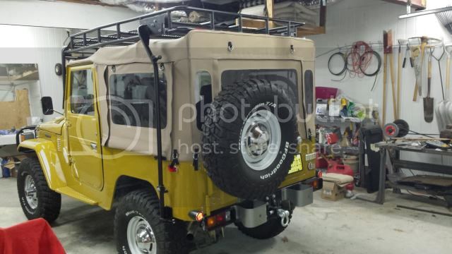

Just curious, do you have any plans to turn one of the side supports into a ladder to access the roof rack?

Just curious, do you have any plans to turn one of the side supports into a ladder to access the roof rack?View attachment 1036783

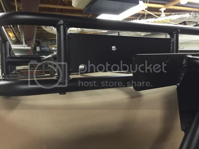

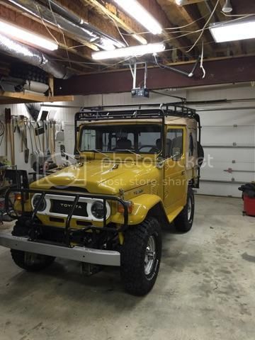

The gobi rack actually has a ladder that attaches to the passenger side. All the brackets we welded up are getting black powder coat this week and will go back on this weekend. Im waiting to attach the ladder so i can test fit it with another big piece of the project, ;) that's finally ready to go on the truck.
