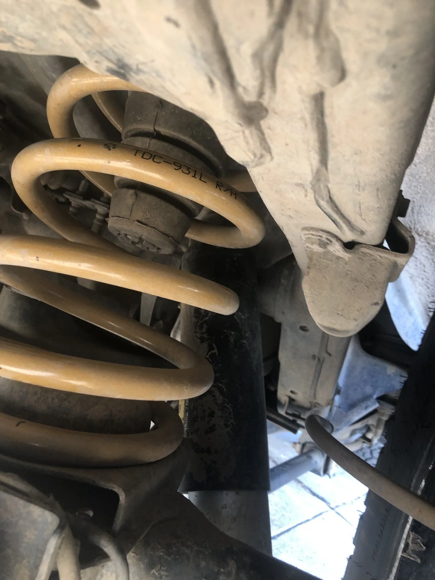

So the Passenger, fuel tank side has the spring marked R/H as shown in the image. This should be correct as the passenger side spring is longer to compensate for the fuel weight. My lean has the passenger side sitting 1.25” higher then the driver side.
Just making sure taller spring was installed on passenger side.
Thanks for the reminder To double check. , I wish it would be that simple lol.

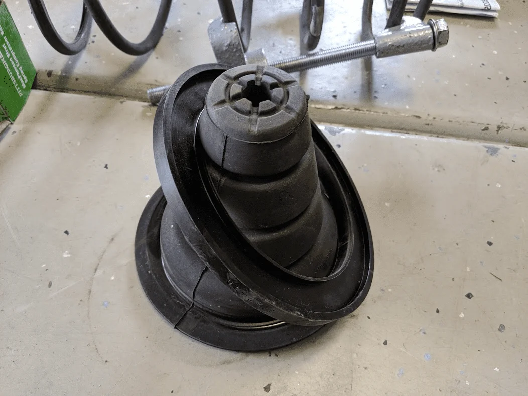

Question for you about putting the spacer on top of the bump stop. Does that cup the bump stop goes into still have enough bite? I put both my 20mm worth of spacers between the spring and bump stop because I wasn't sure if it'd push the bump stop down to far to not seat properly.

heads up on that Ironman spacer, it will not sit flush on the bump stop. The inside diameter is a fraction too small. I butchered mine trying to make it fit. You will have to remove some of the material on the inside in order to get it seated. i decided to try out doubling up OME spacers which worked well.

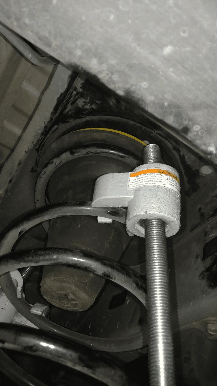

Spring compressors help if you're doing it alone, but I feel like if I have to use one I'm doing something wrong since nobody else ever mentions them. Also at least the cheap one I have can scratch some paint off the springs (saying this not for suspension beauty but because I presume it may increase the likelihood of rust).
