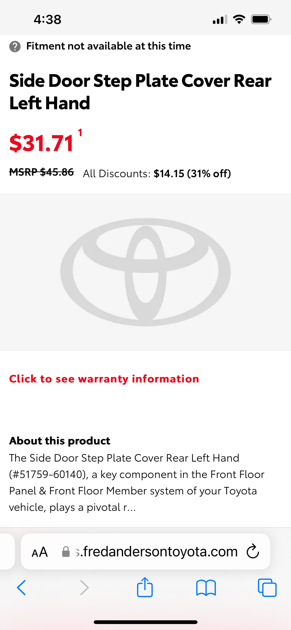

Noticed I was missing the LH rear running board trim piece yesterday. No idea how it could've gone away. I don't do any off-roading, so I certainly didn't bang it on anything. Found a post that states the p/n is 51759A, which doesn't look like a real Toyota p/n, but googling that pulls up at least two parts:
51759-60050
51759-60160
On a Toyota parts website, both of these says "May not fit your make/model year vehicle". The top one states that it fits TOYOTA : 1 model, 10 variants between 2014 and 2021. My LC being a 2013, does anyone know what the p/n for that year might be?

Running through parts.fredandersontoyota.com, I come up with this one for a 2013. Best advice I can give you is to write down your VIN and input it into the parts website and it should give you the right part number.
Thanks for the reply. I ended up going to a dealer and asking for help, and was told that these running board parts were deleted from the inventory after seven years, since they were aftermarket parts to begin with. As such, he wasn't even able to give me the P/N for the 2013, but he did have something listed for a 2018, and assured me they should be identical. That P/N was 51759-60160.
I found one that looked likely on Ebay and purchased it, and it turned out to be the correct part.
