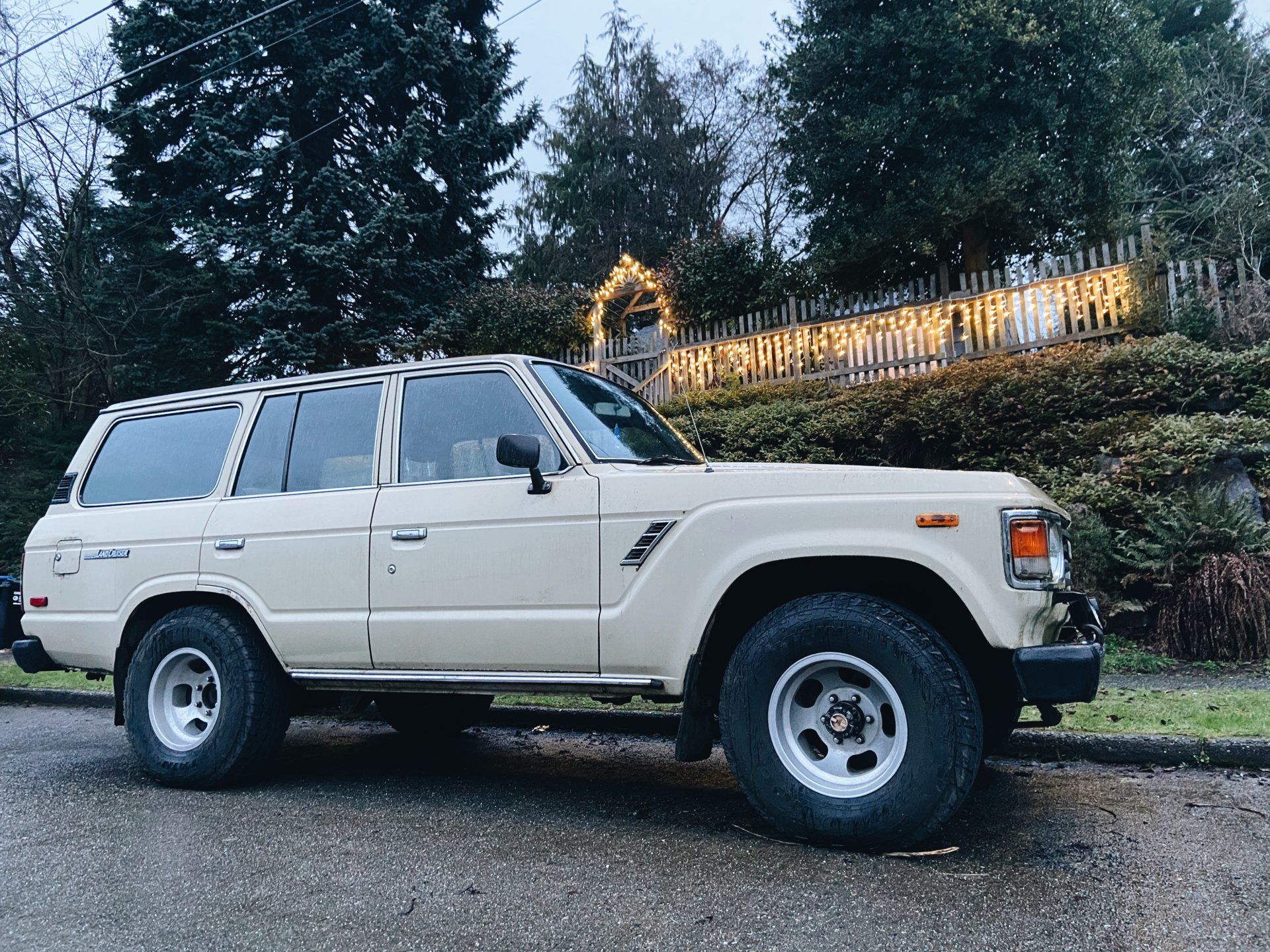

Treebeard’s first glamour shot... can’t wait to get rolling.

Gotta ask, do you recommend this as a general recommendation for a 60 owner or specifically because of something in the photos of my truck?
It’s in some rough shape and you may need one.

You are starting a relationship. If It is love at first site, that can be very motivating and willing to give forgiveness in the future. If you are willing to try the field and wait for that perfect match and have the patience and time to see what comes along, then you may do better - but maybe not. Even if love at first sight, you need to be realistic about possible and possibly a hidden flaw. Just like a smoker to a non-smoker or a substance abuser to a non user can be a show stopper, here is a flaw to be on guard for - frame rust. Get on your grubbiness, grab a good light and wiggle around everywhere underneath poking at the frame with a screwdriver. If everything is solid, you might be looking at a proposal. This past fall was the 20 year mark owning my 60 and there has been a lot of forgiveness. And mine looks tons worse than your pic!
