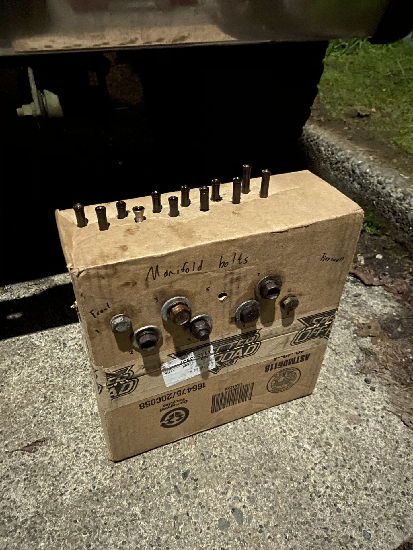

Y’all SOR makes a great bolt/push rod holder.

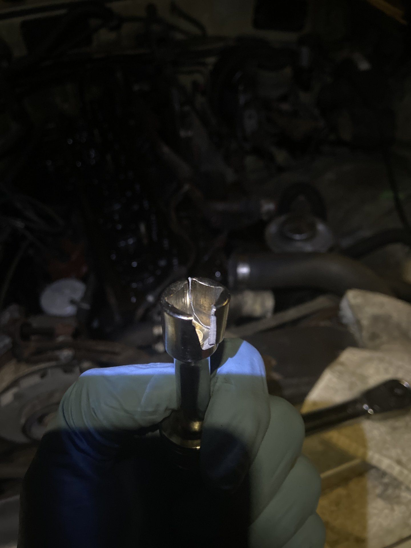

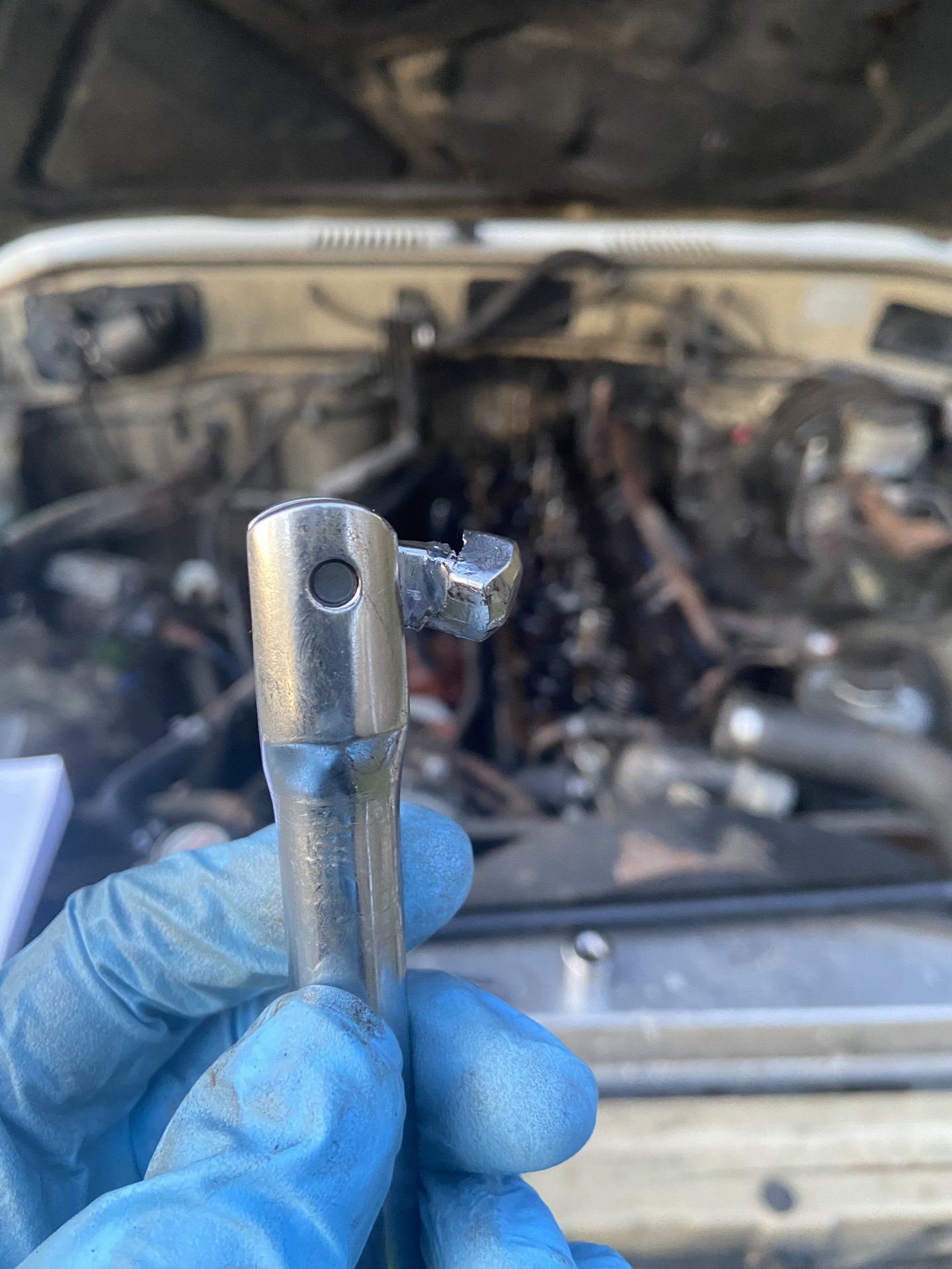

Oh bugger!
I'm afraid budget priced tools ain't worth it. Ya need a Sidchrome socket set...guaranteed for life👍🏻
I guess it's Snap On for guys over there, hey.
Keep at it mate, you're doing great!
Brand new Husky 3/8” breaker bar... I guess I’ll step up to 1/2”.
Yep! Definitely need a good quality 1/2" socket set mate. You're probably applying at least 150ft/lbs of torque to crack the head bolts free.
Snap On, or Bahco are good also, often find them on sale.
I've got a 1/2" Bahco set, made in Sweden, I find it to be excellent quality, and the feel of the ratchet drive is so smooth 😀
I already have a full 3/8” set of sockets and picked up a 3/8” torque wrench last night. That’ll give me the torque requirements for rebuilding the engine but obviously not for breaking it down. 🙈 Lesson learned. One of these days it’d be nice to upgrade!
Yeah, I hear ya mate...quality tools ain't cheap!
So are you just gonna get a 1/2" breaker bar and the required sockets? I guess that's the cheapest option, unless you can borrow from a mate.
Went ahead and bought them. I’m blessed/cursed with a Home Depot, harbor fright, and an O’Reilly all very close by. The bolts are out! Think I could return my cheater bars to HD? 🤔
Yep, you should really have a 1/2” set up. Makes a huge difference when it’s needed....like 4x4, or a locker.
Engine dismantling and suspension work are not 3/8 territory.
Nice work!
Yeah, give the return a try, just tell em you didn't need it, coz while you were out purchasing it, a mate who was helping you managed to finish the job!
Nah...you'll be needing it again...I guarantee i😂
