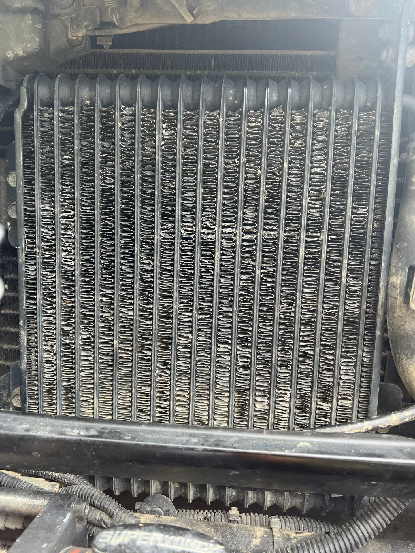

1997 LX. The transmission cooler is actually in front for the radiator on the driver side. 242K miles. Time to replace it all the fins are bent and it is not letting air through to the radiator

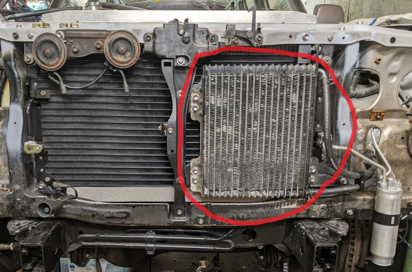

Circled is the air transmission cooler. There is also a transmission cooler in the radiator.
Behind the transmission cooler is the A/C Condenser, and behind that is the radiator.
I don't think the air transmission cooler is available from Toyota. I wish because I would like to replace mine.

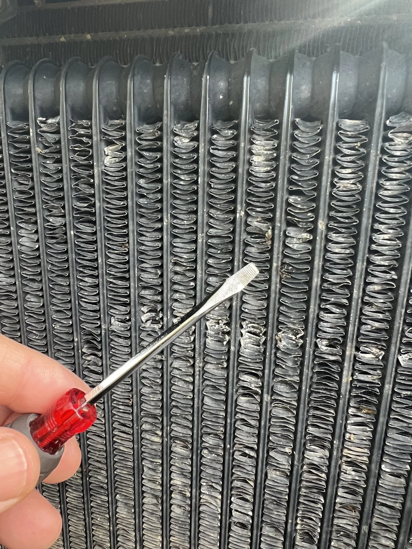

For the peeps that don’t mind some extra credit, they make fin straighteners that work for this application. I would fix the fins and shoot a fresh coat of paint on it and poof done.

As anyone used a fin comb on an automotive condenser before. I see how it will work on an AC unit but not sure how it will do for this application as the fins are not simply vertical but more in a zig zag pattern…

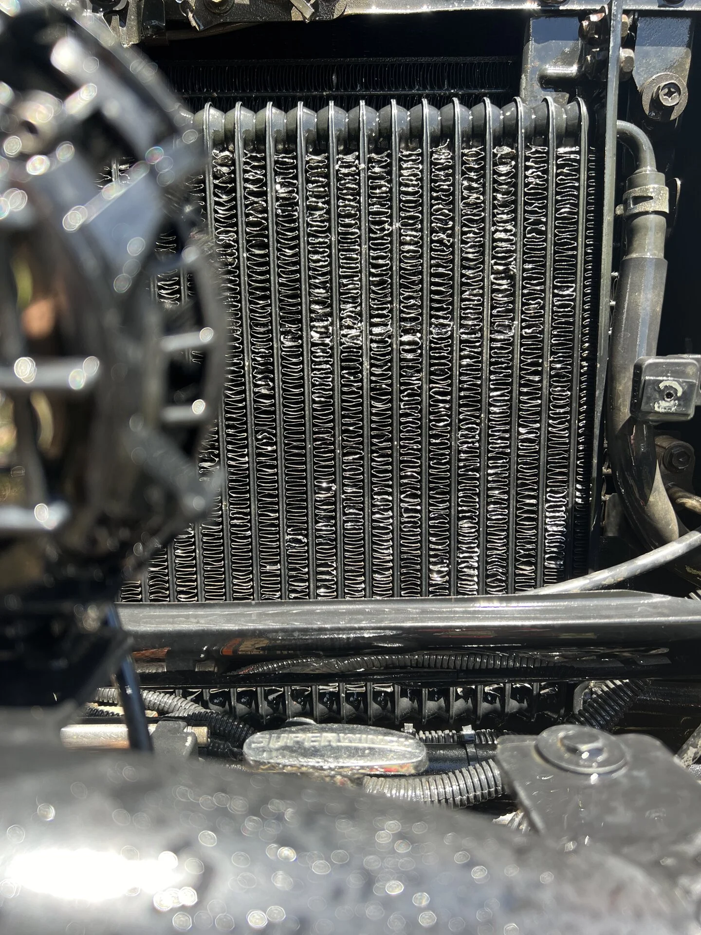

I’ve used a small, flat screw driver to straighten cooling fins many times over the years. The stock 80’s trans cooling system is a good design that obviously does the job very well based on my temp gauge readings and the fact that hot transmissions are not a topic of discussion here and has proven itself to be durable not to mention it fits properly without a day of mounting mods.
Take a screw driver to those fins, make sure the plumbing is routed correctly and forget about it. If the fins are mashed together too tightly start the process with a pick.
