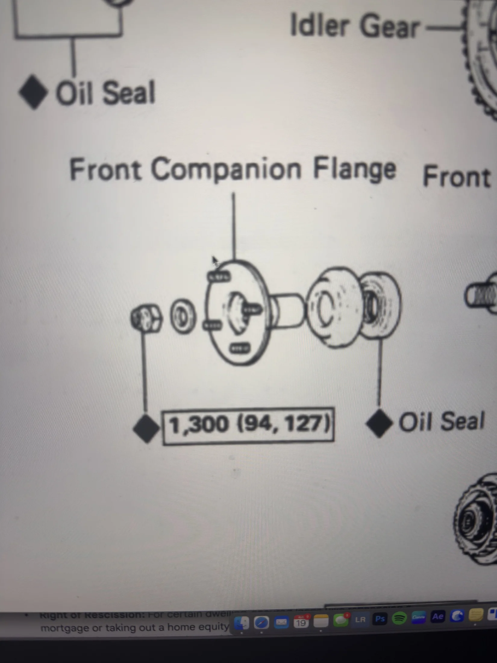

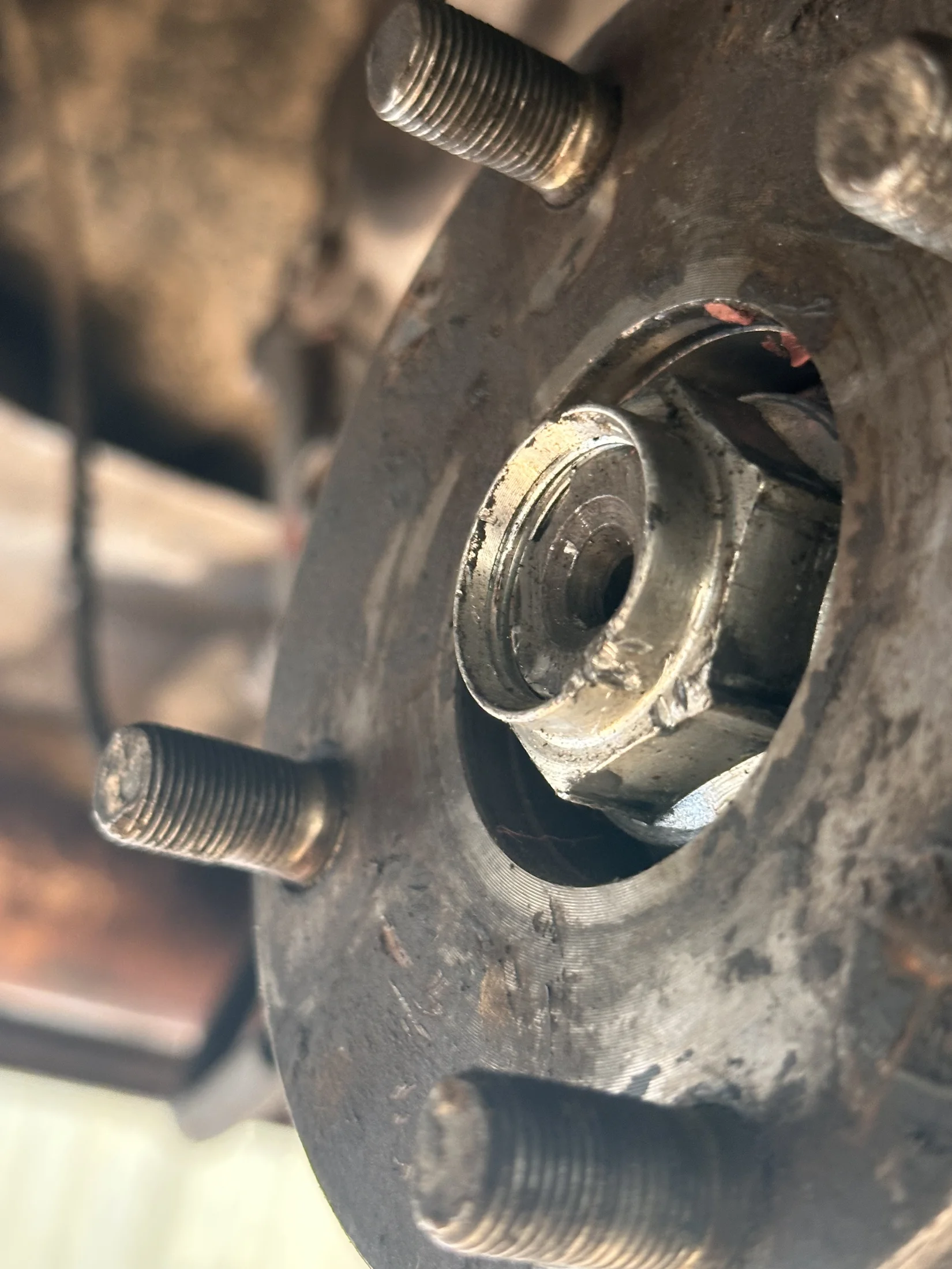

When i go to stake both F/R I noticed that they don't seem to be far enough on to stake properly.
and yes I did already torque these to the 94lb spec.

something is wrong, there should be threads coming past the end of the nut

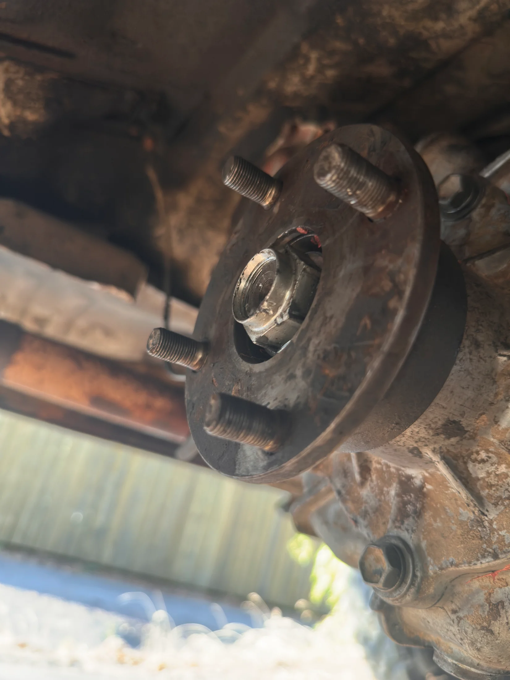

the backside of the flange should be up close to the housing, can't see it in the pic
I can grab a better pic later but you can see the flange and the housing here.
Again everything is snug. I’ve run it for 10min now and nothing has sounded off.
Should I remove the washer behind the stake nut? That might get it on enough.
I was wondering if there is a washer/spacer between the nut and flange
I agree it looks like a flanged nut. Not the right one. If it is pulkl the washer out and you should be fine. But you may be better off just getting the right nut.

The flange nut will take the place of the washer. Remove washer, use the nut.
Seconding this, not that Onur needs any backup. Found that out when I rebuilt my t-case last year. The new part number is a flanged nut, negating the need for the thick washer.
It’s a better part too.

got the washer removed using a little magnet grabber and the fitment is definitely right now! 👌
