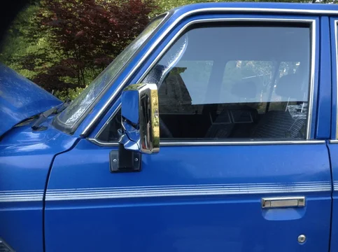

Got some 62 mirrors for it, deffintly cheaply made but they do the job well. upload_2015-8-8_13-9-50.webp
