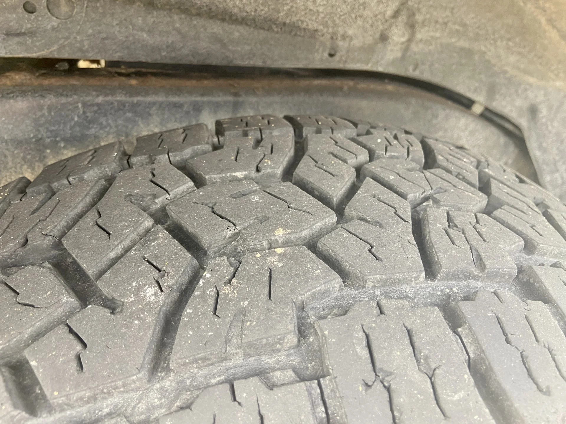

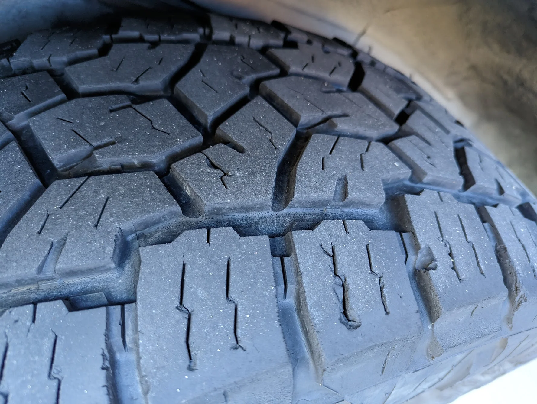

I mentioned this another thread and managed to snap a photo of my best looking tire at the moment. These at3 have 5-6k miles on them. Had anyone else experienced chunking similar to this? Would this warrant a cash in on my DT certificates.
I’m pretty disappointed at how fast they wear and how torn up they have gotten.
Personally, I think this is pretty unacceptable. However, I would love some more input.

I'd recommend you try and return these under manufacturer warranty

Is this happening on all tires? Or just one?
The micro cracking down in the grooves makes those look like very old tires. If they aren’t there might be a material issue. Mine look nothing like that.

Mine are beat-up in spots, more on the shoulder lugs. It's chip resistance doesn't seem as strong as some other AT. Though I'll say I'm not nice to them running on sharp granite trails, but also hooning them on loose dirt. About 15k miles on mine now.
Would be interesting to see if anyone else has irregular wear on whatever tire with harder off-road use.
FWIW, I had similar with a Nitto Terra Grappler. Sister company. They chuncked out almost identical to what @TeCKis300 shows in the image above as they aged.
To be fair, those tires show quite a bit of weathering (cracking) at the bottom of the grooves. Seems like a lot for a 15k tire. What is the manufacturing date?
Isn’t there a manufacturer date on that tire?
Definitely not normal. Mine have 25k on them and look much better than that. I wonder if you got a bad batch?
