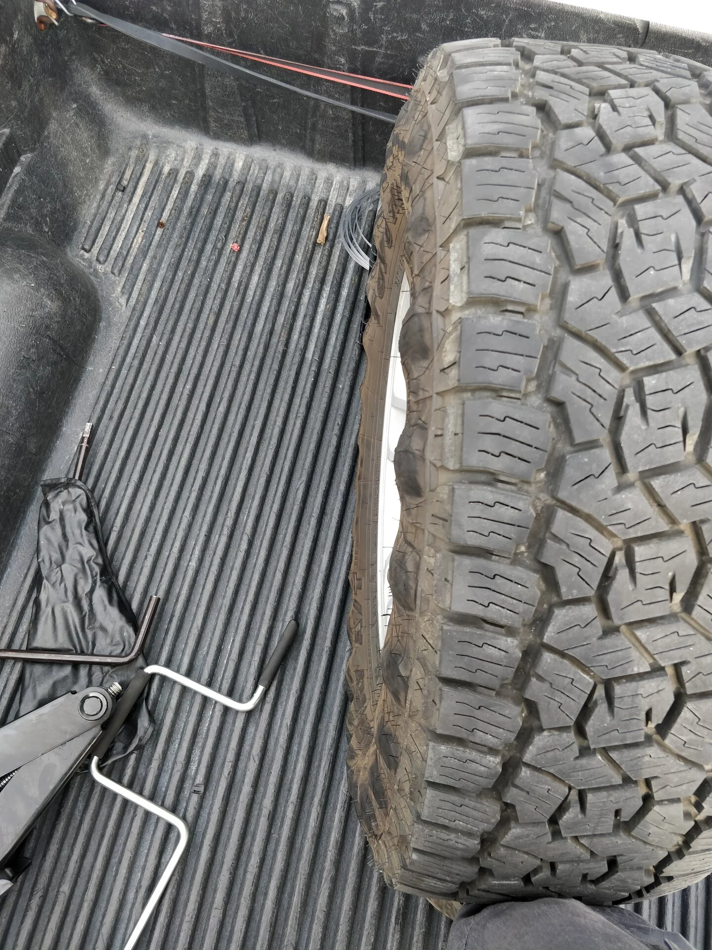

I have a recent bad experience with the open country at3's. I put a set on my 1998 Toyota t100 4wd in October 2023. Its my commuter daily and i drive 75 miles a day of paved commute to work daily with it. I also took these tires on a 1600 mile roadtrip for work as well. Yesterday i had a sidewall failure while driving on the highway. The tires were checked for level daily and i check psi every couple weeks. They haven't had any hard slams and have had zero curb contact.
The tire affected has multiple sidewall bubbles. There is no punctures on the tire. But suddenly i lost most my psi while driving 70... I believe that the multiple sidewall bubbles could of probably been caused by me not being able to get to the side of the road for probably a bit too long... But with no punctures/proper psi maintenance/ and no abuse i am 100percent confident i had a defective sidewall causing this. Discount tire is crediting me 140 of the 215 dollars for the tire- but they are not ponying up for a full defective warranty case. They say i either grossly overinflated it or had severe contact with something that woulda caused the sidewall to fail. Neither of which is true.

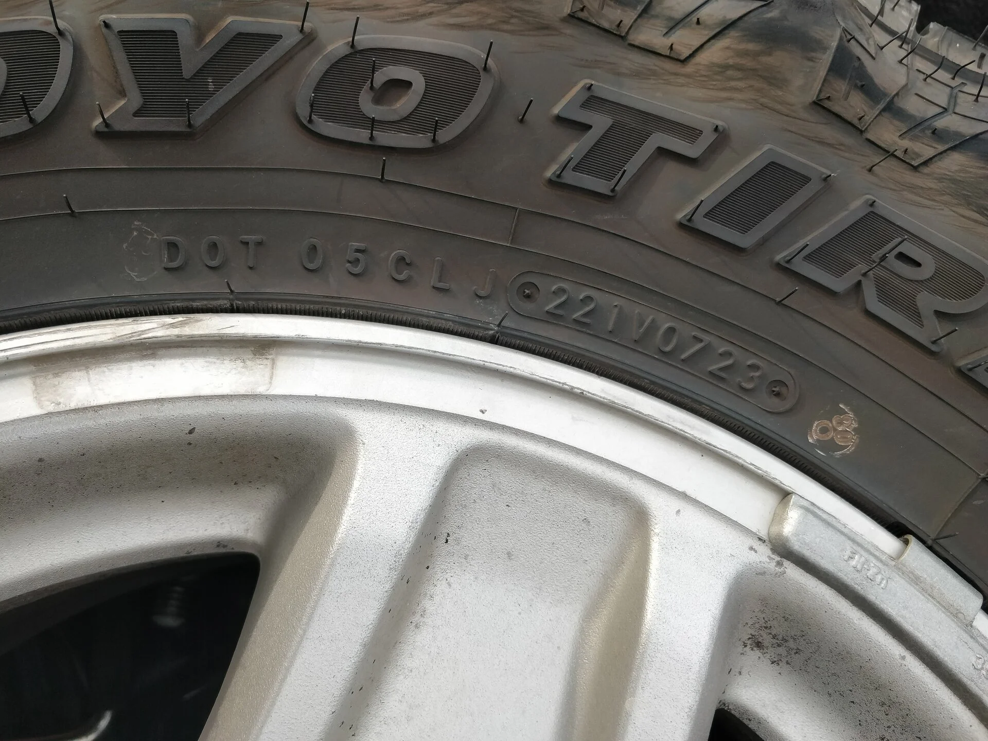

There IS a recall on open country at3s made in serbia out of a specific molding that was incorrect... This caused separation and loss of air thru the sidewall. But my tires were manufactured elsewhere and dont fall under the recall. My issue however is screaming that the same defect happened to me though. I called toyo to let them know and they politely denied any responsibility or possibility that it could of been a defect (of course) and they were thrilled to have discount tire handle any claim there may be....
I won't be trusting this brand after this ordeal... I know it can happen to any tire but sidewall failure with no punctures on 12k/4month old tires is not acceptable.

From your pictures I assume that this is a P rated AT3 tire. Do you know whether they were made in Japan or the US?

I have run many versions of Toyo Tires on all types of vehicles over the years and have never had an issue. It would seem to me that the tread in the pictures is uniform in wear no excessive wear in middle or edges. I think its fairly likely you ran over something and it didn't stay in and the driving on it while low did the sidewall damage. If you inspect the tire from the inside you may even see a sign of a small or possible not so small hole, who knows.. To me for a T-100 you should not have had P metric tires on there, you should have been sold a LT type tire with a load range of C at a minimum. I don't know enough to decipher the side wall code other then the date it was made which was 07/23. I think when you make an investment like tires it's pretty important to never inflate to what tirs say but use the vehicle tag on the door jamb and then go off how youre using the vehicle ie has weight in it or towing etc.. thewn rotation every 5k miles and keeping up on alignments/ front end components etc too. lastly I always get the "road Hazard" warranty through where i buy the tires if it's available, costs a couple bucks but one tire does this and the warranty pays for itself.

The p tires showed recommended for me on all the sites. I dont tow or haul anything heavy with the t-100. I use my 100series with e rated ko2's for towing when needed. If i was going to haul heavy loads regularly id certainly have chosen LT tires.
The tire pressures in the tires are 35 all the way around. Came that way installed and i dont have any issues with that pressure. They have not budged from that pressure since original installation.
I inspected the tire on the outside when i turned it to discount tire. I then inspected it externally with the tire techs there and verified no external punctures. When i picked up the truck i asked the manager if there were any punctures found when dismounting. He said no. I then asked the tech who dismounted/mounted new if there was anything in there. He stated no as well.
The tire held air in it from the time the sidewall gave way all the way until dismount 2.5 days later.
Sidewall breakage in less than 10k miles with no punctures or hard impacts is unacceptable and unsafe.
As for discount tire certificates- spending 10-15 percent more each tire is still not for me. I just wish i was fully reimbursed for such an obvious manufacturing defect. Im very sure discount tire will get the full refund into their account.
I also have spent a year as a diesel tech and changed/repaired 100's of tires myself (by hand) for 18 wheelers/trailers. From my experience in the field i will make an estimate on what happened:
Sidewall cord broke causing a profile change in the outside tread wall- this caused growling sound while driving that i thought was my rear end/diff growling. The sidewall scrubbing on the ground due to the broken side wall cord caused heat and further damage and the bubbles between each sidewall groove. Tire held air from the time of taking it off till dismount at tireshop. Looking up toyo tires recall on the at3's this failure lines up perfectly with what happened. However toyo is claiming that this issue doesn't apply to my dot#. At the end of the day im the guy with the short end of the stick. 75 dollars poorer driving with a set a supposedly good quality tires that i dont trust anymore- purchased from a reputable source who recommend these tires to me and will not offer manufacturer warranty to me when the tire failed in an extreme and unsafe manner out of no fault of my own.

Under bullet point 2 is the most likely experience i had. All the evidence points to it. However my dot numbers supposedly aren't under this recall so thats why im here stating my experience. It is easy to feel bias towards something you like and have possibly invested in. But i have a bad taste in my mouth from it now. At least its posted so that anyone looking into this thread can see my first hand experience with the product.
