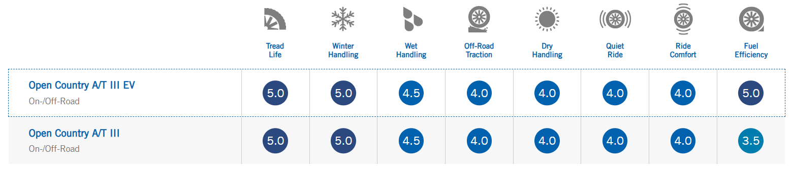

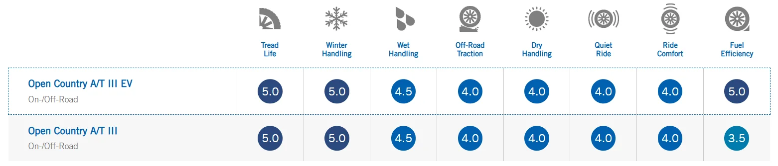

The tires made for EV use are interesting.
In comparing the Toyo Open Country A/T III standard vs the EV model, the EV model is cheaper, lighter and is listed to have “low rolling resistance technology” while the standard doesn’t mention having low rolling resistance.
So what does it give up?
I do see that it’s SL rated instead of the E that the non-EV tire is rated to.
But if SL is rated to 2756lbs and my rig weighs 6780 empty, do I care?
Or does this mean if I ever get cross-balanced on just two tires, I’m immediately in trouble as they burst?
(This last question is mostly meant facetiously, but I guess there is a real possibility of having all the weight on just two tires so maybe it’s a real worry?)
And what about sidewall? Does SL necessarily mean thinner sidewalls? The Toyo page says SL= Standard load and E = 10ply rating. But this is in reference to Load ID - not impact resistance.

Seems like you are comparing apples and oranges as far as the EV to non EV tires. The EV comes in both ISO Metric and LT forms. The LT models are heavier. The ATIII (both regular and EV flavors) in it's ISO/P Metric forms (SL) are a lighter duty tire with less tread and less sidewall dressing. The ATIII EV and the ATIII in LT275/70R18 BSW both weigh the same 53lbs.
All that to say, i have no idea what the difference between the EV and non EV models are. The literature says "AeroWing sidewall lug design" and "EV Optimized Tread Design & Compound". The only extra bullet point for the EV Optimized compared to the regular tire is "reduce rolling resistance and long treadware life".

Ah! Thank you! I was, indeed, misreading it and now see that the two do weigh the same.
Edit: though I think only the EV version comes in both SL and E Load ID in size 275/70r18.

It does come in both. For both the EV and non EV.
Nevermind. Looks like there isn't an SL size like you mentioned.

A big factor in rolling resistance comes down to the rubber compound. It's likely the EV variant is using a low-hysteresis high silica rubber compound, meaning a material that deflects quickly so it doesn't sap energy as the tire goes round and round. Aggressive sidewall lugs don't move through air efficiently and represent a source of drag at high speeds so the sidewall lugs are likely lower profile.
I'm surprised they were able to get such a bump in rolling resistance without impacting other performance factors (at least significantly) to rate it equivalent to the normal variant.
Could be a win win if I could only get them in a size I want.
